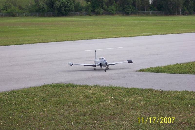

HI, I have the F80, which is basically a single seat version and agree on rhklenke comments on landing, I will try a more aft CG this year , to try to soften the landing.
Rcpete
PS, I have a P70 in mine and think it is a good combination.

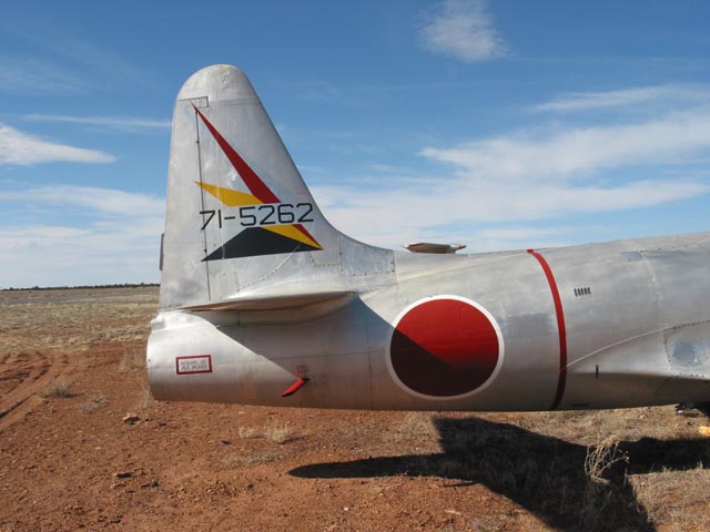

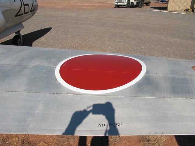

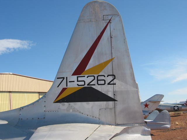

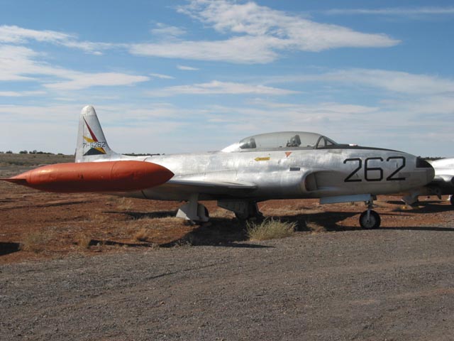

A different scheme for the T-33. I believe it was used by the Japaneese AF during its operational life. The T-33, F-80 rank as some of my Fav jets too.
