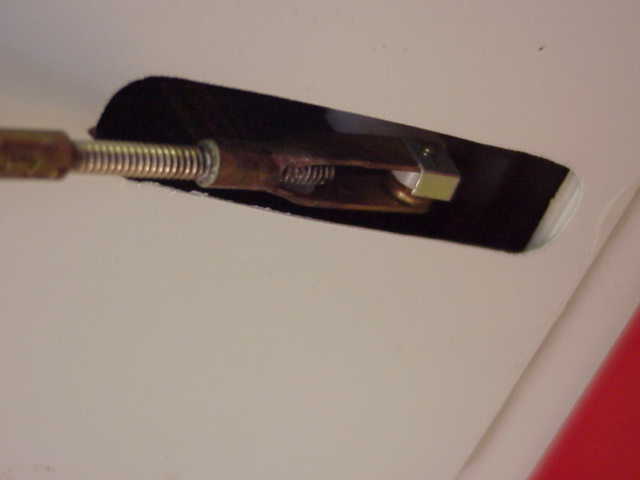

I haven't got the book in front of me right now (nor do I remeber my college physics) but there is a direct correlation between the length of a lever arm and the force that is required to move it, or rotate it as is the case here. Stronger servos is not necessarily the cure for a poorly setup linkage. In my opinion I have proven time and tiem again that the servos on mine with the linkage setup correctly is more than sufficient.
Here's a picture of my linkage.
Maybe it's my SUPERIOR piloting skills that keeps mine from going in!
THat and the fact that they keep the bleachers behind me when I am flying the BC.I haven't got the book in front of me right now (nor do I remeber my college physics) but there is a direct correlation between the length of a lever arm and the force that is required to move it, or rotate it as is the case here. Stronger servos is not necessarily the cure for a poorly setup linkage. In my opinion I have proven time and tiem again that the servos on mine with the linkage setup correctly is more than sufficient.
I happen to be doing an Isobar turn around down at the same end of the Lumberton runway when Dennis' Cat went in. I could see that the aircraft was in trouble with peripheral vision. I almost wrecked the Isobar 'cause I started paying too much attention to the BobCat!
David,
You may recall that we had the discussion about servo arms and length while I was building mine, since you already had yours flying. I did set mine up like yours with the standard short servo arm. My arm lenth was the same as yours. Like you, I had to cut out the servo cover so the entire clevis would fit through it.
The reason they put the bleachers behind you is so the rest of us could hide behind them while you fly!!!
So far as piloting skill, it doesn't take much skill to bend the transmitter stick till it breaks, only adrenalin.
Dennis

Dennis,
There is obviously something correct in David's set-up and something was incorrect in your's. I have explained that if improperly set-up you will not be getting the correct hinge moment to the control surface. Not much more I can say. I hope I've explained this as clearly as possible. But I will repeat, the Travel Adjust feature is not the only indication of the travel set in the TX. The Trace Rate menu and the DR menu's adjust the throw also. But if bigger servos will make you more comfortable, then by all means install bigger servos.
I just helped a pattern buddy with his models this weekend. We spent 6 hours optimizing the set-up as I've described and the results were much "tighter" feeling models and less battery drain. We could fly more flights before needing to charge. This was a direct indication of the improvement.

David,
What is your trace rate set at? Mine was set at 100%. If yours is 100%, then ours were set up identically. I set mine up that way because yours was working well. I did not want to use the long servo arms because I did not want the reduced leverage inherent with that set up. The elevator horn was installed per the plans with the clevis hole at the hinge line and the recommended distance from the surface of the elevator. I was very careful about the setup of the elevator servos.
