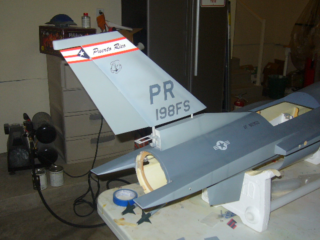

Yes sir, thank you, thank you, thank you Success!
I used the 2:1 clear/hardener, and then a 1:1 clear/flat and the results were great: dead flat.
I think the 10 minutes in the shaker helped a lot! Clear was dust dry in about 25 minutes, and I was able to clear the whole airplane in 2 hours. Now I only have to clear the ordinance.
Once you get the mixture right, it si downhill from there.

Old 04-04-2008 | 12:34 AM
SPLIT S's Avatar
Joined: Apr 2006
Posts: 1,171
From: Blandon, PA
Default RE: M148 flat agent
Congrats..looks great!!!
