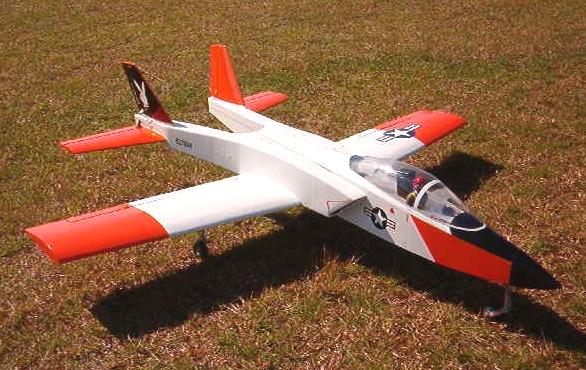

Hello Friends:
I like very much the DV8R. Someone has the plans of the model. In paper or any format.
Many thanks in advance.

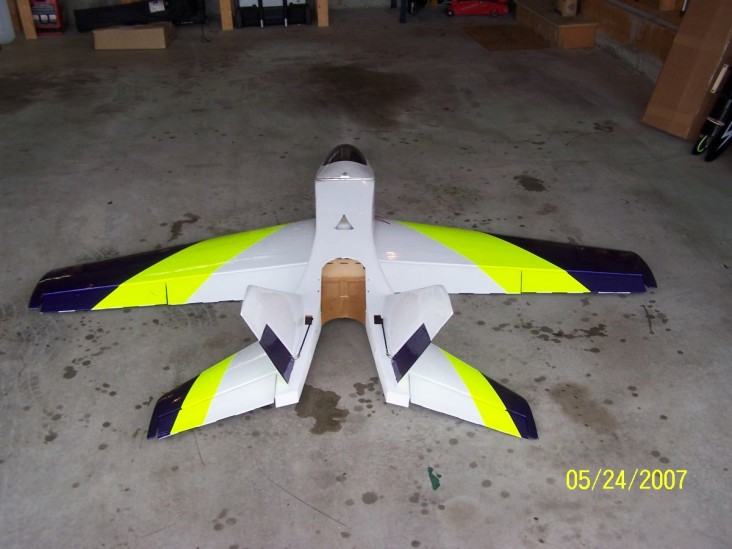

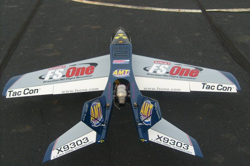

I liked the layout of the DV8R but I downloaded the manual & scratch built one a little smaller for my Wren turbine. Do you want me to send you the manual?
I redesigned it slightly to remove the bent like a banana shape & enclosed the engine which now feeds from inlets at the front. The canopy is from a Eurosport. - John.

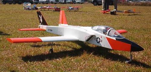

There's enough info there to build one. Pick a proven wing section from your favourite model (I used a Selig section from the Top Flite scale kits), use the basic design methods from the manual & build it from scratch.
You can use the opportunity to fix the bad features in what is a basically a great design (like open areas of framework needing covering in crappy film, exposed servos under the wing to be wiped out in a wheels up landing, anhedral on the tailplane so it bangs on the ground if you over rotate, and, yes, that broken in the middle look!) - John.

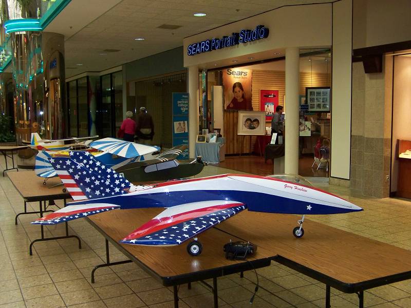

Boomerang1 The picture of the DV8R that you show is my jet. The plane is FLAWLESS in EVERYTHING it does! The plane performs with the best! Yes it is differet with the bent nose, to me it looks like a SU-27. The ONE thing that is CRUCIAL on this plane is the wing! YOU must balance the wing! This is the number one thing on the plane. It is GREAT at any speed! I had a P80 on mine and it was great! All my servos are hidden inside the plane, very clean!! Robart still sells the retracts for this plane also! hope this helps This is it now, recovered Boomerang, don't take this as a bad remark to you..... Gerry

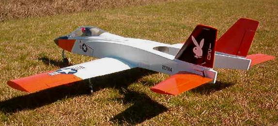

There were problems on some of the earlier kits with the wing incidence. With that fixed, it is a very nice flying airplane. I've actually got one hanging in my garage (if anyone is interested) and it has some real nice lines from certain angles.
