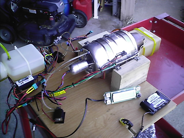

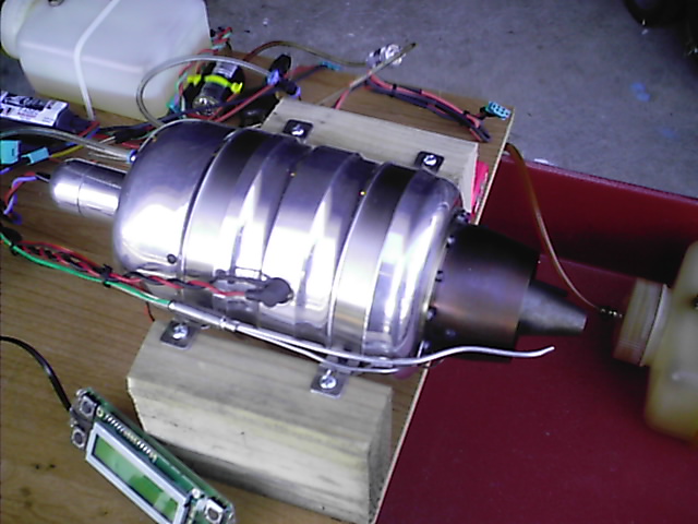

I need help with my TJT 3000, I got it not to long ago, today I had the chance to put it on a test stand, everything was going well 'till I try to start the engine, the Thermocouple is reading 236 degrees before I do anything and when I bring the throttle stick up to the top it goes into cooling mode, I see why it goes into cooling mode but, what's the deal with the temp. unit? [sm=50_50.gif] and where can I get a new one? ( this is a type "K" Thermocouple )
One other thing, I like to get the latest version for this FEDEC ( Gaspar ), where can I send it to have it updated?
Thank you in advance for any advice.

Sounds to me like you have a faulty thermocouple or possibly a FADEC problem.
The quickest way to resolve any potential TJT electronic component problem would be to ask Gaspar the designer of the FADEC systems used for the TJT-3000. You can contact Gaspar directly yourself here at Xicoy http://www.xicoy.com/

I had an idea and went to try it, I raised the minimum temp past the 266 to 276 to see if I could induce the FADEC to do the strating sequence and it did ( no fuel no propane ) but I still need the FADEC lattes revision.

Looks like the thermocouple is shorted to ground. Try to remove it from the engine and try again holding the TC tip in the exhaust, but without touching the engine body. If all OK, then you only need a new TC.... and to take care with the new one of to not bent sharply while installing..

I did per your instructions, I removed the Thermocouple from the engine and it gave me the correct ambient temp, I put it back in place and it seems to have fix itself because it is still giving me the correct ambient temp.

Usually things don't fix themselves alone... Unless you have found the isolation of the leads of the TC clearly damaged and fixed, I reccomend to replace the TC, it will fail again when hot if the damage is internal.

I like to report that the engine is running fine. I finally had time to play with it today and got it to run without any gliches for 6.5 mim all the way to full RPM and through the cooling process too ( the darn thing wanted to lift the test bench at full throttle )
I end up adjusting a few things on the FADEC progam, changing the starter "O" ring ( it is a grommet ) setting it with a drop of CA and I will have to get me a new Thermocouple, most likely from Tod at Dreamworks.
I like to thank Marty ( Jet FX ) and Mr Gaspar himself for their imput and suggestions.
