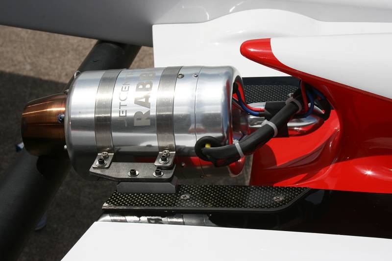

Yes, very well. Just installed the new Jet Central Rabbit in my new Bobcat and it operates very nicely. I only put an initial three flights on it today, but here's what I have deduced so far....
1) Weighs in at exactly 2.5 pounds
2) Fuel consumption in an average bobcat flight was around 7 ounces per minute. Most of the flight was spent at less than full throttle, as the engine moves the Bobcat at a pretty good clip.
3) Internal glow plug works fine.
4) We timed acceleration with a stopwatch ... idle (40k) to full throttle (152k) in just a hair less than 3 seconds.
The Bobcat is a custom job BVM did for several of us. Looks great in the air.. extremely visible. A great flying plane.

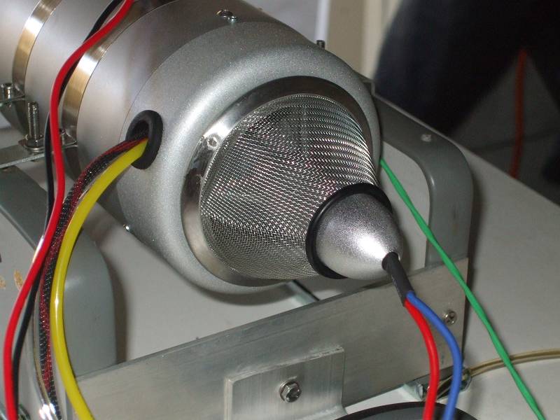

For anyone interested, here is a pic of the latest pre-production testinng FOD screen.
This one meets our requirements for how it affects the engine when fitted.
Regards,
Rob

Another tea strainer...

Actually if these were Tea Strainers we'd have probably been in production by now.
In fact this is the third lot of mesh we have tried and works well for up to the faclon engine.
We have a stronger mesh for the eagle and rhino due to the mass airflow these engines draw, and this is the next prototype to be tested.
The final design will have clips to fit to the starter motor "legs", as well as a protective ring around the base to keep the unit from scratching the engine housing..
Rob
