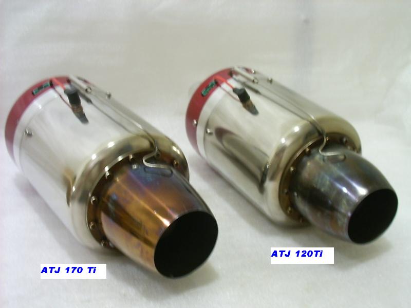

#86
Hi
Here are the spec`s
ATJ 170Ti Turbine engine Specifications
Dimensions 尺寸: Outer Diameter 110mm; Length: 290mm
Weight é‡é‡ : 1750grams (including starter)
Nominal thrust @ 15CéœæŽ¨åŠ›: 17KG @ 123,000rpm
Idle RPM 低速轉速: 35,000
Idle thrust @ 35,000 ä½Žé€ŸéœæŽ¨åŠ›: 0.8KG
EGT 噴氣溫度範åœ: 650-750 C
Fuel Consumption 油耗: @ max rpm 520 gms/min
Fuel/ oil 使用燃料: Jet -A1 or Kerosene + 5% oil (synthetic turbine engine oil)
Here are the spec`s

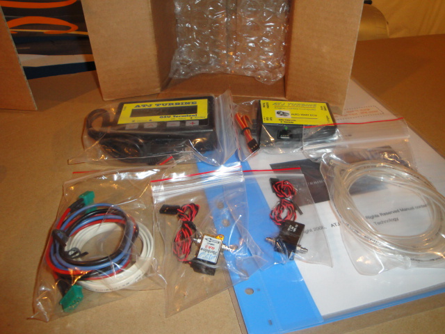

So Iconsidered it for about one month until he gave me a special price offer through e-mail and made me decide to buy it. Went back to Taipei and bought the engine. Before packing it up we fired it up (right there in his office, and that was quite scary to be honest ^.^) and, since everythign looked alright, Ipacked it up and brought it home.

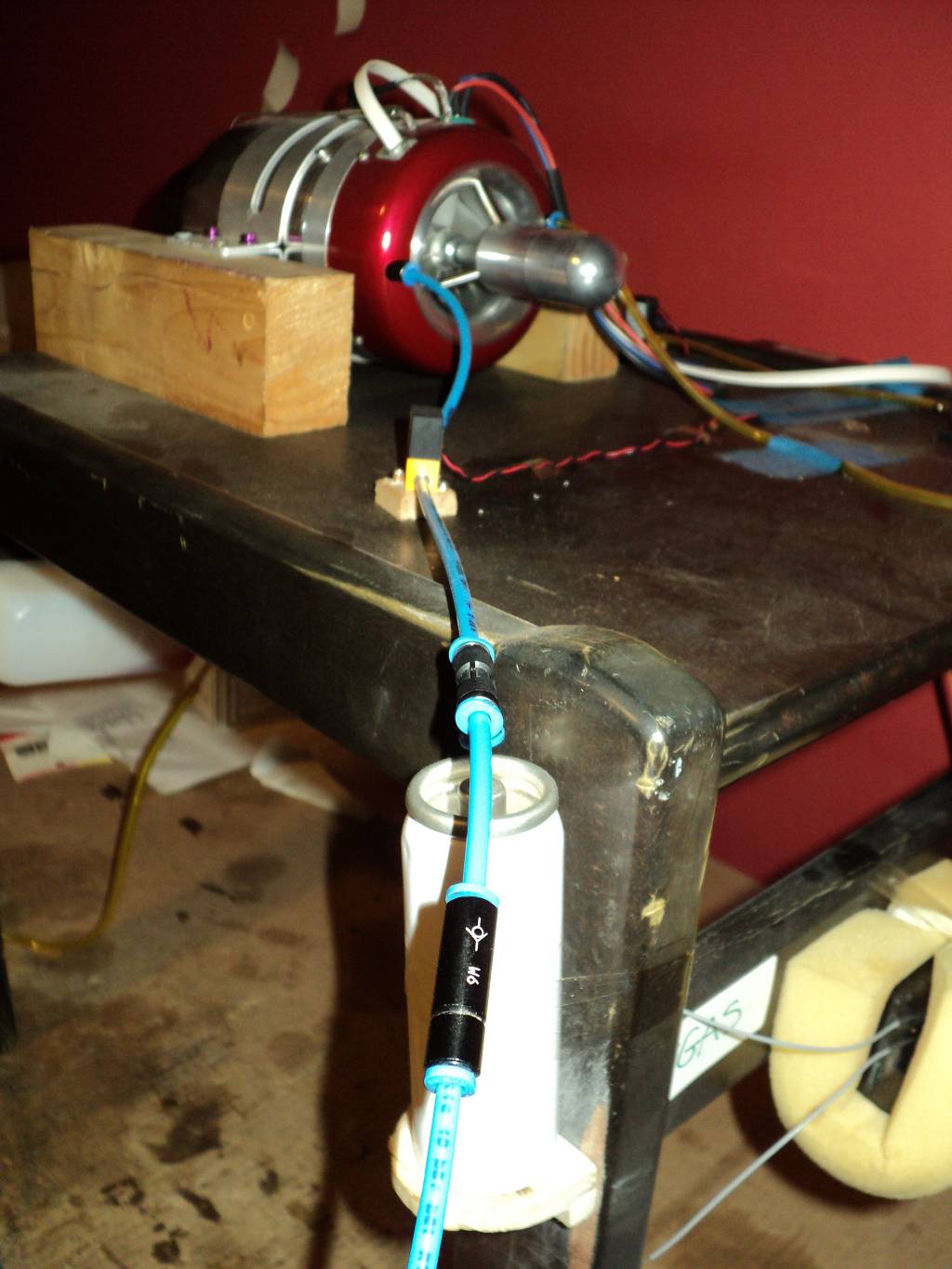

Since this is my first turbine, Iwanted to clear my mind of all possible doubts and run as much testing as possible before heading back to Europe so Ibuilt a test stand, ordered a co2 extinguisher, built a board for all the electronics and fired it up by myself.
Plugging the system to a fully charged 2s LIPO the glow plug (an OS. 8) blew right away (Joseph actually told me to expect my battery would be weaker than his as he was using a big lead acid battery, but this was not the case as the lipo was well over 8v). Replaced the plug and lowered the rate to the very minimum on the ECU start programming, Iattempted a start. Increasing the plug power progressively allowed me to find the lowest setting for reliable ignition to be at about 25 (original setting was 35).
After the gas ignited properly, she spun up to pre-heating and then shut down giving me a "bad start" error. This happened 2 or 3 times then the engine actually started properly.
It then ran flawlessly just like the one Itested "on the road" so Ishut it down to straighten out the startup issues. Cooling was also perfect.
After this start there was no way to turn it back on as the gas simply would not ignite. Fearing I'd lowered the plug power too much, Iraised it, with the only result of blowing a second plug. Ieventually figured out gas was not reading the engine at all because the gas solenoid was not opening.
So I removed the solenoid from the circuit and connected the gas tank directly to the engine, driving the flow manually and the gas ignited right away (with a new plug).
The same trouble with spooling up the engine during the transition from gas to kero happened with a few failed starts. So Iincreased the "pump start"setting from "AUTO+2" to "AUTO+5" and with this change the engine spools up perfectly every time.

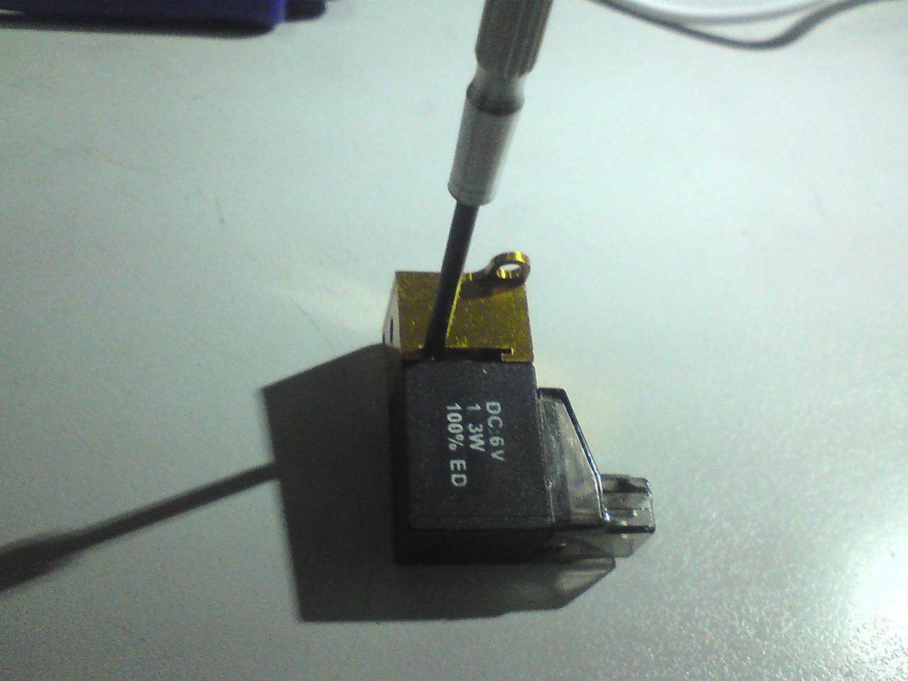

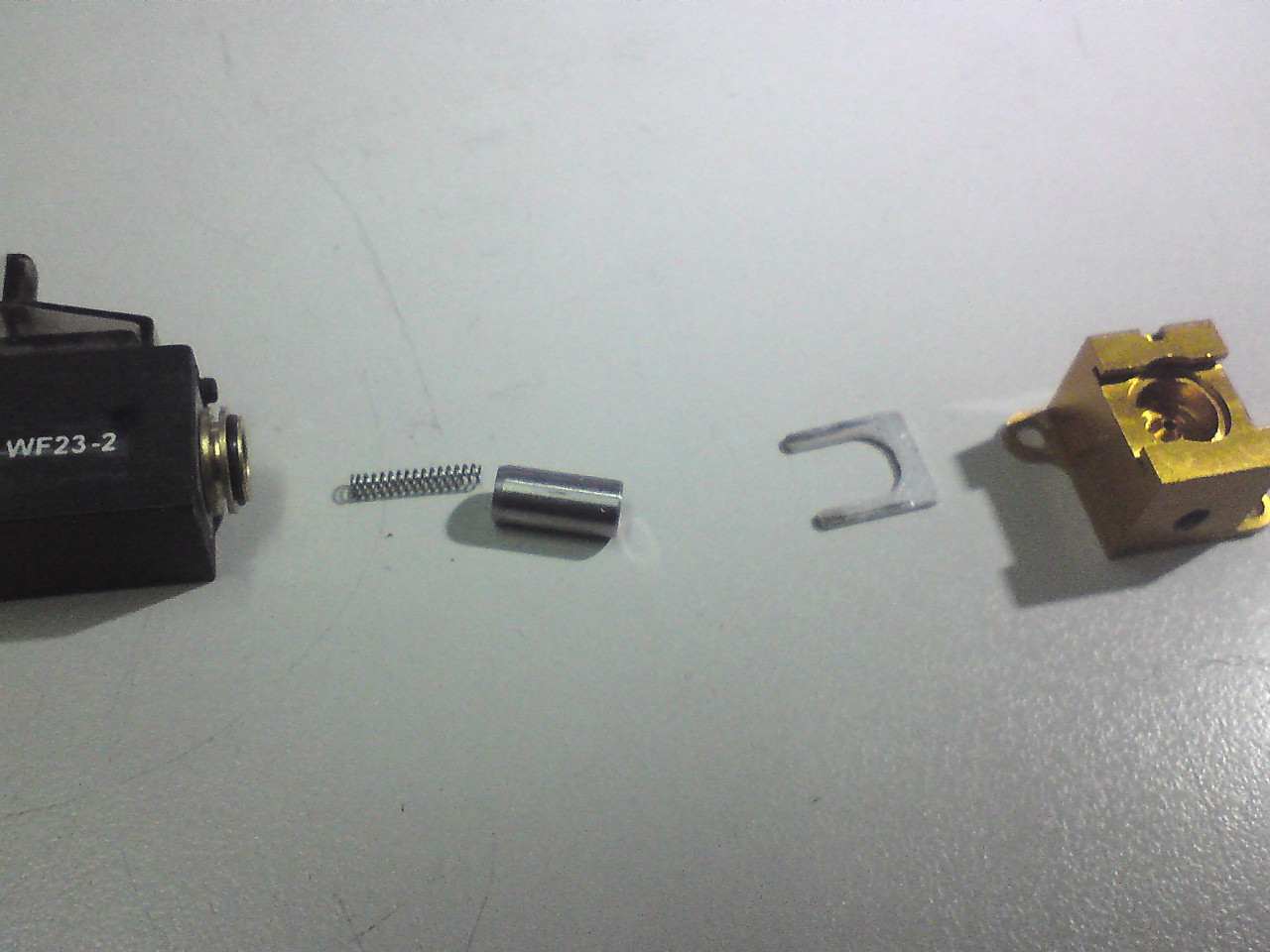

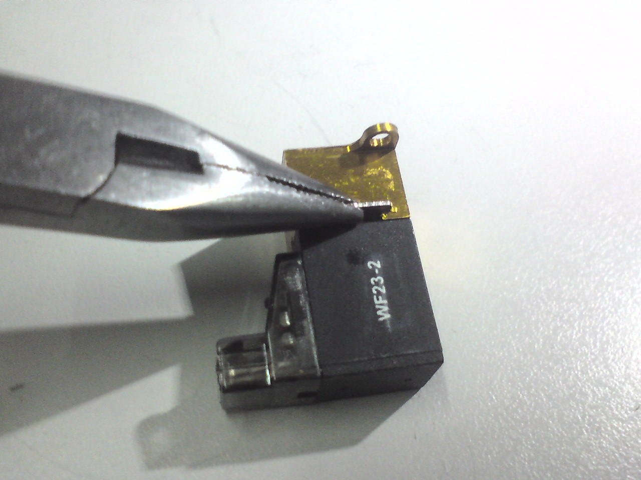

About the solenoid Icalled Joseph directly on his mobile and he was so kind to provide me with disassembly info and pictures to look for anything that could have gotten the valve stuck.
So Idisassembled the valve and found nothing wrong. Running a resistance test showed an open circuit and, since I was not into disassembling the tiny electronic part of the valve while it's on warranty, Ijust mailed it back to Joseph. He returned it within 2 days and said there was a problem with the internal power lead connection. These valves are the original solenoids supplied directly by Xicoy by the way.
Now that the initial issues have been straightened out, the engine seems just perfect under all points of view and Ican't wait to mount it in the airframe when Iget back to europe in April. It's gonna be aFeibao Velox XL thunderbirds scheme
Attached are the pictures Joseph sent me while I was troubleshooting the gas valve.
