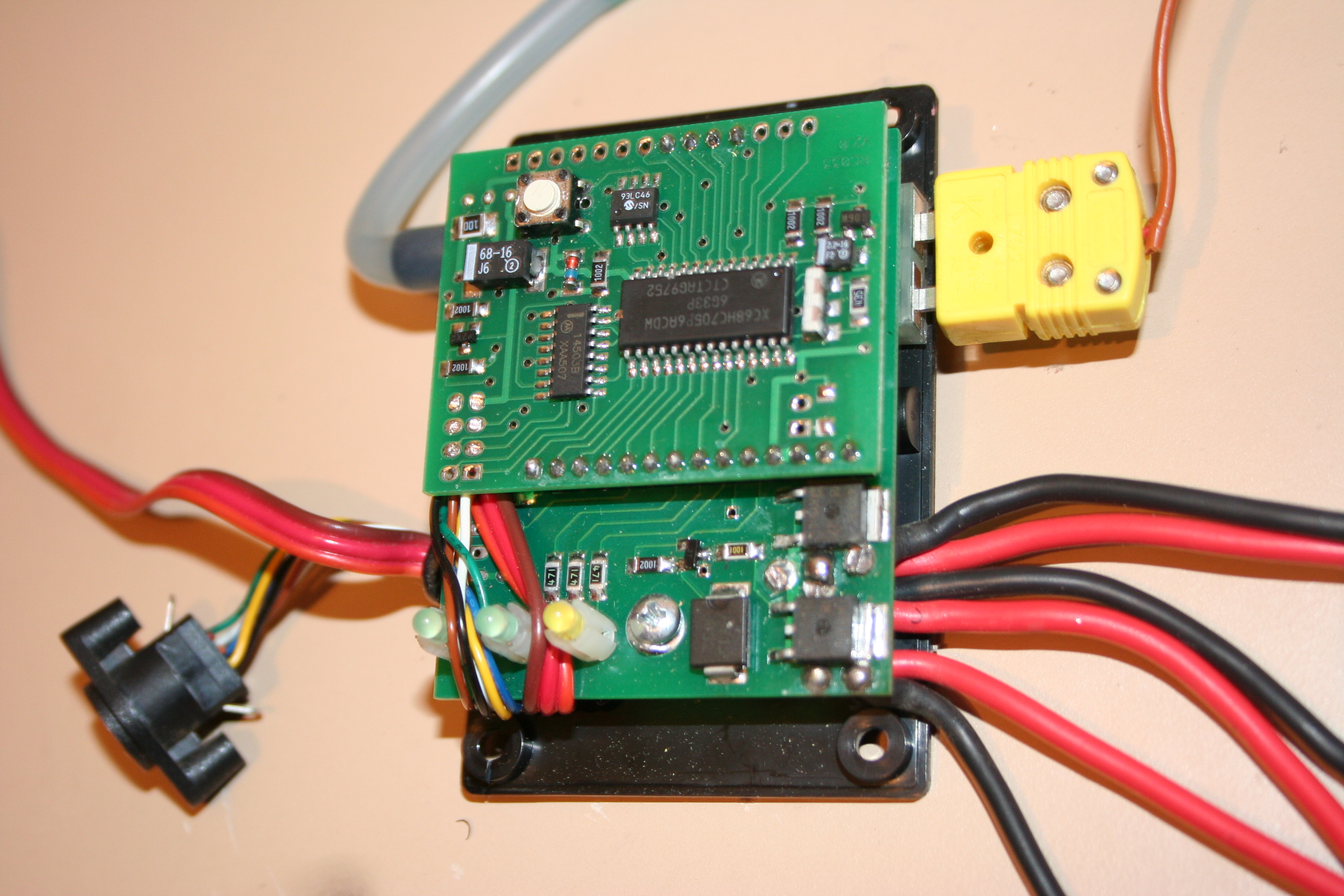

you mean open up the ecu to see which ones they are connected too. Will post tomorrow. I know what you are thinking. I ctually opened it up myself to make sure I was connecting the right ones as it was hard to tell just soring them on the outside of the ecu

I you can do that it will help, the reason I ask about possible incorrect connections is that the when you press the ignition button, the only part that's energized are the glow plug terminals, once that is verified as correct, I will tell you how you can test everything is working properly without risk of fire

not sure if this shot will help, let me know if i need a different angle or anything, the first 2 on top are to the fuel pump the second 2 the battery the lat 2 the glow. this is what it says in the manual also. can you see anything rong?

I compared to an ECU I have on hand, from your angle, the two at the top should be the the glow plug, and should have the positive with a "Blue" sermos terminal, the second pair going down should be the battery and the third pair should be the pump with a "yellow" sermos connector
Is this what you have??

I also noted that internally, both ECU's are a bit different.....

I removed the sermos connectors so couldnt tell for sure. But the first 2 i have connected to the fuel pump. This is what it has in the manual I got. Looks like that is the reason though. I will swap them around and see how I go. Thanks heaps for your help. Strange though that the manual has them the other way around!!!

first, do not connect the pump, just the glow plug, remove glow plug from turbine and connect the boot and ground to thre glow plug while holding in your hand, turn everything on and press the ignition button, see if the glow plug lights up....

Everyone I have used worked fine, even the 4 stroke ones, but it is said that the best are the McCoy #9's...
On another note, make sure your cable pairs are always together on the ECU connections, the"common" are actually the positive terminals, so, you cannot swap your black cables, or you'll have trouble....

well i think you have solved it. Just turned it on hit the start, glow lit up for 30 secs then display read timed ot and glow went off. The manual is definately wrong then or I was given a different manual online. Knew it wouldnt be anything too major. Thanks again
