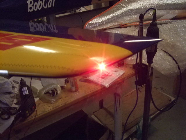

Some pictures of my installation of position-lights(Beacon Mini) on the left wing!

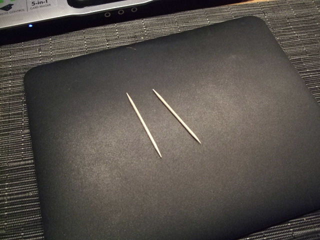

Even the "toothpick" came with the kit!
