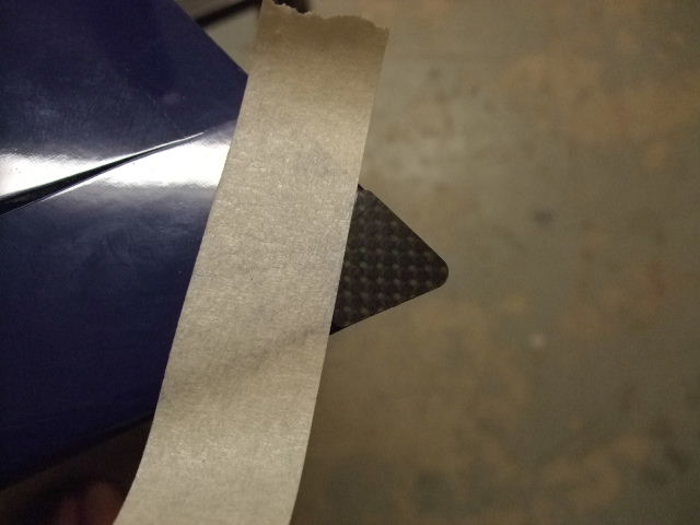

Mounting Bvm skidz (stab tip) on the wings.

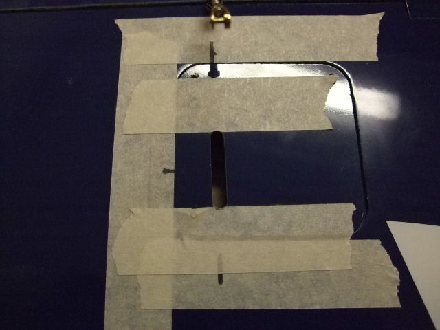

Lasse, do you have a problem with the flap inside chord edge to boom clearance ?
Old 02-20-2009 | 06:28 PM
  #115
Lasse Palm's Avatar
Joined: Dec 2003

I'll be interested how you adjust the clearance, maybe I can copy your technique.
I'm just too scared to go mad with a permagit block and screw it up.

Interesting that there is no mention of this problem (I have it to) in the manual, seems to be a design issue that has never been corrected [sm=confused.gif]

The flap rubbing is a bit of a pain. I had to take quite a lot of material off and seem to remember going almost completely through the composite skin to get enough clearance. I then reinforced that area with a bit of cyano and then a bit of aeropoxy.
I'm not sure there is an elegant solution. You just have to file/dremel it off.

I cut a V shape section along the joint line between the top and bottome skins. It was about an inch long. Seemed to be the easiest way to achieve it. I also had to take a permagrit file to the rear of the flap as that was a sticky fit when the flap was up.
