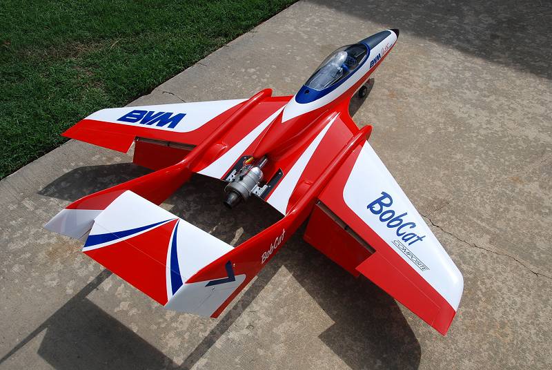

#161
Lasse,
I test flew my Bobcat last last week with a P70, i was cautious with my CG setting. Where is yours set and how do you did you find it to fly? and where did you put you ECU and receiver battery(s)?
#162
Joined: Dec 2004
Posts: 140
From: North Augusta,
SC
I'm am just a few days from my maiden flight and wanted to know if you would comment on the control throws of aileron, elevator, rudder? My setup is as follows:
elevator: 2" up / 1.5" down
aileron: 1" up / 3/4" down
rudder: 1" in - 1.5" outboard
I don't have the original manual since I purchased mycomposite BCused, but found the above numbers on the BVM website.
I have added about 15-20% expo to each of the above just because that is how I set upmost of my aircraft.
My first flights will be from a grass runway. How do you feel about using 1/2 flaps for takeoff? I have found on this forum that some required up trim when using flaps, while others have required down trim. I find that odd. Any comments?
Did you use full flaps on your first landing?
What about flight times? Iran my RAM 500equipped BC with full tanks and got about 6 1/2 minutes (at full throttle) before pulling from the UAT. I thought about setting my maiden flight at 5 minutes to be on the safe side.
Center of gravity: is that measured with landing gear up or down?
John

#163
Edited - Sorry, I was being repetitive. 1/2 flaps for takeoff are fine for me, but a little up elevator was required for 1/2 flaps slightly more with full flaps and gear down.
On my P-80, it uses 8oz/minute and I have a UAT, center hopper tank, and 2 saddle tanks. This gives me between 6-8 minutes depending on how I use the throttle. This also allows for a few fly-by's incase I don't like the approach.
Hope this helps!</p>

#168
I check the CG with gear down and the UAT full of kero, but all other tanks EMPTY. I'm using A123's all through the plane. 3-cell ECU in the nose and 2 2-cell Rx packs velcroed to the side of the fuse in the rear of the plane. Much room for adjustments of CG when I have more time to mess around with it.
I'm going to be painting soon and want to compensate for the tailweight the new colors will end up adding.

Jimmy,
Thanks for the tips. I did my maiden last weekend without incident. Used the recommended throws issued by BVM but found the elevator a bit touchy at high speed. Switched to low rate (about 20% less throw) and have left it there for all flight modes.
I used 1/2 flaps on takeoff and full for landing. About 3/8" uptrimprogrammed for half flapsand1/2" forfull flaps. My CG is per the instructions (on the fuselage holes) but plan to move it back soon.
My field is grass and a bit rough in spots. Made 5 successful flights on Saturday but broke two flex plates the following day. Need to work on my landings! I'm using the stock BVM retracts and Duro struts. Have a set of Pro Links on order to replace the mains and hope that will help.
I'm considering a engine upgrade since the RAM 500 takes longer to get to altitude (at take off) than I like. I'm considering the P70 or 80, but a bit confused at the $300 price difference in the two and would expect the larger turbine to cost more. Any comments?
John

#170
Congratulations!!! Yes, I also broke a couple flex plates on the first couple flights. I really needed to learn to let the plane settle onto the mains. I had a tendency to fly it onto the nose wheel. Now, I just let her glide in at pretty much idle once I'm about 30 feet from the end of the runway. She settles beautifully.
I ended up adding a lot of expo to the surfaces, but kept the elevator throws so that I could do some more aerobatics, but I know what you mean about the touchiness. In the beginning, someone asked if my aileron servos were twitchy because the plane was rocking back and forth at speed. I kinda laughed and told him, no - my hands had been shaking the whole time!!
I don't know the reason for the cheaper price on the P80-SE, but I have my older P80 dialed up to the max which is about 21 pounds of thrust. The new SE seems to have that and a machined compressor wheel for faster response. I would definitely get the most engine for your dollar there! I'm almost at a 1:1 thrust with my jet and I really enjoy its performance!
Once again, great job on the maiden, and your color scheme is awesome. Very bright! Mine gets its paint this week. Wish me luck!

ORIGINAL: Lasse Palm
Cockpit and Canopy
I make my own Cockpit/Clear canopy!!
Cockpit and Canopy
Lasse
I really like the detailed Cockpit on your Bobcat. Can you tell me where I can get the plastic instrument panels from ???
Paul
#173
Joined: Dec 2003
Posts: 602
From: Stockholm, SWEDEN
Hello Paul!
I used the cockpit interior from Nauwa models in Sweden, they made ​​these cockpit accessories!
But!!
The company does not exist anymore..Sorry![&o]
Regards
Lasse Palm
