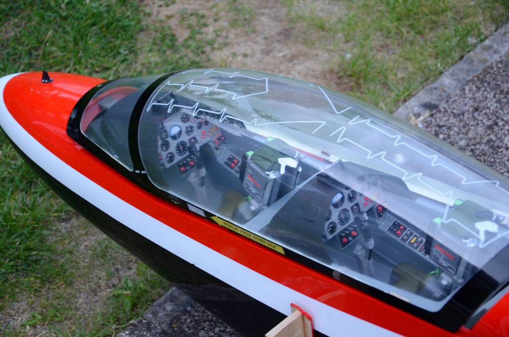

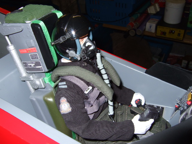

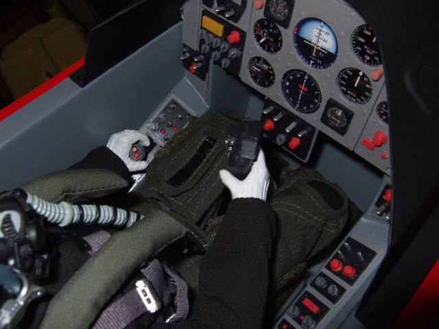

When I first flew my Carf Hawk last year I had a few bumpy landings to start with even on atarmac runway but it never dropped a wing on approach.
Over the winter months I made some changes including movingthe CG back as It was dropping its nose a bit in banked turns and needed a lot of down elevator to fly inverted.
I have a scale cockpit (skymaster) and 1/5th pilot and the canopy /frame interior and pilot weigh 1 kilo so I have notneeded any nose weight never the less I have moved one of my rx packs (2 cell 3600 lipo) back from next to the nose legg to just in front of the tank bulhead (about 600mm 24 inches) I have also mixed in a small amount of crow (6 mm at inside line of aileron) with full flap and this has helped no end on landing approach.
The advantage as far as I see it is that with a small amount of crow you have in effect washout, so this will prolong any tip stalling at low speed.
With the outer wing (aileron section) now at a negative attitude compared to the main wing the sink rate is greater and much more like my Flash to land.
Bouncy landings are really becausewe tend toland too fast andthe plane wants to carry on flying, With crow on the Hawk once she is down she sticks so I am very pleased with this

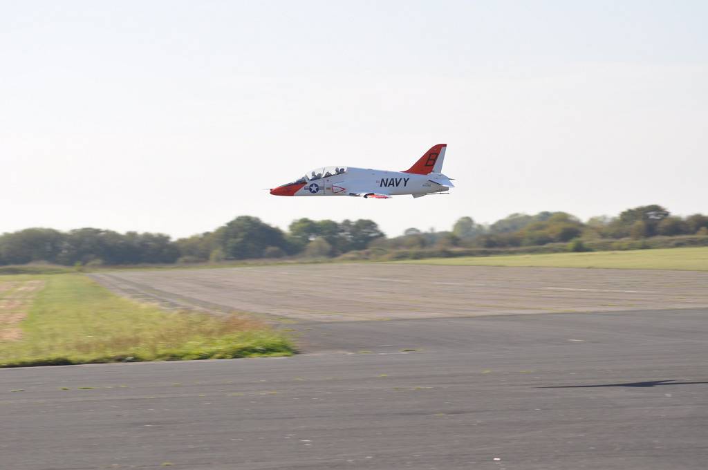

Old 10-05-2011 | 06:13 AM
  #669
Joined: May 2008
Posts: 89
Received 2 Likes on 1 Post
From: Foxham, UNITED KINGDOM
Default RE: Comp ARF BAE Hawk build thread

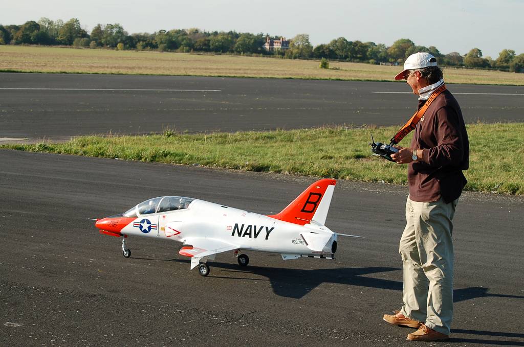

Hi all, another Carf Hawk in the air, kindly maidened by DW at Abingdon. I'd incorporated pretty much all the suggestions and set up through the build thread and she flys like a dream. I'm really pleased, its an excellent model.
ps had to upload the picture of DW using my MPX TX..................he did give a wry smile though!

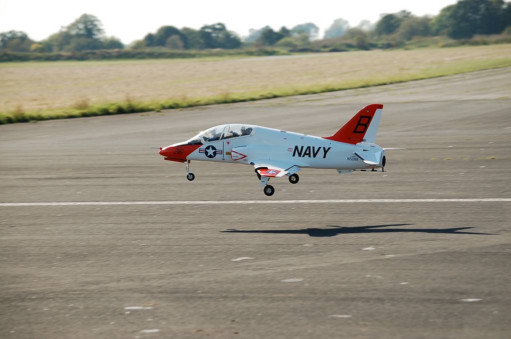

David
Always good to chalk down another Tx type...makes me realise again and again how great my DSX-12 is
More pics take of the maiden flight taken by Little Stevie
Great model, worked perfectly and just needs a set of my wing flap carriers to look perfect

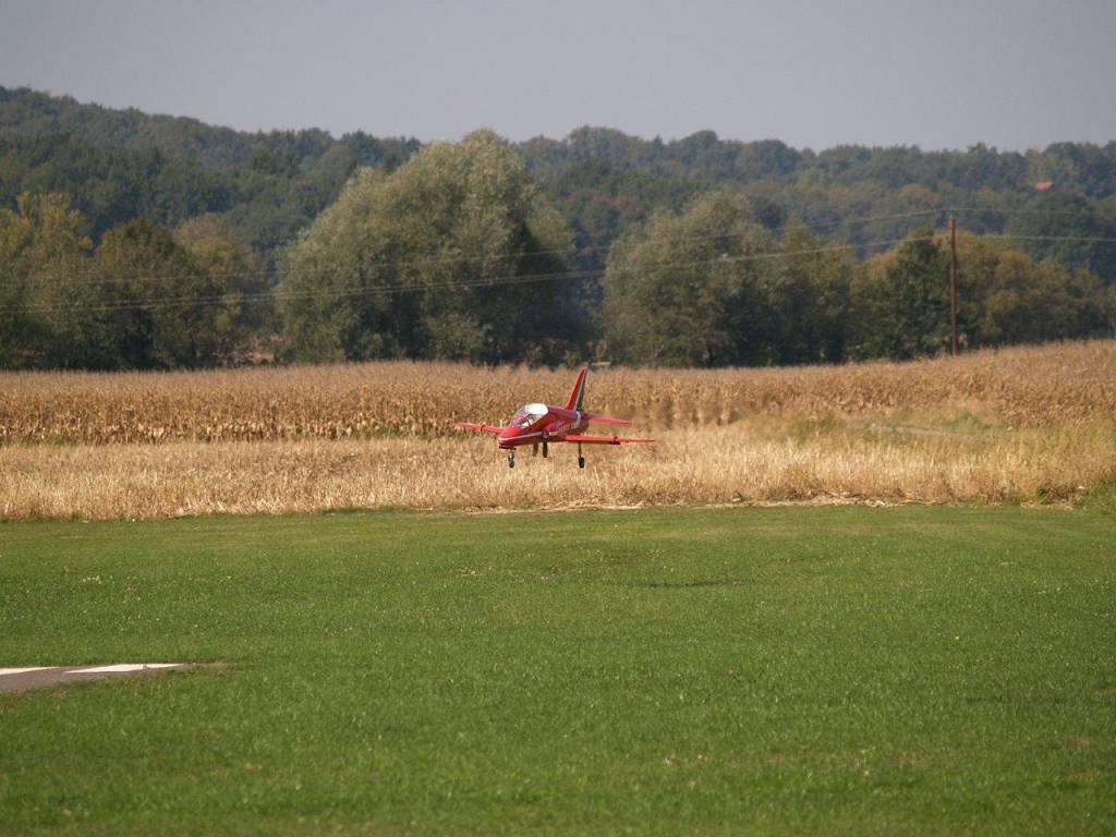

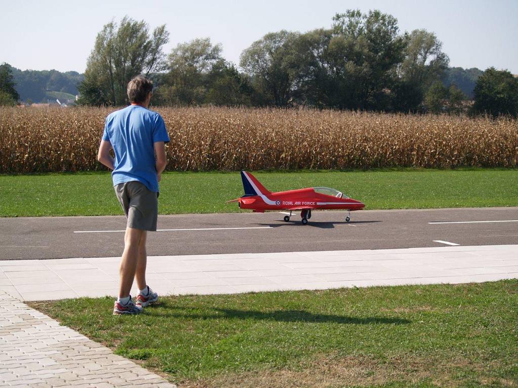

Old 10-08-2011 | 12:58 PM
  #672
Joined: Aug 2007
Posts: 1
From: hitzendorf, FL
Hello!
Mine flew tthis week too!
All settings as written here so many times!
A real superb model plane!

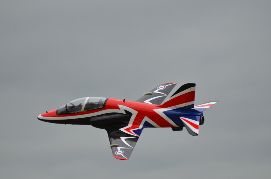

Congratulations!
They do fly good!
They look even better when you get the cock pit detail and pilot in
Alan

That does look good! What cockpit and pilot is that?
Mike
Old 10-08-2011 | 11:35 PM
  #675
fireblade5437's Avatar
Joined: Dec 2005
Posts: 974
From: Leicester, UNITED KINGDOM
Mike
The cock pit was from Der Jet through Motors and Rotors and the pilot was done through Phil at fighteraces UK, had the suit changed to black to match the 2010 Display Hawk both not cheap but if you are going to spend on CARF Hawk anyway you might as well finish off properly
They do transform the glass area.
Alan
