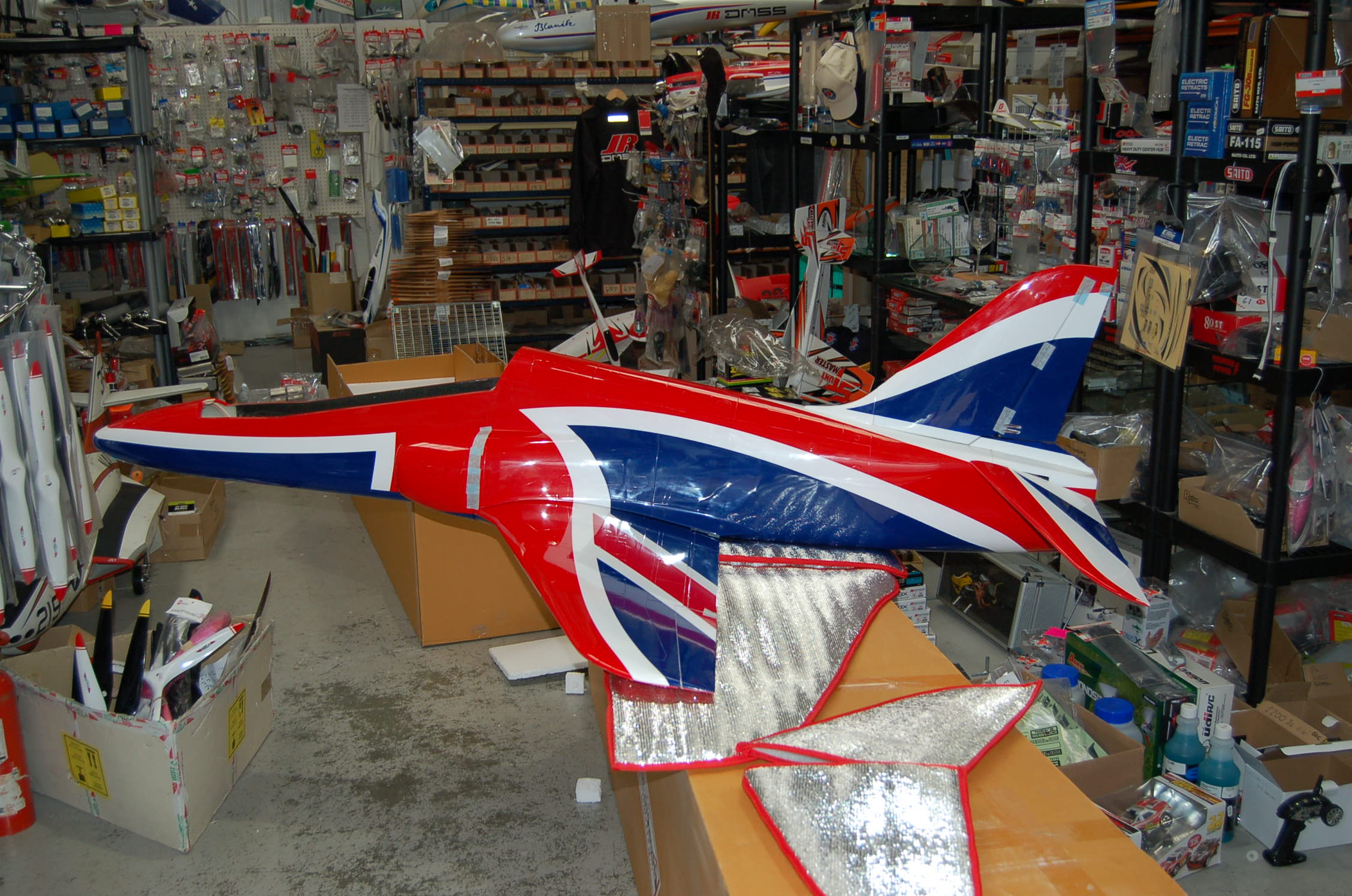

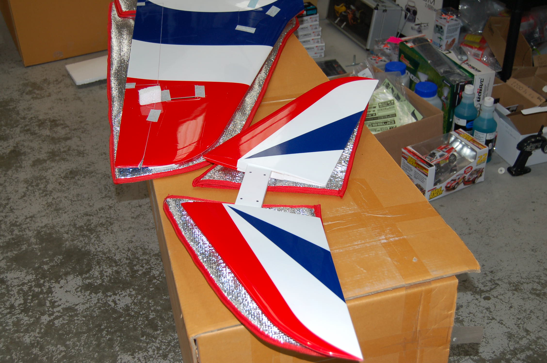

Bob
You should have told us how you did the covers! Especially whilst I was re-painting the Hawk
Got any pics of what you did?

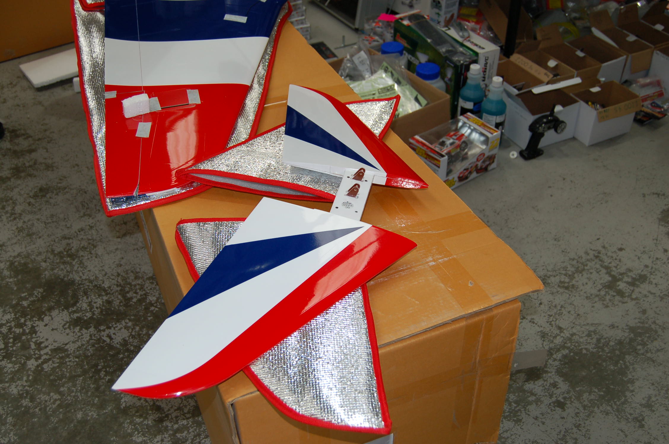

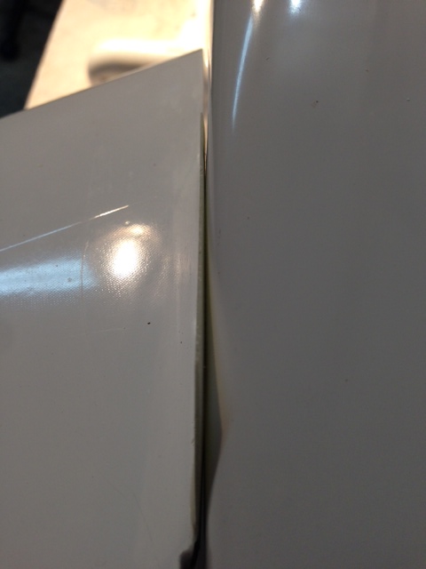

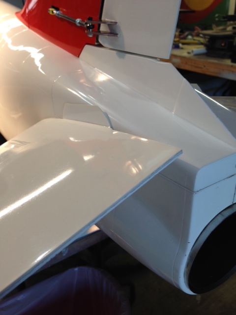

Bob
i was thinking of cutting the covers flat so that i can glue them flush with the elevator edges ( with hysol)
wouls that not be the same as what you did without cutting into the elevators
mine is all white so i will paint it all at once
would grey paint work instead of the aliminium tape ? or does the tape stay on ?
Alan
how did you do your APU ?

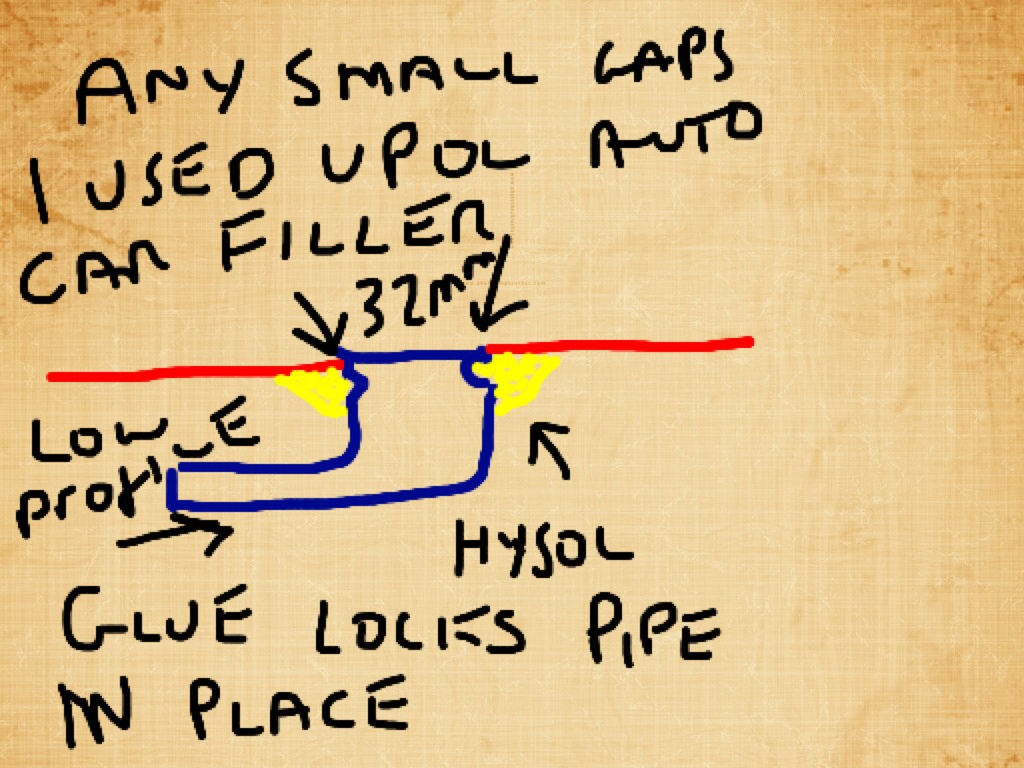

Izzy
I used a water waste pipe fitting which was 90degree right bend, now this particular right hand elbow/bend which I use was also perfect as it was a low profile one so the bottom of the bend was flat.
The diameter of the fitting is 1 1/4" or 32mm (31.75mm) I brought the fitting from B&Q (Home Depot in US) same type of store
I would try and get one for you but cannot get out at the moment :-(
I will sketch you a pic and post how I glued in with Hysol, don't forget water pipe fittings are PVC and Hysol will not attach to PVC even if you rough it up. So I created a fillet around the fitting and glued directly to body of aircraft, came out perfect and looks exactly like 1:1 scale
The holsol fillet 'locks' the fitting to the fibreglass body.
Alan

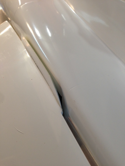

Looking for help.
I have aquired a rebuildable air frame. The wings have the gear out of them, but have found from another RCU user that has provided me, templates for the gear plates.
I am hoping that someone has templates for the nose gear section, that needs reconstruction.
Clay

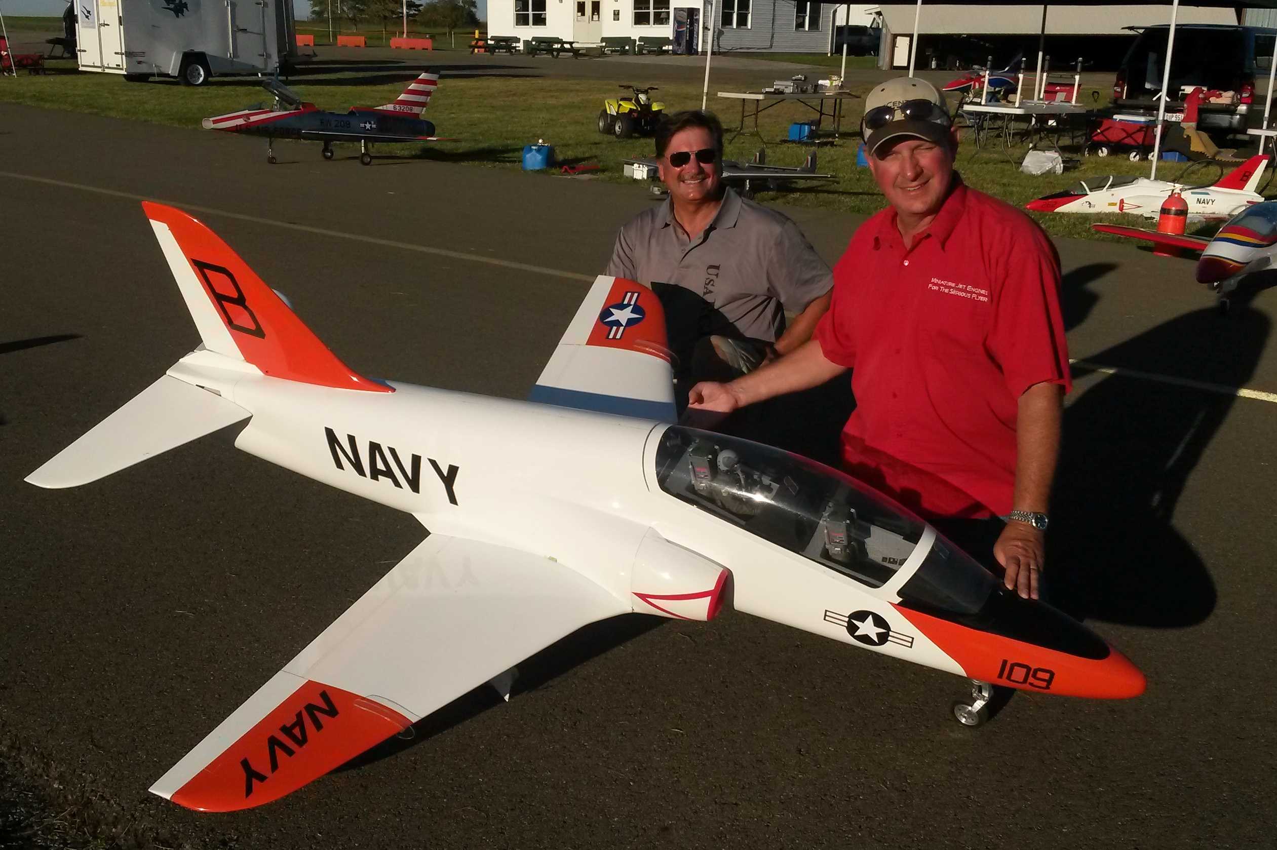

Well we can add another flying hawk to the list, my rebuild Hawk was test flow By Jim Hiller yesterday, he gave it a clean bill of health!
C.G. and throws were according to the manual, I also added crow with flap deployment.
The before photos are on post #733 in this thread.

  #1913
rhklenke's Avatar
My Feedback: (24)
Joined: Jun 2002
Posts: 6,005
Received 34 Likes on 21 Posts
From: Richmond, VA
Congrats Rich! Another successful resurrection!
Crow seems to make a big difference in how the model lands - much easier to get it in the "groove" for a soft touchdown with no bouncing...
Bob

Rich
Looks great, all that hard work and hours you did has certainly paid off!
How much crow did you dial in?
Alan

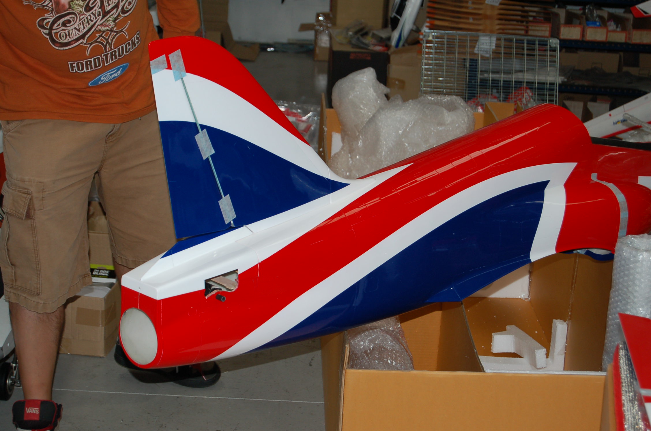

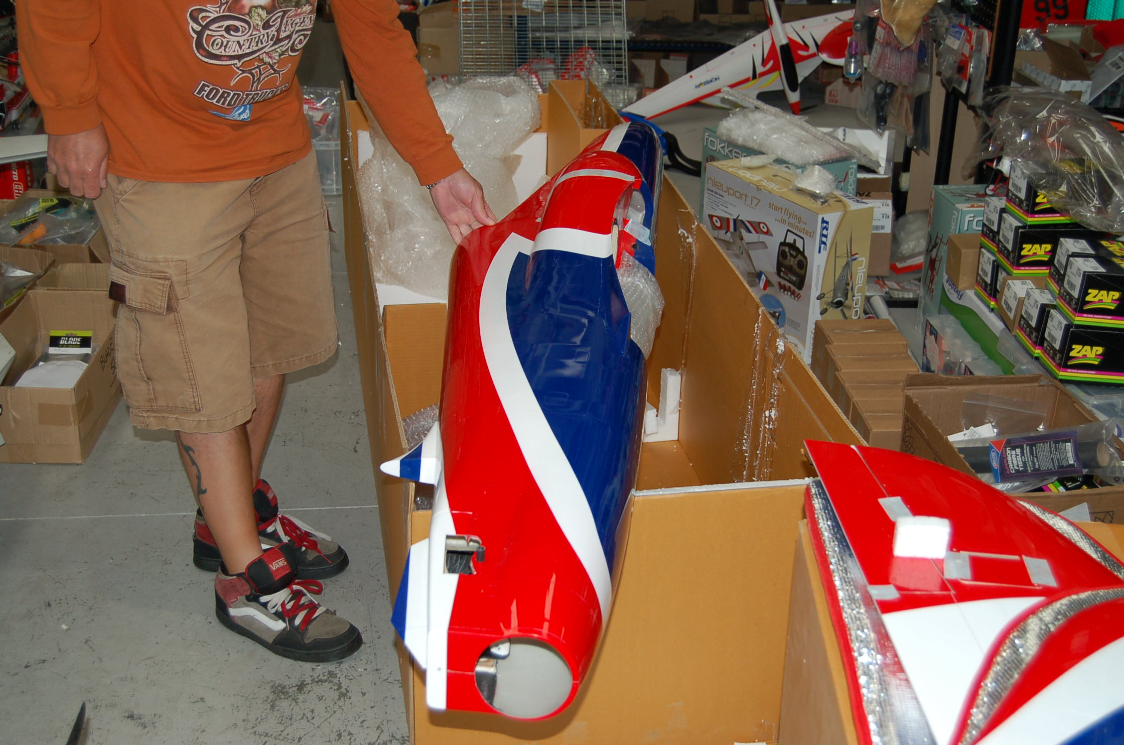

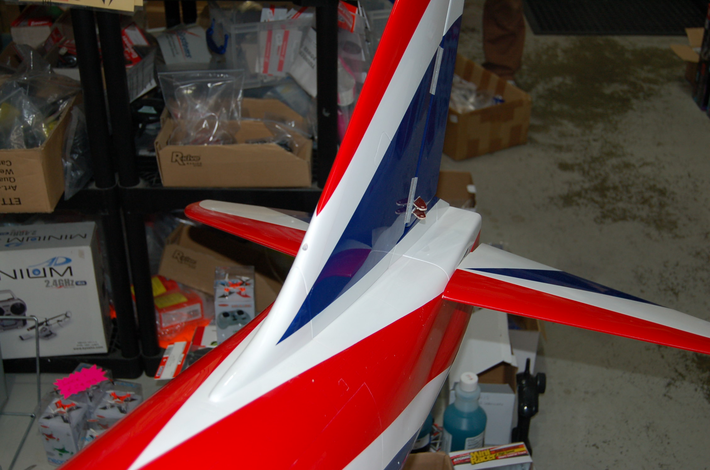

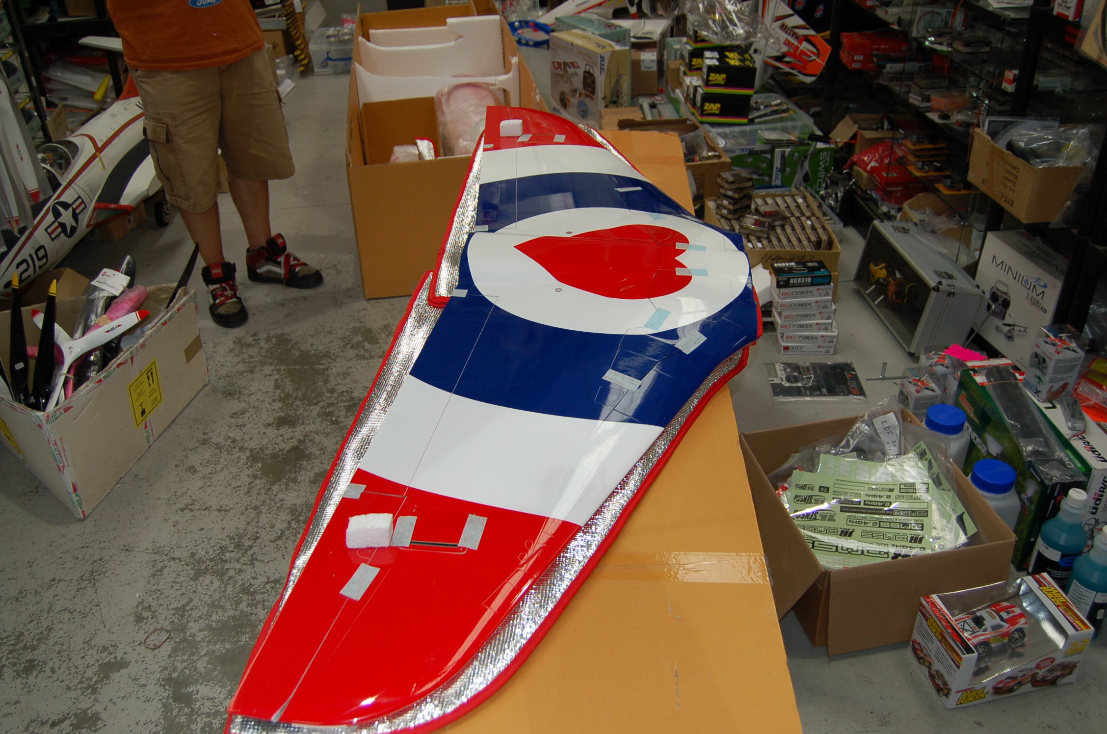

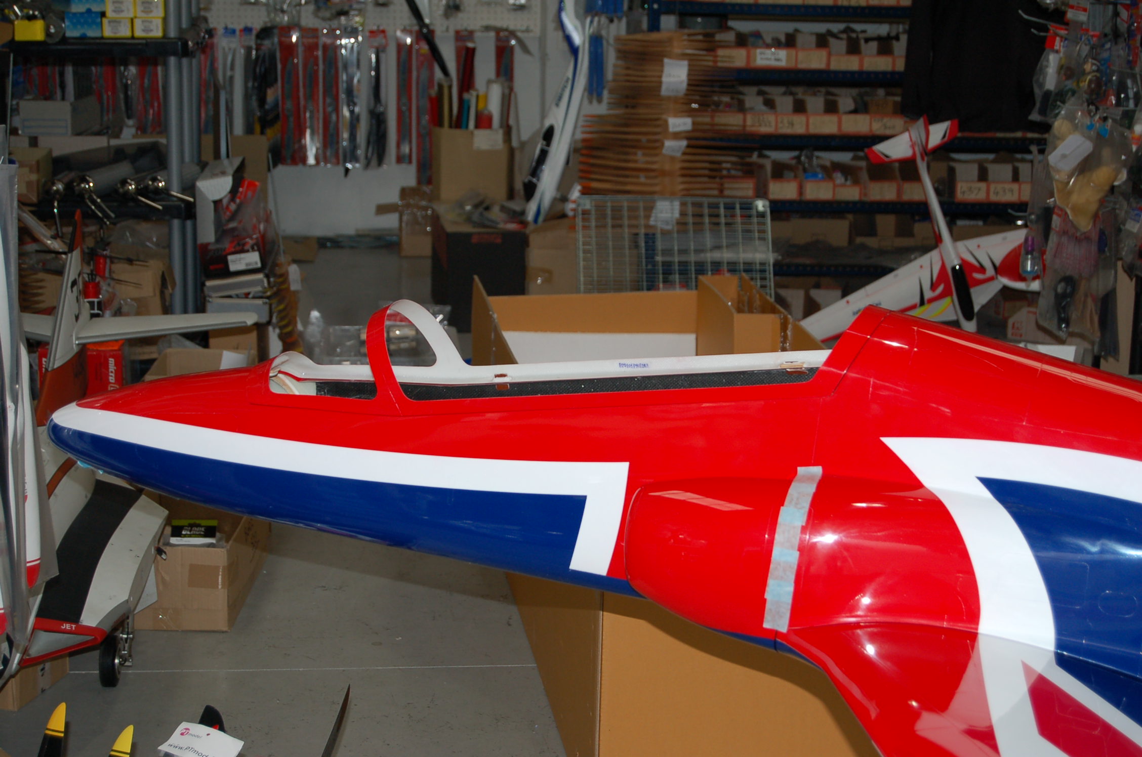

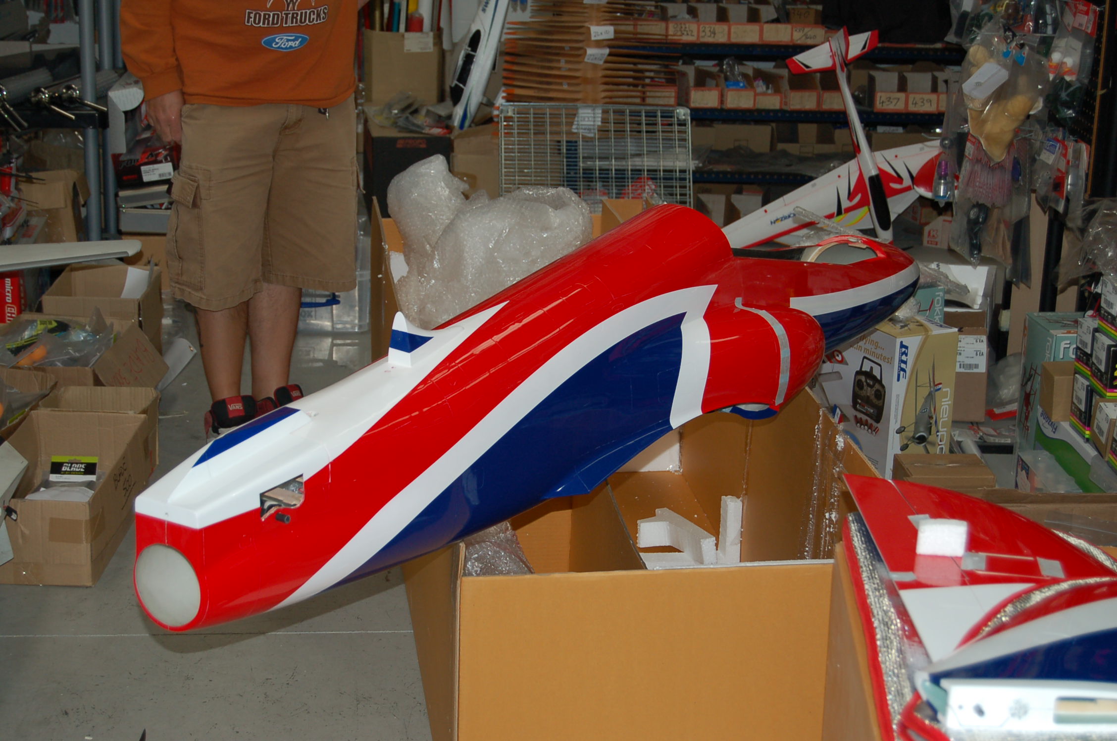

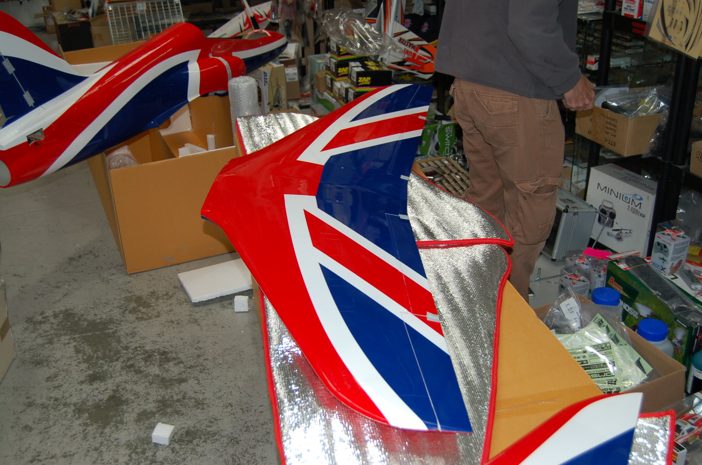

One of many models I collected at JP12 was this 2012 scheme Hawk. No had time to unpack it till now, but I'm mighty impressed with the scheme and paint work on this one.
P-140Rxi and probably new JR 28x going in this one

Looks good! How about fitting a cockpit this time?
Alan

Its not for me! Its a customers and I'm sure he will fit one...

Hello Alan,
The crow is between 4 to 5 mm, I also added the wing fences based on what I read on this thread (I made them out of clear polycarbonate) , Jim said it didn't exhibit any bad stall tenancies so I guessed they worked.
I did not put on the lower ventral fins yet as a T-45 did not have those, it seems that the lack of their presence didn't make much difference.
Not sure when i will get to fly again, our weather is getting ready to turn to the bad side!

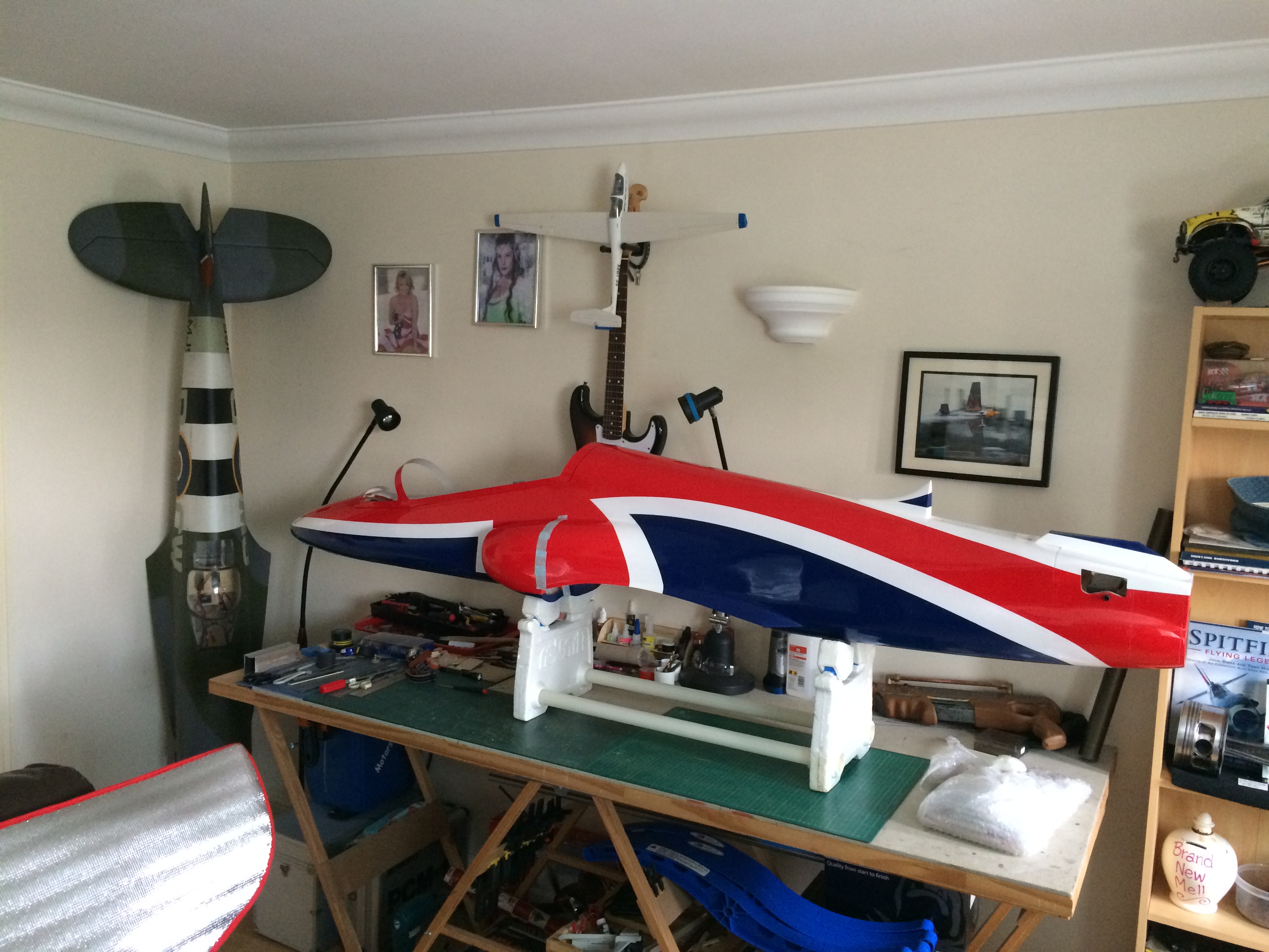

yea Dave will be cockpit, and pilot, looking forward to the build and maybe the new JR 28X,
it's on the bench ready to start..

Damn, I should have figured that after we paid them extra to do that scheme that they'd start selling it!
Oh well, at least that one is over in the UK...

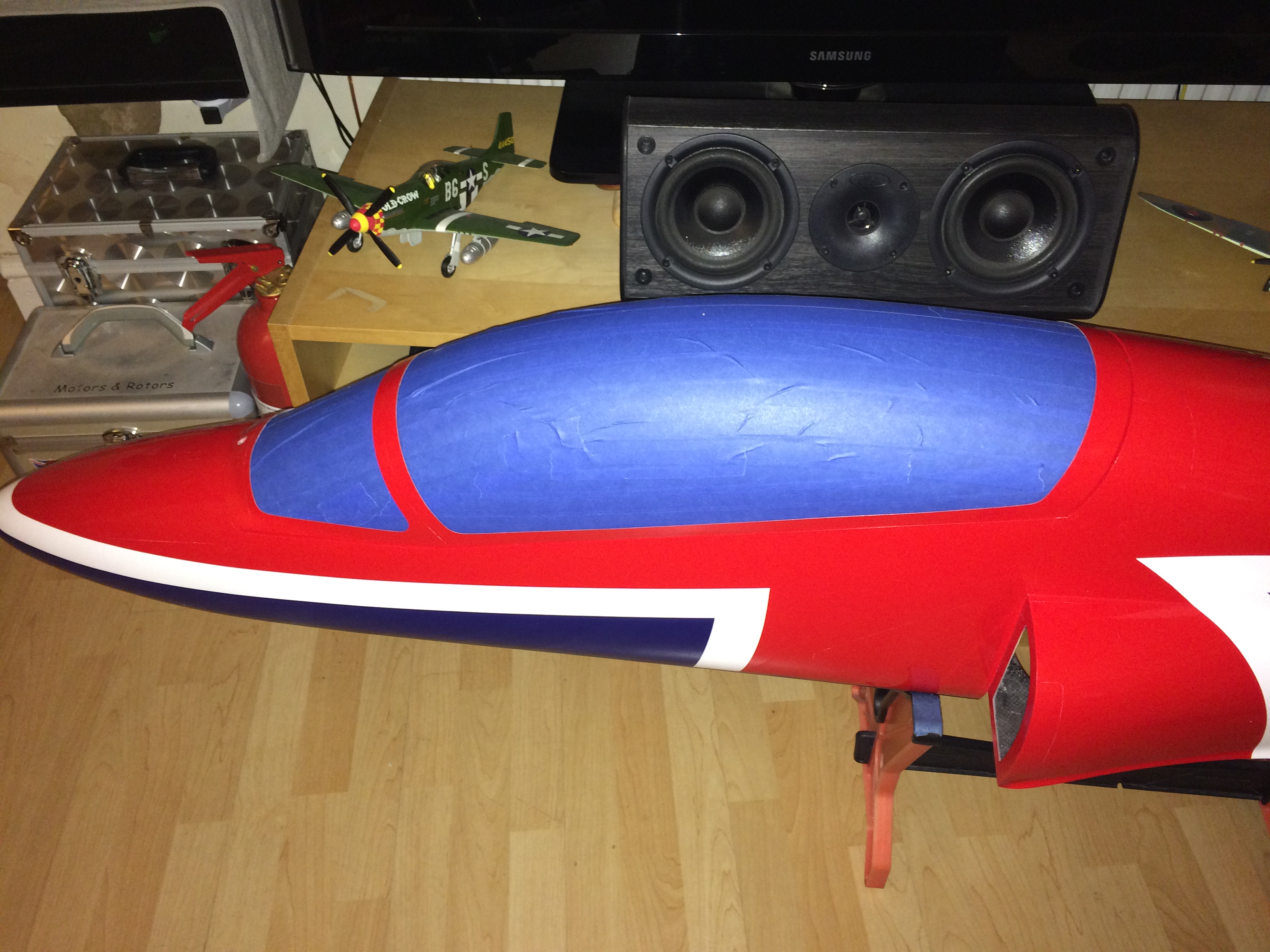

Joined: Mar 2008
Posts: 448
From: Aylesbury, UNITED KINGDOM

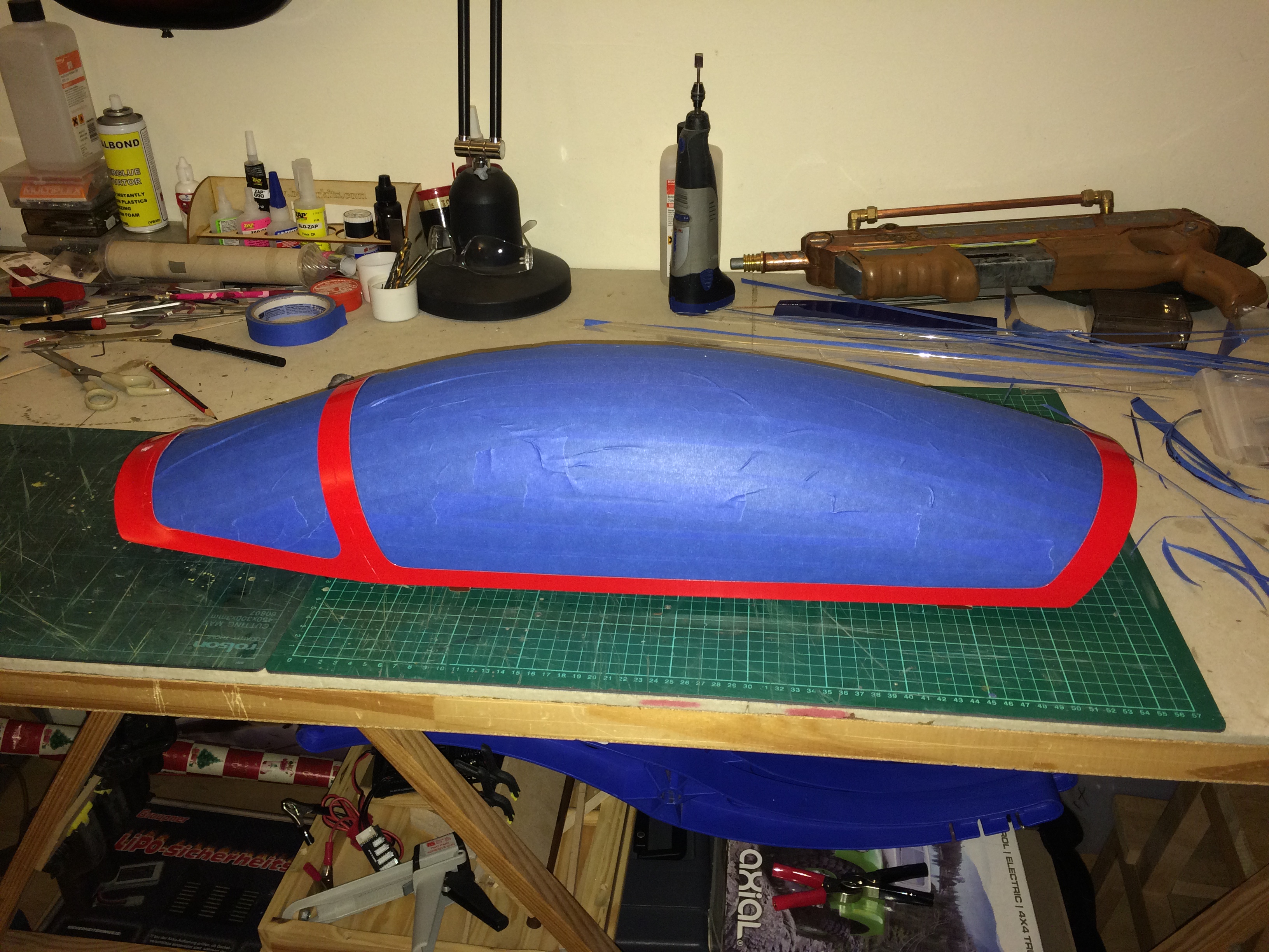

Canopy nearly done
ID:	2036374   Click image for larger version

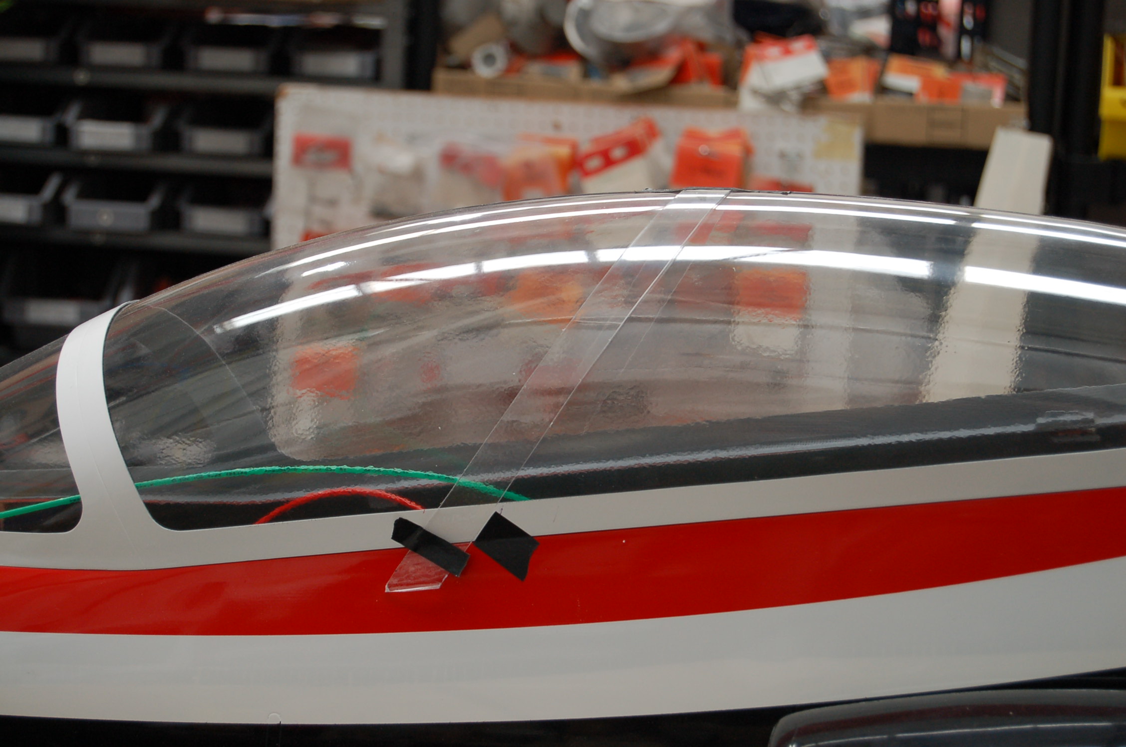

I've cut you out one of these....

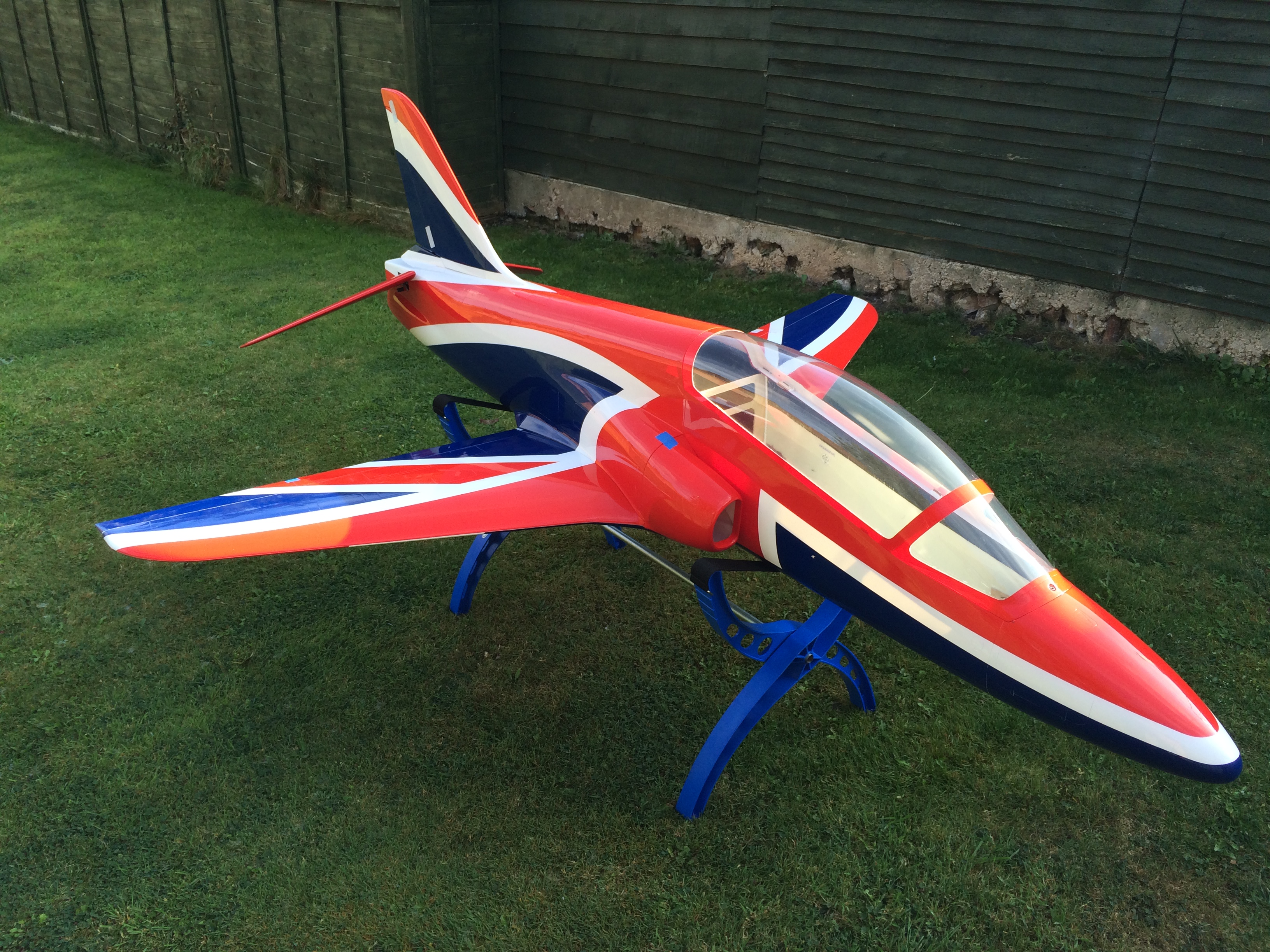

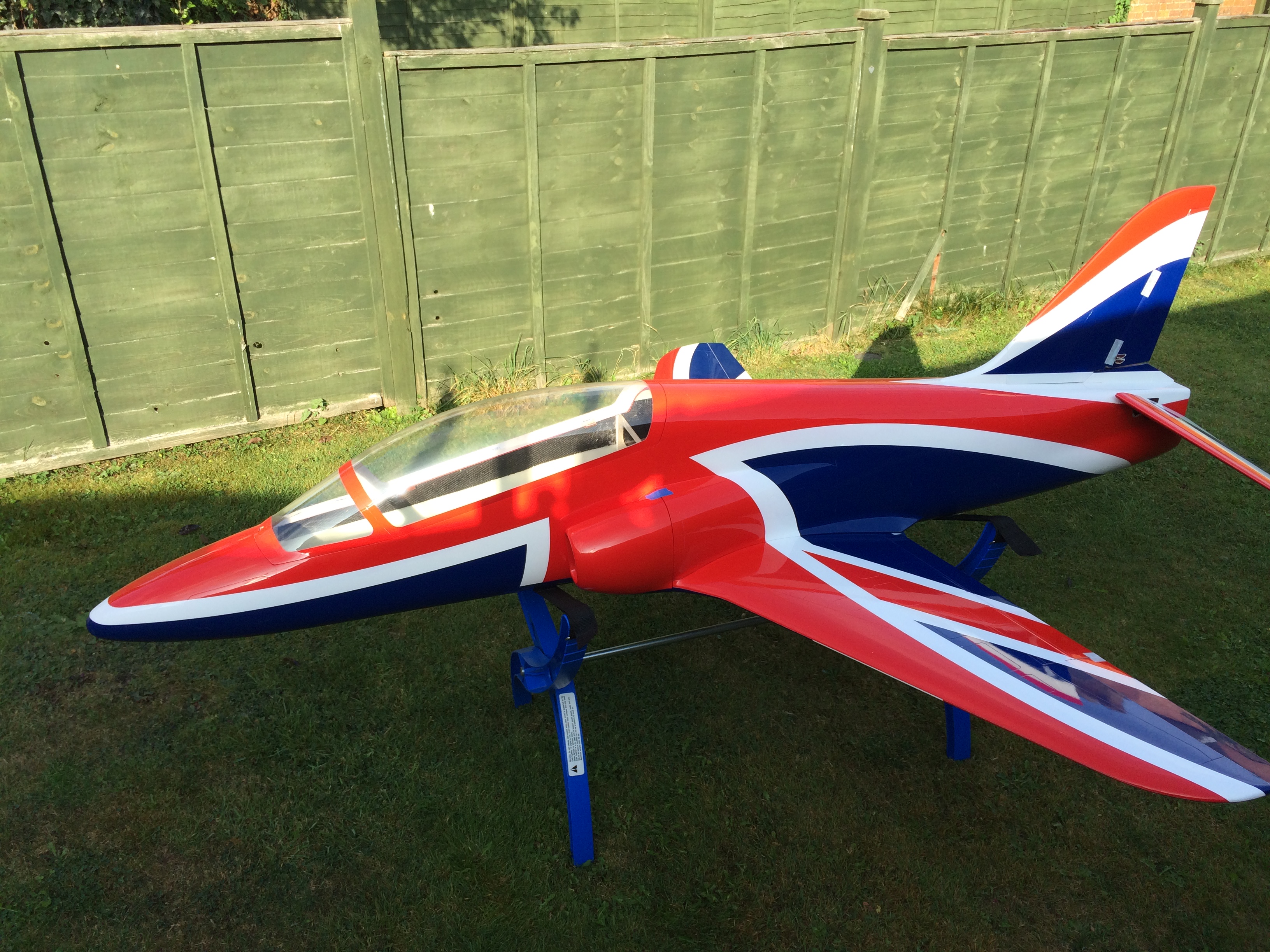

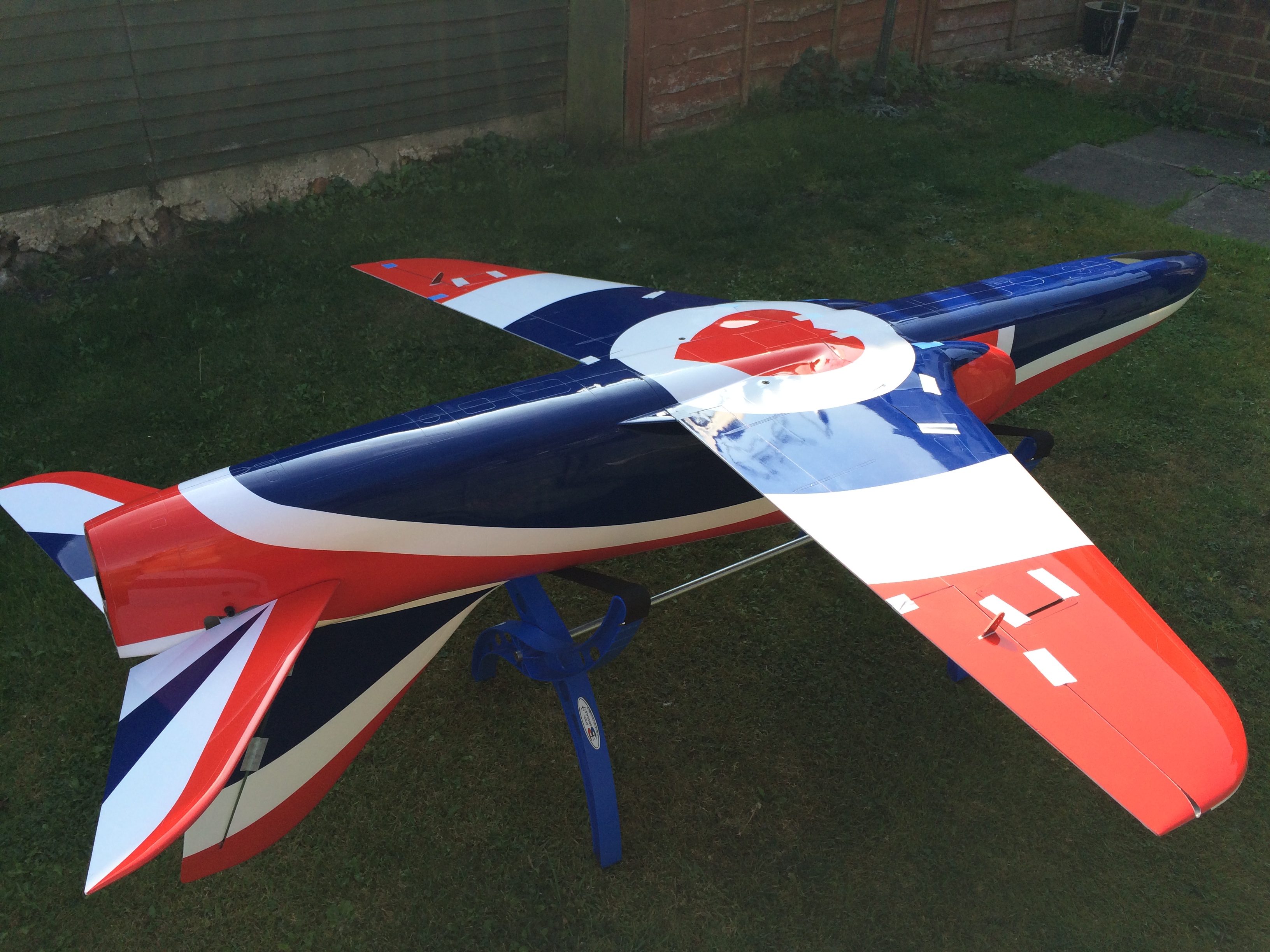

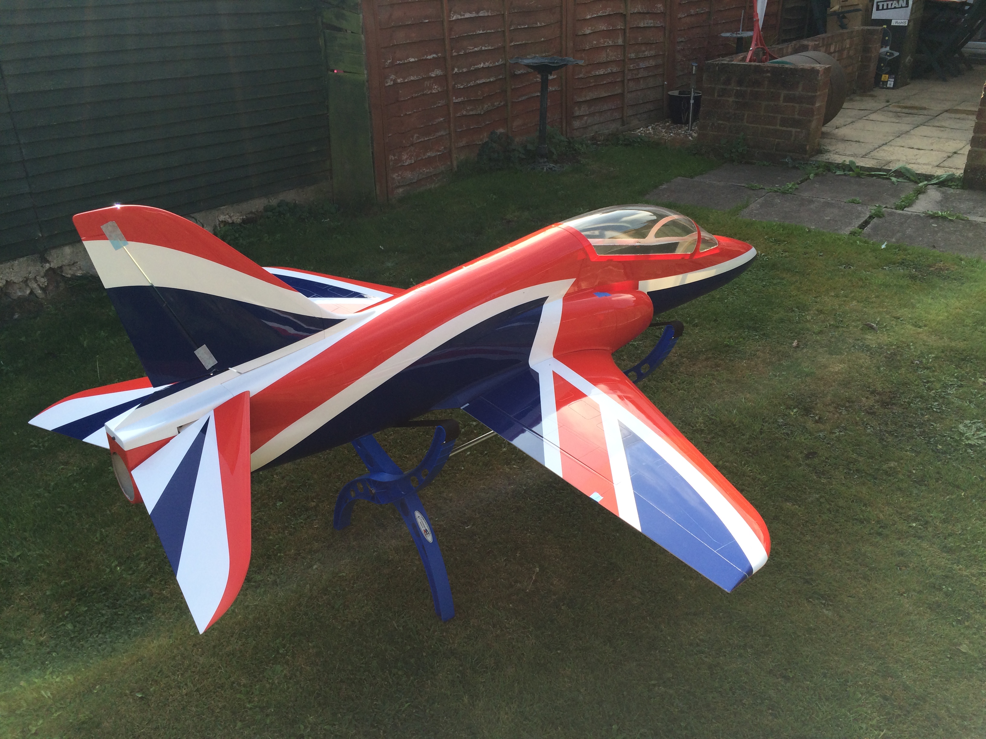

Old 10-03-2014 | 02:22 AM
  #1925

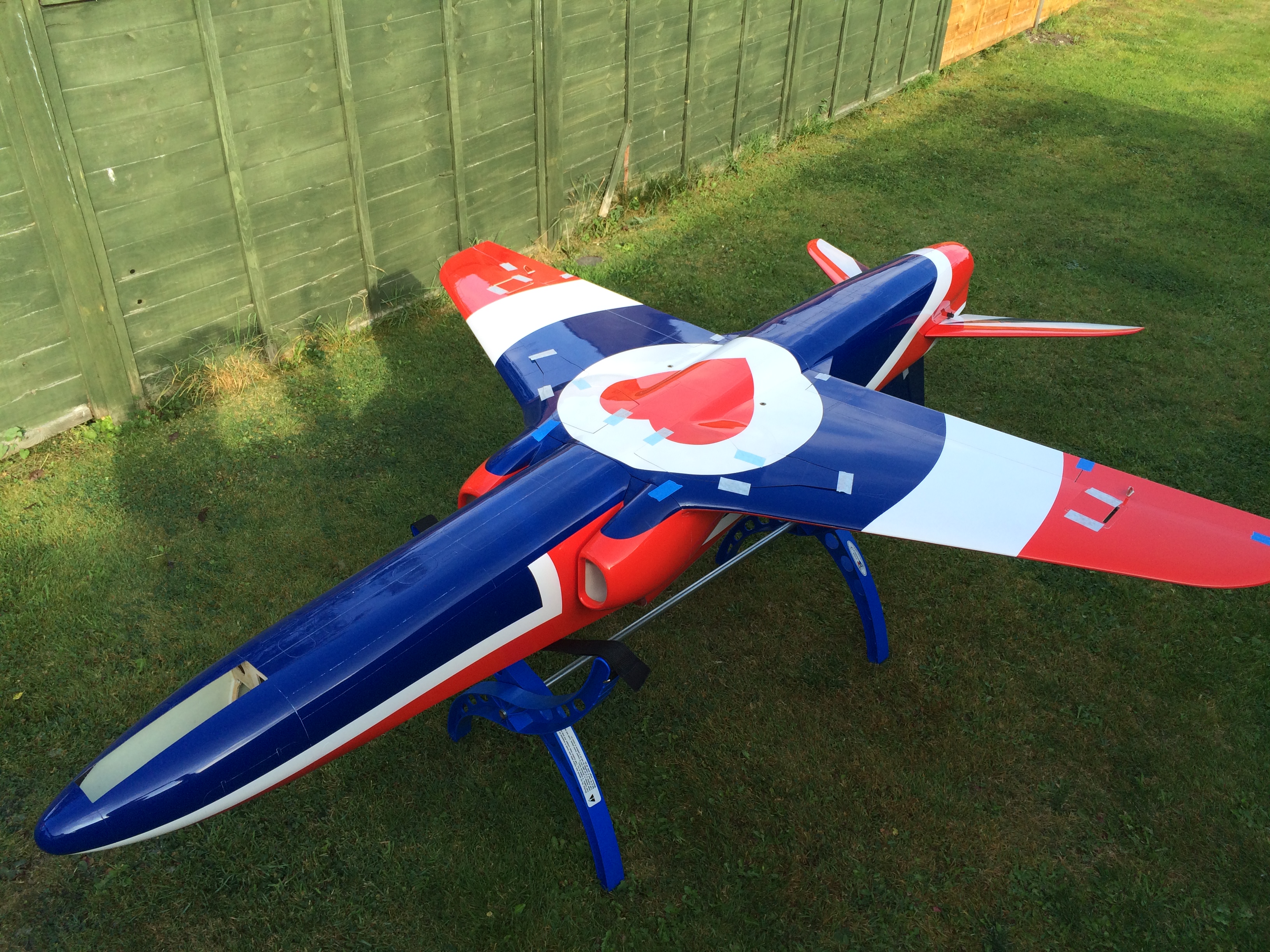

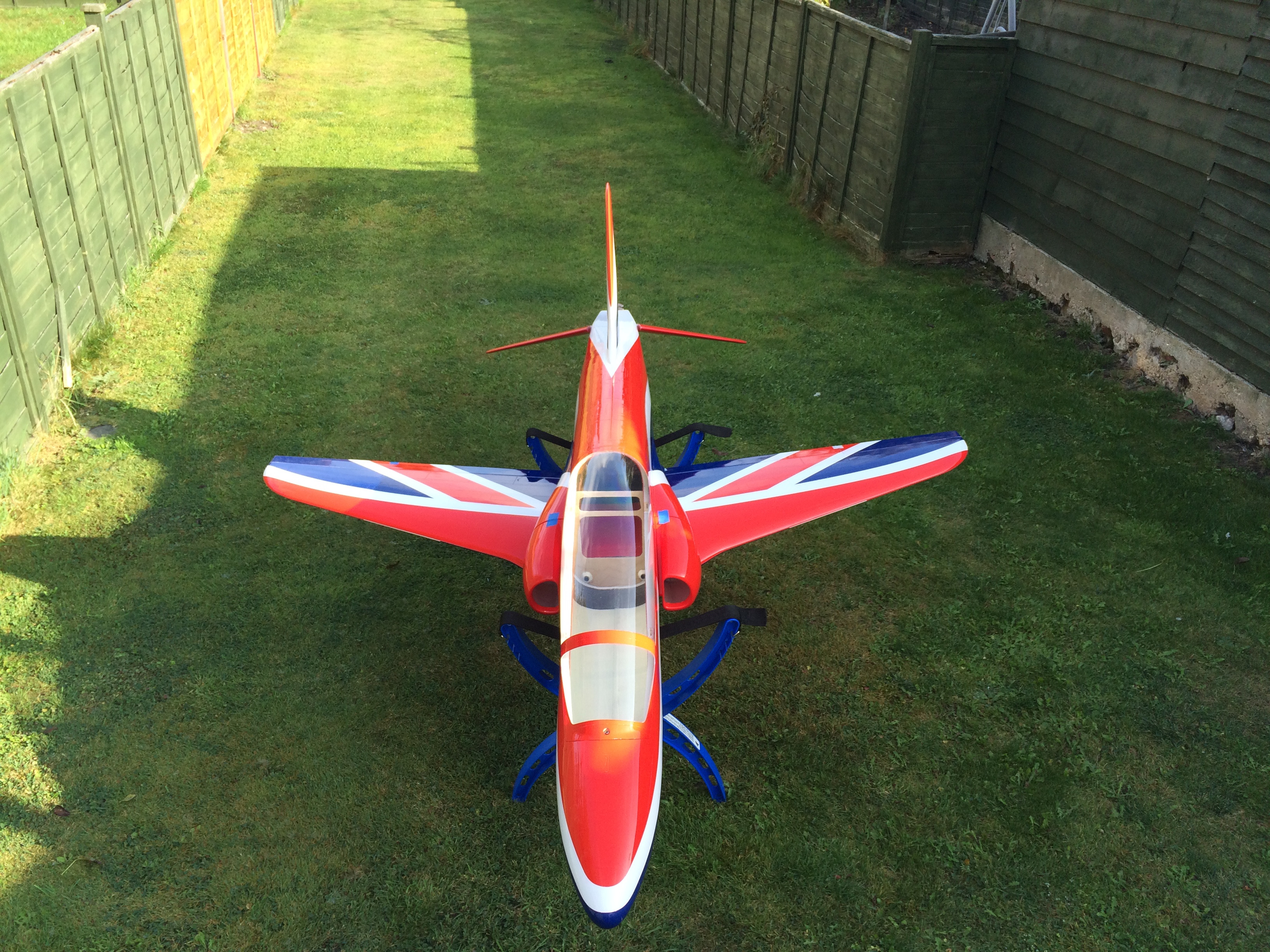

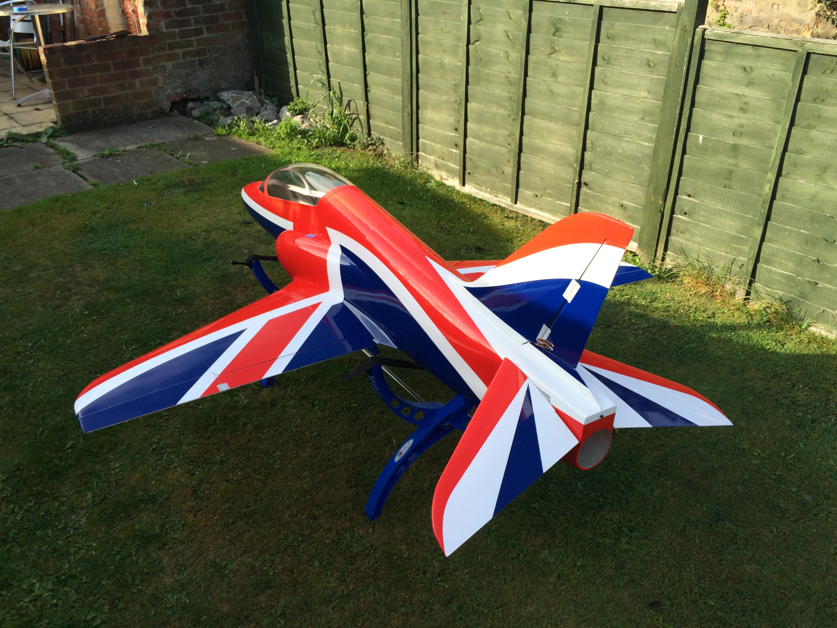

Joined: Mar 2008
Posts: 448

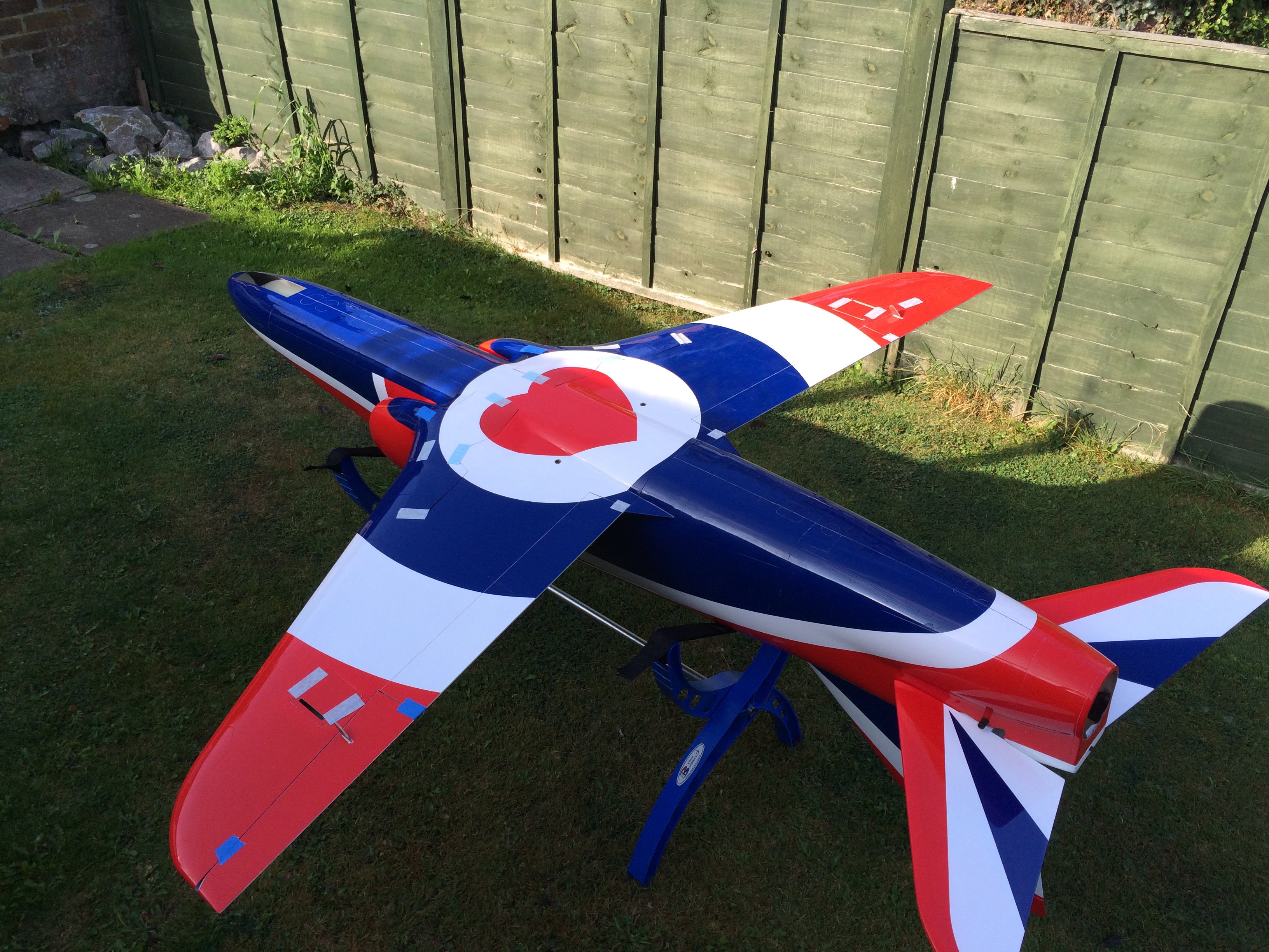

More pics of the new scheme, dry assembly in garden, wing and tail parts all perfect fit.
