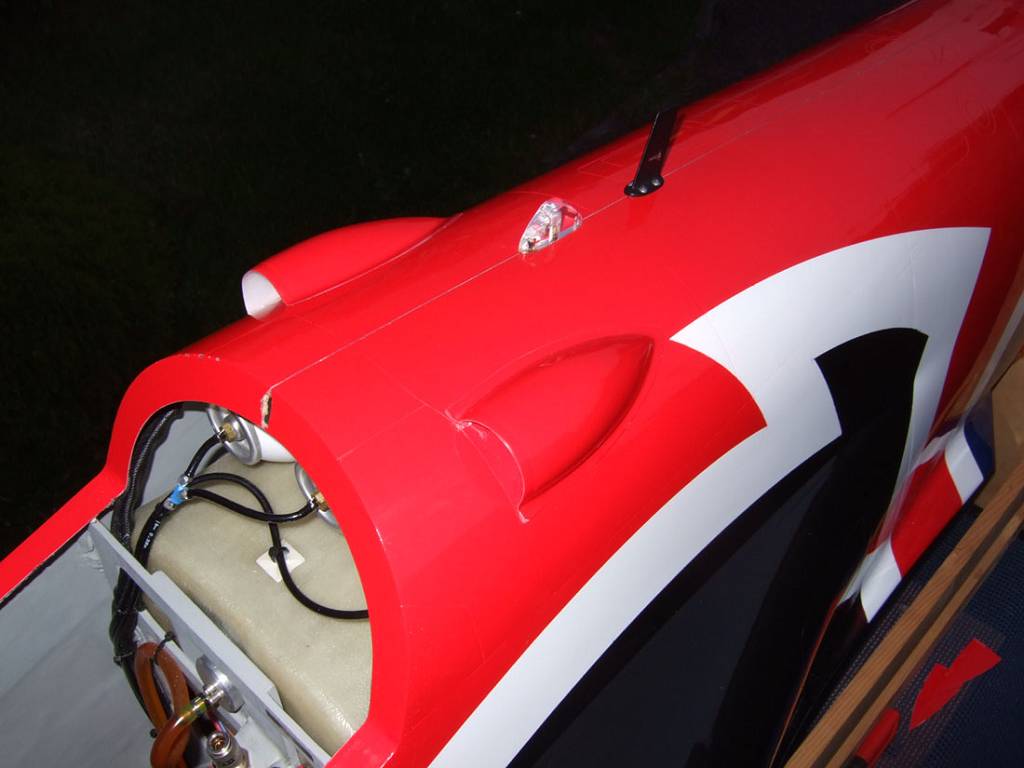

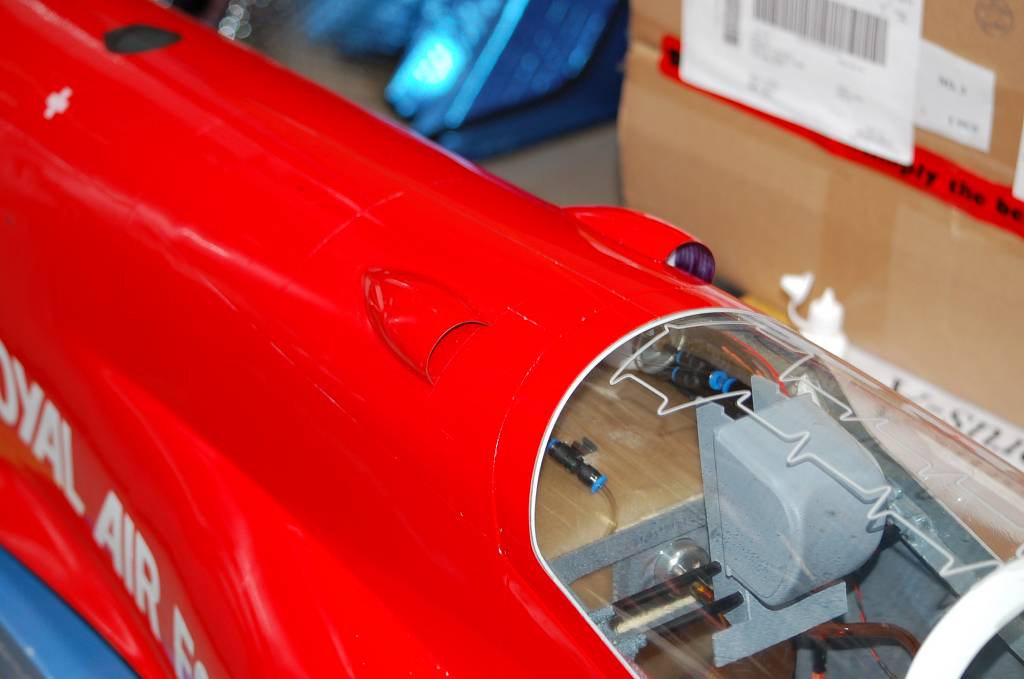

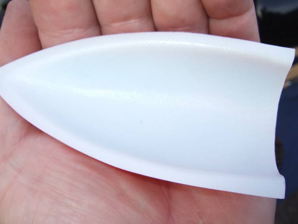

I have finally had and fitted "bunny" ears to my Hawk. They are available in Red, Black and white.
Dw

What material are they made from? Glass F ?
Regards
Alan
Also did you cut venting holes in fus before fitting?

Alan
Light moulded glass.
Funny you should say that! meant to and it needs it..but not that clever/too excited!!. I wonder whether they will come off or make a noise!
Dave

Dave
Put me down for a set of red please I will ring you in bit
I vented the scoops on my smaller hawk but I do think that on the CARF Hawk especially if your a speed freak like the Germans :-) then they will need venting or I think you run the risk of them being ripped off!
Regards
Alan

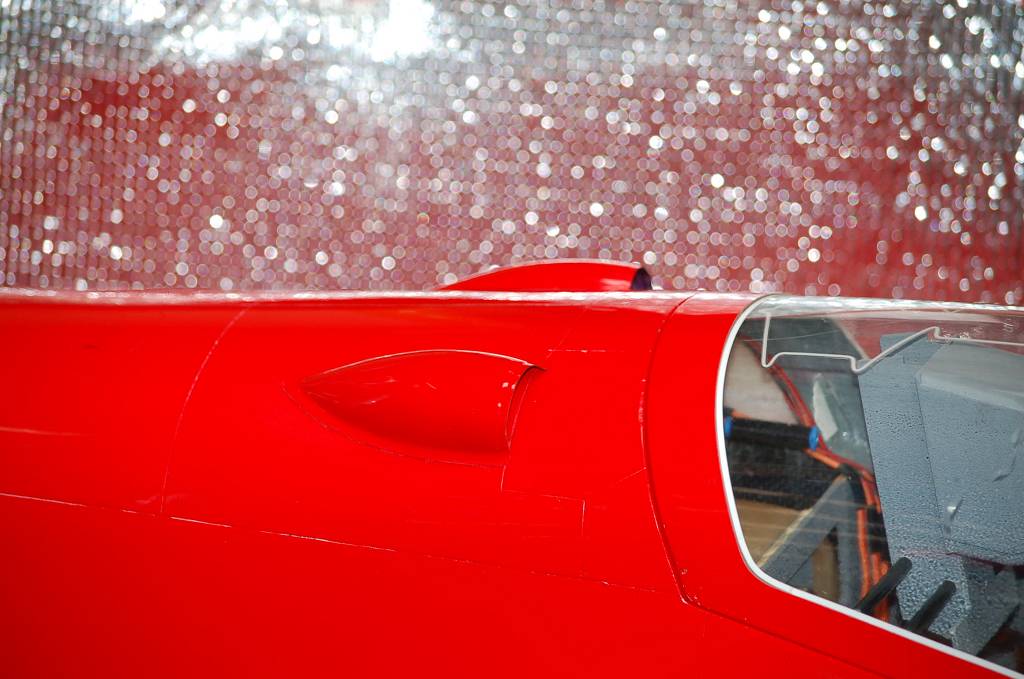

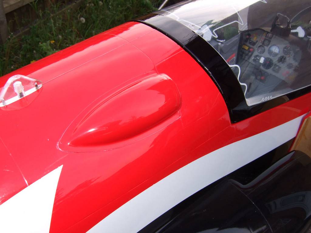

Some pics of the new top air scoops
Alan

Fireblade,
The scoops look good. Is the lens on the strobe next to the scoops a solid thick piece of plastic drilled out for the LED or does it just look that way?
Marty

Marty
The strobes I milled out of solid perspex to the scaled down shape of the full size, if you look in this thread you will find the posts I did with reference to the NAV lights I built for my Hawk
They have a 700mAh Philps LED very bright same as what is used on Merc autos day light running lights.
Regards
Alan
