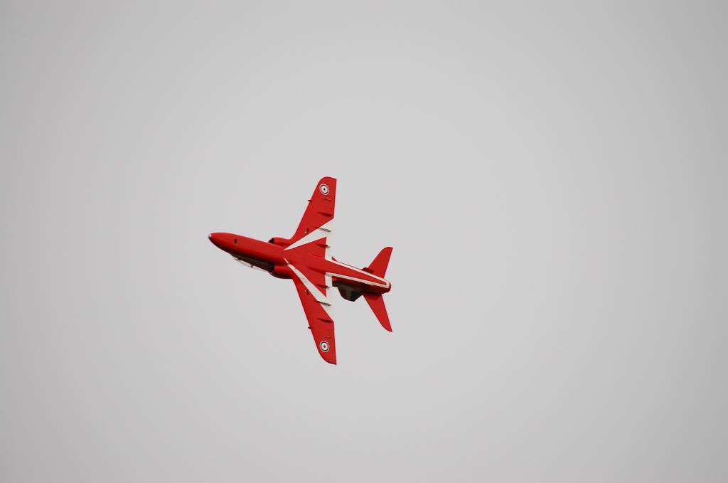

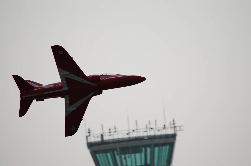

Hi Dave, what are your thoughts on the other "protrusions" available for the Hawk? I believe you, or someone, said the fuselage strakes behind the wing had little effect pro or con on flying, but since they enhance the scale look I will use them. Then there are the bunny ears and your flap mech covers, 3 under each wing. I will include them unless you think they hurt performance. Did they affect the flying qualities in any measurable way? Did you vent the bunny ears to allow more air into the fuselage? Thanks for reminding me about those wing bags "posting" from the rear, something an owner/operator would know about!

The fuselage strakes make little difference, but it looks SO wrong without them I would always add them.
Bunny ears are now included and will be on your kit, make no difference to flying-You should vent them...but I didn't
My wing flap covers probably improved slow speed handling (with flap) a tiny bit, but it was and is good without them. I just liked the look.

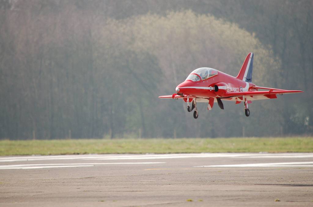

better one of bottom

They look fantastic. Thanks. I'll have to put together a little order from Motors and Rotors...
