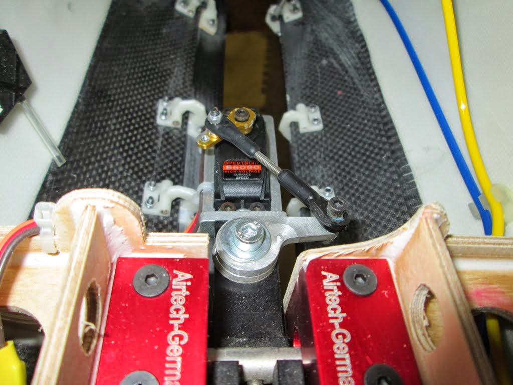

Could someone confirm what the front landing and main landing gear pin sizes are?
They look to be the 8 - 10 mm sizes... but I'd like to know before I get mine
Thx in advance
Old 11-11-2015 | 01:45 PM
  #2128
Joined: Jun 2002
Posts: 13,266
Received 793 Likes on 576 Posts
From: Watford, UNITED KINGDOM
Memory says 8mm nose and 10mm mains, but its been a while since I built one!
Old 11-12-2015 | 01:05 PM
  #2129
afterburner's Avatar
My Feedback: (18)
Joined: Jun 2002
Posts: 3,021
From: New City, NY
Thx in advance
The mains are 10mm. The nose doesn't have a pin. Either the top half of the strut will bend or the trunion will distort. Don't ask how I know

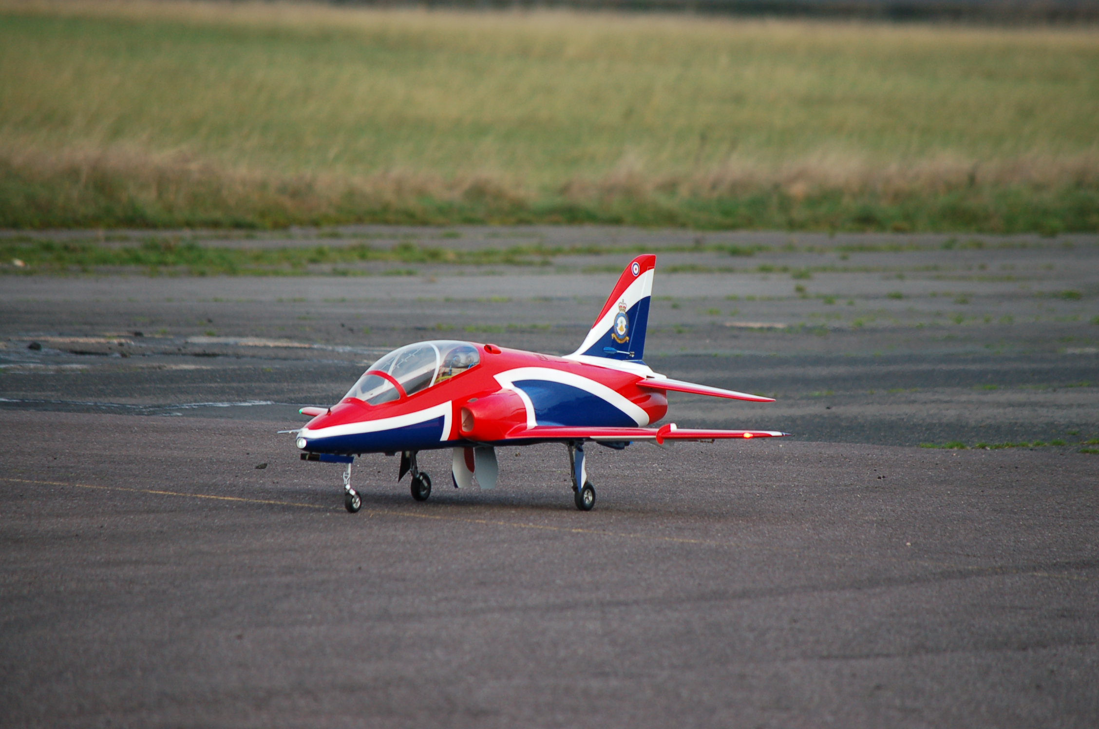

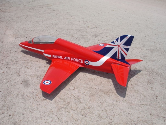

Couple of CARF Hawk's at the JMA meeting today, Both JetCat P-140 and JR guided

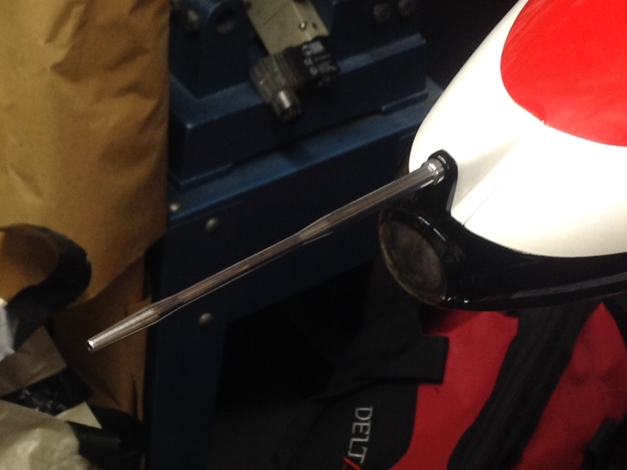

Old 12-05-2015 | 10:23 AM
  #2134
fireblade5437's Avatar
Joined: Dec 2005
Posts: 974
From: Leicester, UNITED KINGDOM

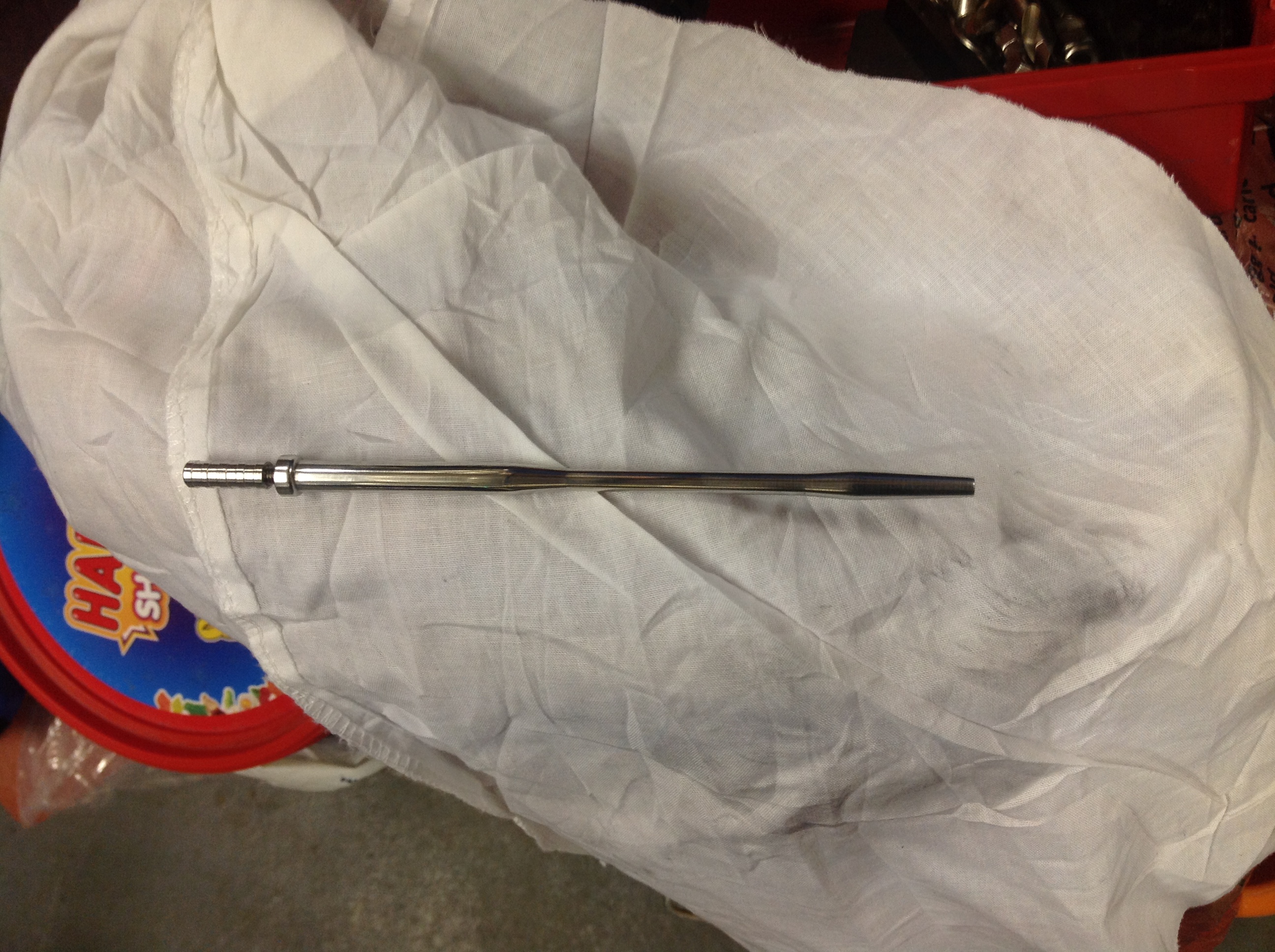

Darren, I got your probe finished today and it will be in the post to you first thing Monday morning
Picture of the probe fitted to my CARF Hawk
Alan

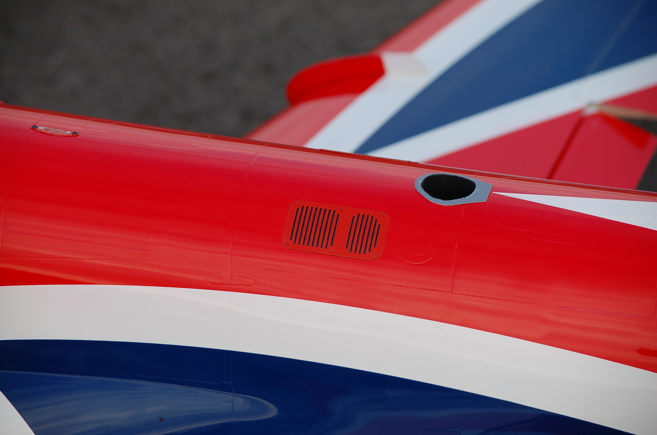

Question about scale details on Carf Hawk, on the pictures on post 2133, there is a lot of details with wingfence, air intakes on top of fuselage, APU inlet, scale hinges on flaps ect. Do it come like this from CARF, or where do you get the scale parts, because when I look at the pictures on CARF homepage the plane is without the scale details?

oesterling - The plane comes with limited scale details. Most of those can be seen on CARF homepage hardware set picture. Those can be used for antennas and bigger details only. Molded pitot base, pair of bunny ears, two wing fences, pair of rear fuselage fins, set of gear doors and stab root plates - thats pretty much it.
So no Pitot, canopy/cockpit details, APU intake/exhaust, flap hinges or aileron hydraulic servo casings. Quite accurate panel lines tough.
Hope this helps.
/Jyri
Old 12-11-2015 | 09:11 AM
  #2140
Joined: Jun 2002
Posts: 13,266
I have the dummy flap fences moulded for mine, we sold a few sets only. Easily made from 10mm balsa with glass cloth cover.
The Grills are something we offer, APU you cutout and line with a tube, paint inside black. Pilot tube from Alan on here.
The outline is very good, it can be really scale as you will see looking back through this thread.

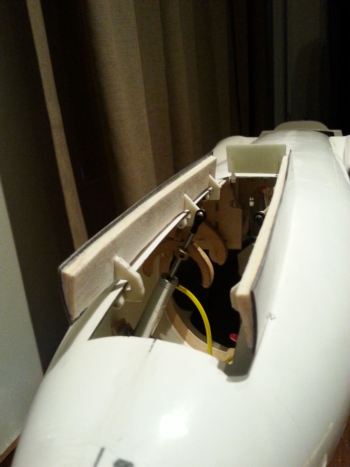

Old 02-18-2016 | 11:57 AM
  #2141
sharam's Avatar
Posts: 253
From: SF Bay Area, CA

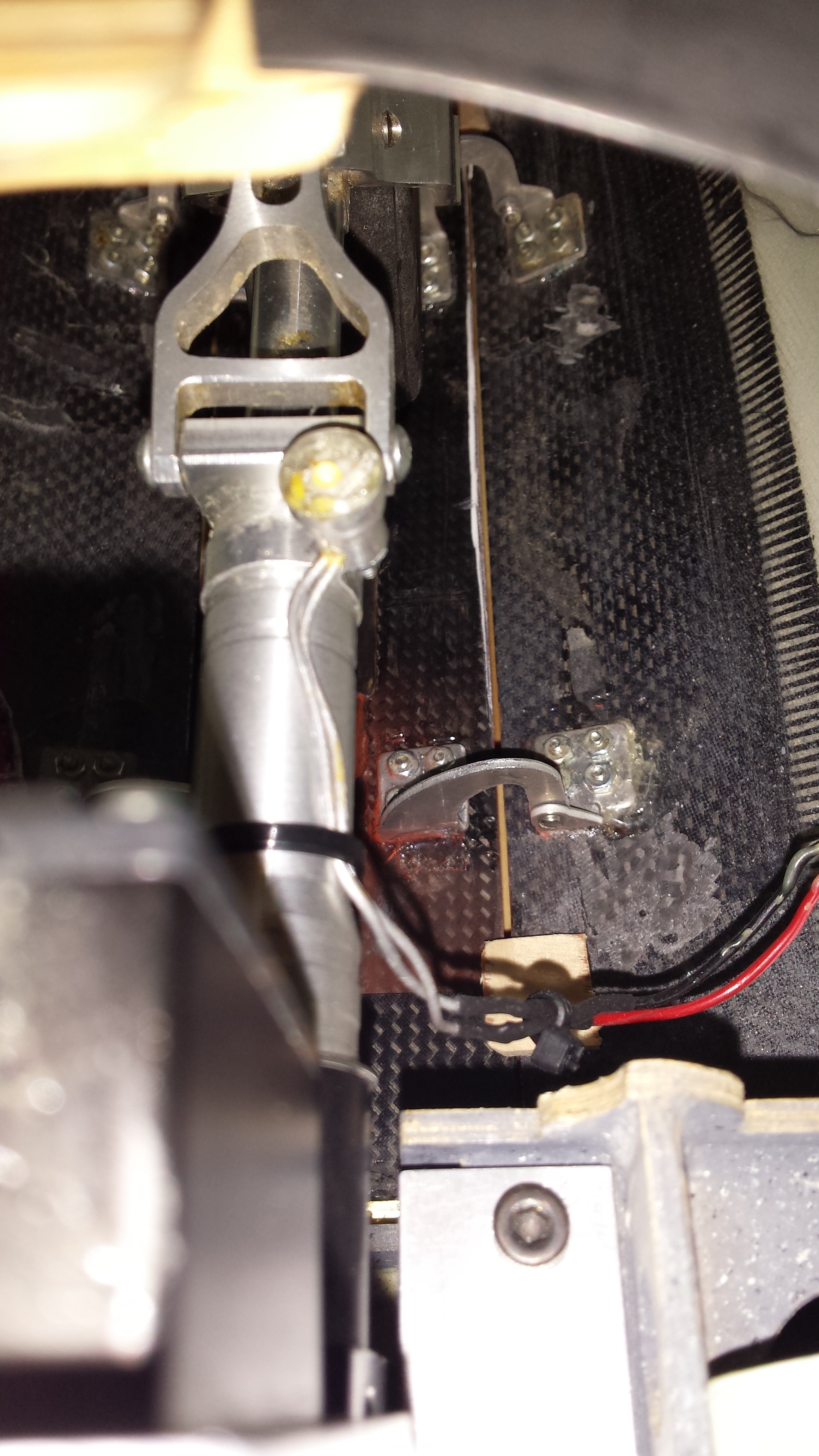

Love my Hawk. Anyone use the after market metal hinges on the nose gear doors instead of the stock method? Would love to see pics of you have them.
Old 02-18-2016 | 01:06 PM
  #2142
Joined: Oct 2008
Posts: 62
Received 7 Likes on 6 Posts
From: FINLAND
Not metal sharam but after market stuff anyway. Some plywood spacers underneath to level up hinge line. See pic.
I have been adding scale stuff all winter but progress is too slow. Some weight dremelled from the fuselage and some rivets and holes. Still empty shell and not an aeroplane. Just need to find motivation somewhere to get it flying again for the summer.
ps. anyone having scale retracts just lying around. I'd like to upgrade
/Jyri

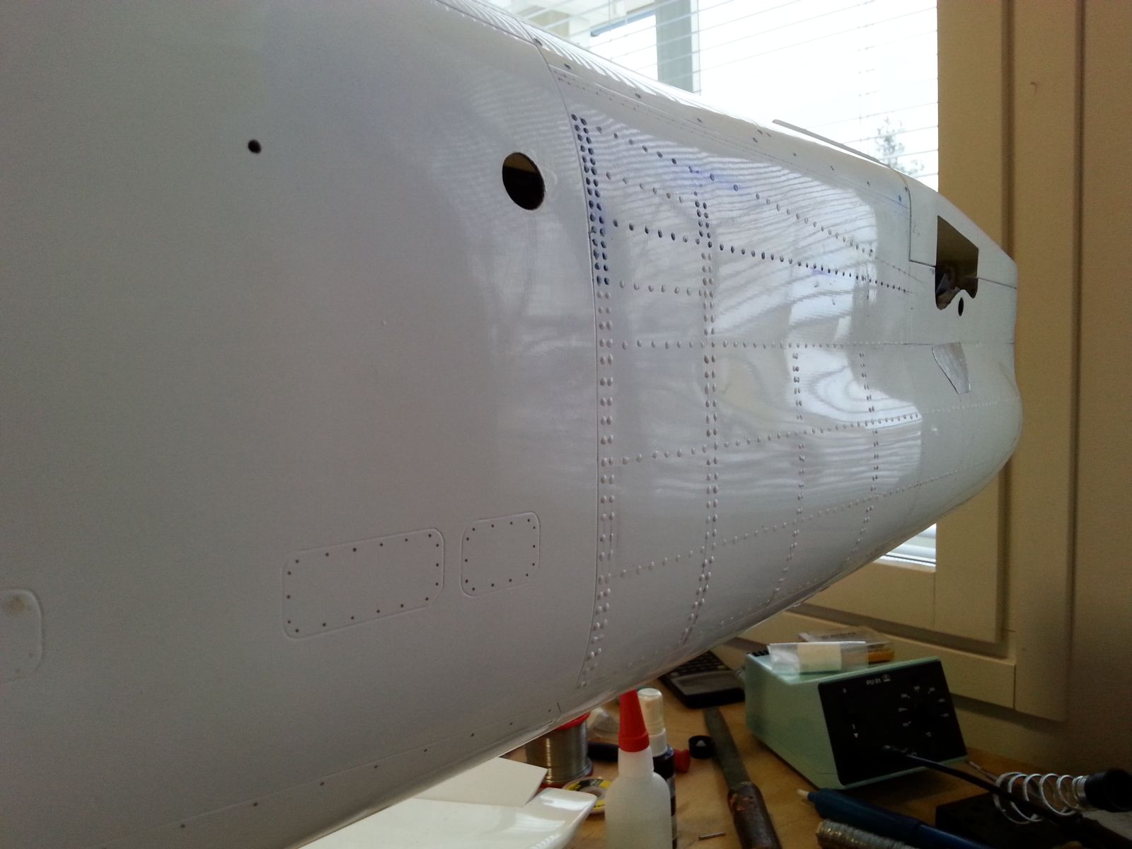

How does one get those nice looking rivets on the model like in post 2142?
Thx in advance for any input

The scoops are now included in all kits. They are available as a part.
ZAP 56 in a syringe is normal.
Old 03-04-2016 | 02:06 AM
  #2150
Joined: Oct 2008
Posts: 62
From: FINLAND
Im just copying old stuff not inventing anything novel... see posts #2067 - #2069. Just tapping droplets with sharp steel wire. The glue I use is standard PVA-c wood glue. Lots of time... Thats pretty much it.
But beware it is very nerve intensive job Still not complitely finished mine.
