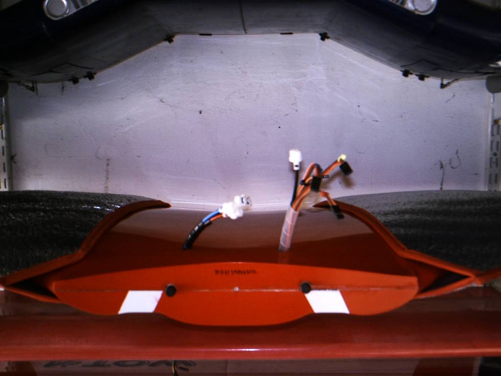

Rich,
Looks like I will be mounting my new smoke pump in the Tutor until I come up with a way to get a smoke tank into the Hawk with out redoing the airlines and wires.
Well anyway the Tutor really needs smoke more then the Hawk
Stan

Stan
You could put two 24 oz Dubro's one either side of the wires?
Dave

Dave,
Thought of that. They will cover the air inlet some.
Did you ever put smoke in your Hawk?
Stan

Stan
I have used the wing tank from a flash with the wire and air lines coming out just either side of centre, i will try and take some pics for you tomorrow.
Steve

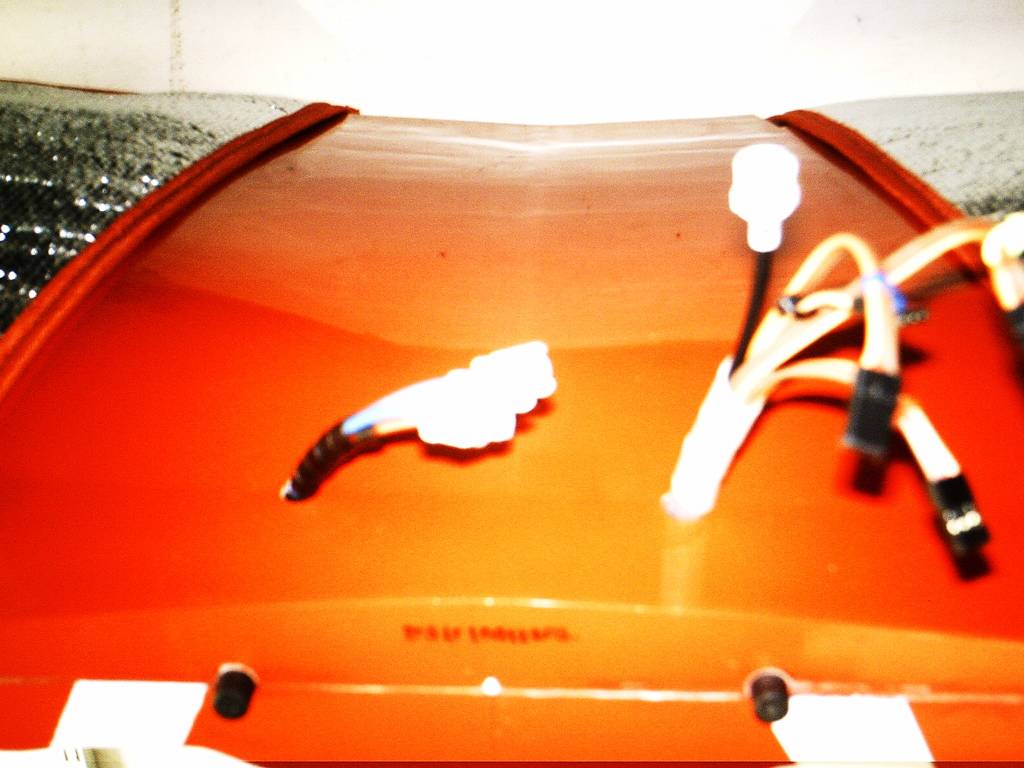

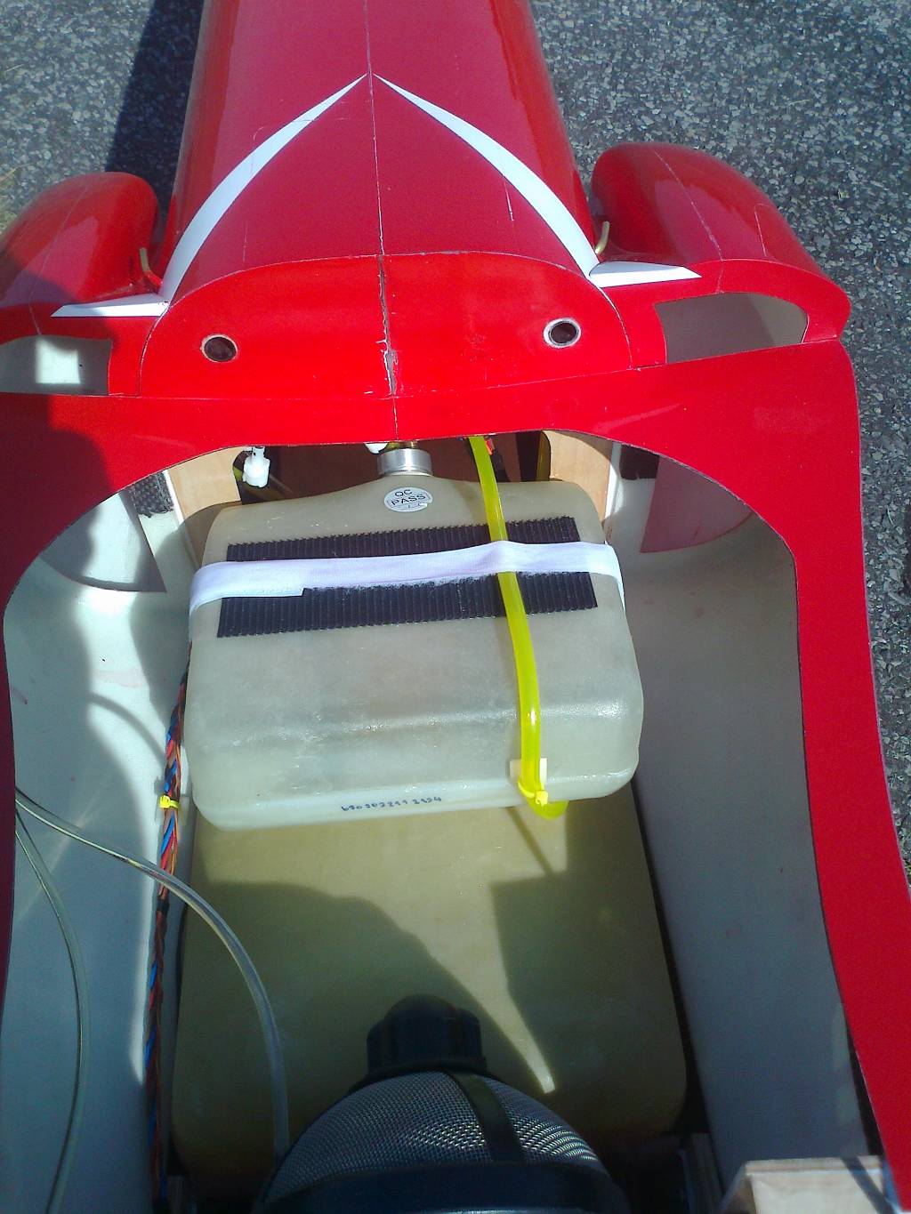

Hi Stan
Here are some pictures for you (sorry about the quality), i have put the tank in upside down to give more room through the front but it works fine.
HTH
Steve

Steve,
Very helpful pictures I see what you did.
This will be an option for me when I do install my smoke tank.
I do like to watch airplanes when they use their smoke systems, but my main reason for going to smoke is to use in an emergency situation.
While flying my Flash I have lost sight of it as I enter a turn with the proper colored sky.
My thought is it would be great to flip a switch and be able to spot it if you could not find it right away.
So my thinking now is a smaller tank 24-32 oz's (two 16 oz tanks). That should give me two minutes of smoke if I only used it on certain maneuvers or emergency situation.
Thanks for your pictures,
Stan
