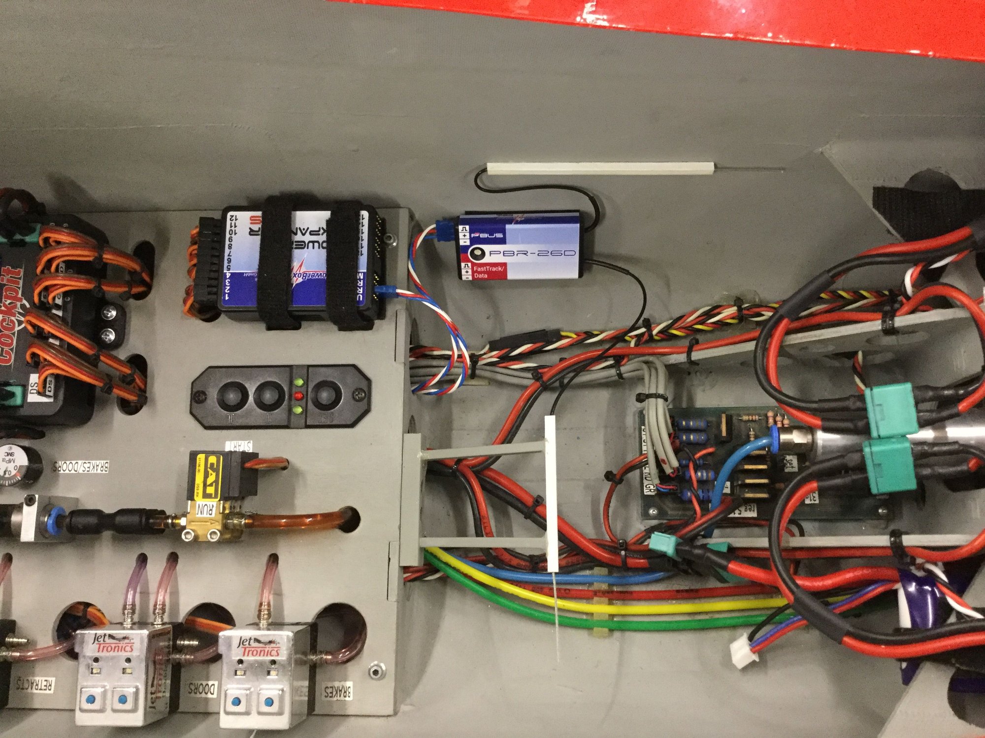

Dave, do you happen to know if there is any carbon fibre in the intakes at all? I know where the strengthening carbon is on fuz but just wondered if there is any on intakes (both mine still bolt on) as thinking of aerial placement but one would be inline with one of the intakes...
When I rubbed them down for spraying I cannot recall seeing any carbon but it’s 9years ago now..😮

In the inlet itself, no Carbon. With Core it doesn’t seem to care! We taped two Rx aerials to a carbon radio tray and it still had great range, even from the opposite side of the carbon!

Dave thanks for that.
Also had maiden flight with my Honda T1 with 2 x 26ch last week and had the normal results 🤣
One mod I did as the aerials are very short was to increase length which made placement for second Rx a lot easier
Sent Cockpit back to Richard now on V19 one problem we did see was jumping of servos namely the tailplane which I solved by putting the Power Expander on 12ms and also the Cockpit frame rate on 12ms....
Power Expander took place of original FASST 14ch/MX22
Now got CTU for turbine data also Cockpit data on P2BUS

Hi Alan, seen your posts on PB Support, and DW, good to see our Hawks are still flying and getting facelifts now
I plan to thoroughly refresh mine with the PB Rx, fuel lines, servo connections to the wing, whatever else I can find after all these years and 400+ flights.
Alan what “CTU” are you using for turbine telemetry with the CORE? Was it easily implemented? I have a Mercury and 2 PBR-26D Rx for my Hawk. So this will be the first time I fly the Hawk with a gyro. I never felt it needed one.
Smart install BTW. And the CORE does appear to have truly great connectivity with its PB Rx. How it can “see through” CF is mysterious but I ain’t complaining!

Hi! Hope your doing good!
The CTU I am using is one done by Carsten and Sandor (Digitech) very good and easy to programme
got one on my T1 with the JetMunts 140XBL and the Hawk with the P120SX
I have Mercury SRS in T1 also got one in Elan with 100XBL
The Hawk was originally set up on Cockpit non SRS so got a Power Expander and as you had probably seen on Powerbox forums had problem with servos jumping until I found by setting all frame rates to 12ms in Expander and Cockpit cured the issue
