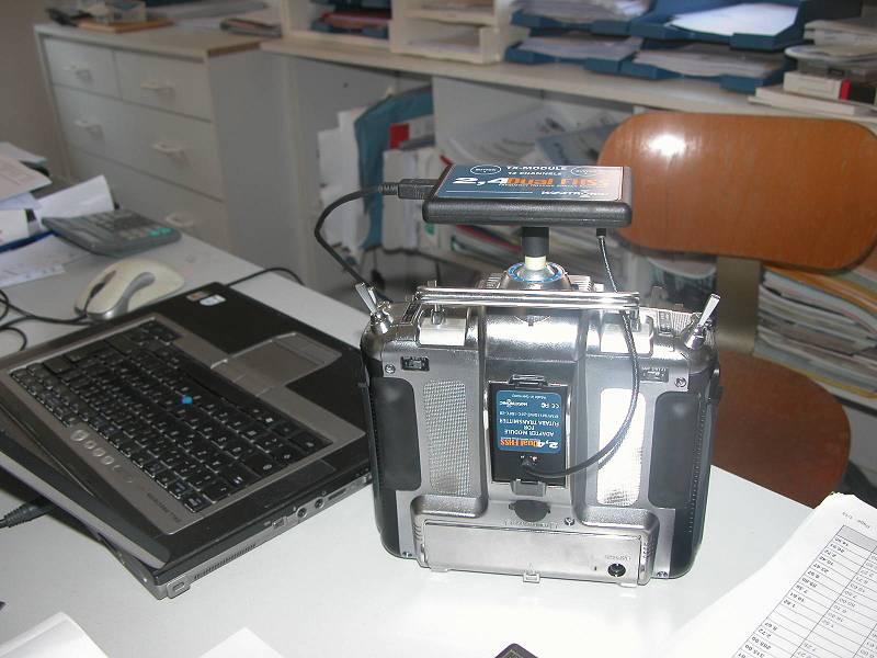

As much as I hate to say it, A lot of the guys on here are not gonna touch that thing until it becomes a single unit. That big clunky flat antenna is not really functional, you will have to attached everytime you fly to the TX. Just a big hassle. That being said, it won't see the same sucess the first unit had. You are right, Weatronic did have ground breaking technology. A small box provided, dual rcvr's, redundant power, easy programming, sequencing of servos, the list goes on and on. But, now that you this "contraption" on top of the TX people will look elsewhere to accomplish the same attributes that the weatronics does. Personally I would spend more $$ in individual items to "work around" the clunkyness. my .02 FWIW
Sean
Sean
My first question was about customer service and my mind hasn't entirely been put at rest. This thread was 'dragged up' 6 weeks after I posted the initial question. Support isn't just required for setting up the module but also for faults/repairs.</p>
I am tempted to give this a try but the TX module does appear to be a bit of a pain. I am also not sure about the legality of some of the systems in the UK (e.g Graupner MC19 and Multiplex EVO/Profi) as it appears that some TXs need to be 'modified', looking at the literature. However, this is not a problem for me using a Futaba 9Z. I am also not a great fan of the battery redundancy that only uses one battery. I would much prefer the battery usage to be 'shared'.</p>
I think the Weatronic is almost the perfect system but a few niggles make it a less straightforward choice.</p>

I have heard both arguing about the beauty or the lack of beauty of it. Some people don't care about the looks and strive for funcionality. Of course is it is also a matter of taste and to some the looks are more important than performance. So be it. Some people rather throw out the baby with the bath water.
Weatronic recommends to actually leave the transmitter module on the receiver and put it in the transport case attached to the transmitter while not in use. It is what it is at this time an it will lead to further developments down the road.
