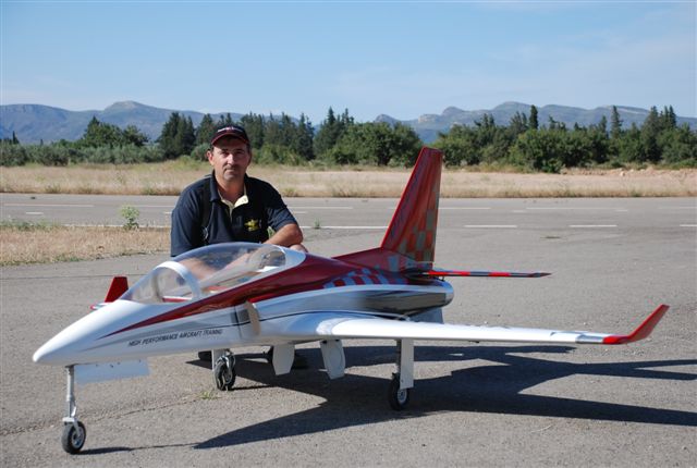

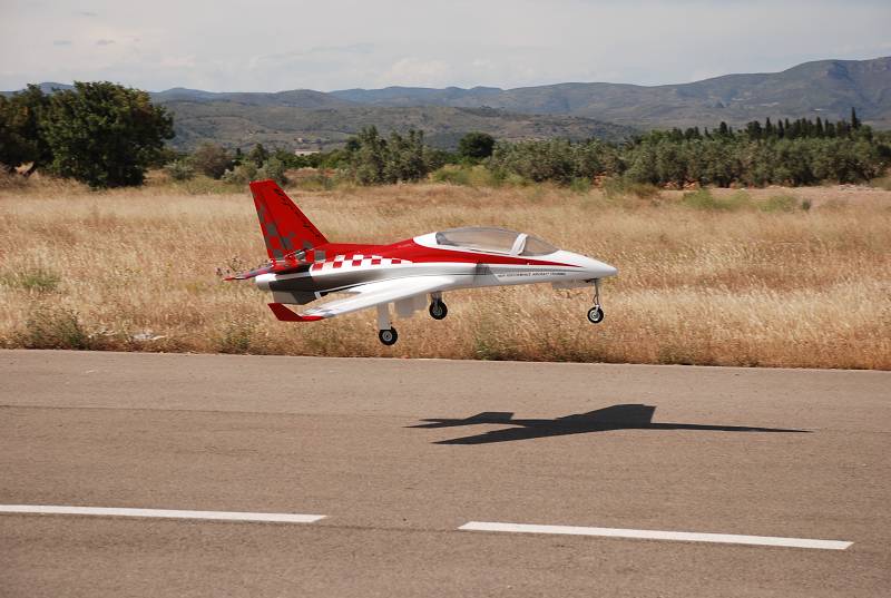

<div id="result_box" dir="ltr" style="text-align: left">Hi, ( Hola)
I've completed all the corrections and this is the result, a good flight and the best jet I have ever had.
Jclittle, thanks for the help and advice
Norbert</div>
