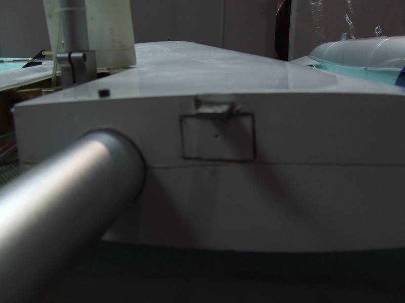

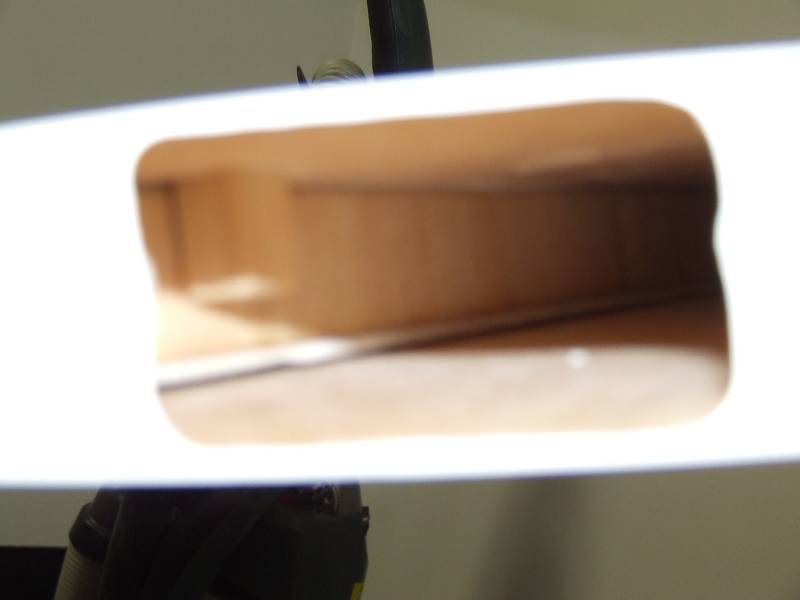

Old 05-05-2009 | 05:02 PM
  #38
My Feedback: (15)
Joined: May 2003
Posts: 40
From: Ft Worth, TX
Default RE: Another Skymaster Viper
some pics
pic one is wing sleeve repair
pic two is carbon plate to reinforce landing gear mount

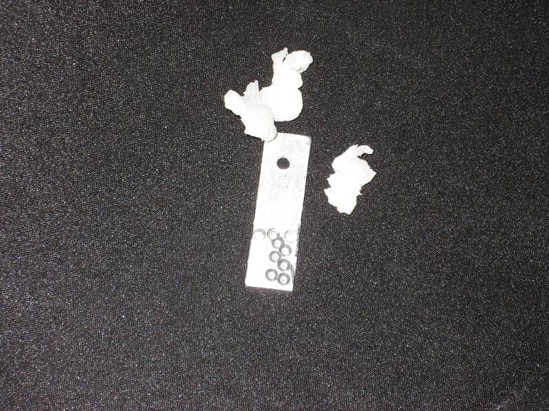

Old 05-05-2009 | 05:04 PM
  #39
My Feedback: (15)
Joined: May 2003
Posts: 40
From: Ft Worth, TX
pics
pic one is internal of rudder showing no glue and former not attached
pic two is fitment of bvm bypass and tailpipe

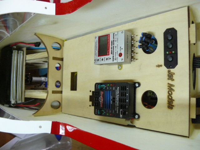

Old 05-05-2009 | 06:11 PM
  #42
norbert montenegro's Avatar
Joined: Jan 2009
Posts: 180
From: OlocauValencia, SPAIN
Excuse my English jclittle is not very good and it's hard for me to understand certain techniques,but with the photographers of JTs Hobby I understand the two main problems. Apply the reforms in the model quickly, you step photos of my work at the moment.
Thanks again for everything
Regards
Norbert

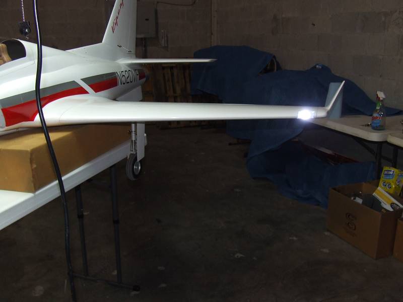

Old 05-05-2009 | 07:42 PM
  #43
My Feedback: (99)
Posts: 707
From: Suwanee, GA
Norbert - nice building! In case anyone is wondering if the wing attach mod needs to be done, here is a photo of the tab and all the glue that was holding it in place. It was loose and probably would have pulled out in another flight or two.

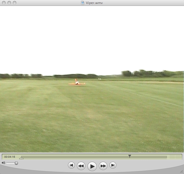

Old 05-05-2009 | 10:07 PM
  #44
Joined: Nov 2005
Posts: 720
Received 5 Likes on 3 Posts
From: Araras, BRAZIL
First Flight...
http://www.youtube.com/watch?v=Uo96Cv3zZxs
Regards
Heraldo
