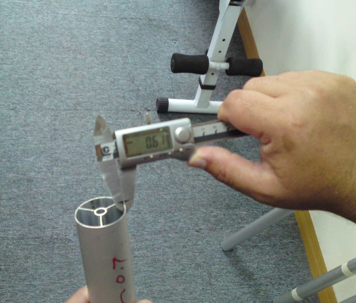

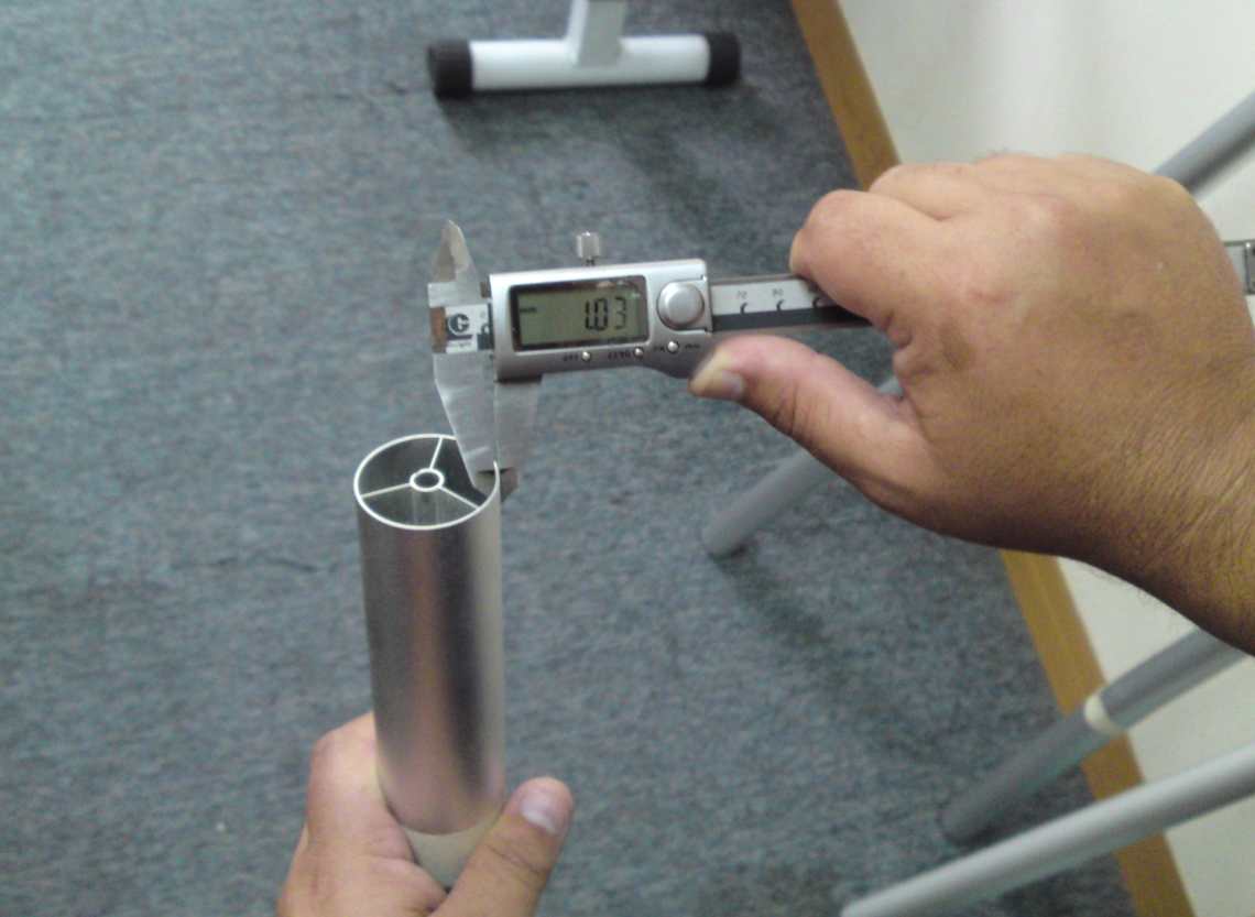

Hi all,
Here is the pictures showing the difference between the 2 pipes. If your pipe is 0.6mm please e-mail us and we will replace free of charge. We will take some pipes to Florida Jets to echange for USA customers. So if you are not attending or know of somebody that will, please collect the pipe from us in the Florida Jets.
For UK and rest of world we will send via EMS.
This problem only for Viper large and Hawk Large. So please check and send us e-mail before flight.
Best Regards
Anton

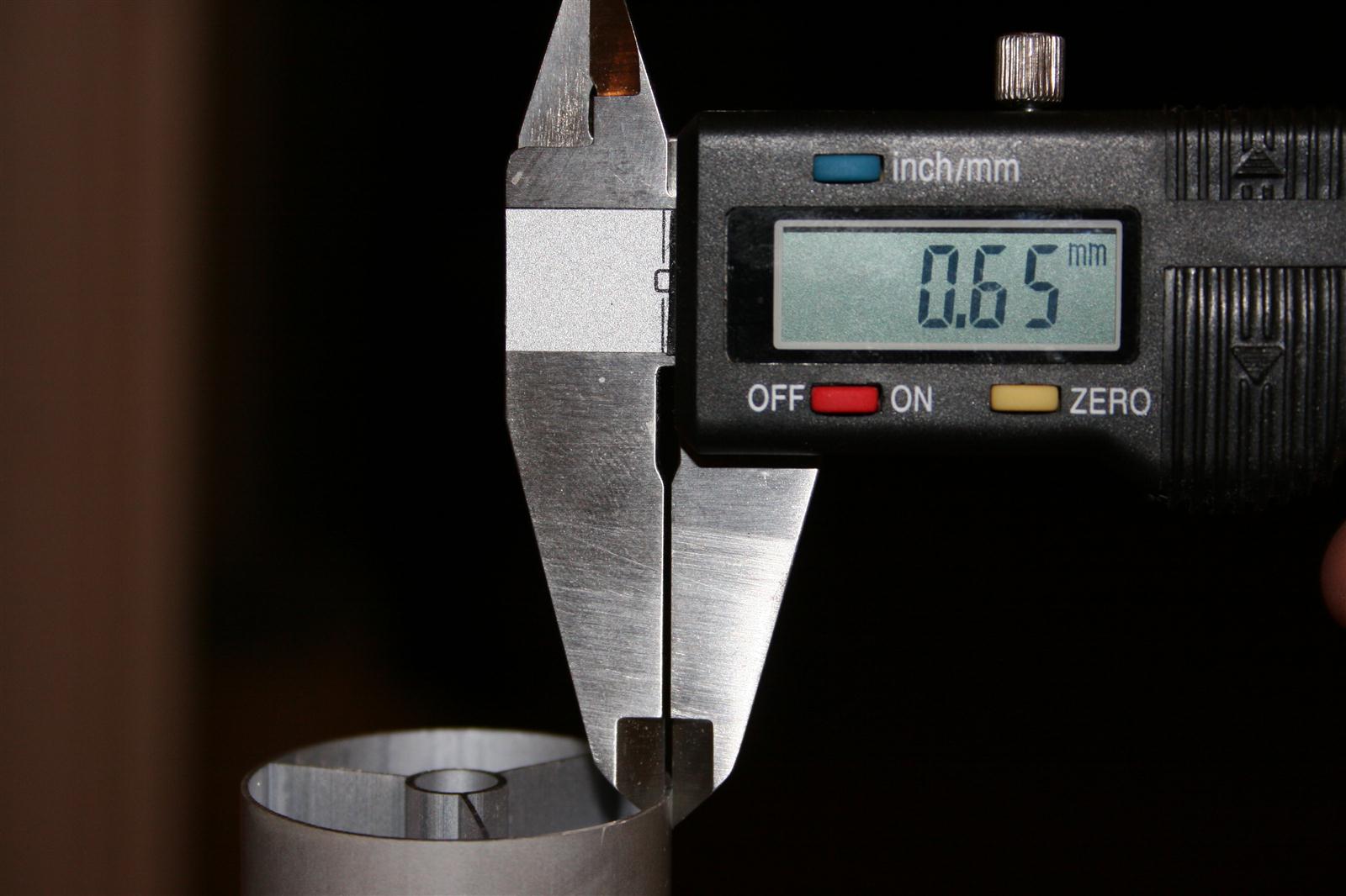

Default RE: Another Skymaster Viper
I got 0.65mm (tripple checked) and 298 grams, and mail has been sent!
(P200 and this tube, guess I was lucky!)

ORIGINAL: cgroen
My tube is the same as yours. Not had any problems over many flights. I will send for the stronger tube, just to be safe.

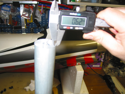

Bingo!
