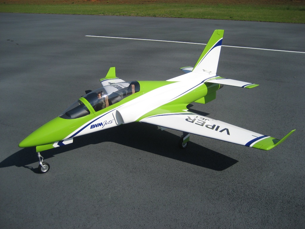

Matt, I heard from John B that you were getting close! My CG is exactly in-between where Anton recommends in the manual. All batteries are up front (2 - 5200 mA Li-ions and 1 - 2750 mA LiPo), gear down, UAT full, and all turbine related equipment is under the turtleneck just behind the cockpit. With this set up I needed to add 3 oz in the nose. Definitely fit the cockpit before doing final CG, this along with a pilot will make it nearly right without adding any additional weight. I made a stand to balance my larger planes without a helper, photo is attached. Set your elevator movement to 25mm, this is perfect for landing with minimal expo. The Viper will balloon on you with too much elevator and expo.
Did you do the mods that were recommended in the various build threads? Specifically the rudder? I also added additional glue to the windsheild as I had one come out in flight several months ago. Not the canopy but the windsheild.
Enjoy your Viperjet! Its a great flying jet.

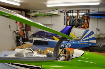

My latest little viper mod, and an oldie that is really worth making sure you do........
I found the canopy frame very flexible one the lower cross braces of fiberglass were removed. This made handling it when it was off the model tricky and after a few " Harder" flights ( Especially those with snap rolls ) I found the rear edge of the canopy frame starting to open out. I didnt deal with this quick enough and ended up with a tiny hair line crack in the very top of the frame where it had opened out more and more.
My fix was to put a cross brace in. What I used was a 3mm carbon push rod with a threaded adapter at both ends, with a clevis attached. This was I could adjust the length of the cross brace a little to get it just right. I then cynoed, and rocked powdered the very top domed part of two fiberglass servo arms into the corner of the frame as attachment points. Job done! The frame is allot stiffer now, nicer to handle when off the model and can not open up in flight.
The oldie to make sue you look out for is to make sure that you gently heat the flap faring attached to the flap surface which lips below the top surface of the wing, then while warm flew it gently so it rolls under more and clears the top skin of the wing. From the factory these tolerances are a little close and I have found in flight that with a little wing flex the flap can actually catch the wing as they raise. On more than one occasion I have had it where one flap has caught and not gone fully up. Causing the model to roll a small amount in flight, ruin that flight, stall the servo and damage the wing skin a little. A gentle warm with a heat gun ( Go easy as its thin glass in that area ) and a tweak down has it sorted.
Hope these mods are of some help

Ali,
Thanks for the mods. Could you please provide a photo for the canopy mod although your explanation is quite clear would like to see exact location of cross brace.
Best regards,

Not a very good photo I am afraid but it will hopefully give an idea, if not I will take another later on.

Thanks Ali,
I think i get the picture. Do you think that a carbon fiber layer with resin on the inner side of back former of canopy to stiffen it would do the work??
Thanks, Regards,

yep I am sure that would help but the carbon rod is just as if not more stiffening as well as being super quick to do.

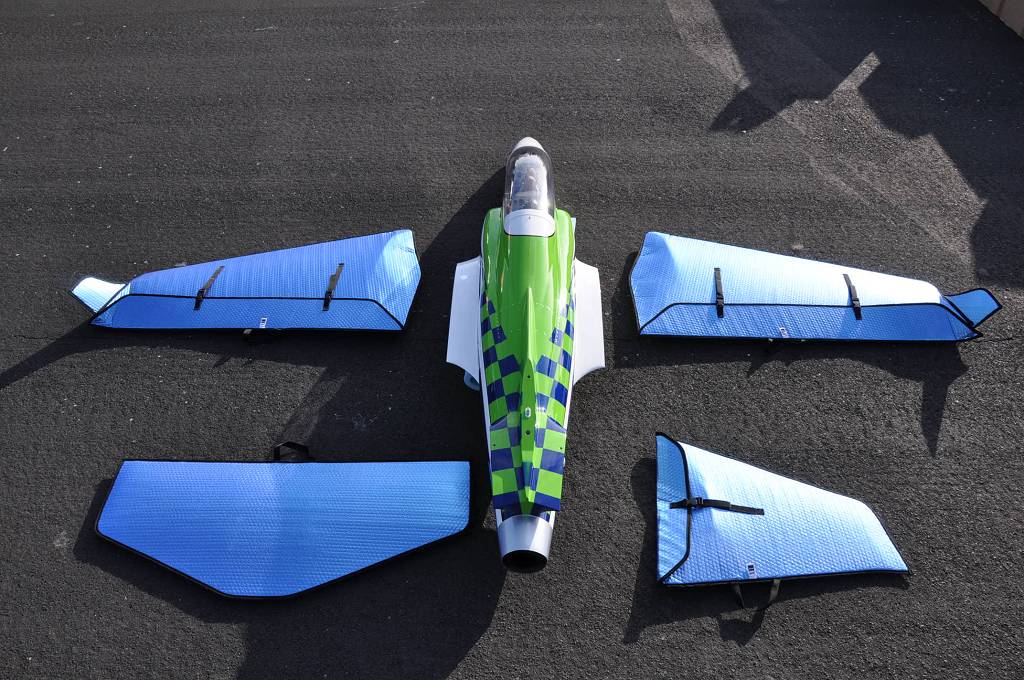

Also another bit of good news for all you Viper jet owners out there... I have had Pull Over products in Germany make me a gorgeous set of padded and lined custom bags for the wings and tails to help protect your pride and joy.
Two piece wing bags securely clip closed and even have a slide of wing tip protector.

The bags are great Ali, I got myself a set for my Viper at JP also (and when I saw the quality, I ordered a set for my Eurosport also )
Regarding the canopy brace Al, what have you done in the front of the canopy ?
There is a cross brace in fiberglass when the canopy is delivered, I looks like on your pictures that it is removed ?
I'm afraid that removing it will make the canopy blow of in flight ?

Hi Ali,
Thoese bags for the Viper looks super! where can I get a set?

Gonzalo Hi
I am selling these bags and have just last week sent a set to Rob Lynch in Florida.
Regards Al
Email me direct for costings [email protected]
