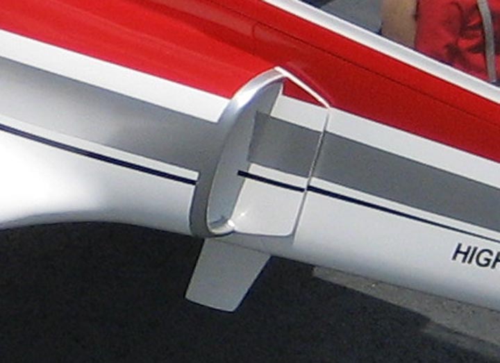

Getting on well with the build. I have a part not on the parts list. It is a small fin (shaped like the tail fin) about four inches by two inches. It looks like some kind of ventral fin, but have no idea where it goes. Any ideas?
Edit :- Looking again at the parts list, it mentions a UHF antenna. Perhaps this is what it is? I don't see it in anyones Viper photos.

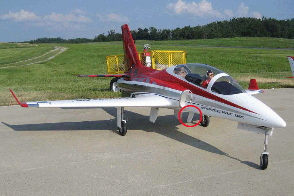

The small fin is an alternate vertical stablilizer in case the big one is too large for your trailer.....just kidding.
As you guessed, it's a scale antenna. It goes on the bottom, centered and more or less in line with the intakes. You don't see it often in pictures since it usually must be removed for transport. Some of us attach it with a couple of vertical pins and magnets to make it easily removable.

Thanks Craig. I think I will leave it off. It would probably be more bother than it's worth.
Liked the alternate vertical stab idea.

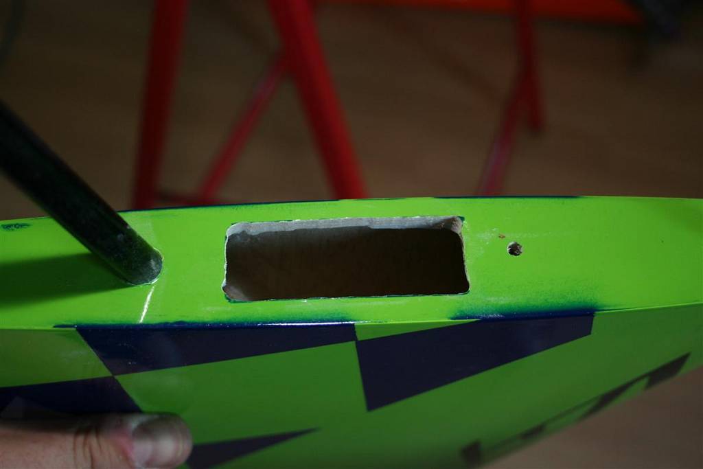

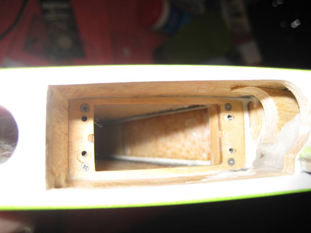

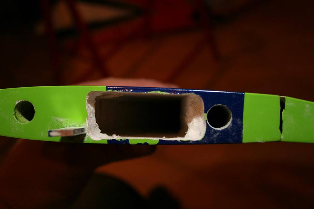

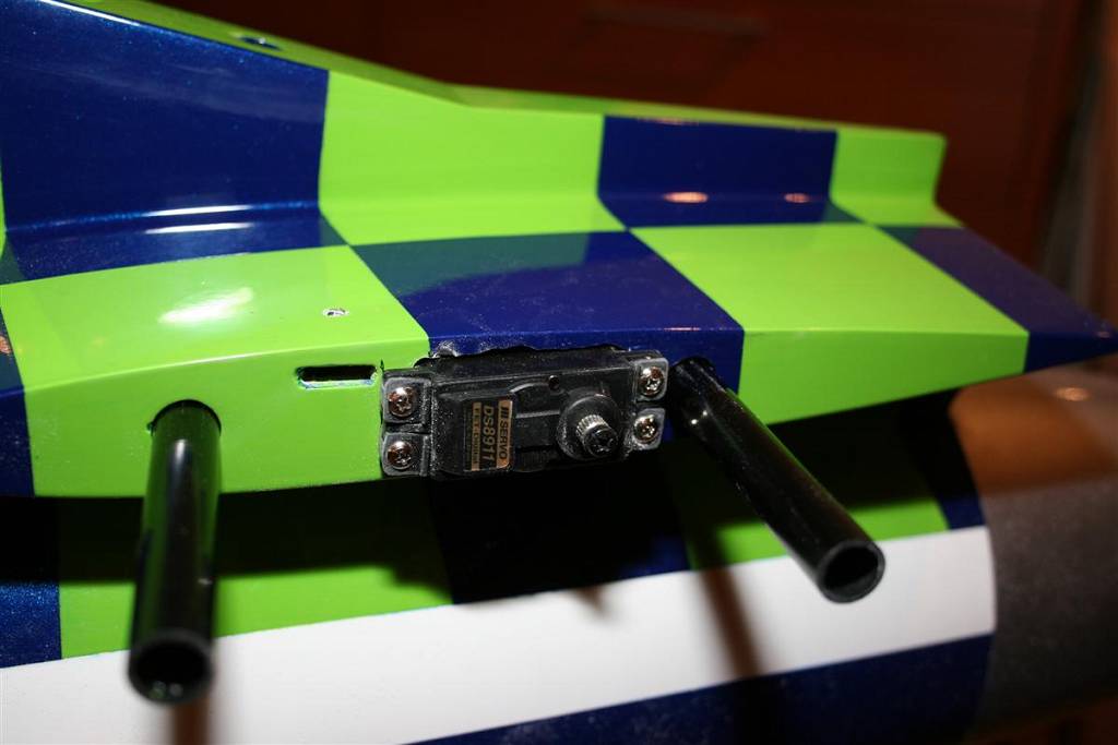

The manual explains to mount the elevator servos in the stabs, I found it very hard to fit them there, and even harder to make room in there for the ply to attach them to.
I choose the fuselage mounting instead, makes it a lot easier I think (and no connectors, which is nice).
Now I'm just waiting for the carbon double horns from Digitech, then I will discover if there is any hardpoints in my elevators []

I fitted my elevator servos in the fuse. It is a much more solid fit. Fitting them in the stab looked weaker & more difficult. I did the same with the rudder.

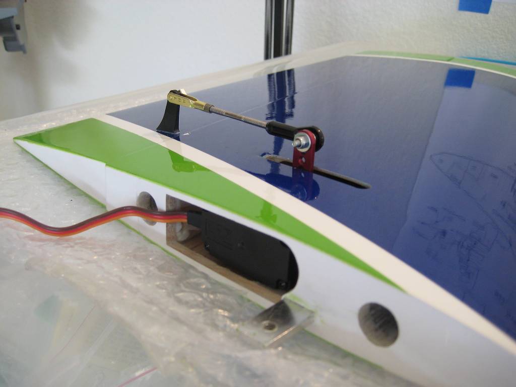

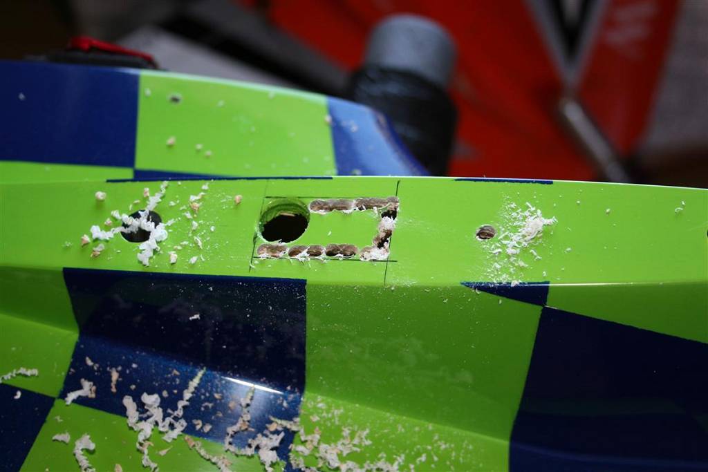

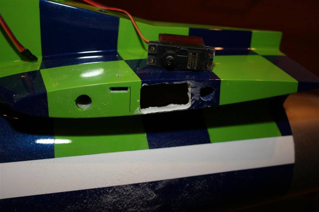

I just started my Viperjet.
Here are some pictures how I manage to attach the 8711 to the stab. Now I have to do the other one.....[] lots of fine carpentry there:

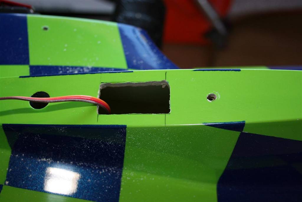

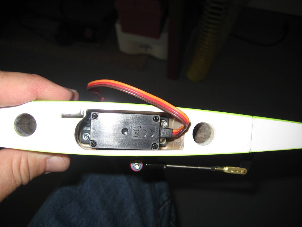

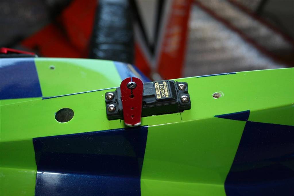

I mounted the rudder servo the same way as the elevators.
Now I'm just waiting for the double carbon horns from Digitech, I really don't understand why Skymaster is delivering the plastic horns they do, they only go around 6 mm into the surface, on a plane that weights around 20..22 Kg !
I would also be afraid that they eventually would crack due to exposure to sun etc ?
All my surfaces will be done using the double carbon horns with a ball link between them, and alu servo horns.
