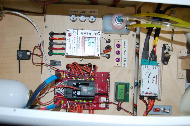

Dirk,
Just to clarify what is happening, here is the simple version:
We store the planes with the gear retracted.
When we turn the plane's receiver ON, the gear wants to extend, which is normal.
In Mode 1, there is no problem, the valve opens the gear AND Doors.
In Mode 2, there is a problem. The gear wants to open, however the DOORS are held shut. This is a problem because the gear could break the doors, while trying to extend.

On power up V1 and V4 are illuminated. Another words, Gear DOWN door CLOSE...AT THE SAME TIME....

My valves and lines are connected correctly, period. The system works perfectly in every way EXCEPT upon system power up. I am going to have to shoot a video because words are not getting it done.
This valve is has a serious design flaw or the ones Chad and I have just happen to be broke in the same exact way.

I have tried it in every possible way. Bound it with gear up, and gear down....
It makes no difference. I have even crossed the up and down lines on the gear. That keeps the gear up on boot up but the brakes done work on extension and the GSF fails the gear to the UP position.
The S/W on this valve is hosed up, period. There is not a mechanical fix for this.

Ok, Made a quick video of the valve in operation, this should clearly show the problem I am having.....

Ok, So both Dirk from Airpower and Myself have confirmed this to be a software glitch in the valve.
I have a shipment expected in house next week containing the EV5U-Pro with the updated software revision. Anyone wishing to swap the valve out for the updated software is welcome to contact us for a return authorization.

We have received stock on the EV5U-PRO valves with Revision 3 software. I have thoroughly tested the new software and can confirm the software issue noted in this thread has been resolved. Regardless of power off position of the gear, the doors now open before gear deployment upon power-up. All valves sent in for replacement are shipping today.

I am trying to set up mode 3, but the front door fires out of sequence. I have the main gear doors plugged into
D2 and the front door plugged into D1.
When I click the radio switch for gear down this is what happens:
1) Main gear doors open. (Correct)
2) Gear Down (Correct)
3) Main Gear doors close (Correct)
4) Front door opens <- This is taking place at the wrong time. I can not get the times set for this to happen at any other time.
When I click the radio switch for gear up this is what happens:
1) Front door closes <- This is taking place at the wrong time. I can not get the times set for this to happen at any other time.
2) Main gear doors open. (Correct)
3) Gear up (Correct)
4) Main Gear doors close (Correct)
Any Ideas? Changing times does nothing on the sequencer.
Thanks Scott
