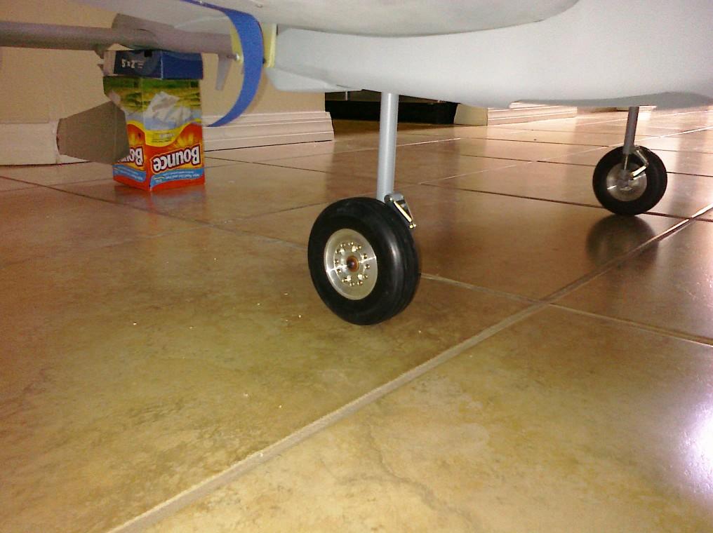

Here are a few pics for reference on the finished verticle stab.
chris

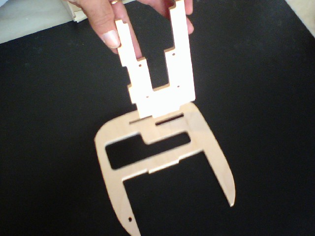

ORIGINAL: siclick33
Chris,
Could you give me an idea where all the wooden formers should go?
Hey sic

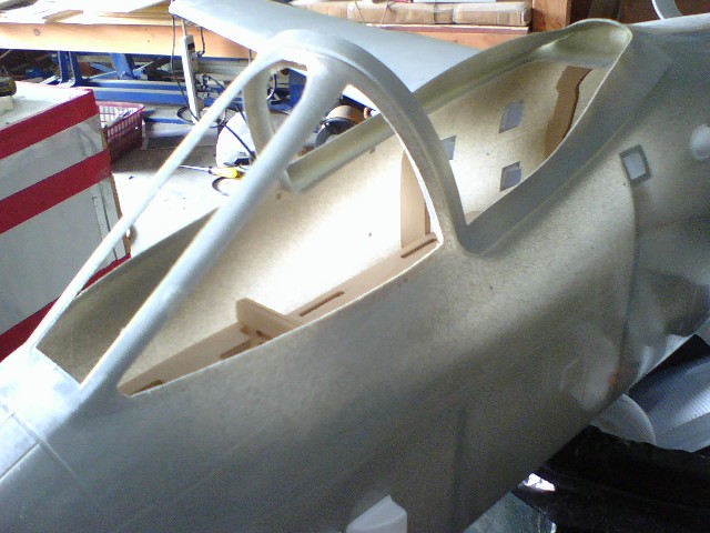

Sorry for taking awhile to get back with you. I have been out of town on some family business.
Here are some pics of the nosegear area formers. All these formers fit together like tongue and groove and will be tacked with CA into place. Before doing this, do a dry run to see where you need to scuff the inside of the fuse. Tack them in place and when you get your retracts in and working properly ,you can glue them in. I used west sysem mixed with colloidal silica and some 1/8" chopped glass but you can use what you feel is best.
chris

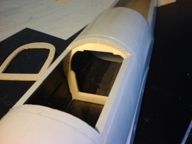

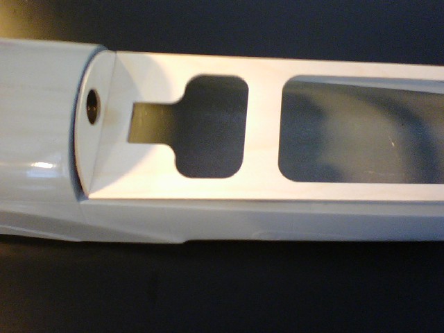

This former goes on the inside flange at the back of the canopy area. Their are some notches cut out for the avionics vents and needs to be put in accordingly. You will want to put these vents in before putting this former in.
ID:	1262680   Click image for larger version
ID:	1262681   Click image for larger version

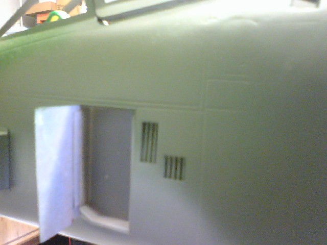

This former sits inside on the front side of the fuselodge hatch flange. You will need to watch the angle on these because the wing pins slide through the fuse in this are. You can tell where these pins go through by looking at the outside of the fuselodge wing area. You have a pin, 1" wingtube and another pin that need to be drilled out. I believe the pins were 5/16" k&s aluminum tubing. I used the dremel with a small router bit to cut out most of the area where the 1" wingtube slides through. There is a sandwiched piece of wood ply in the wing area with a 1" hole cut into it. When you get most of this are cut out, slowly trim it out just up until you hit the ply. When you are done you should have a 1" hole that the wingtube slides into.

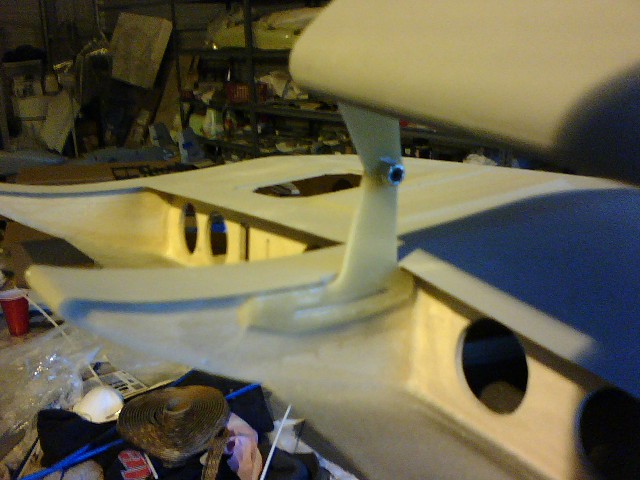

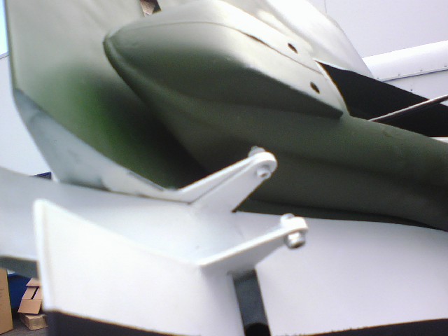

These are the flap hinges. There are 4 hinges per flap. Scuff the area to be glued. The skinned area of the flap will need to be marked and notched out where the hing slides in so it can be glued to the ply area of the the flap.You will want to put the hinges on the actual flaps first. You will line up the bottom edge of the glued area of the hinge with the bottom profile of the flap and fully forward. It does not need to be right up against the wing skin. You can have about a 1/32" gap from the bottom and front of the flap skin. Next, you will put the hinges in the flap wells after you line them up where you want the flaps. You can put each pair of hinges together with the bolt and locknut to line everything up better.
The real A10 has big gaps where the flaps meet the wing area. Dont be alarmed when you see the gap when you begin to align them, it was just me trying to make it look more scale. Just space them evenly.

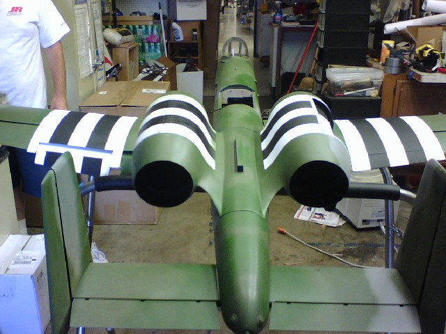

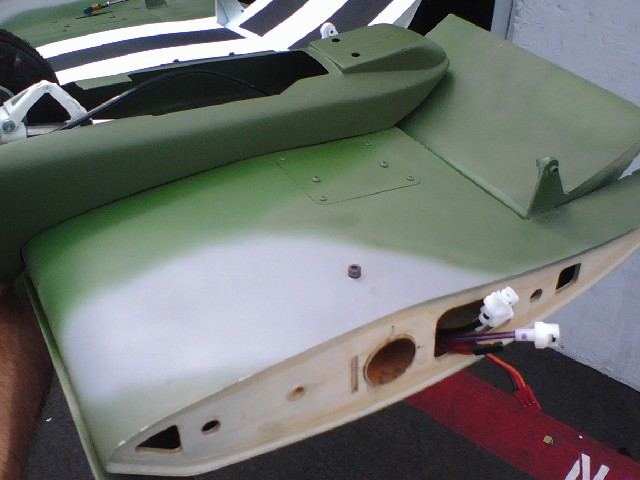

Here are a few pics of one that Ty from Florida is doing. He is using hoye fans with scorpion motors. The tamjets aluminum wheels go good with the A10. Thanks for the pics Ty.
chris
