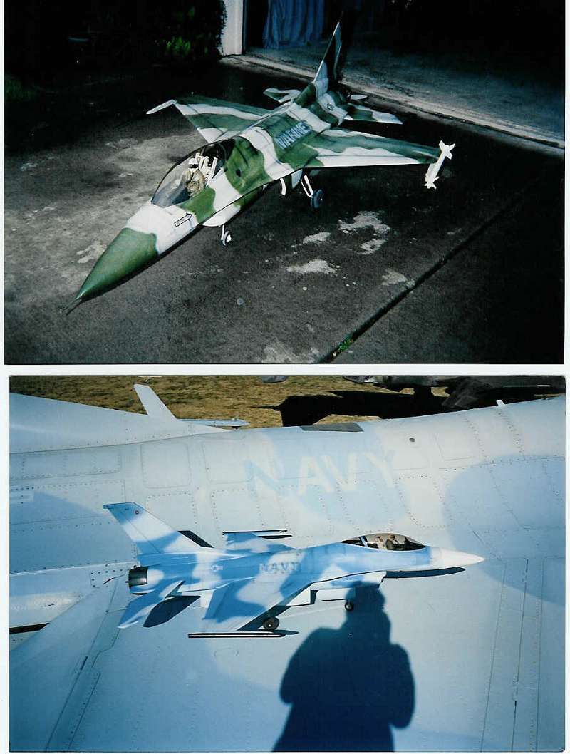

My old CBM SQDN.
Will

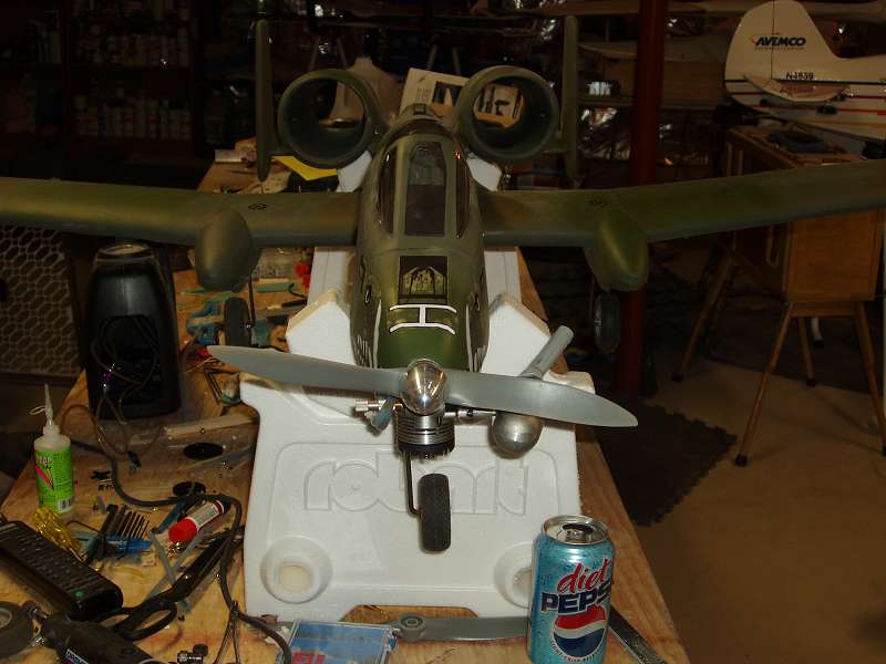

I solved the CG problem by relocating the motor to the nose of the A-10. Cg is right on the money and the plane weighs 7 pounds, looks were sacrificed but it should fly well.
