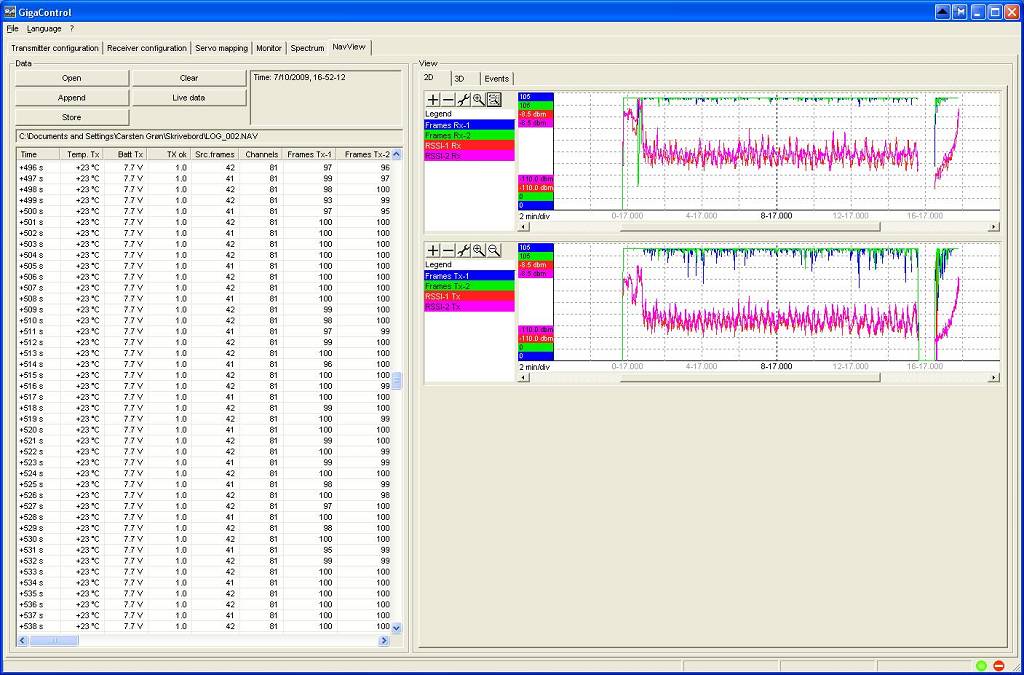

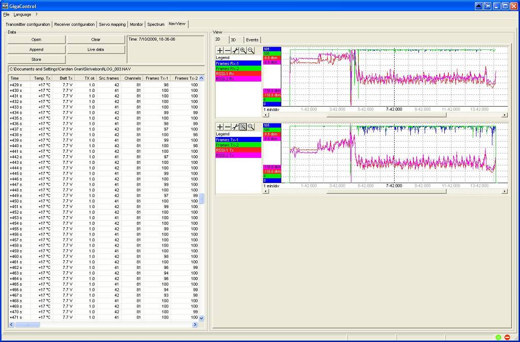

Hi Oliver,
I mounted a 12 channel micro reciver in a small prop delta plane (an outlaw), if it went down, it would only be a propplane [:'(]
It looks as far as I can see ok, the dropout at the end of the first file is due to landing off-field (around 100 meters from myself, when I walked to get the plane, I placed the transmitter on the ground, and I assume that the TX got no frames back from the plane then. I picked up the plane and walked back to the transmitter, and the signal increases again.
Can you have a look and see if the data looks ok ? (I can send you the data via email if I can have your address ?)
Transmitter is a 14MZ

I sent the data to your email a few minutes after you responded, let me know if they did not make it thru

Hi Carsten,
Your files are showing the following results:
Flight 1:
Lowest RSSI 1 rx:-76 dBm
Lowest RSSI 2 rx:-76,5 dBm
Lowest frame rx1:93
Lowest frame rx2:92
Average RSSI rx values: -65,5 dBm
Failsafe 0
losses of feedback communication ( 136/168 events ): 0
Lowest RSSI 1 tx: -87,5 dBm
Lowest RSSI 2 tx: -89,5 dBm
Lowest frame tx1: 69
Lowest frame tx2: 82
Average RSSI tx values: -80
Flight 2:
Lowest RSSI 1 rx:-79,5 dBm
Lowest RSSI 2 rx:-72,5 dBm
Lowest frame rx1:95
Lowest frame rx2:94
Average RSSI rx values: -68 dBm
Failsafe 0
losses of feedback communication ( 136/168 events ): 1 for 1 second.
Lowest RSSI 1 tx: -88,5 dBm
Lowest RSSI 2 tx: -85,5 dBm
Lowest frame tx1:83
Lowest frame tx2: 91
Average RSSI tx values: -78 dBm
These are the best results I have seen so far. Of course it is not a jet and the flight distance must be shorter. However your system is fully GO.
Let me know how it performs on a jet to see the difference ( EMIs are higher on a jet due to the ECU and more elctronic devices fitted )

Thanks Oliver !
Yes, my initial impression was also that they looked fine, just needed confirmation from a pro
The receiver was "mounted with a showel" inside a small (but very fast) delta wing (1,3 Kg, with a 9x8 prop running at 17K RPM), and I regard this airframe as "a no loss" should "something" happen
Both flights was actually going out far away (at least 400 meters to each "side"), I choose this plane also because of the "easy to see" shape, so I know I can follow it far away.
I will play a little more with it, and then mount one of my 12 channel micro receivers in my P160SX powered Elan, that one consumes a lot of airspace pretty quickly
Thanks for your help (and especially this thread), it's much appreciated, and very comforting with a group when this new technology comes out!
Now, if just Weatronic would step up to their customer support, and start answering emails !?!?!

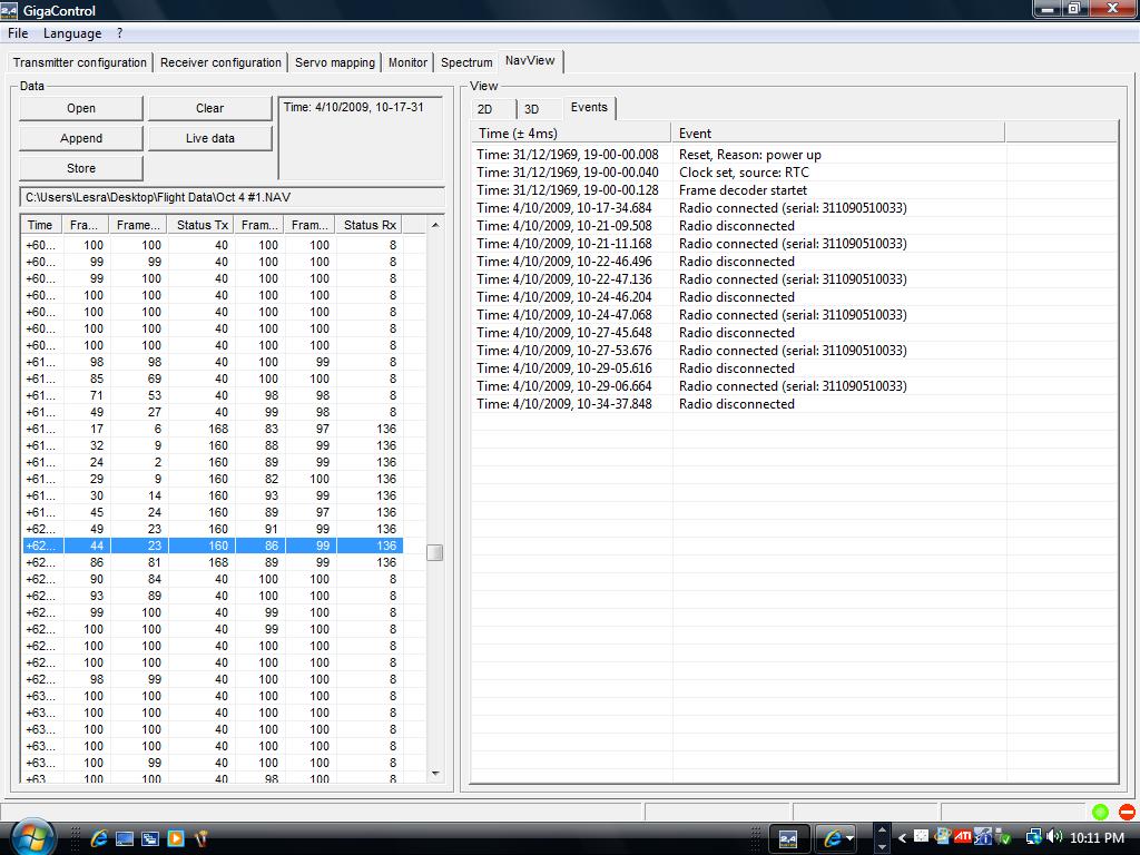

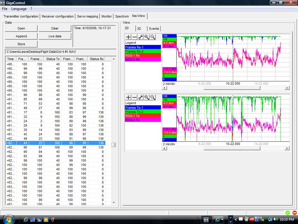

Hello Stripe. Welcome to the Jet forum by the way.
Here is the analysis of your data:
Lowest RSSI 1 rx:-84,5 dBm
Lowest RSSI 2 rx:-84,5 dBm
Lowest frame rx1:75
Lowest frame rx2:78
Average RSSI rx values: -67,5 dBm
Failsafe 0
losses of feedback communication ( 136/168 events ): 5 for a total of 17 seconds.
Lowest RSSI 1 tx: -127,5 dBm
Lowest RSSI 2 tx: -128,5 dBm
Lowest frame tx1: 0
Lowest frame tx2: 0
There was a difficult downlink event at 3'38'', shortly after your takeoff ( possibly someone masking the transmission line ? ).
Apart from this event, the data shows:
Lowest RSSI 1 tx: -102 dBm
Lowest RSSI 2 tx: -110 dBm
Lowest frame tx1: 25
Lowest frame tx2: 27
Average RSSI tx values: -83,5
This seems to be a normal result. What is important to check ( in bold ) is the minimum Rx frames. Yours show quite good values, even during this event at 3'38''.
So your control link ( uplink ) is strong and good.
Also note that you get quite a few more downlink disconnections than usual ( 5 events for a total of 17 seconds ). This is also due to a partial masking of antenna 1.
Just check that this event does not happen too often, or you might want to change the position of antenna 1 ( the one that is on the left side looking at the receiver from the back ).
Your feedback link ( downlink ) is a bit on the weak side but nothing to worry about ( this is why you get so many disconnect events on the event tab )

Lowest frame tx1: 0
Lowest frame tx2: 0
Thank you very much it's beginning to make sense now, all I need for Christmas are more receivers to convert the rest of my stuff.
keep up the good work
