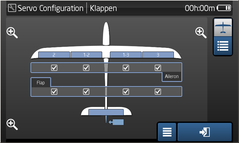

My next challenge is to work out that small curve edit screen for each servo. at this stage I dont think the presets are a lot of use, but time will tell.
The problem I have is trying to make the curves do what I need, Unlike gigacontrol where you have a large screen to deal with and it is easy with a mouse.
So if any one has sorted out how to do it easily please let me know.
Ross
Ross
Editing the servo curve with the BAT UI is a different method than Gigacontrol. As easy to do in fact.
I like presets a lot. Most of the time I come to realize that I just need 4 points along the curve to align multiple flight controls. The preset gives me the ability to edit 4 points on the curve really easily.
Here is the method I use.
First enter the curve edit mode.
Then select the non-global option ( to edit the curve with point, not to move the whole curve ).
Then enter the preset menu.
Select the 4 point curve preset.
Then move the current point along the curve with your stick or knob till you reach the point you want to edit. It will highlight with a thin red circle.
Then hit the "select" button. The highlighted point will turn solid red.
Now you can adjust the output value with the "+" and "-" keys. Note that you will need to keep your stick at the current position to check the effect on the point live.
A complete curve can be edited quickly with this method.

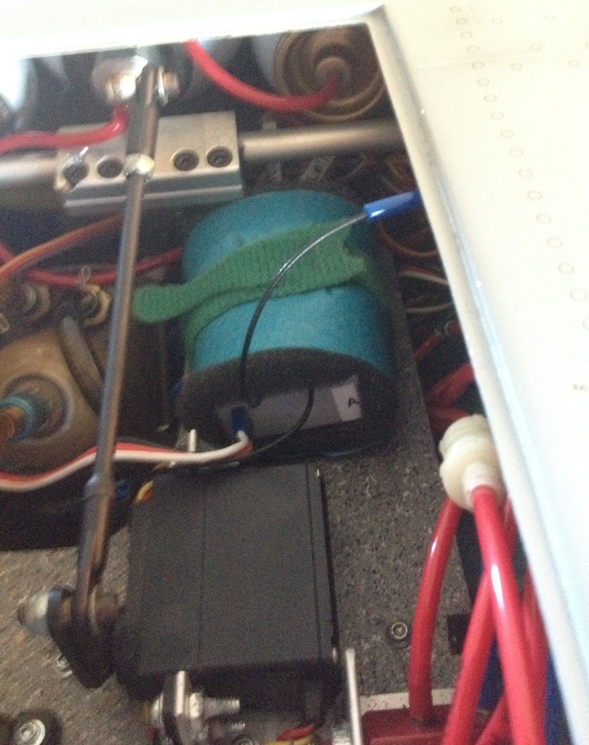

I am setting up my Paritech Nimbus 4, it needs 15 servos, BUT a 12-22R (Gizmo) is too big, it doesn't fit .
So I am working my way through with 2 Micro 12's it is a good learning experience and so far going ok. All the surfaces are set up and I am to the point of attaching wings etc
and making sure the directions and throws are ok.
With Gigacontrol and the Gizmo I can check current draw, which is very useful when setting up Items like retracts and flaps .
But with the Micros how can I check the current and make sure that the servo and batteries are not being overloaded??
Ideas please

Ross,
I have just installed a Micro 12 in my Paritech DG 303, no room for a Gizmo despite its size. I used a couple of JR matchboxes to expand servo outputs to air brakes, rudder servos , pull, pull, and as a power source for the gps and vario modules.
During set up I inserted a Hangar 9 volts/ammeter in each servo line, to check amperage, works v well. For total current draw just insert the meter into a battery cable .
Giga Control made precise set up just so easy, and even the tiniest adjustment can be seen to affect the current draw on the meter, more accurately than on the Giga readout, particularly good for setting the closed position of the air brakes.
The entire DG is fitted with JR. HV servos but running at 5.9 volts from the Powerbox sensor switch.
David.

Thanks for the comments, What size is your DG303?
I have one also but I managed to fit a 12-22R..

My DG is 5m. There would be room for the Gizmo BUT the space is occupied by batteries for the Florian Schammbeck power unit. Later this winter, I will arrange a quick change unit for a Wren Supersport, so it is self launching in two forms. I had some Matchboxes spare, cheaper than a second receiver !!
My BAT will be here as soon as the latest firmware is installed.

As David suggested, you need a Hangar 9 amp meter for synchronization or limit setting.
Note that I would highly recommend you to set the servo limits in the list view of the servo configuration menu. Once set, this limit cannot be passed by any condition or mixer.

Thanks for reminding me about the use of an ammeter, I remembered I made one up years ago, and I used a multimeter on the current setting.
So I have just started to set the control surfaces using the ammeter.
As limits, I wonder why the preset servo limit is 125 plus and minus, surely 100 would have been better as a starting point, as only very seldom have I had to use more than 100 on any plane.

The term function with the BAT 60 refers to channels.
You first need to assign your flight modes to switches from the flight mode window. Look at page 29 of the user manual for this.
Then offset your functions, change the curve for each flight mode from the function window. You can do this inside the wizard process or afterwards by selecting "model setting"->"functions".
You need to select the flight mode first from the previously assigned switch before changing the curves/ offsets.
