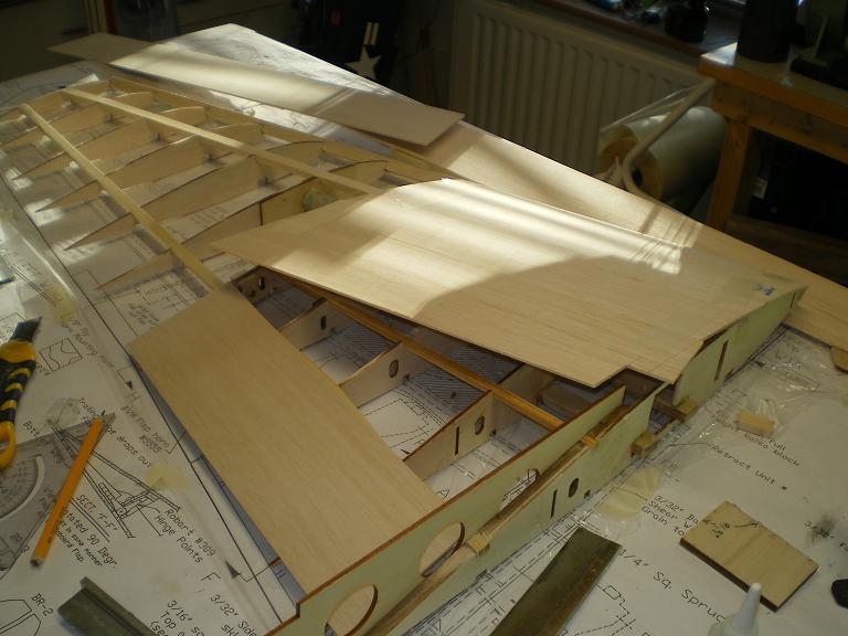

The preliminary efforts to cut the wing skin.....

Dave, the wing is more or less straight forward. So far I haven´t encountered any problems...but I´m moving forward rather slowly. All servos and rods as per Mr. Sterners drawings..

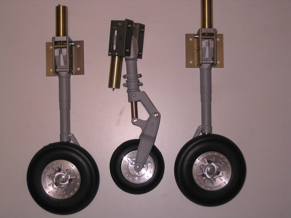

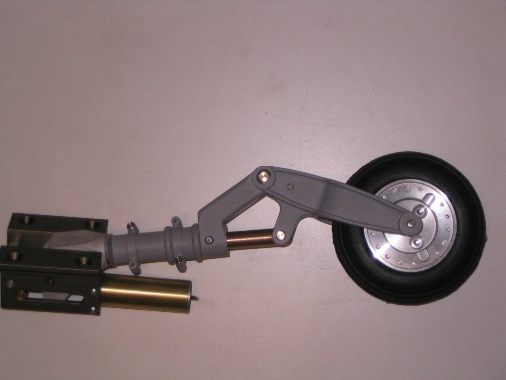

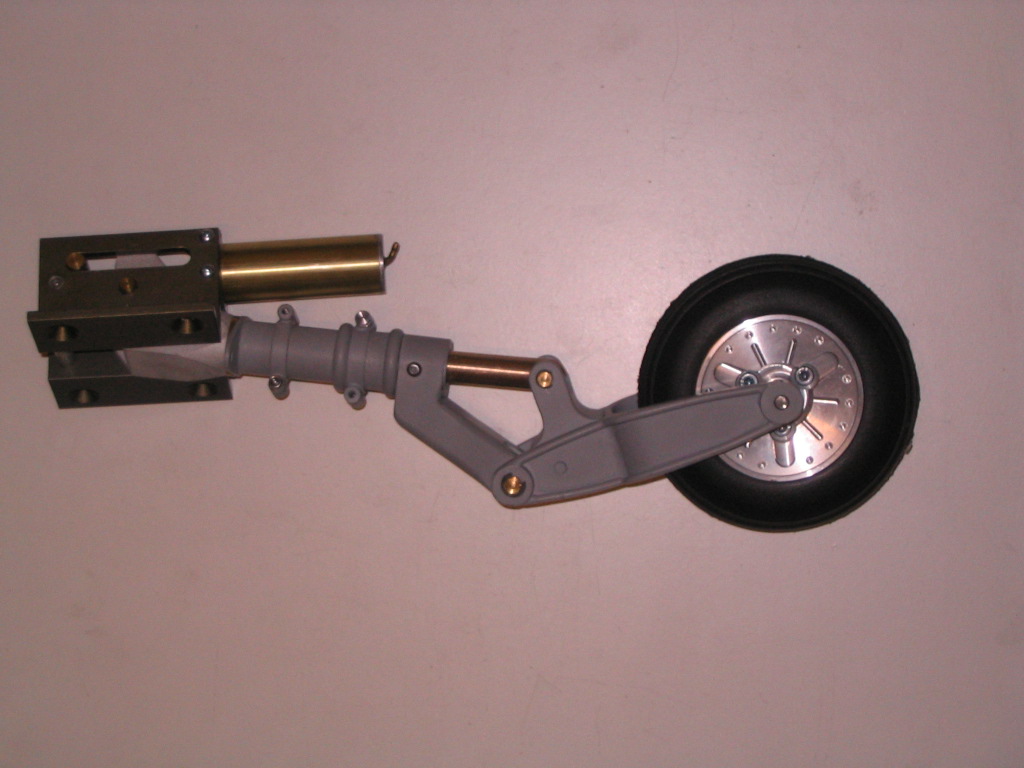

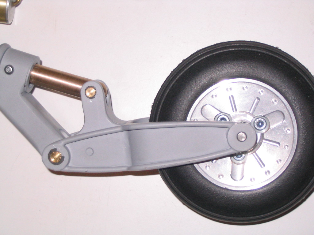

Just want to show the first Hawe scale gear for Kerry Sterner Vampire 1/4!
Also possible for 1/5 and 1/6!
Regards, Henk

So far I have got a set of retracts from Umstech in India. It´s hydraulic and looks ok!
Regards
Pete

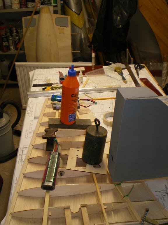

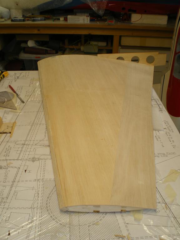

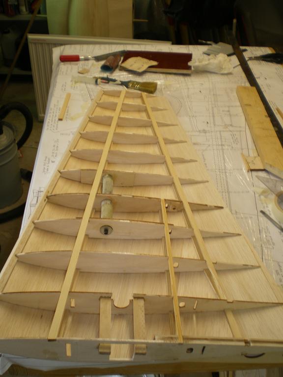

I´m slowly making progress on the left wing panel. I have glued the wing skin onto the ribs and spars on the top. In two steps... first the inside skin up to where you take the wing apart, and then the outer skin. Using white glue..except when starting, using cyano to secure the front edge of the skin to the leading edge spar.
Turned the wing upside down and glued all the spruce spars in place...using whatever was heavy to press the spars down into the notches...
