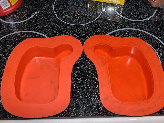

Here are a few Photos of a Plug I made for Smoke tanks on A Fly Eagle F-15.
First photo plug in place in Fuse.
Second photo first layer of fiberglass cloth with Epoxy resin.
Third photo Heavy code of Bondo after fiberglass to make smooth. Most of which was sanded off
Fourth photo first half of mold being laid up.
Fifth photo first half of plug made.
Final photo finished Mold. The lines in the orange is because I could not find my Dump gun so I had to brush on the gel coat.
Its not a hard process but it does take some time sanding and getting the plug smooth. The finished part will only be as good as the plug.
Hope this helps.

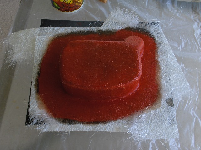

I am not sure by your post if you are making a male plug to use to make a female mold or if you are going to try to make a finished part off the foam plug.
If you are going to make a female mold off the plug, do as Butch says. Lay up the plug with epoxy resing and glass cloth. The glass cloth needs to be fairly thick (stiff) so it doesn't flex too much when sanding the glass. I recently make some tank molds and only used two layers of 3.2oz cloth and the foam would flex when sanding and caused me a lot of work to get a good finish.

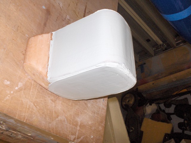

Thank you all for your help and advices... I am producing a male plug to create female moulds to pull off castings...
I had moved on to glass the plug with finishing resin. I forgot the weight of the cloth but it has the same thickness as t-shirt material... I applied a second coat of resin to fill the gaps in the weave and when it had dried, I wet sanded the entire plug with 400 grit sand paper.
I located some low spots in the sanded plug. I will follow Bill's method of coating the entire plug with a thick layer of putty... I have no success locating bondo putty in Singapore.. so I am testing various brands of putty to find one which is easy to spread and will sand well... the pics show the plug after sanding down with 400 grit sandpaper and the various putties I am testing.
By the way, is there a trick on how to lay an even coat of putty into the plug?
