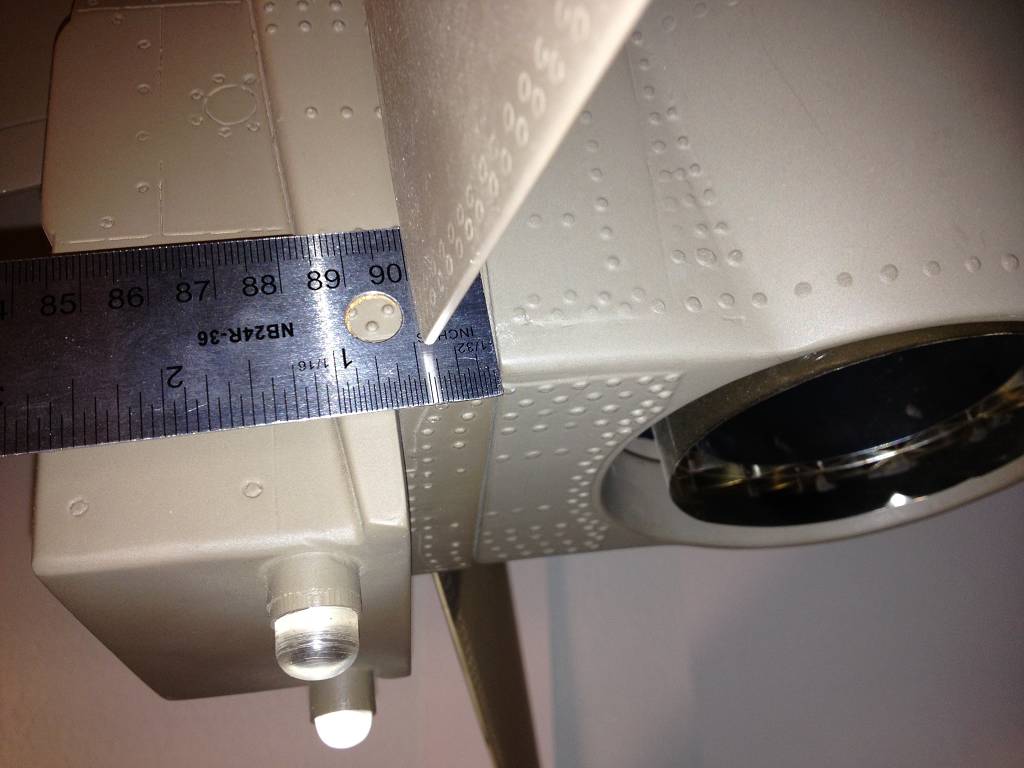

Again, I ask if there is anyone that can post a good clear picture and measurement of the Hawk's stab neutral flying position during flying ?
Here you go.
#327
My Feedback: (21)
Thank You Colin and dubd for the references and Pic.
I had set mine up to the suggested position in my BVM manual which is 1 1/4" below the double row of rivets. This just did not look right to me, and after seeing dubd's pic and a couple of pics i found early in this thread from Colin's suggestion. Don't know how I missed these pic earlier. I have come to the conclusion that that 1 1/4" reference can not be right. So I will go back and readjust my stab's neutral to match this info.
The suggested position and what the pics show as positions, my stab if off by 5/16". This would have used up all of my trim adjustment on a maiden that could have been a problem.
Thank You for the help guys.

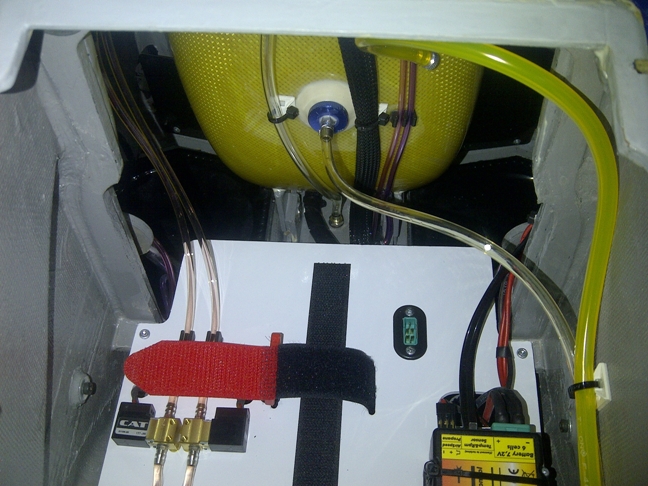

Well, I decided to go the hard way and did what Inconel did.
It's hard to understand why SM puts the fuel tank 4in. ahead of the CG. Maybe it is because they recomend a very forward CG
I cut of the intakes and install the fuel tank near the CG. That way it will have less to none CG variation during the flight. Also because I have a heavy cockpit with double animatronic pilots, I need a bit of weight in the rear, so decided to move the turbine a bit backwards. My goal is to have a CG at 215-220mm without any weight
I'll post pics next time.

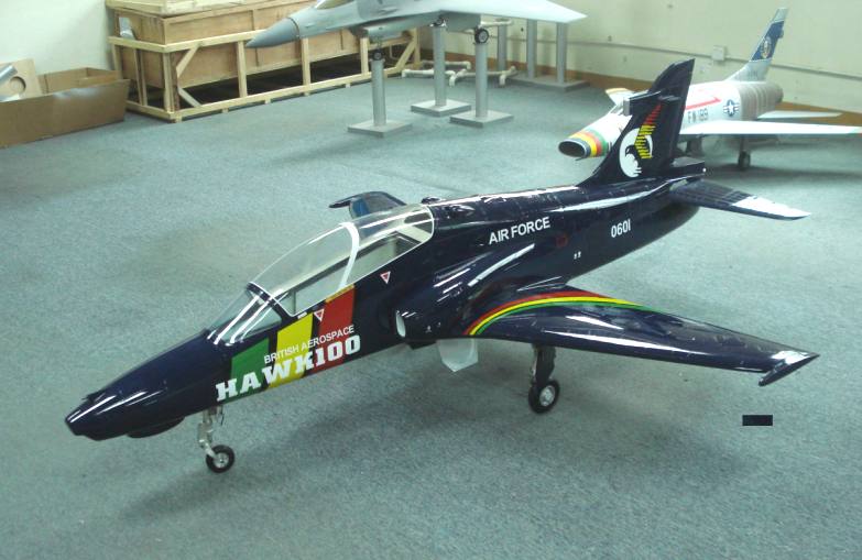

Thanks for the quick reply Anton, This is my first jet, the Hawk 100 will be my first jet build also, and this thread is going to be very helpful,I would like to thank to all the builders and pilots who have contributed to this thread. Hopefully my hawk is being built as we speak, this is the worst part ,the waiting for delivery(LOL).
If any one has any suggestions I would really appreciate their input, Dustin from Jetaddiction.com ,Pablo Fernandez and Rei Gonzalez, have been a great help,in choosing the equipment needed. thanks
J.C. Alvarez
This is the Scheme I chose
J.C. Alvarez

Awesome, Now I don't have any doubt of how my plane will look , Justin from BVM said that he does not recall selling that color scheme in the U.S. now the wait will be a little easier knowing how good it will look.
Thanks Anton for the info
J.C. Alvarez

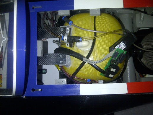

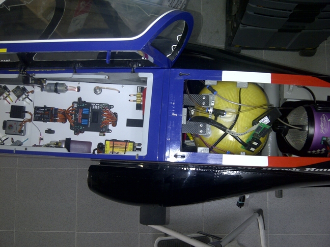

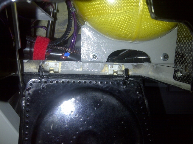

Hi Dave
here are some pics about the mod I made. The CG at 215mm still a bit forward, but drop landing had to do with blanked elevator at full flaps- too much exponencial. I used the same expo settings as in the F18 and proved wrong
I plan to move the CG a bit more in the rear at 220mm, maybe even at 230mm. When rolled inverted in other flight (gear retracted), the plane pitched down when inverted, so I guess 225-230mm will be fine. This is a long way from the original 190mm recommended by the manufacturer. No pitch change during flight as "fuel goes by" with tank install near CG. Downside is that main gear doors open because fuse pressure is higher without intake. I have already ordered the BIG Robart cylinders for the job[8D]
Regards
Nuno
Regards
Nuno

I turned my tank 90 degrees so that I could get the door cylinder to work (U.P. 2 inch stroke) and to continue to use the inlets.
I will have to take some pictures..
