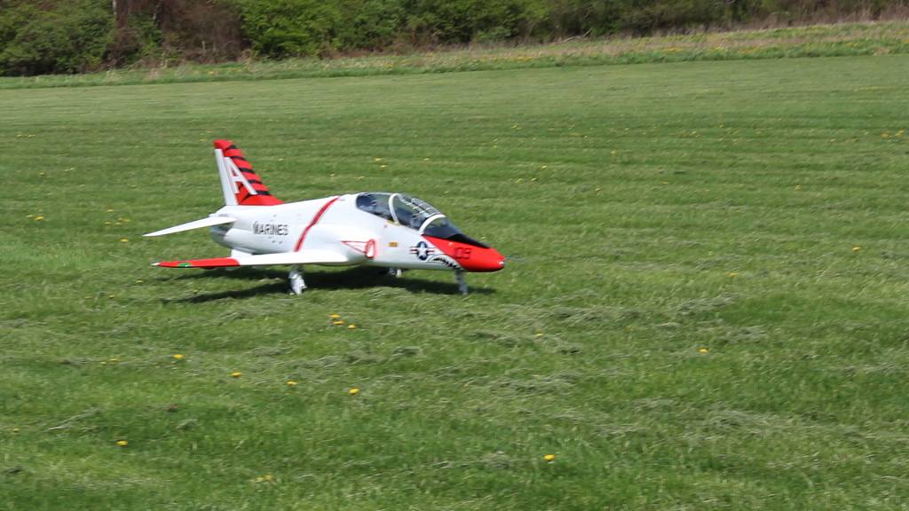

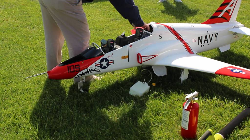

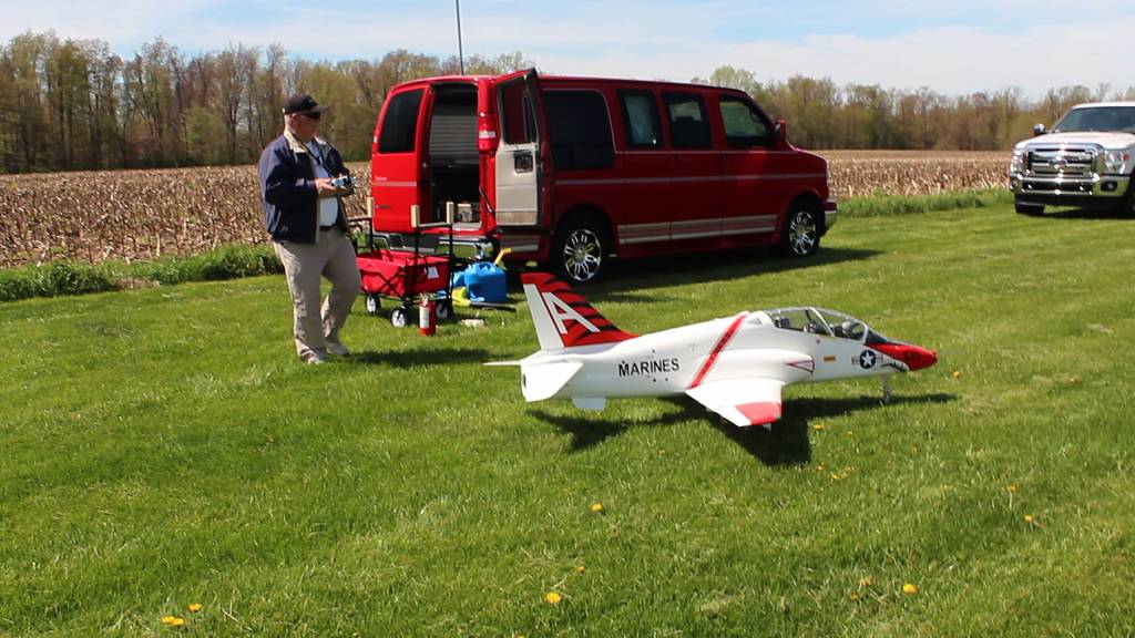

Well, this past Fri I did my maiden flight on my new large SM Hawk. I must say, I am totally happy with the plane. Flight went very well. I moved the CG forward to 220mm back from LE and the later flights were exactly want I want for a setup.
I have a total of 7 flights and to me the Jet Cat 180 is to much for my liking, so today I switched out and put a Jet Cat 140 in and will try to fly again tomorrow.
Overall, the flights were fun even with the last flight ending with a dead stick.

Hi Joe
Congratulations on your maiden.
Did you flew it inverted with CG at 220mm? If so, did you use elevator input to fly level?
Regards

Yes, I flew inverted and yes it took some input on down elevator. Hard to say how much because I use less down ele. than up.

So, still a bit nose heavy... maybe 225-230mm, that´s my guess where the spot point is.

I did the first flight at 230mm cg, but I did not quite like the feel. I moved my batteries forward and am at 220 if not maybe 222mm. I like the feel for me better now. My takeoffs were exactly what I wanted with the nose gear liftoff with the mains following shortly afterwards. Nice scale looking takeoffs. The landing were nose high also but flying off grass, the nose gear settled quick because of the grass being thick and taller then normal.
