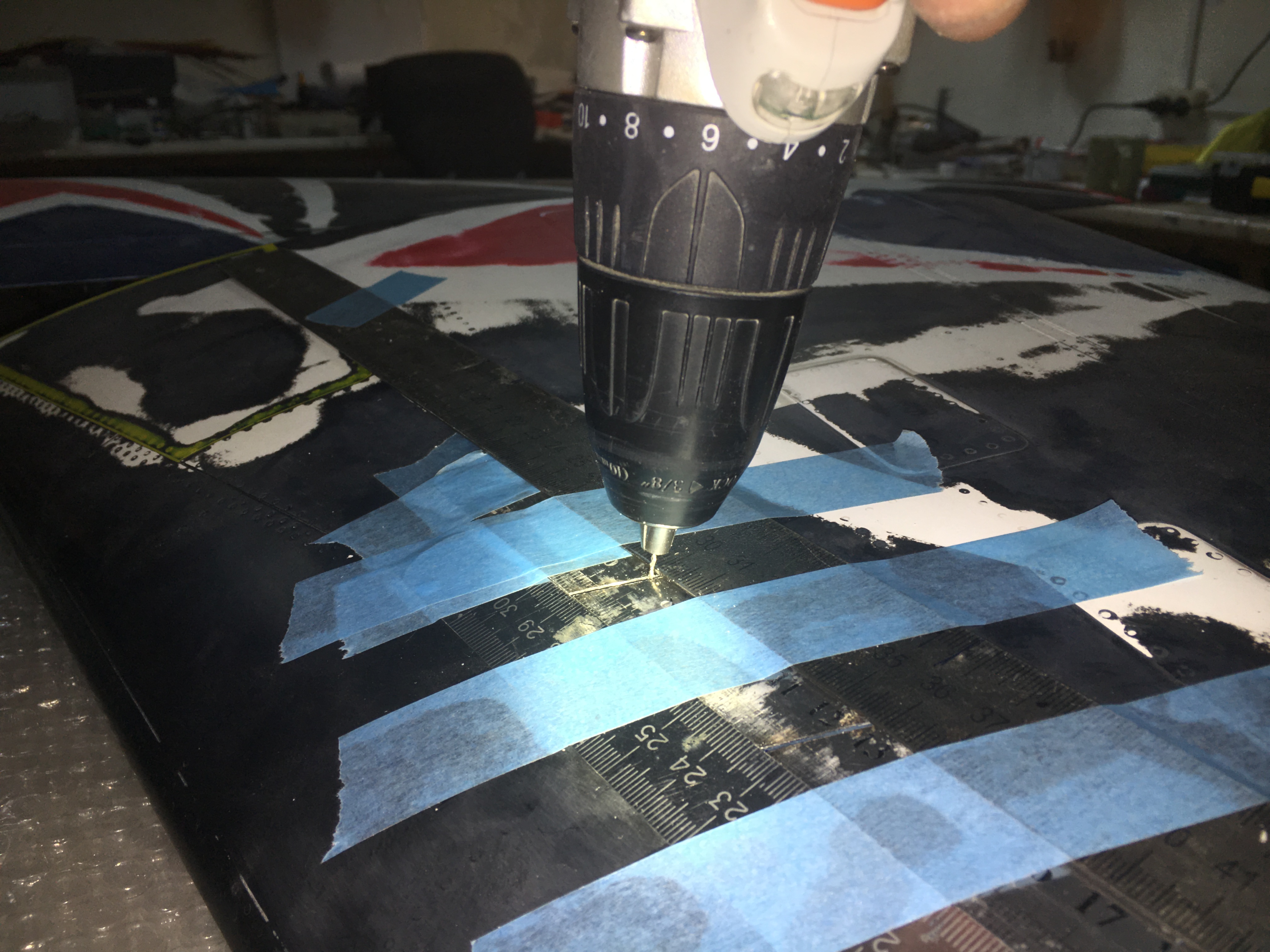

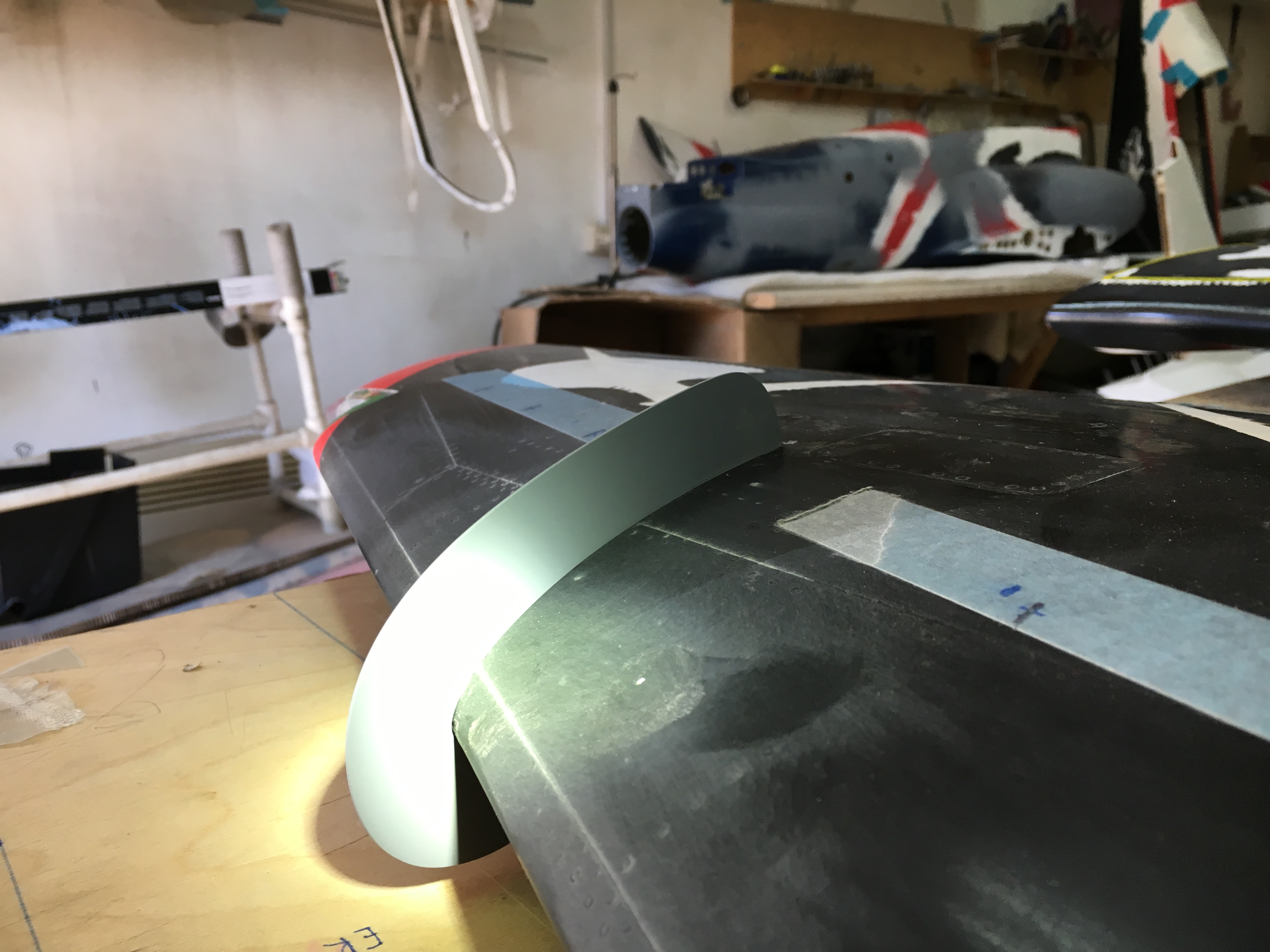

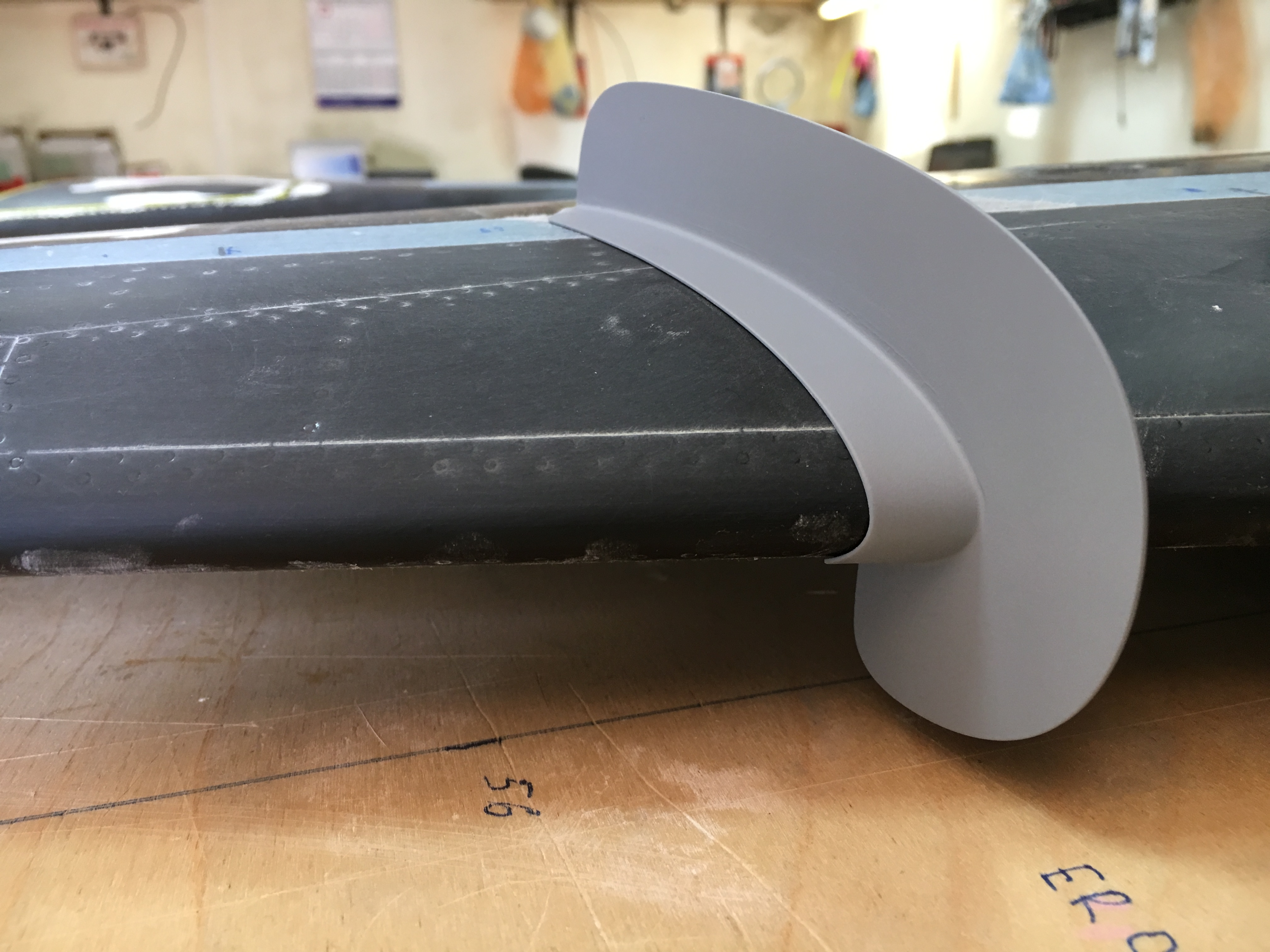

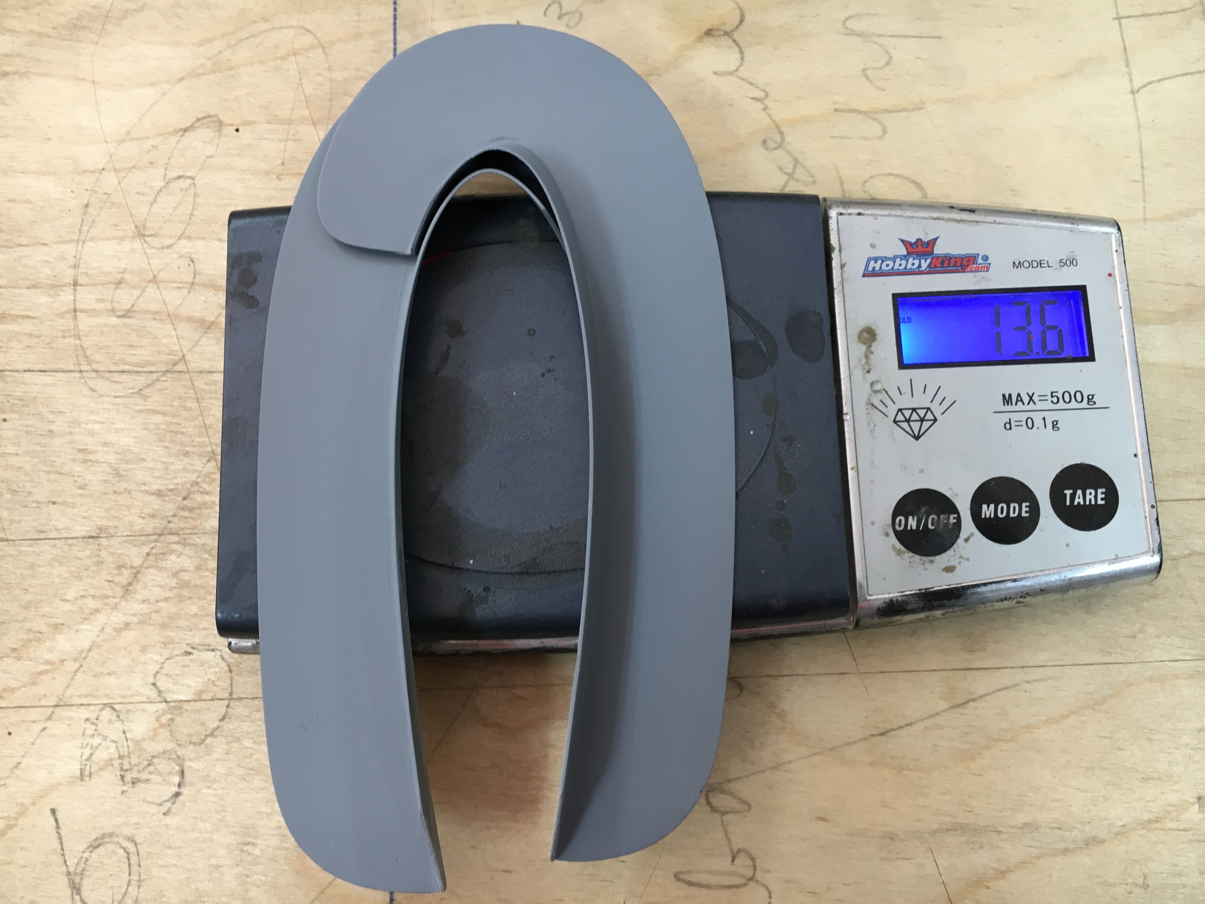

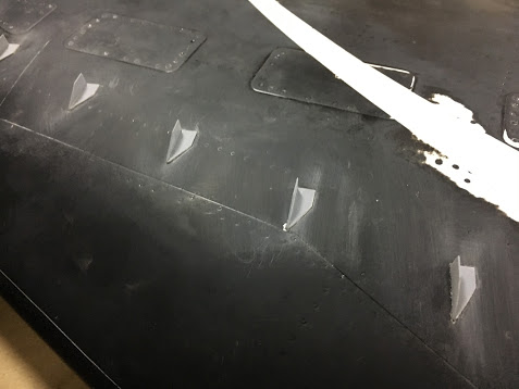

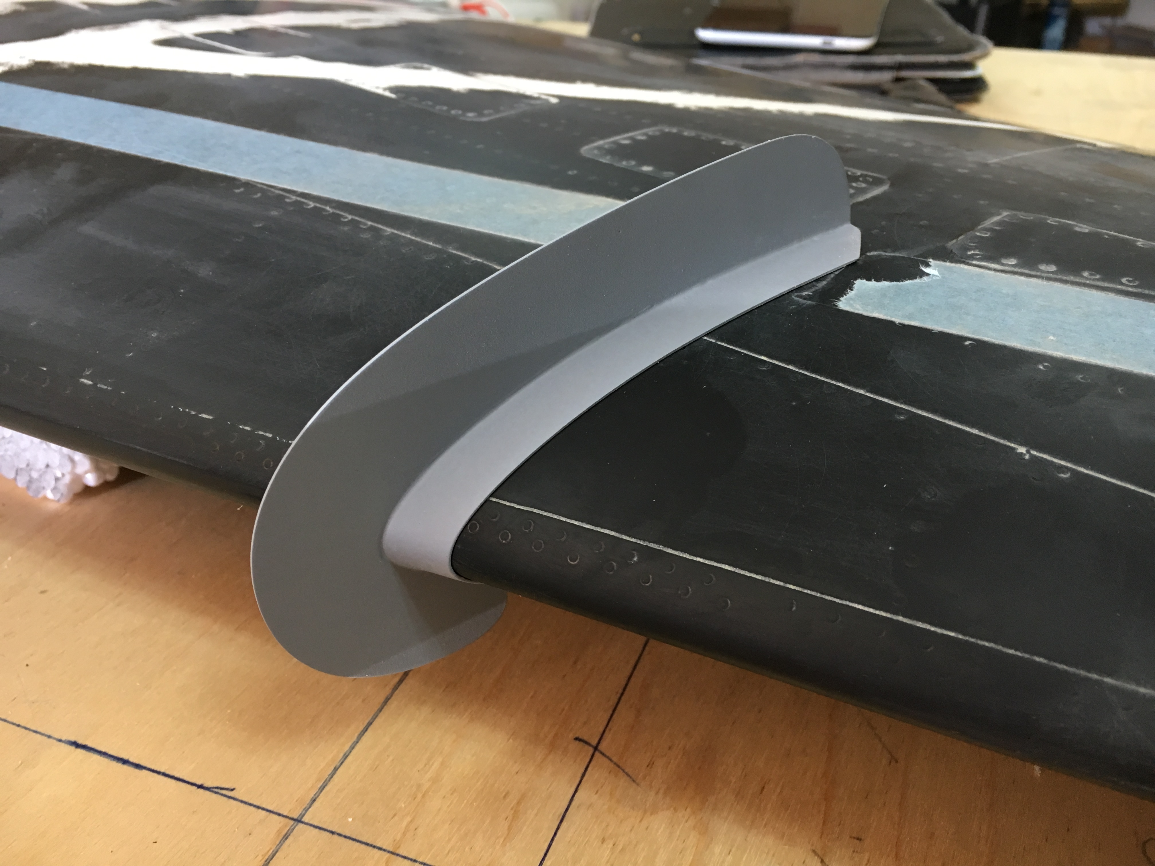

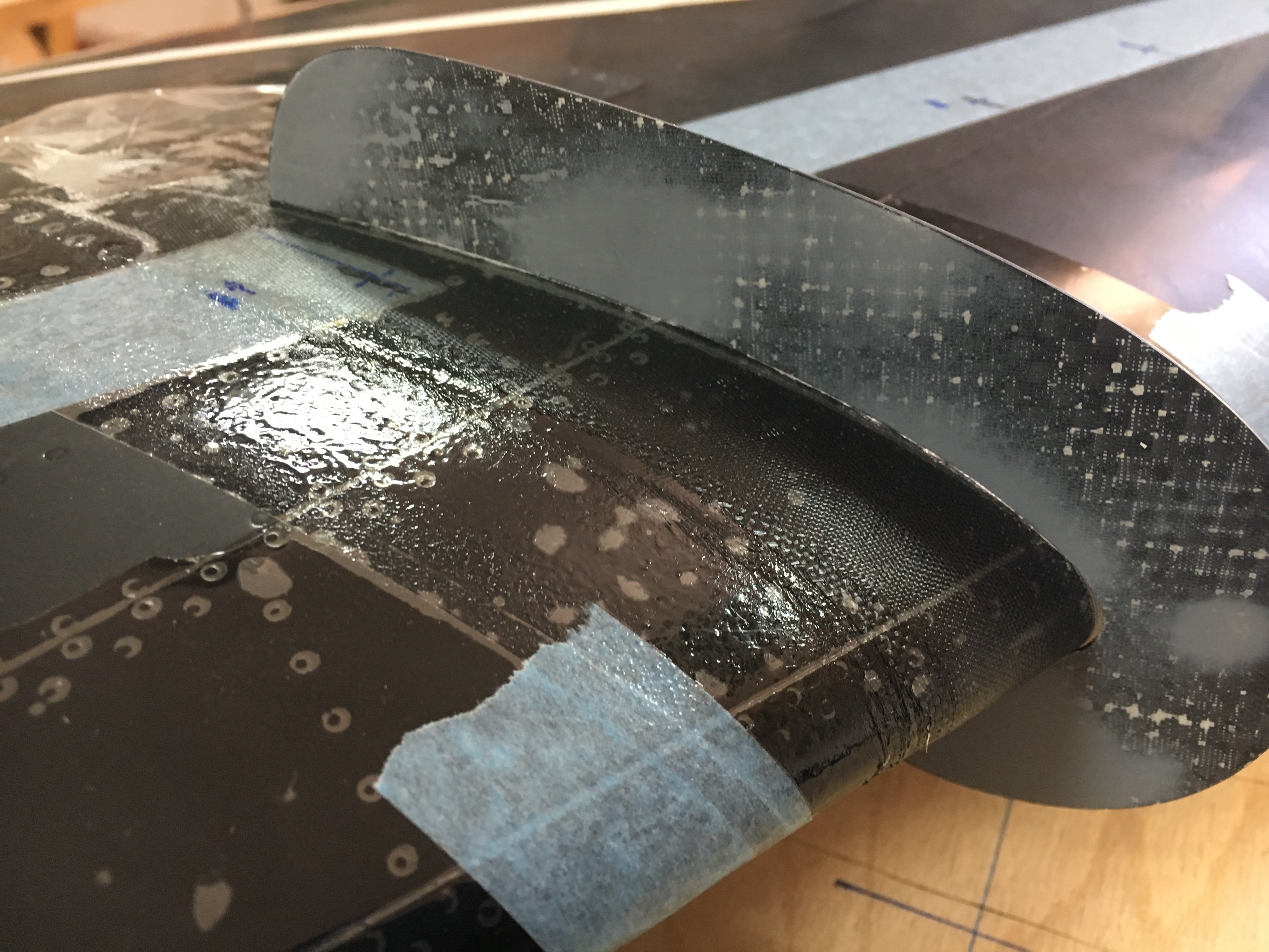

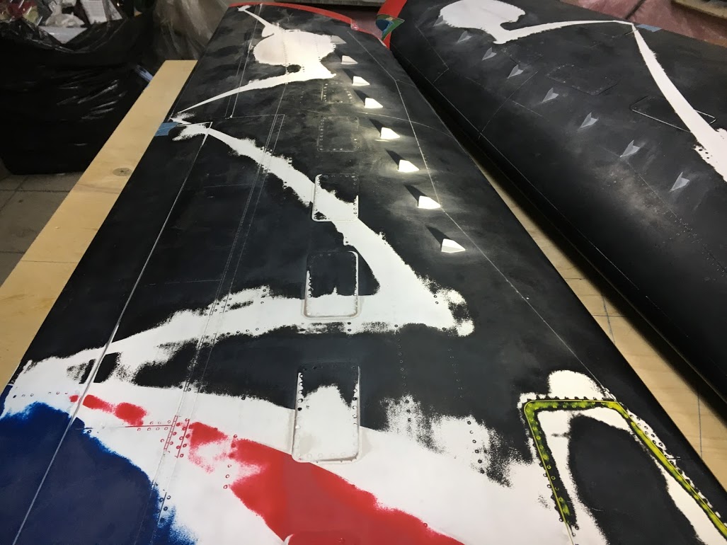

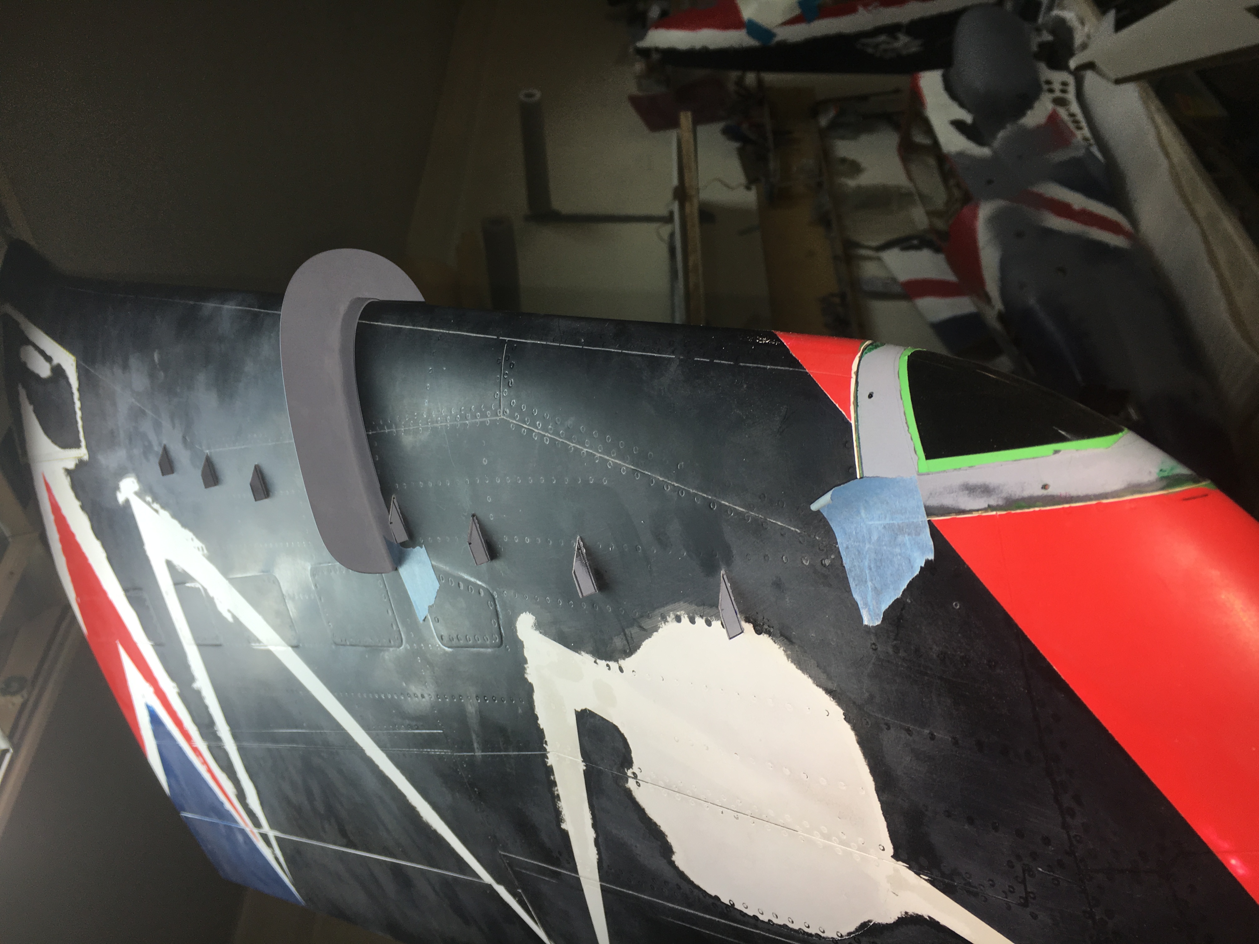

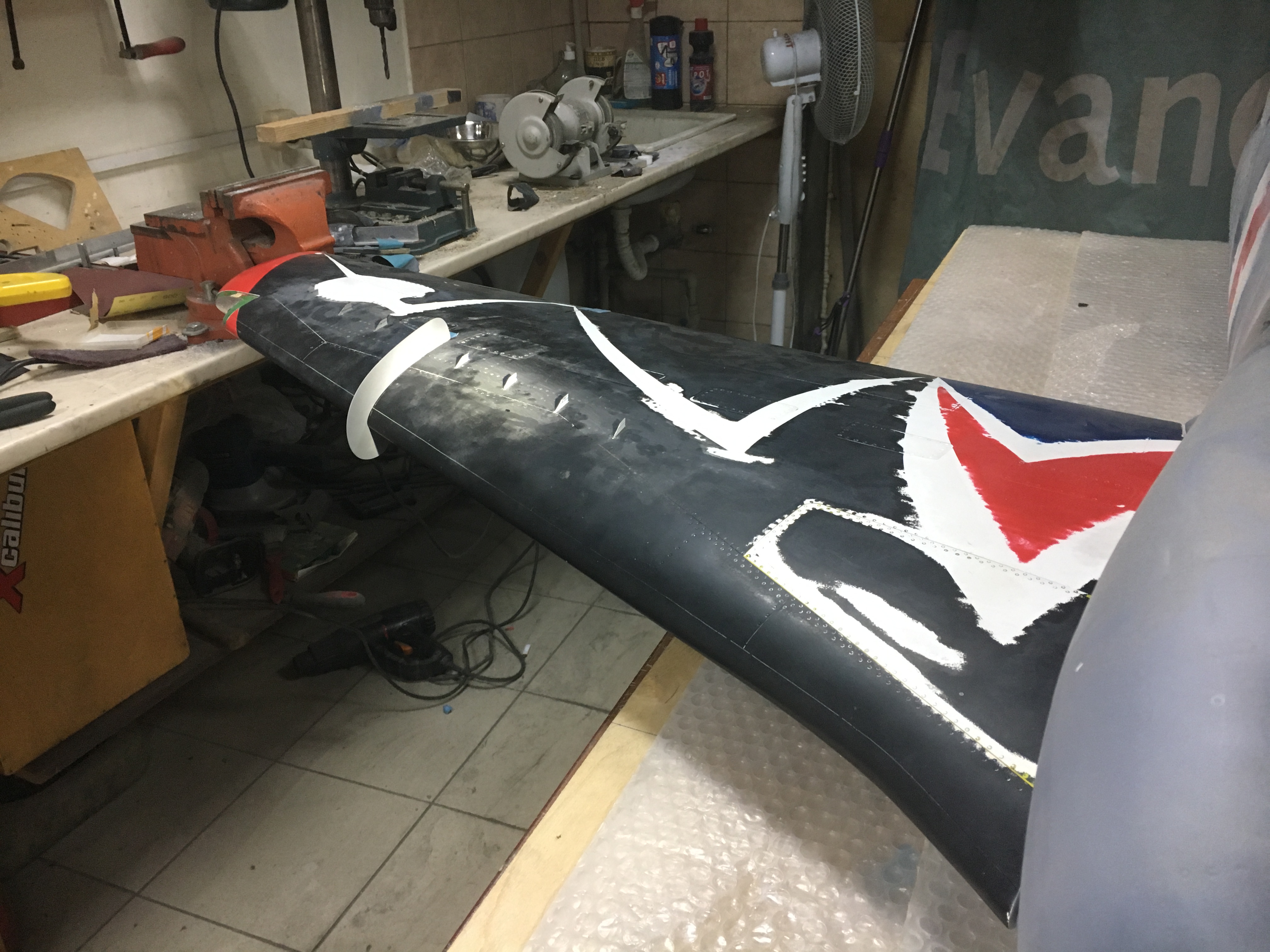

Originally Posted by rcjetsaok
Ok guy's,... Let's talk wing fences... Who is useing them and your thoughts ?? The ones that came in the kit we're building now won't even go around the leading edge... My thoughts are that they sent the fences to the 1/5.5 kit accidently.. Any of you guys have this problem ? And back to my main question, are the needed for stability and tip stall ??
Dan
Dan, you trying to put fences on wrong place (approximately at the center of wing), the right position about ⅔ distance from main wing rib (opposite of the beginning of aileron)
Look like on prototype
I'm sure with ore without fences will not affect stability, it's just for scale view.
On my bird I fully rebuld fences (it's was not scale size):
And vortex generators:
Regards,
Sergey

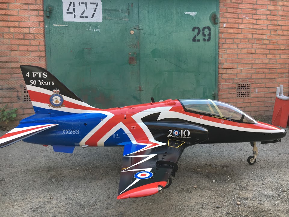

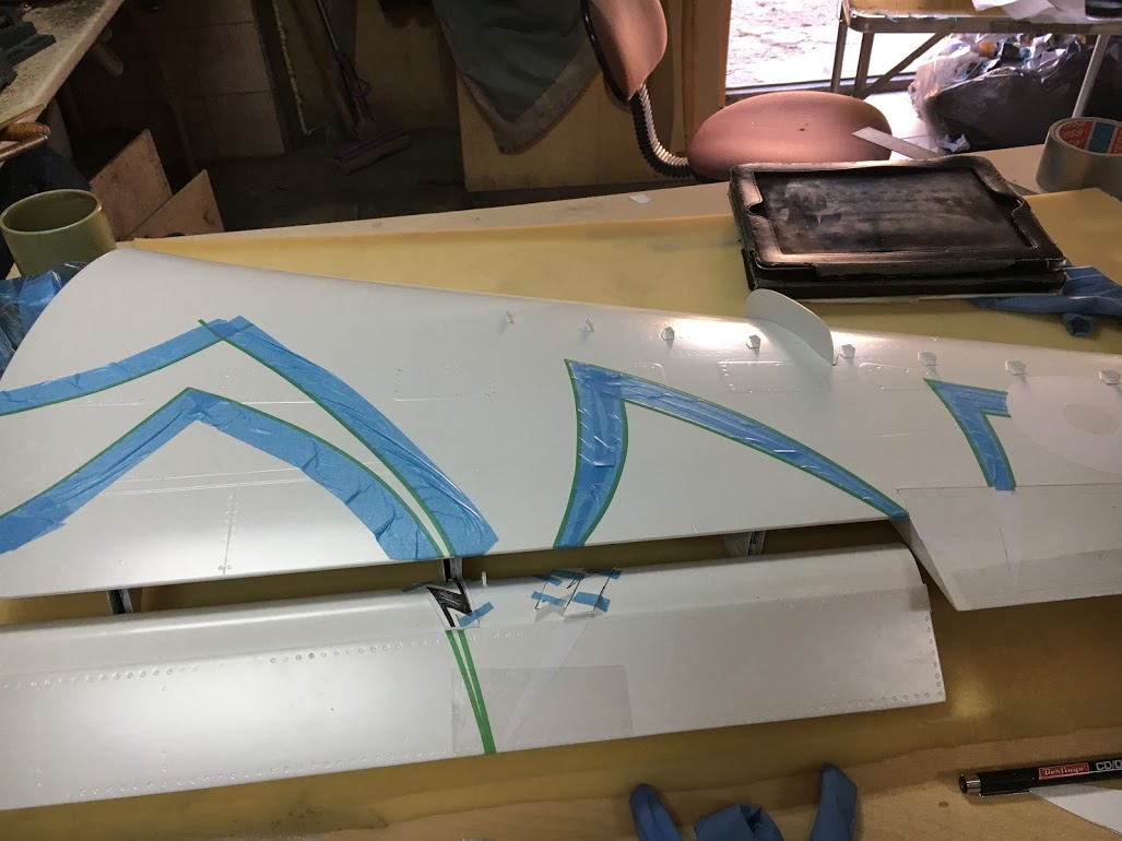

Old 05-07-2017 | 02:56 AM
  #679
helifox's Avatar
Joined: Apr 2014
Posts: 125
From: Krasnodar, RUSSIAN FEDERATION

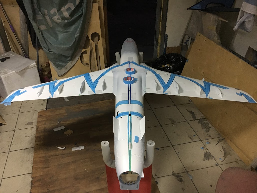

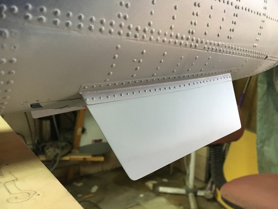

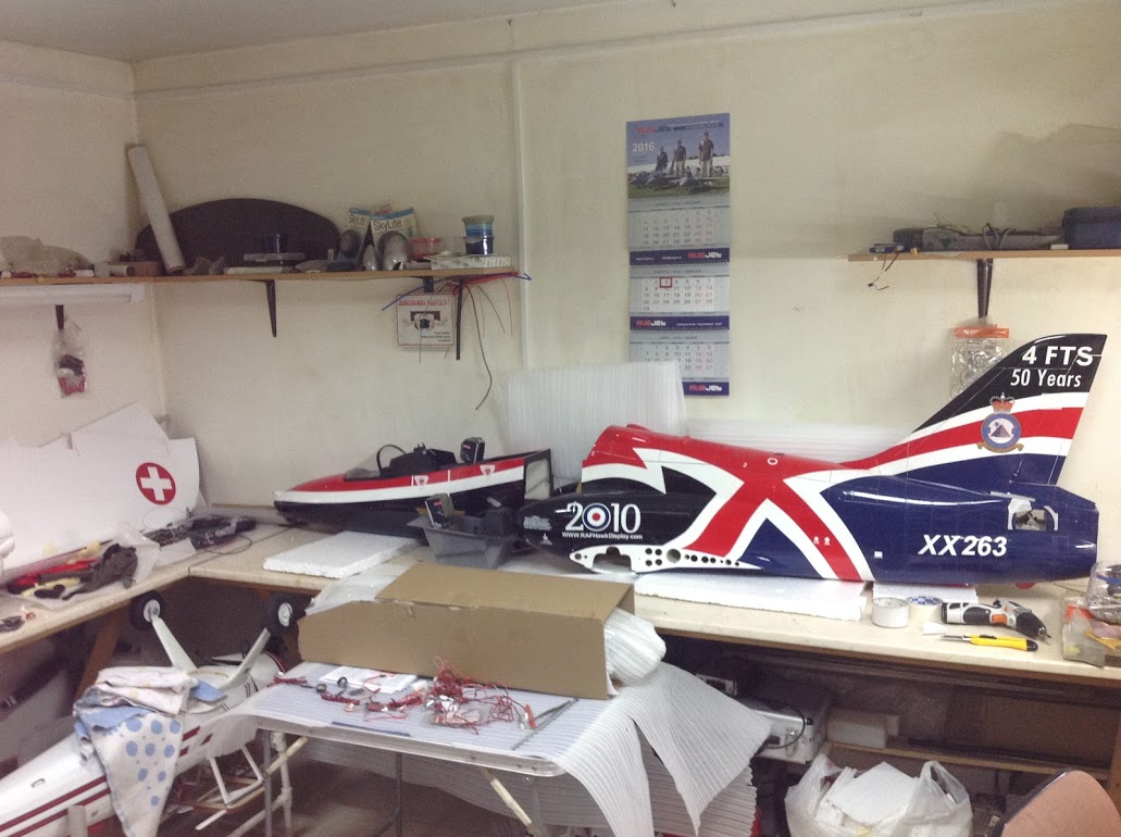

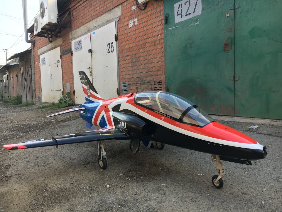

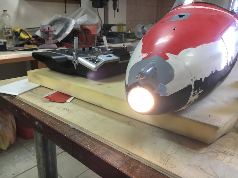

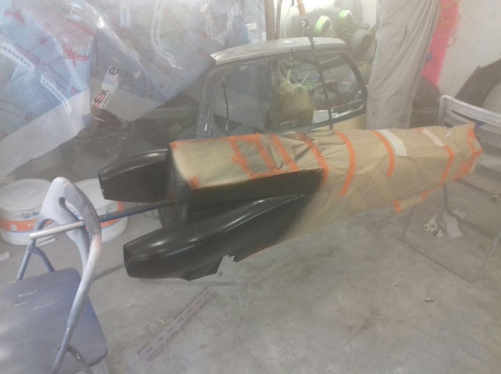

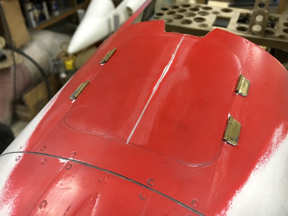

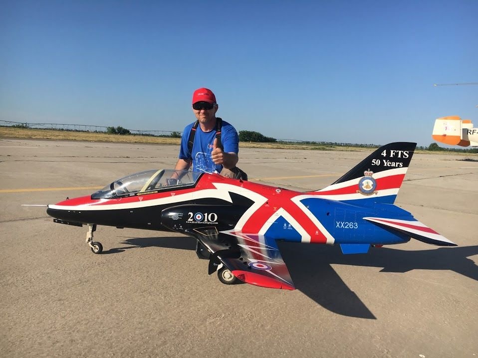

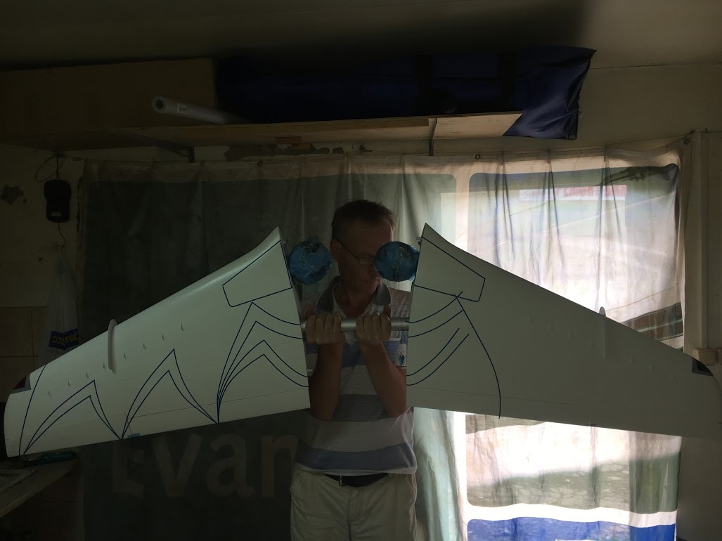

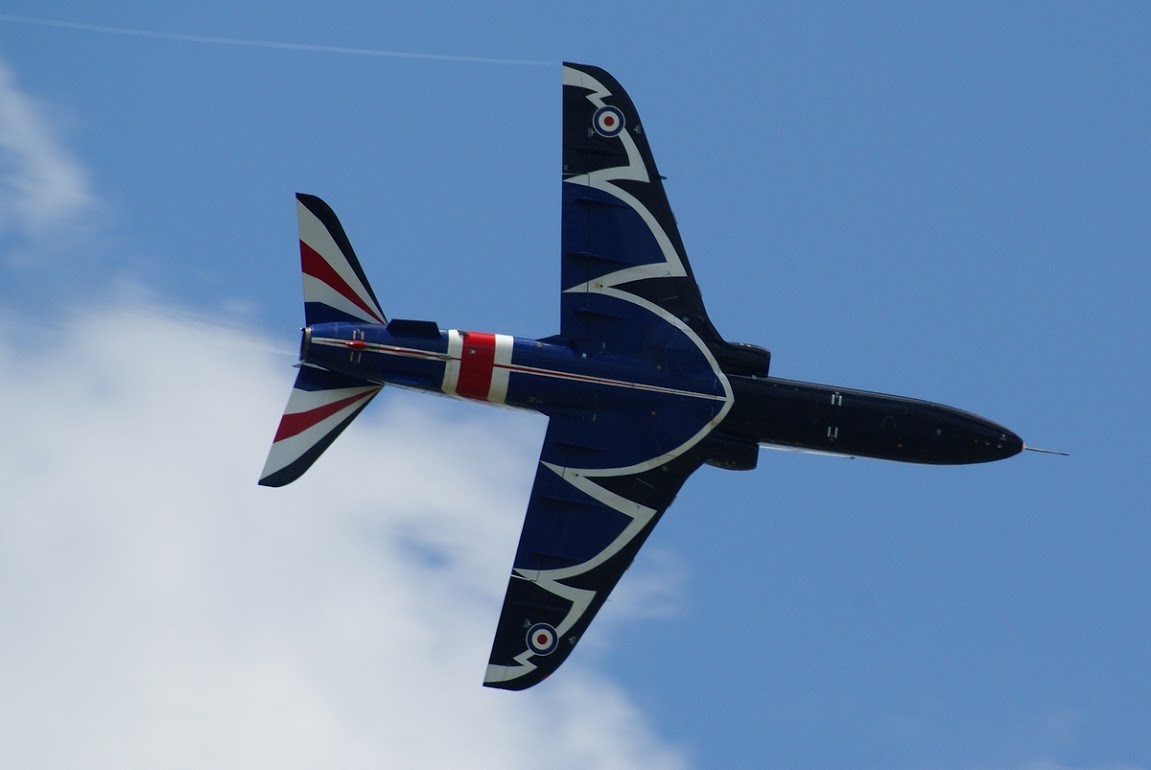

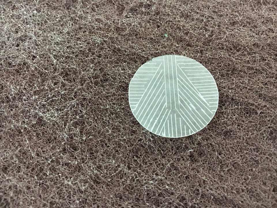

Hi to all,
There is some progress to give to standard ARF more scale view
[ATTACH]2213550[/IMG]
[ATTACH]2213551[/IMG]
[ATTACH]2213500[/IMG]
[ATTACH]2213501[/IMG]
[ATTACH]2213502[/IMG]
[ATTACH]2213503[/IMG]
[ATTACH]2213504[/IMG]
[ATTACH]2213505[/IMG]
[ATTACH]2213506[/IMG]
[ATTACH]2213507[/IMG]
[ATTACH]2213508[/IMG][ATTACH]2213509[/IMG]
[ATTACH]2213510[/IMG]
[ATTACH]2213511[/IMG]
[ATTACH]2213513[/IMG]
Next step - fully repaint according XX263 paint scheme and then assembly the ARF.
Kind regards,
Sergey

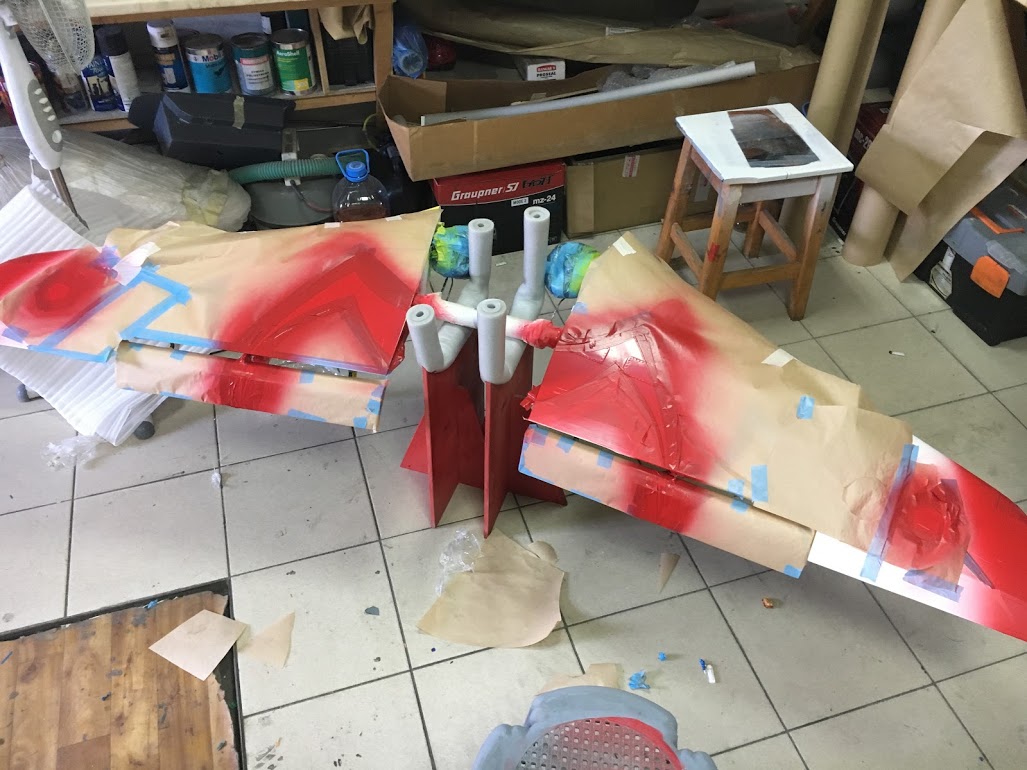

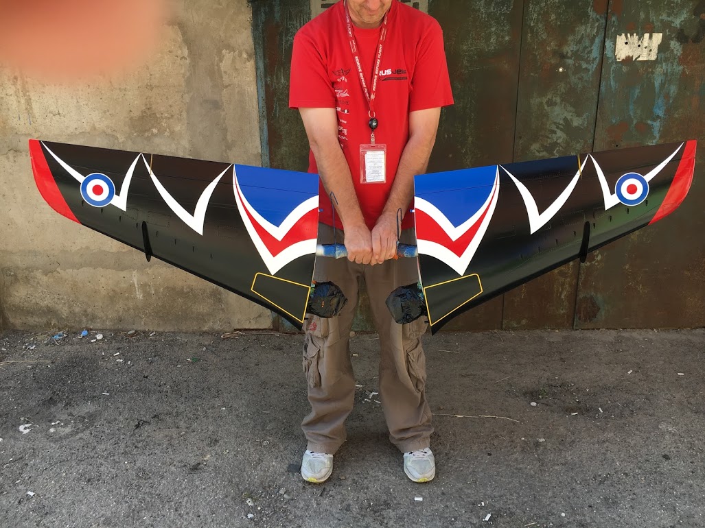

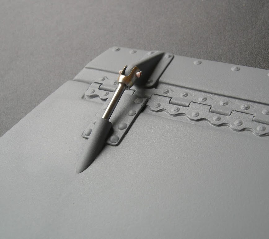

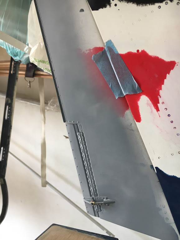

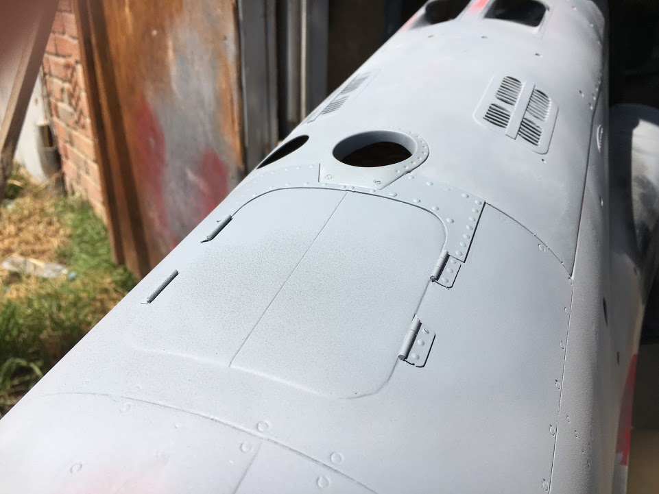

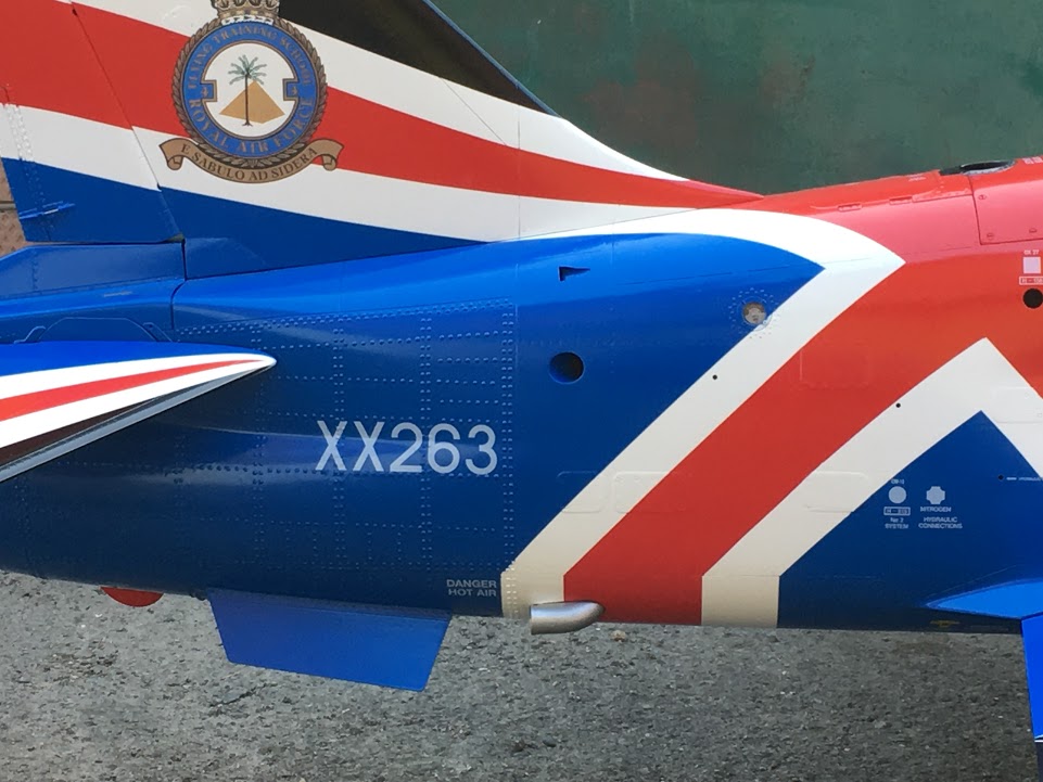

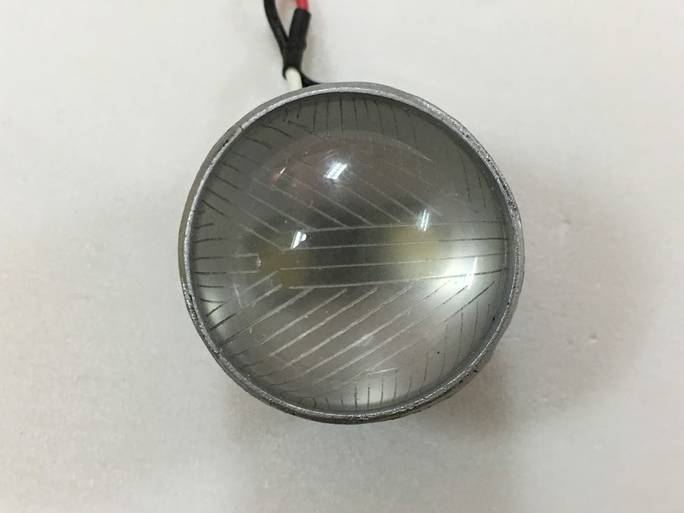

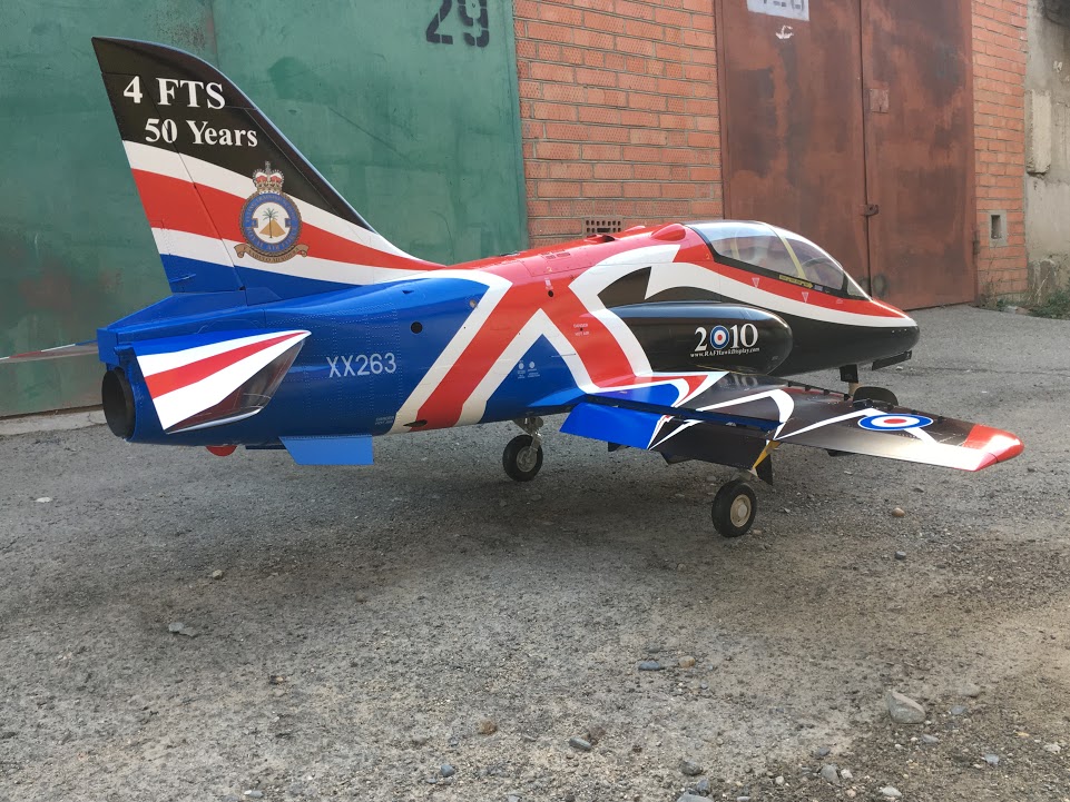

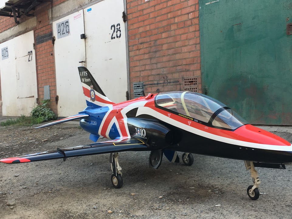

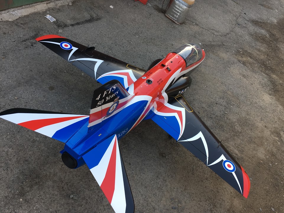

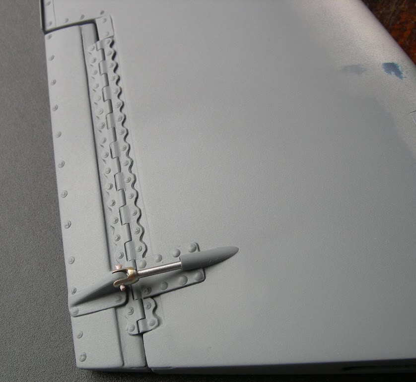

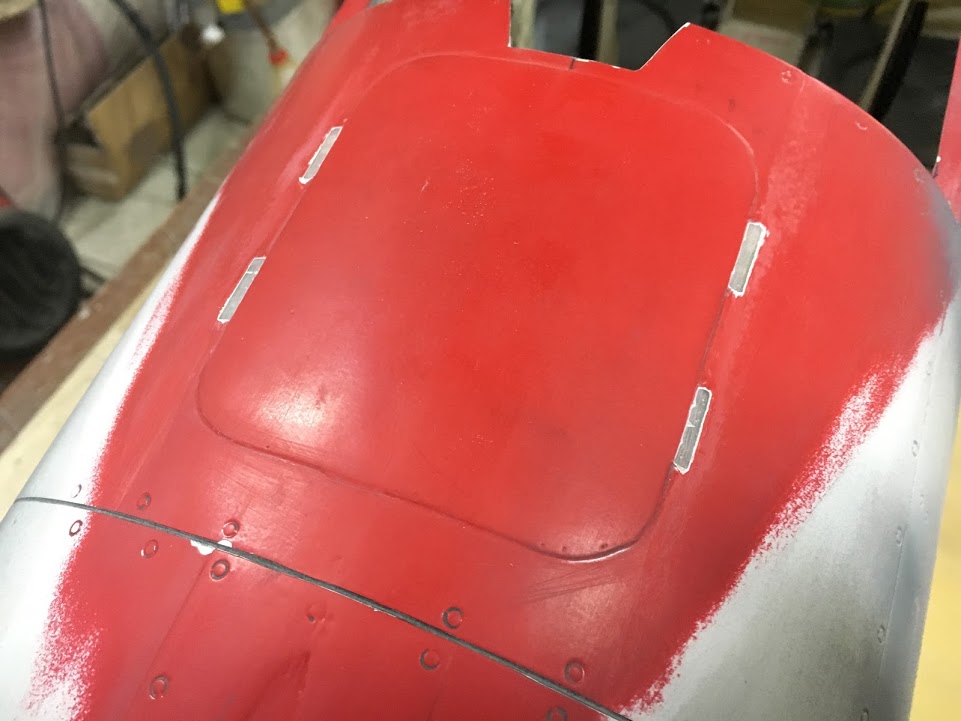

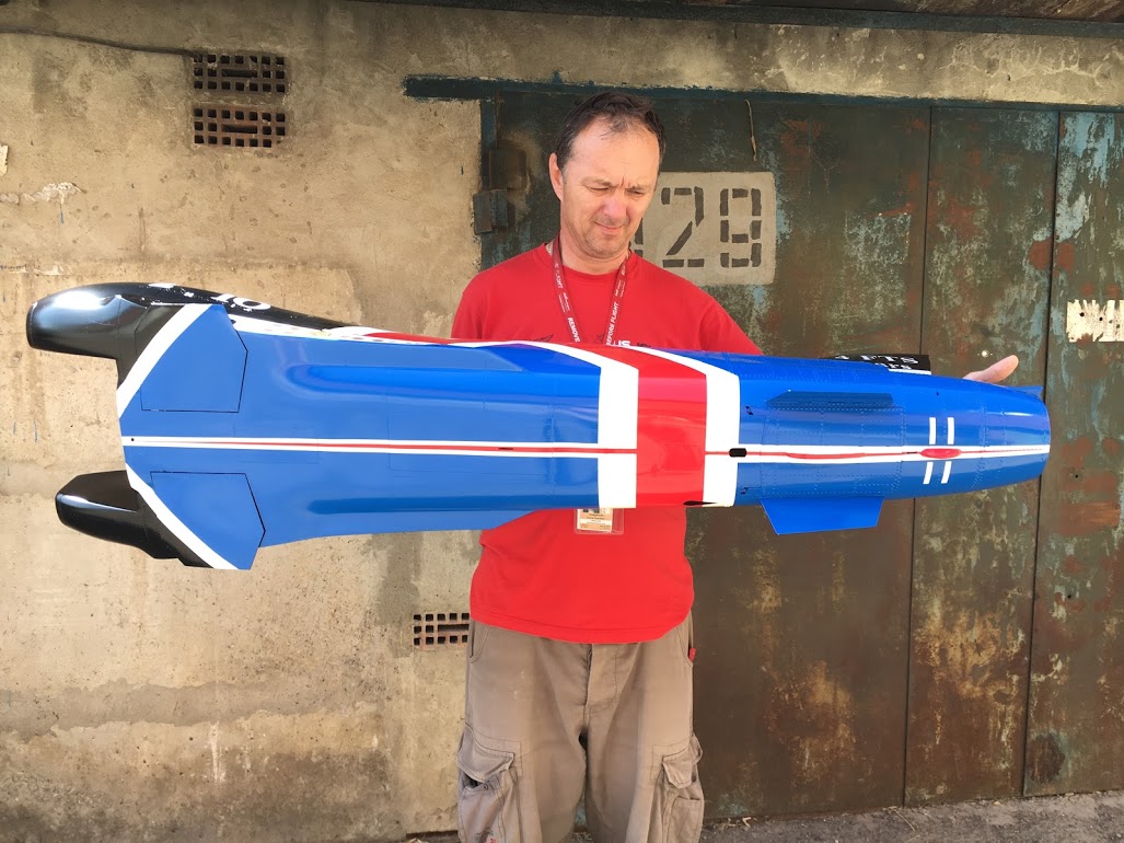

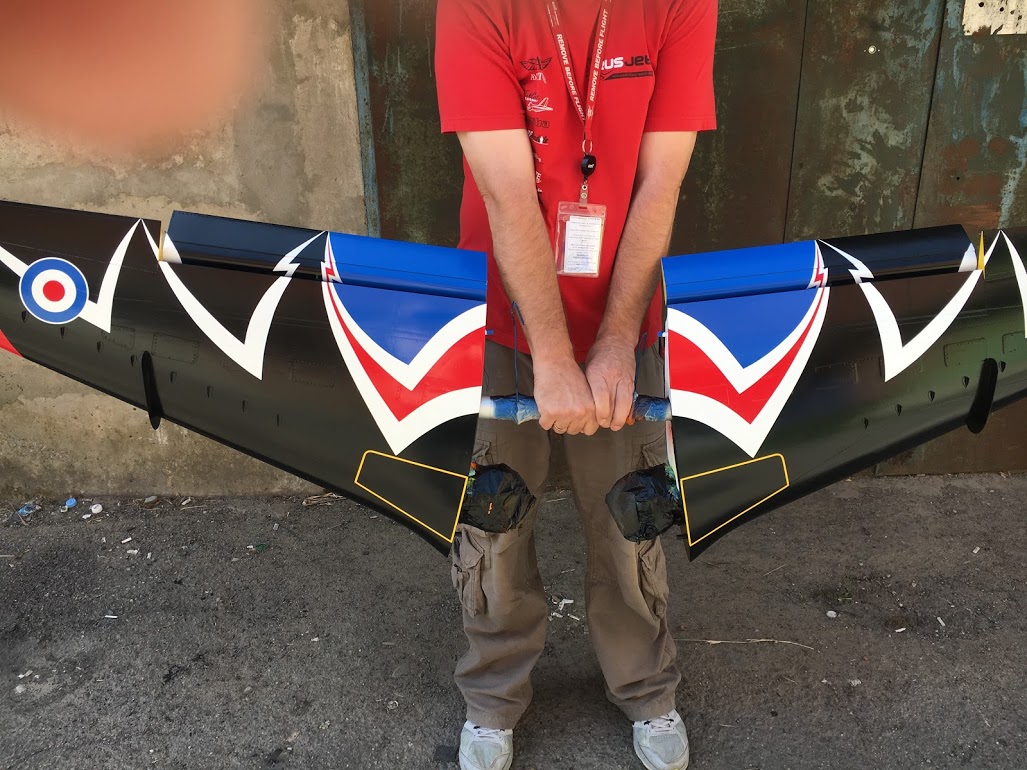

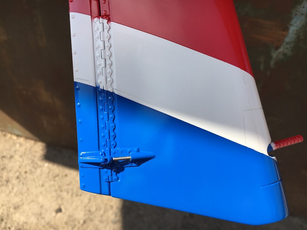

Hi to all,
and sorry for delay, not to much time for hobby
But there is some progress with my Hawk, we add imitation of rudder trim

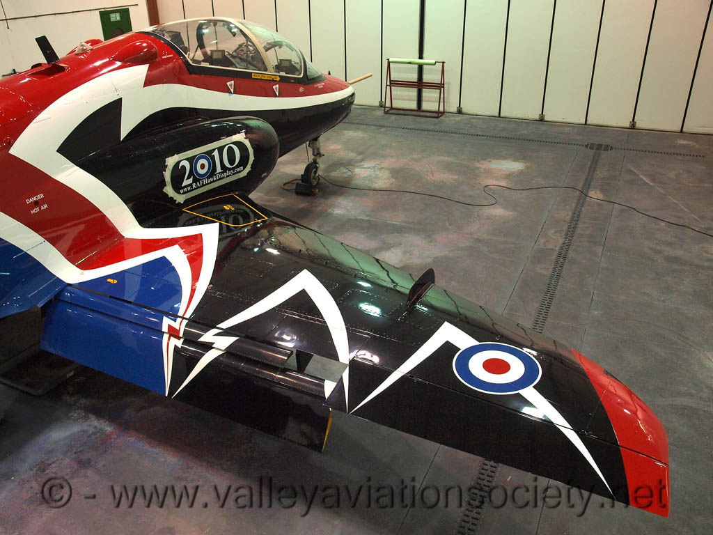

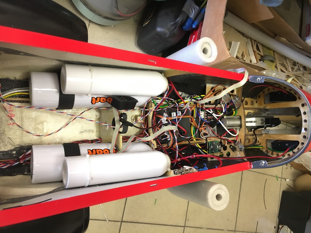

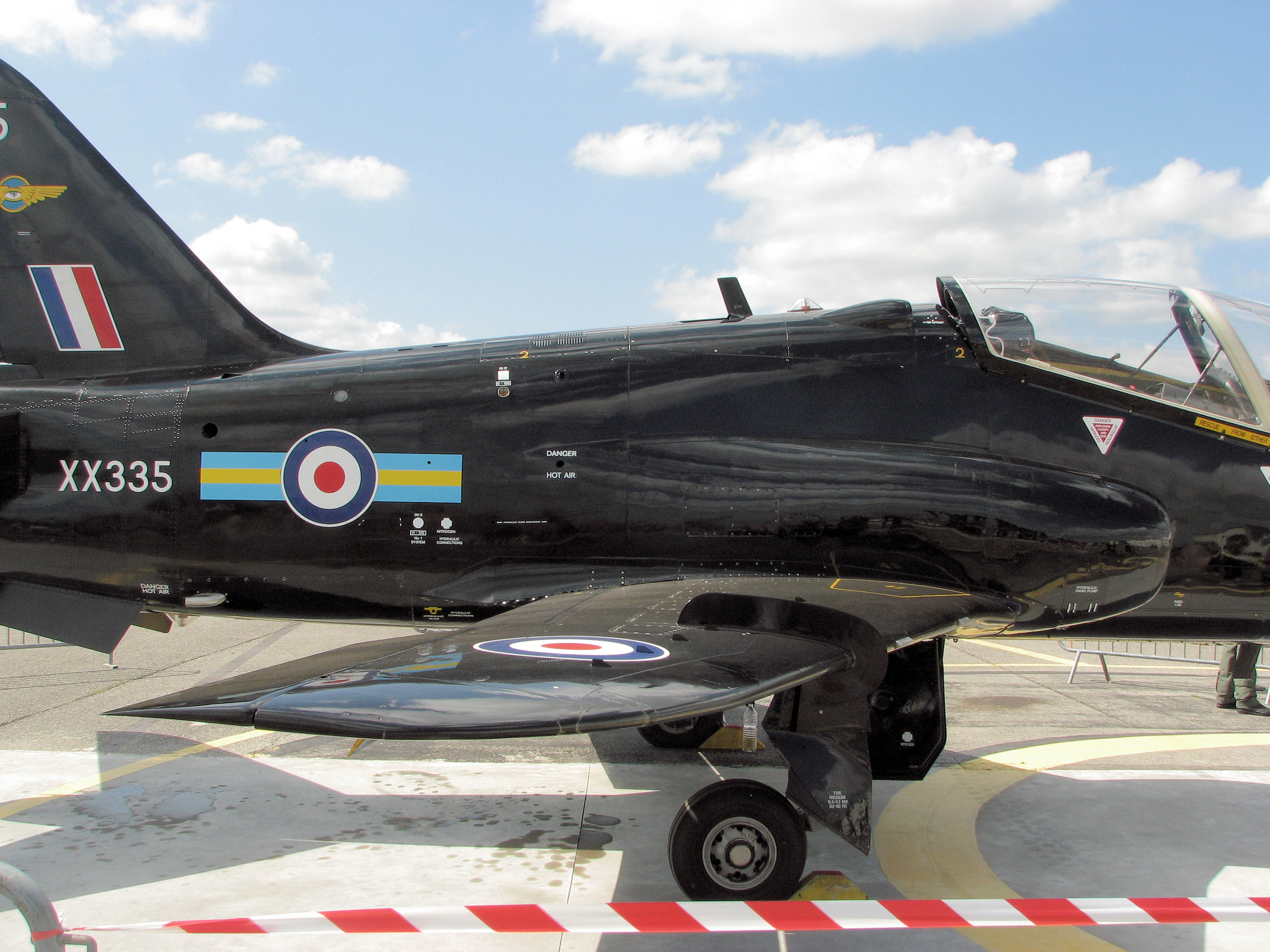

and just finished repaints, now needs to apply decals and finalise semi-mate polish and then assembly.
Some photo of the prototype paint:
As SkyMaster did:

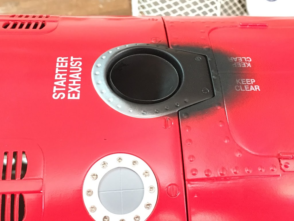

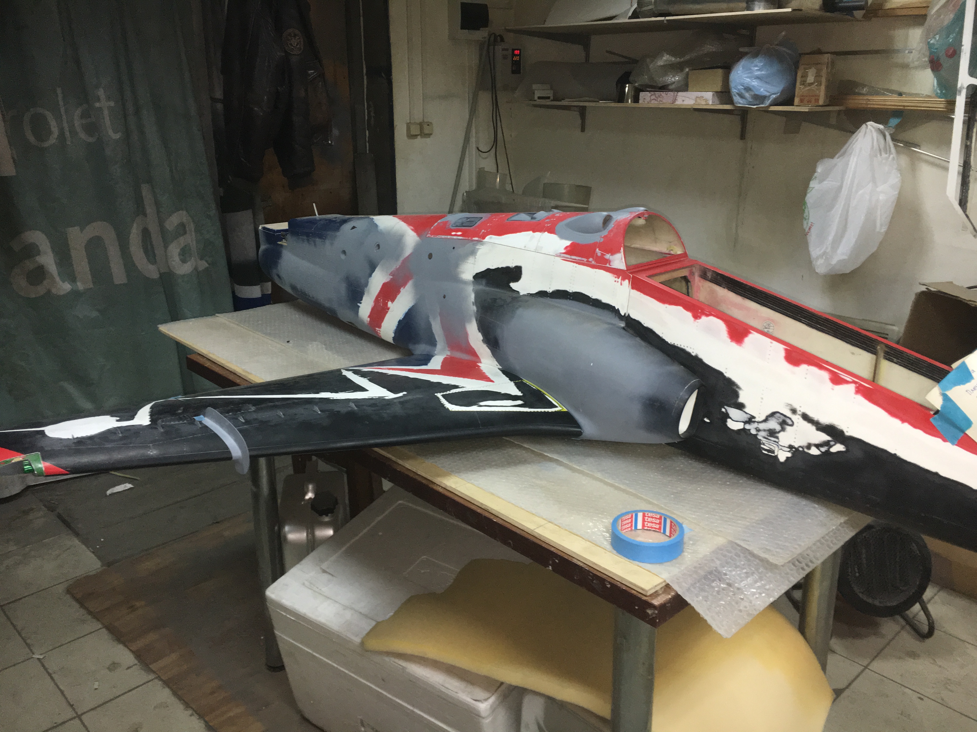

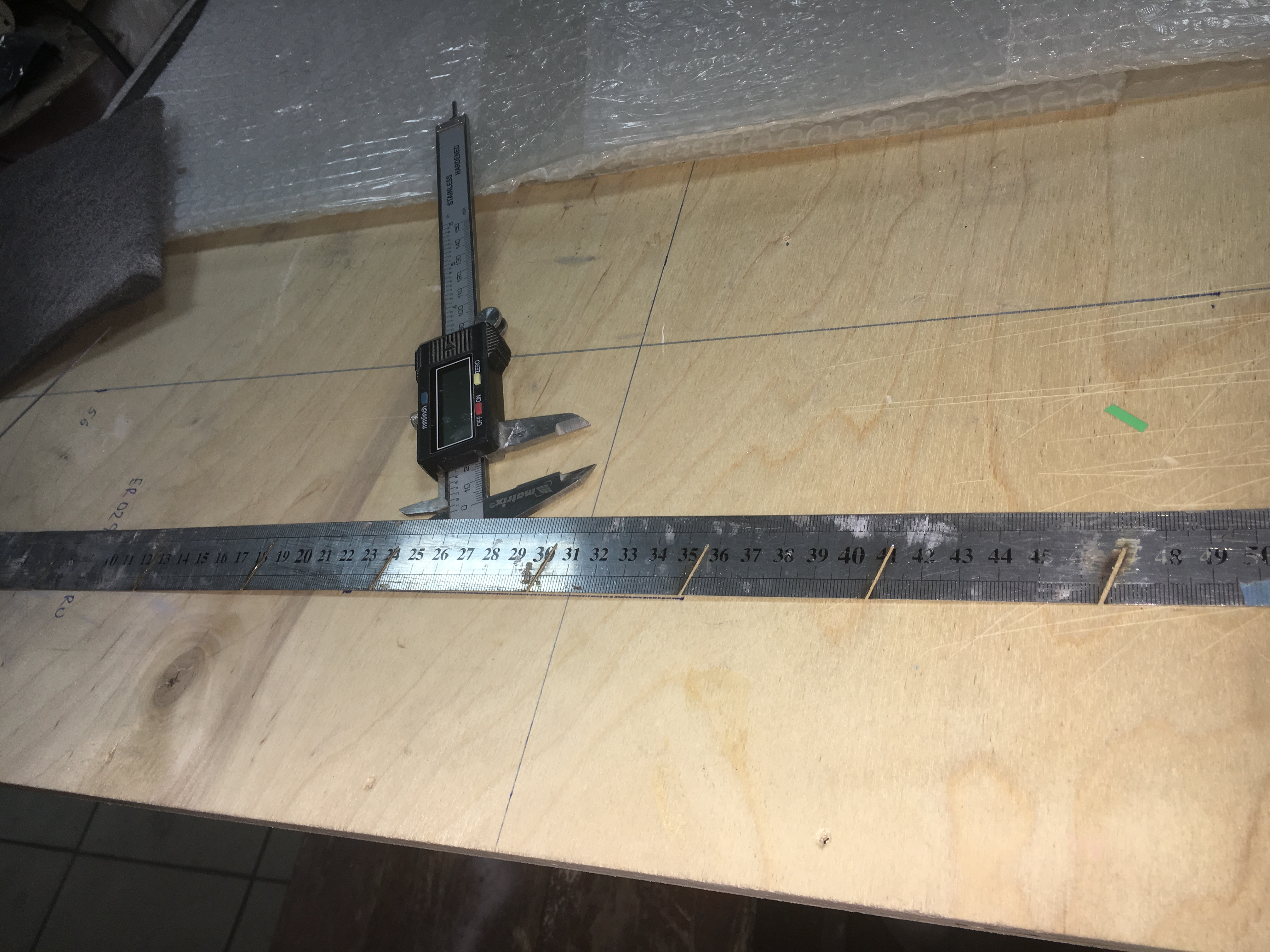

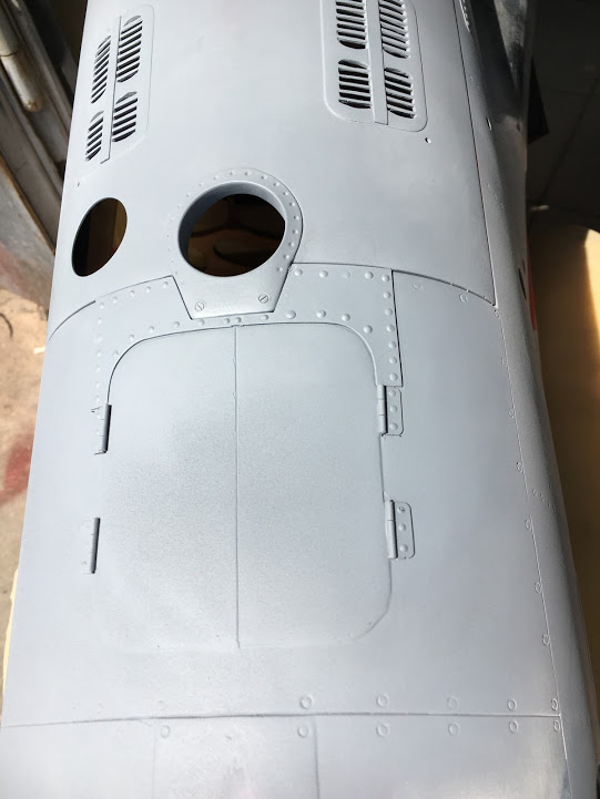

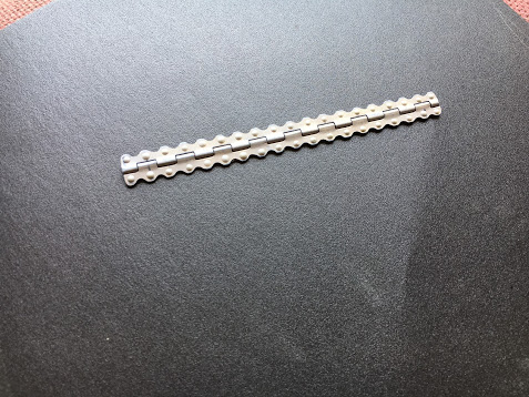

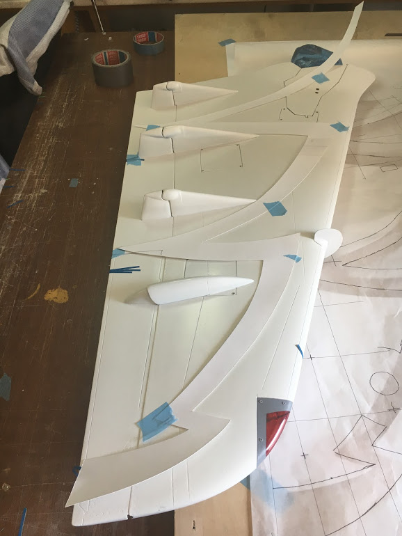

So, you can see to many mistakes, not critical for fan, but unacceptable for copy. Does it why we decide to fully repaint.
And have started (initially i thought it be much easy)

The flaps was paint as prototype
Also Hawk pilot now has very creative shoes
The maiden close and close...
Kind regards to all,
Sergey

Today she stay on shes own leg....

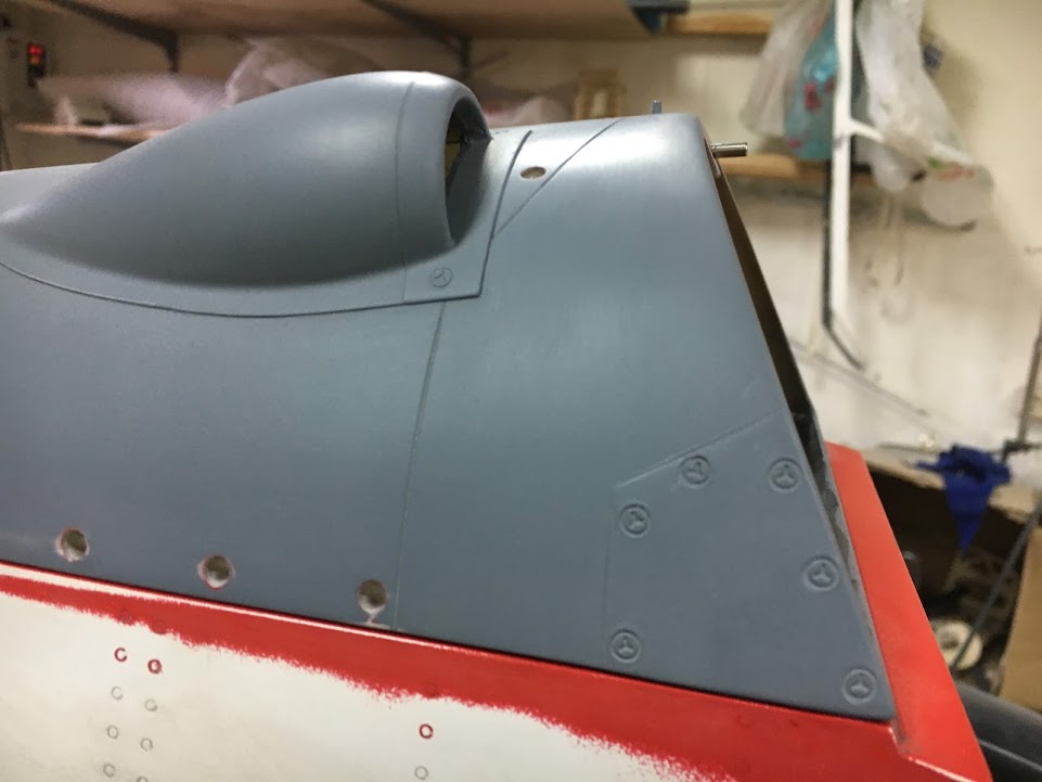

Hello! In my opinion, too light blue. Should probably be darker. Accordingly, the British standard.
Old 09-27-2017 | 04:40 AM
  #692
helifox's Avatar
Joined: Apr 2014
Posts: 125
Hi,
I couldn't find the official acknowledge the number of blue color been used for XX263 (not for 1:48, 1:72 plastic model painting), also i don`t have possibility to go England to find original aircraft to check with BS paint catalogue.
Does it why i used lots of photos to decide by what to paint.
And i think blue color is to close to original:
The prototype:
My bird:
I didn't use photoshop, i swear!
Any way, these model just for my pleasure, and i like her.
Kind regards,
Sergey

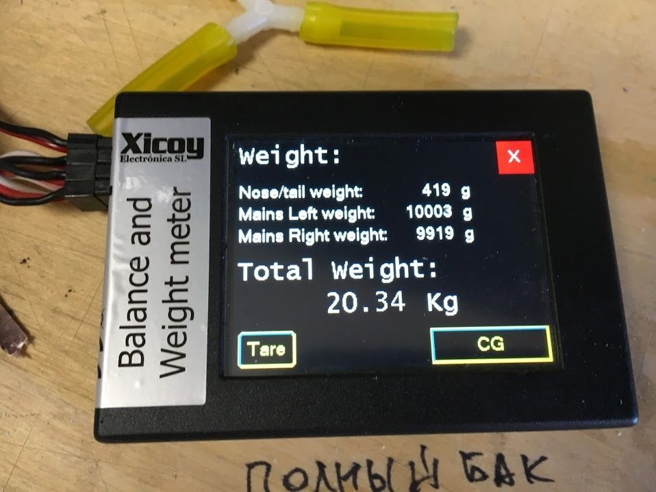

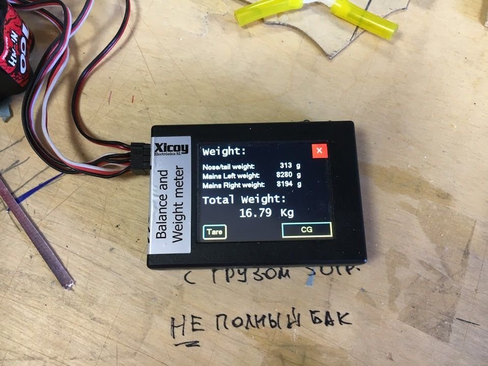

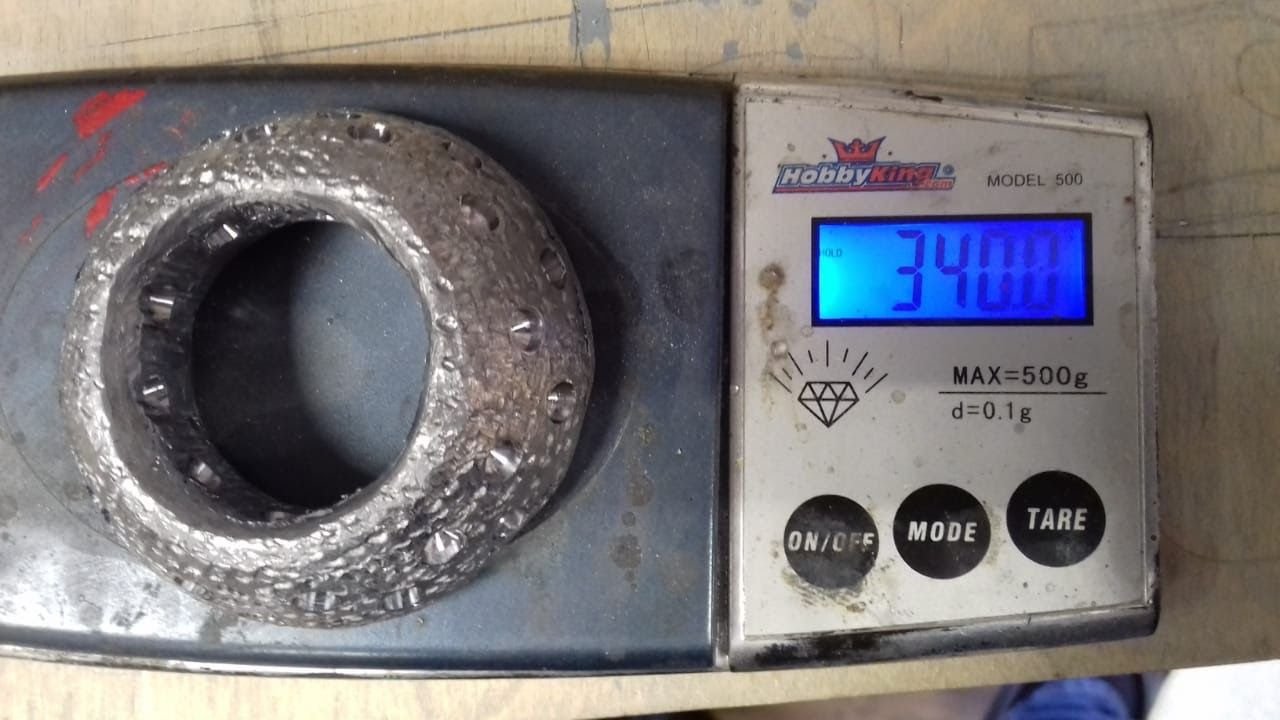

Hi to all,
The maiden was successful, thank to all SkyMaster team for such buetiful model.
CG was 215 mm, but will move to 220. Powerplant JC P-140RXi in tail. Custom fuel tank 4500ml.
Due to RXi turbine has inner pump, valves and filter was added 340gr ballast to the nose.
Take off weight:
Empty weight:
Short walk around after maiden:
