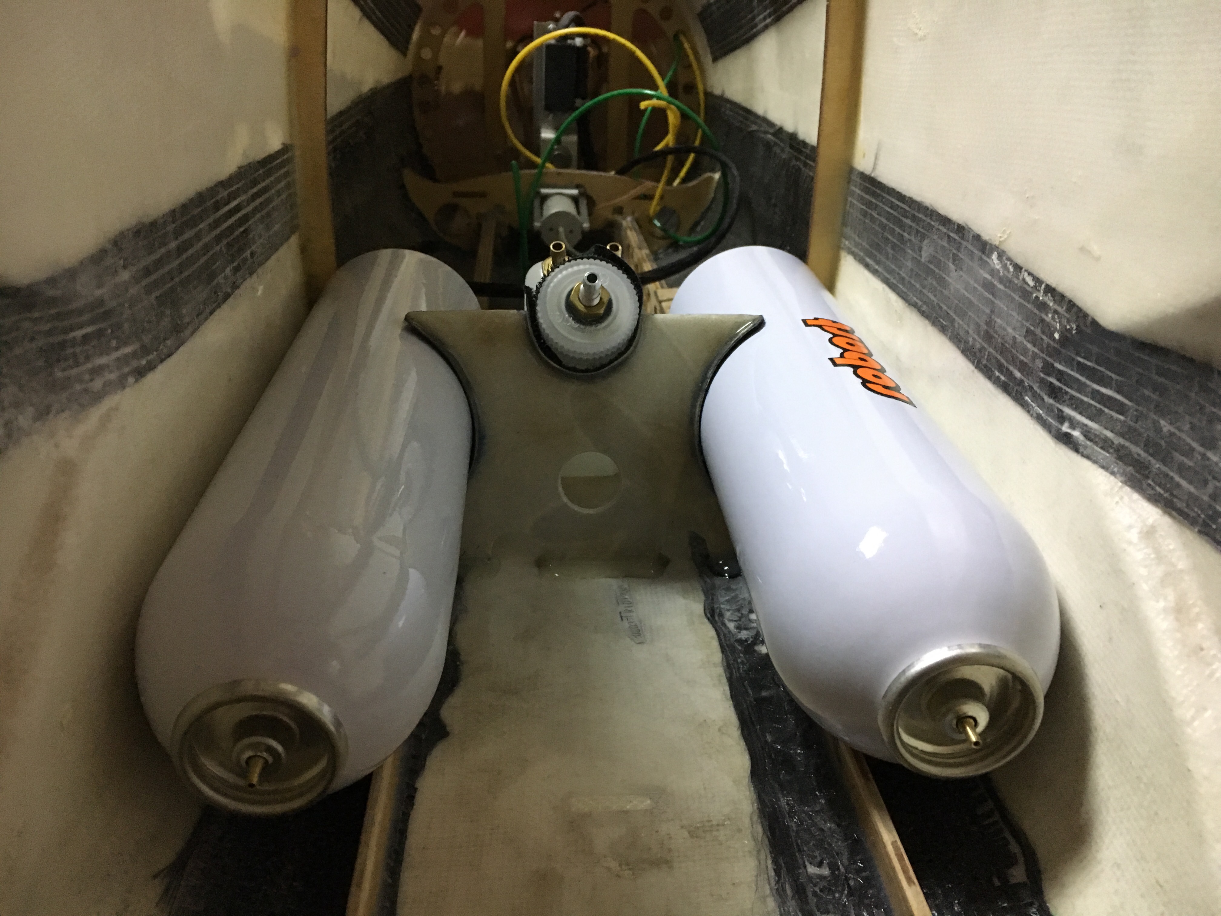

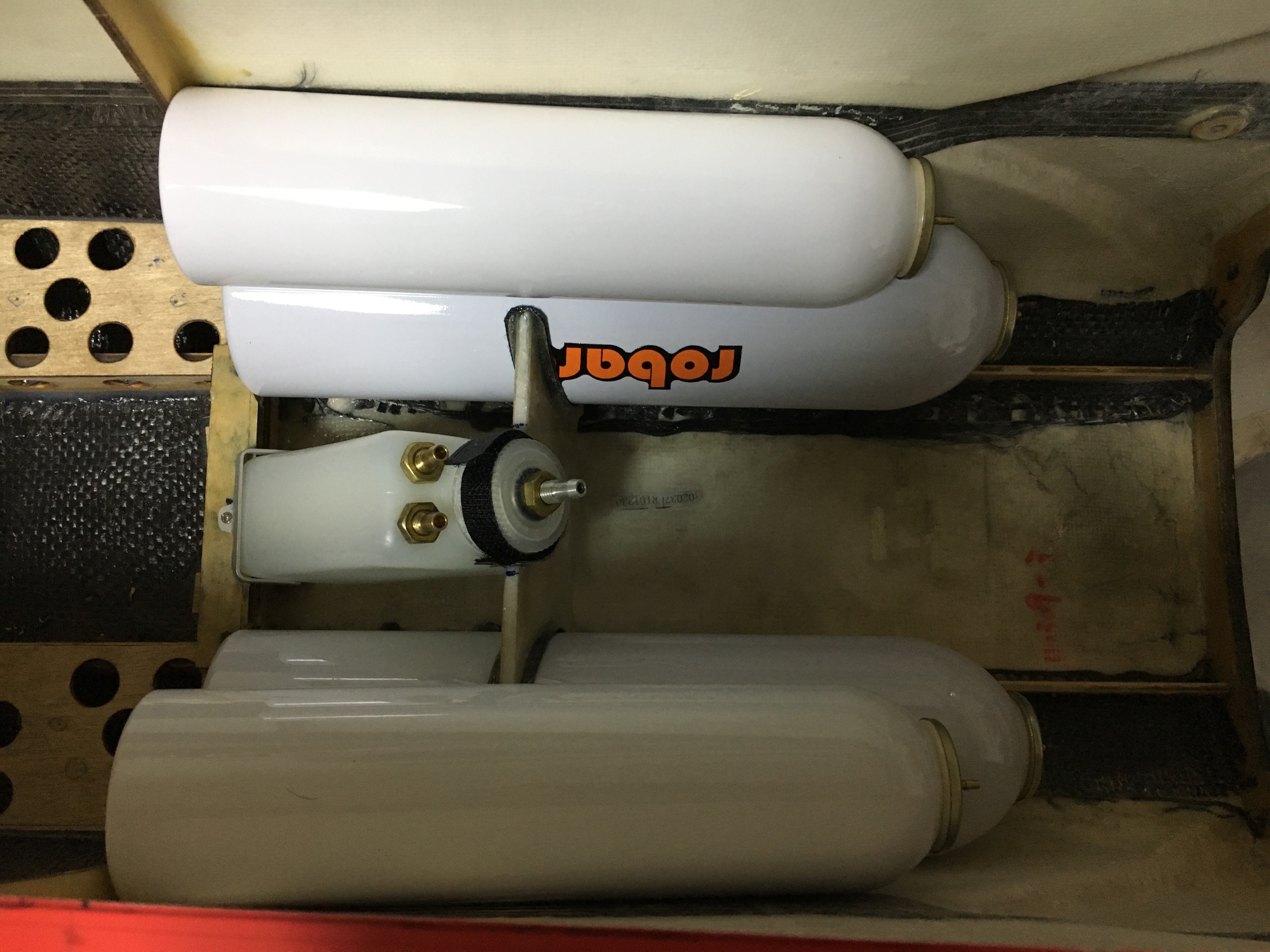

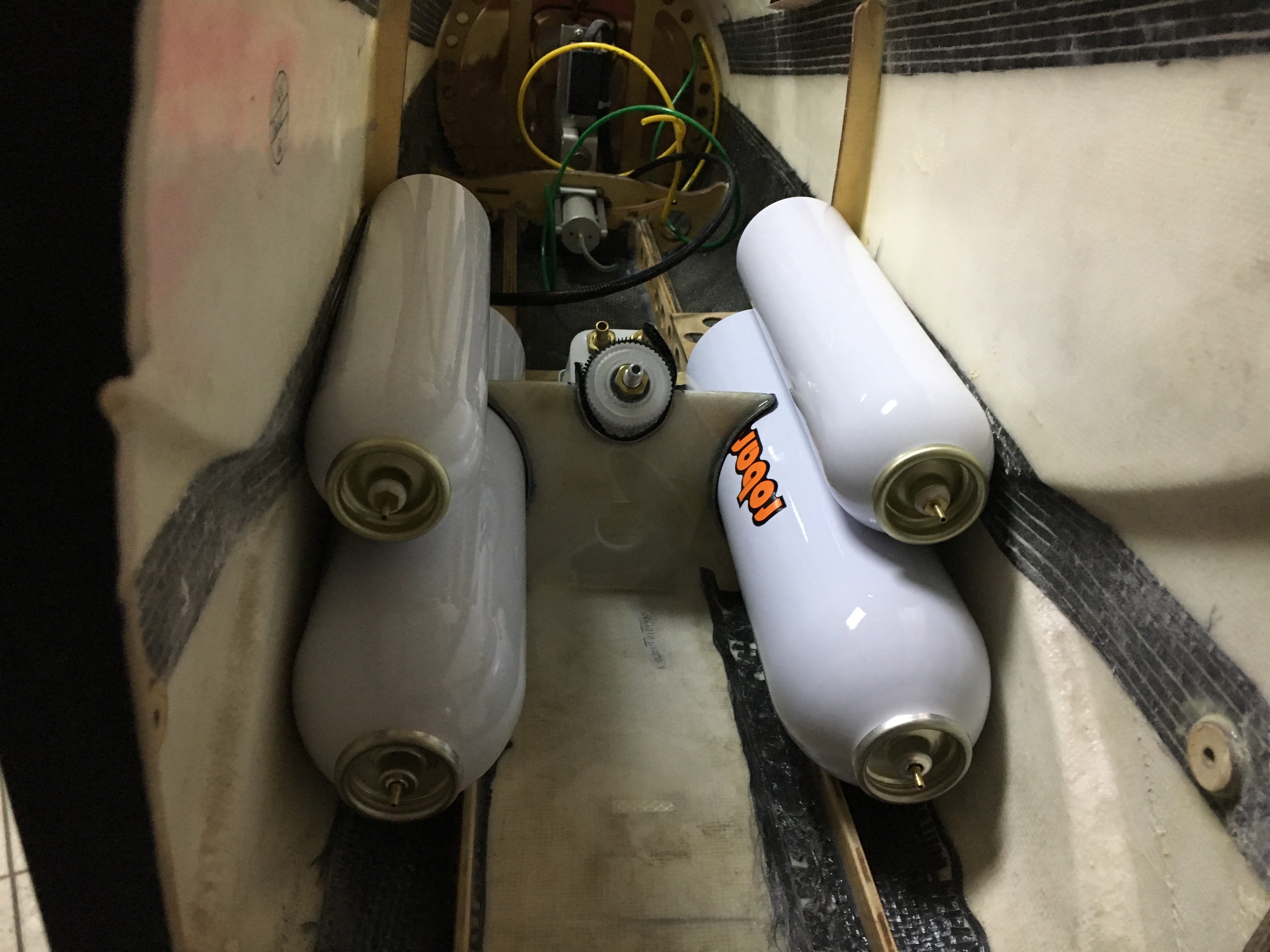

A couple questions:
1. What size air tanks can you fit in the suggested location?
2. What size servo arms are used?
I am on the road for a few days and cant measure anything and want to get some stuff ordered so it can be at the house when I get home.
Thanks!
Old 01-26-2017 | 02:04 AM
  #657
helifox's Avatar
Joined: Apr 2014
Posts: 125
From: Krasnodar, RUSSIAN FEDERATION
Originally Posted by IFlyEm35
A couple questions:
Thanks!

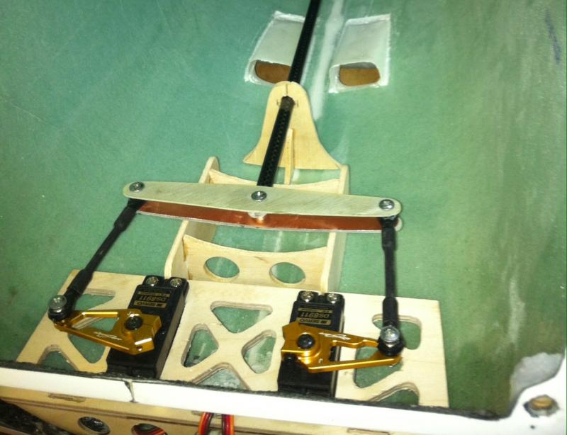

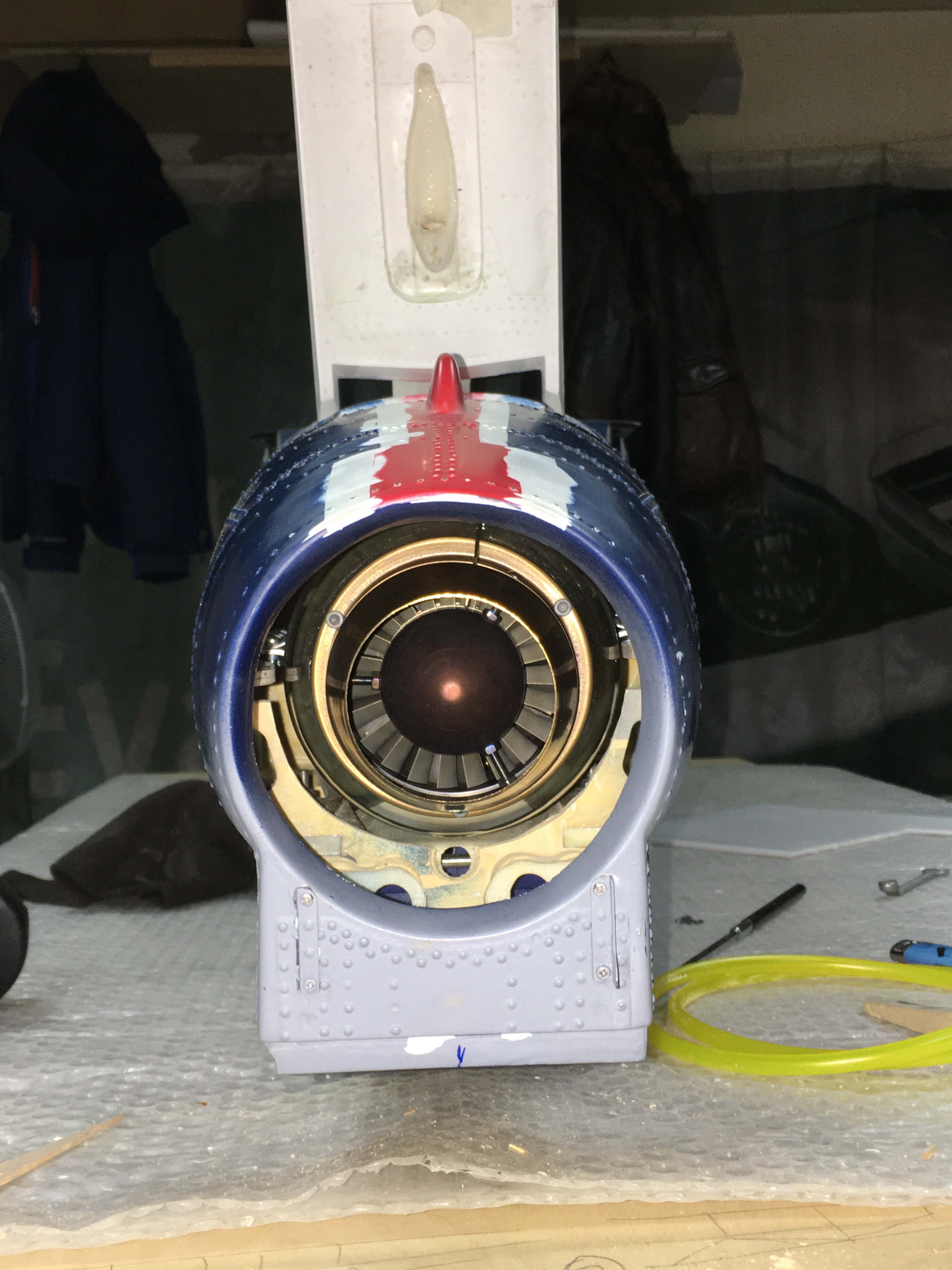

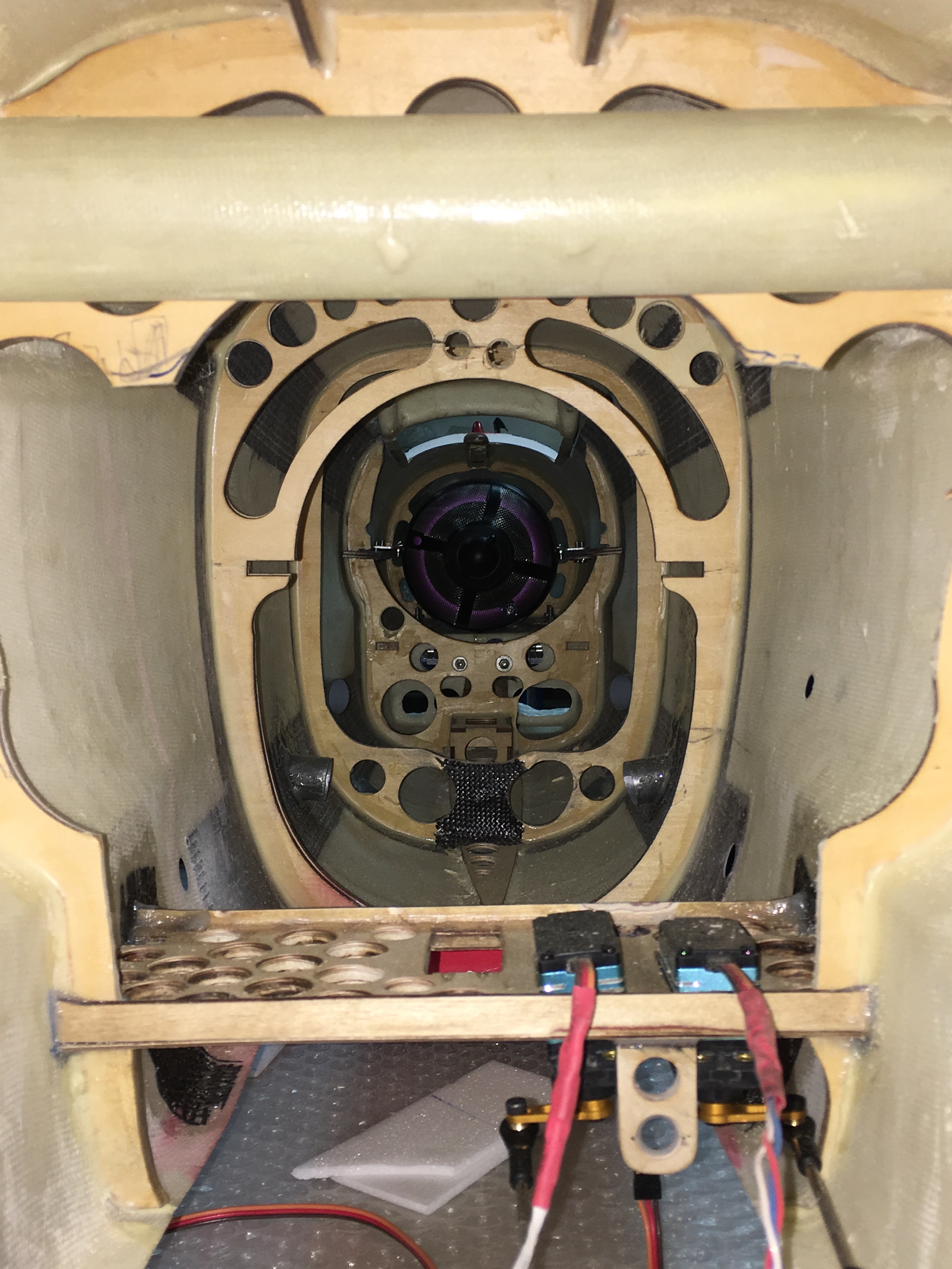

1. I use 2 XL Robart tanks for gear and gear dors, and one standart for brake (just decide not to use air brake and install my P-140rxi at the tail (all servos I move close to CG)
2. 23mm Secraft JR servo arms

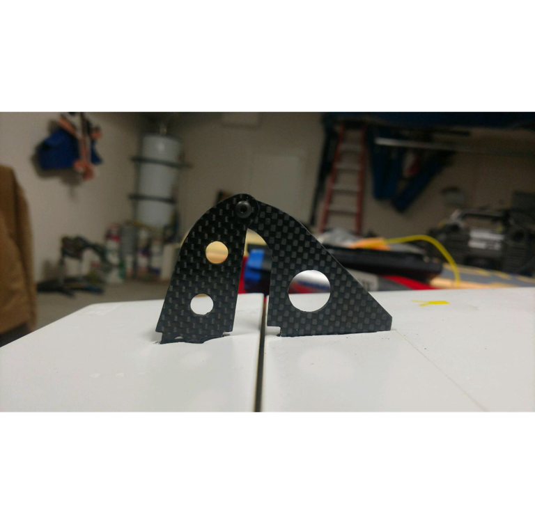

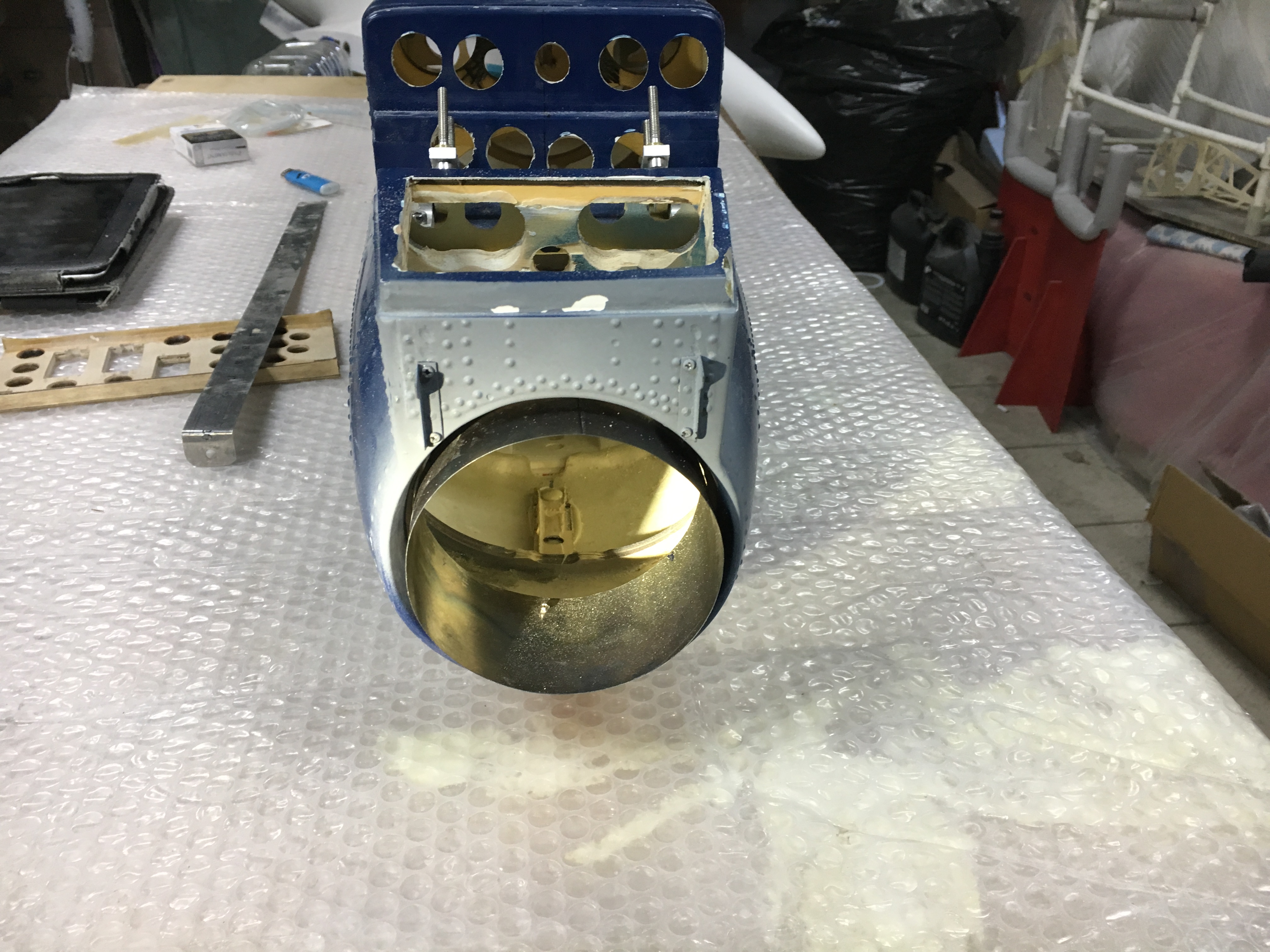

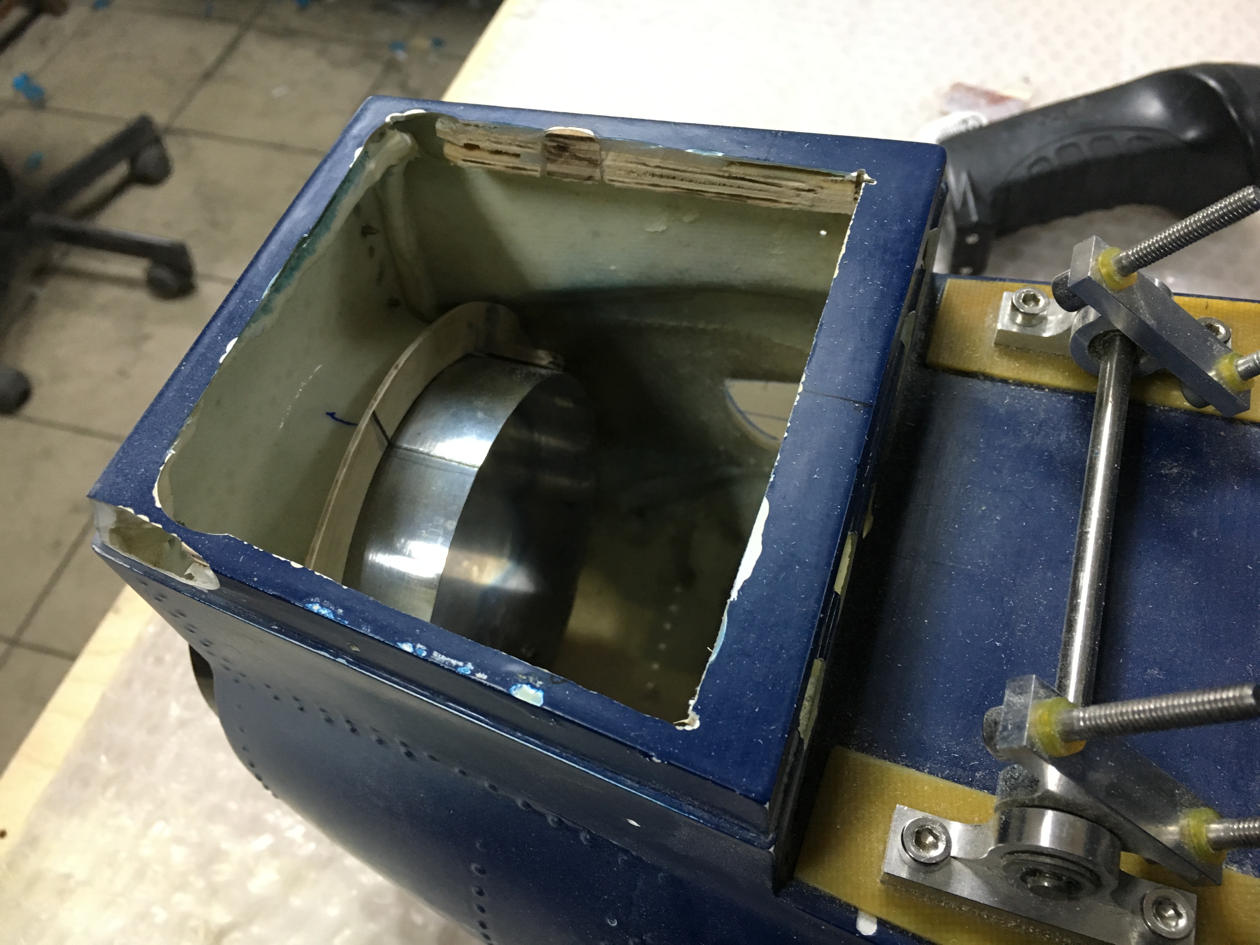

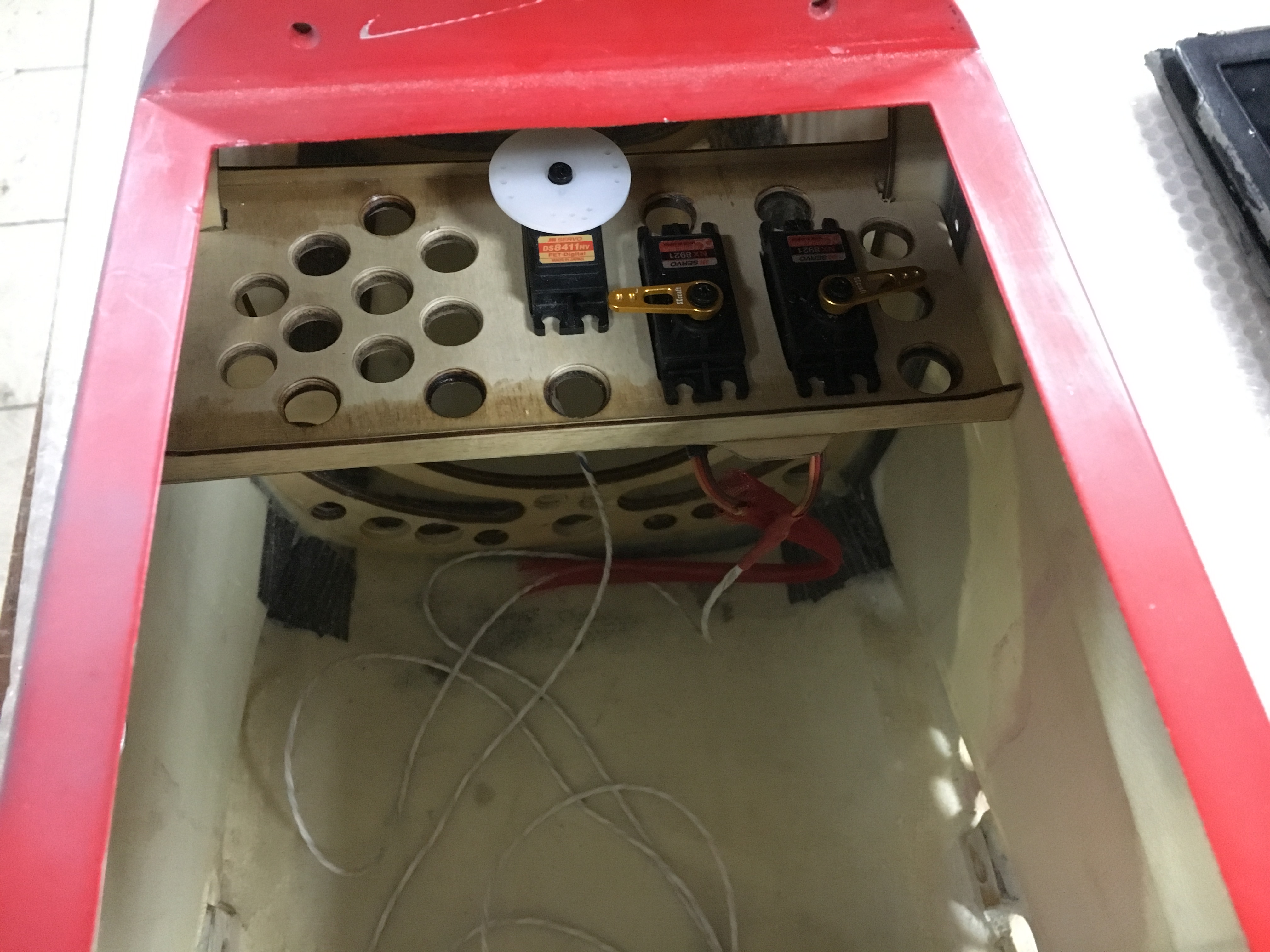

The horizontal stab will work like these:

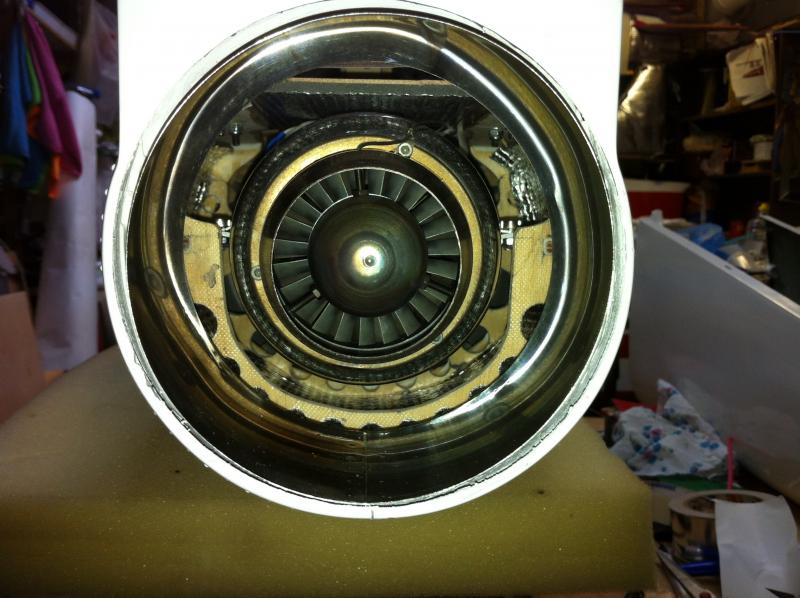

The turbine will install like these:

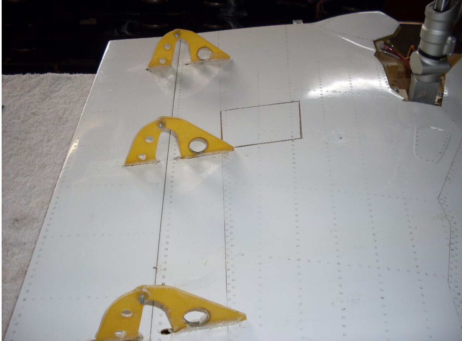

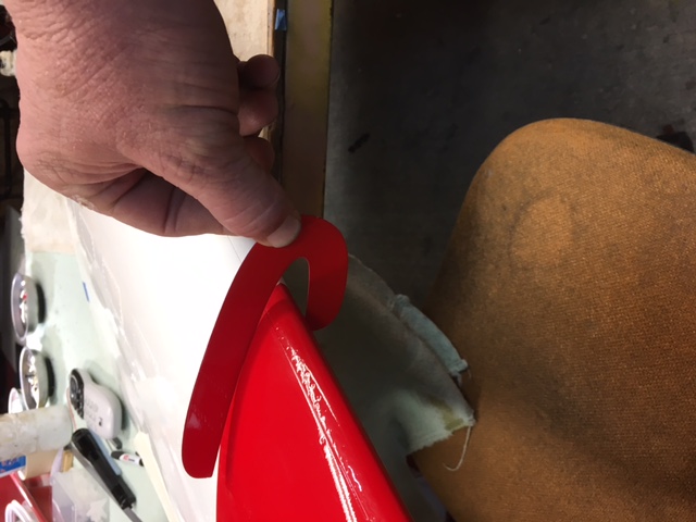

Ok guy's,... Let's talk wing fences... Who is useing them and your thoughts ?? The ones that came in the kit we're building now won't even go around the leading edge... My thoughts are that they sent the fences to the 1/5.5 kit accidently.. Any of you guys have this problem ? And back to my main question, are the needed for stability and tip stall ?? I have always been told that flying a Hawk without fences is like useing razor blades for toilet paper !! I had the the 1/5.5 kit, key word is HAD.. So I think there is truth to the myth... Please tell !!!
Dan

I know of at least two Hawks flying without wing fences, mine being one of them. I put about 30 flights on mine last year without any problem. They are not necessary.

Peter Goldsmith showed me during an event last year how if you sight down the wing the Hawk has a bit of wash in built into it so if you set the ailerons just a tad higher than the flaps (flaps up, ailerons neutral) you end up with slight wash out which will help with the tip stall tendency. I'm building the 1/3.65 but I think the same would apply. Thought I would pass this along because I never would have seen or thought of this. JS

I have heard of this now that you mention it... A very slight full time crow in essence... How much are you planning to use ?? I would think the thickness of the aileron at the flap joint up wold be enough.. Thoughts ?

Dan, That's about the amount we discussed and I plan to try first. Trailing edge aileron thickness, of course.

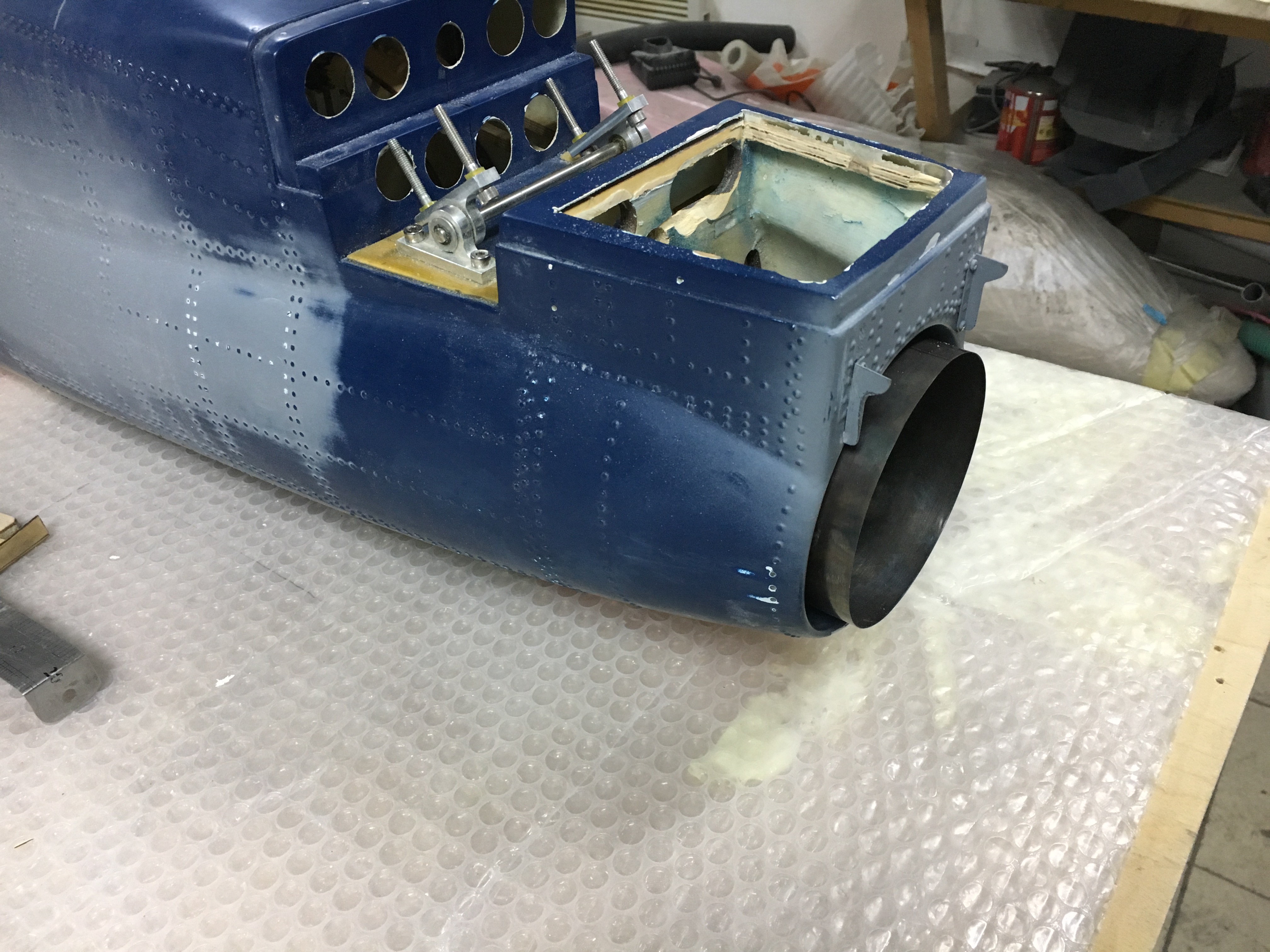

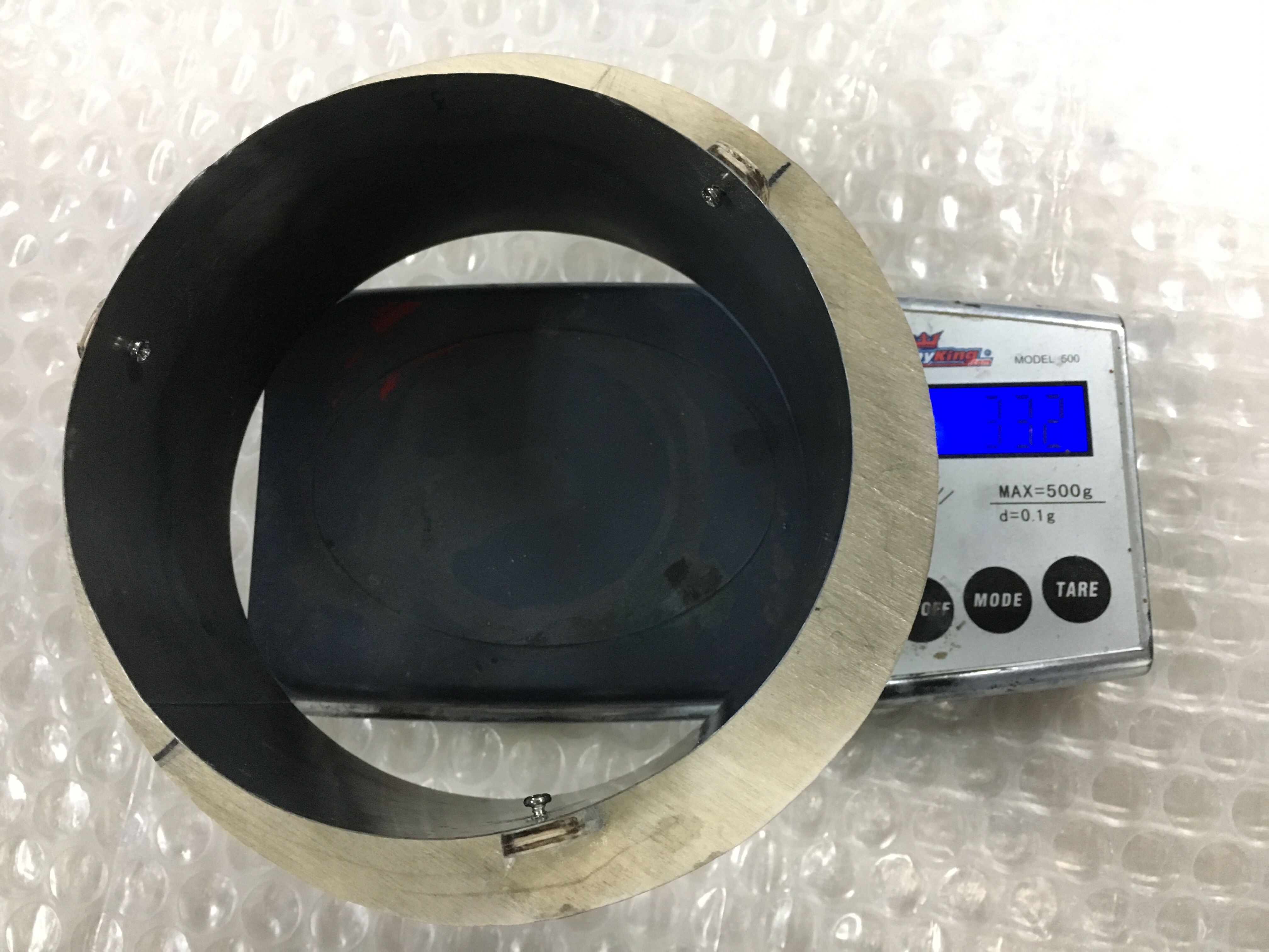

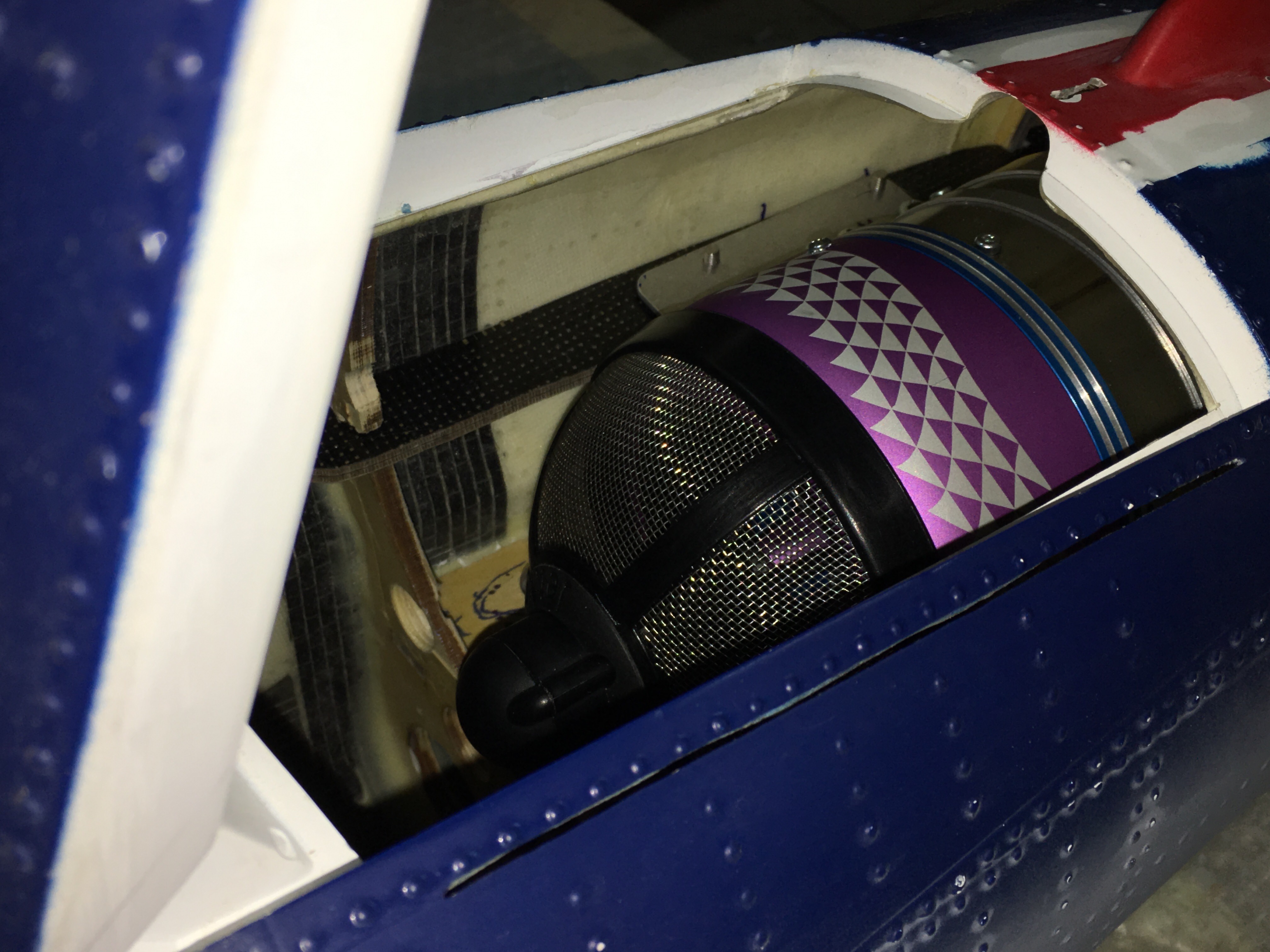

As I did write the turbine was move from standart position to the tail. To minimize ballast at the nose all servos (elevator, rudder) installed close to CG
http://youtu.be/bACudnnu9Xs All up unpainted weight wit all scale detals now ( except fuel in main tank) is 15,5 kg
