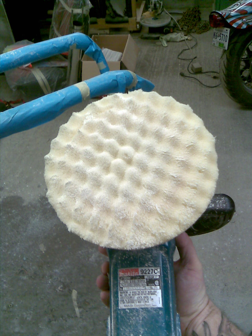

Picture 5. 3M waffle polishing disk for the extra cut compound
Picture 6. 3M waffle polishing disk for the swirl remover

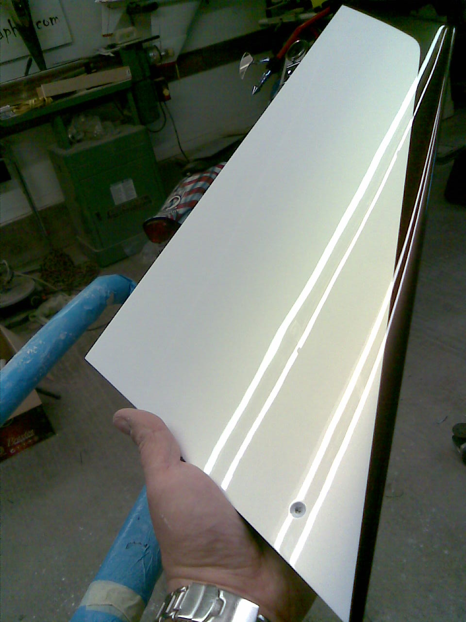

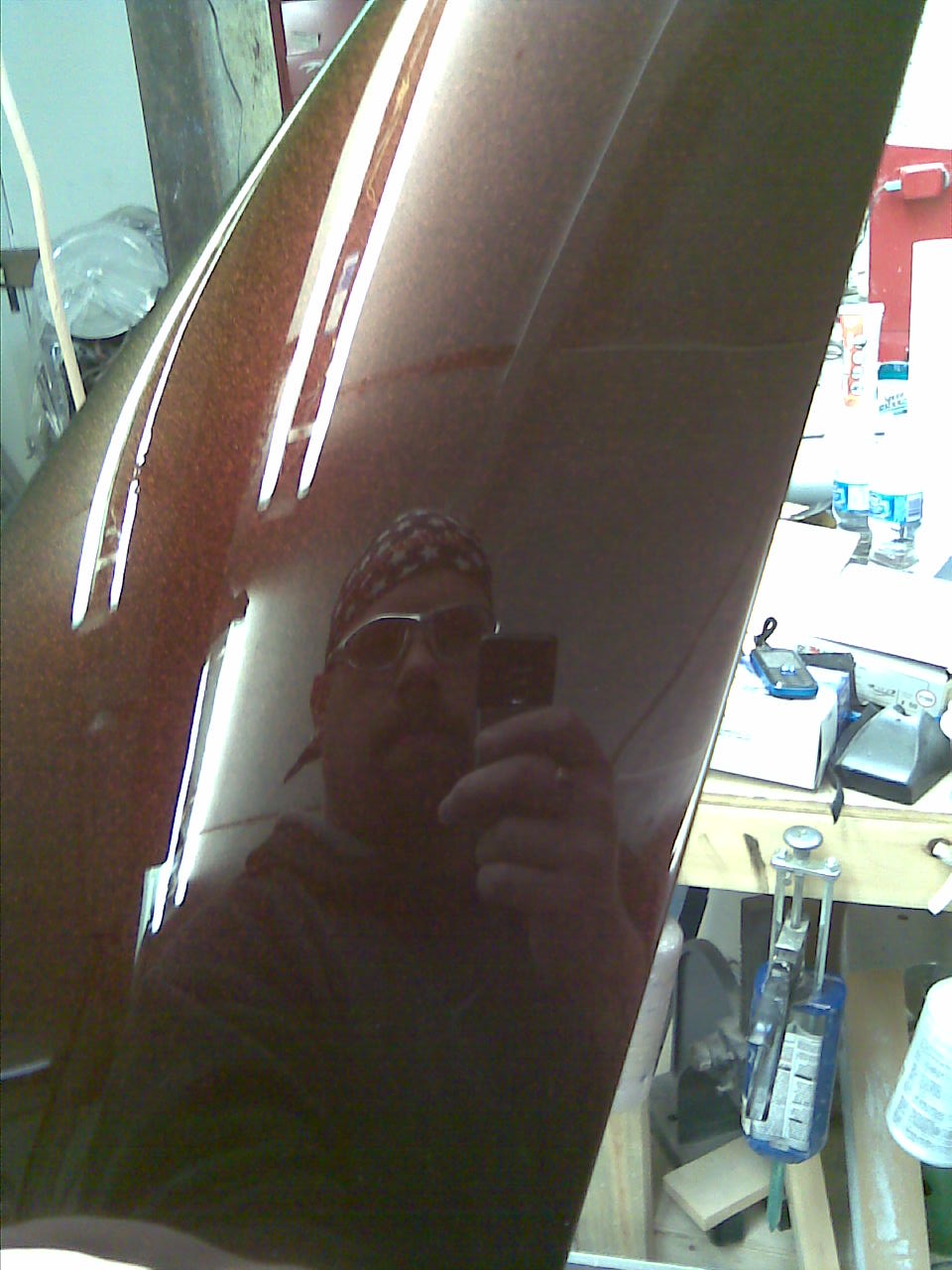

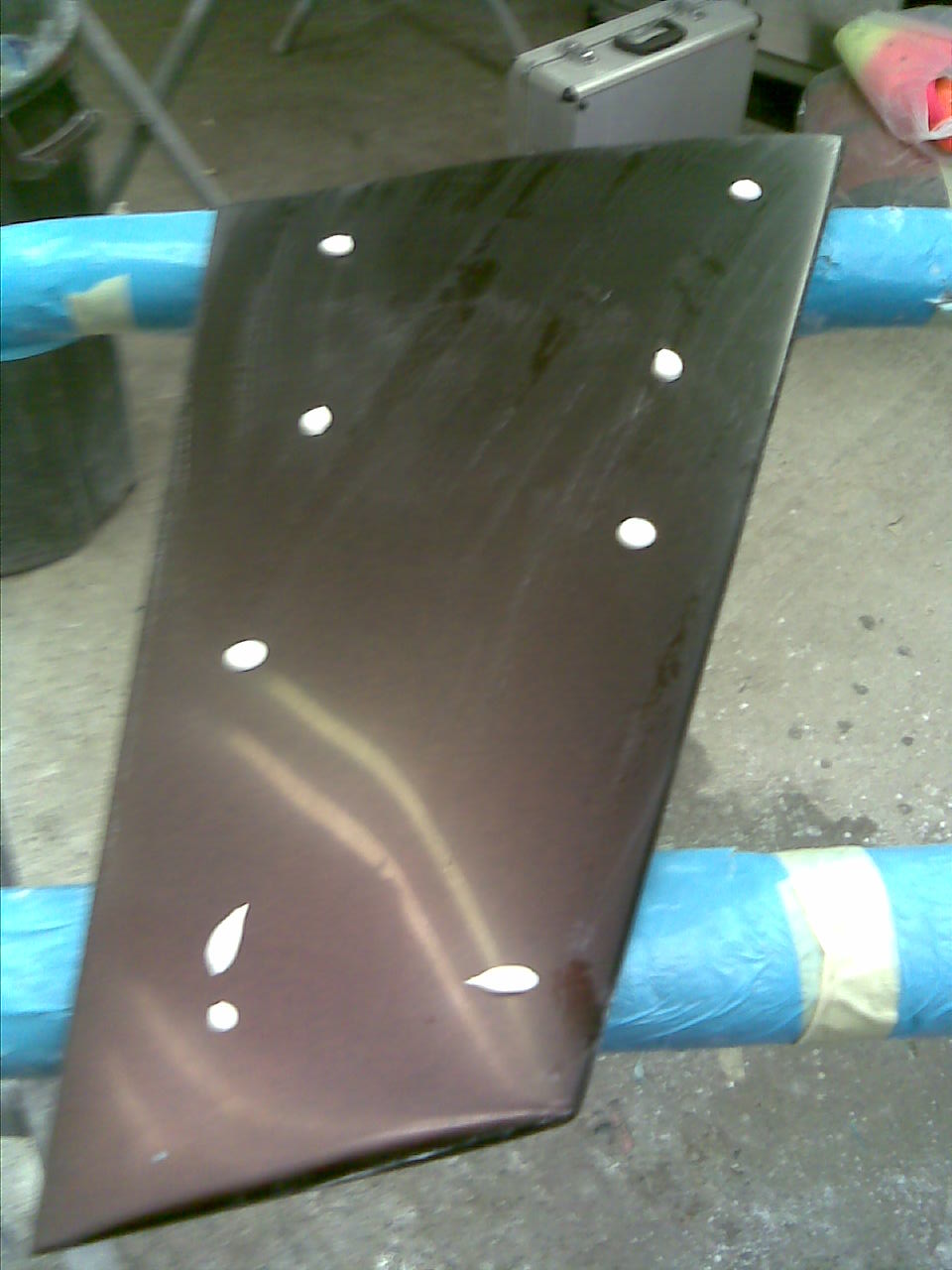

Ok, so, here is where a paint job really starts to take on a life of it's own. This is really the difference between a nice job, and a "HOLY $^!^" job.

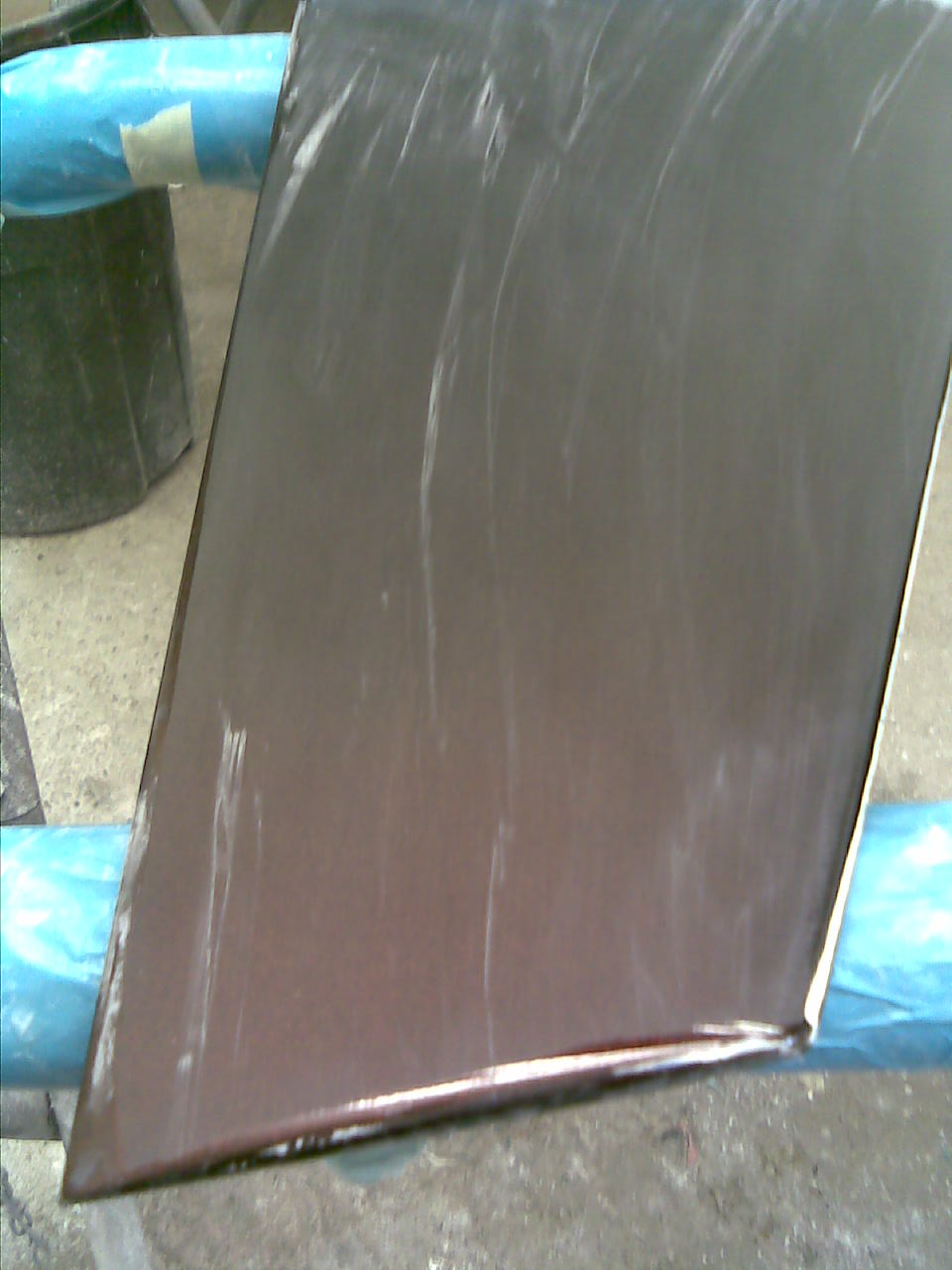

Picture 1. Here is the stab, it looks pretty good, but you can definitely see the orange peel in the light reflections and yup, there's some dust in there!!!
Picture 2. Some more dust just to show you that even with a paint booth, and doing things properly, dust is inevitable.
Picture 3. First, using the 1500 grit sanding disks on a soft block (I use a foam rubber sanding block, again from 3M and just wrap the disk around the sides to hold onto it) begin sanding the surface, check it regularly by wiping it dry, you will instantly see the orange peel, and any dust in there.
Picture 4. Sand the surface until it's uniform and you no longer see any dust or orange peel. Don't worry that there's no shine, we'll bring it back! While sanding, I first sand in one direction and then again at 90 degrees to the first. Don't start sanding in circles.

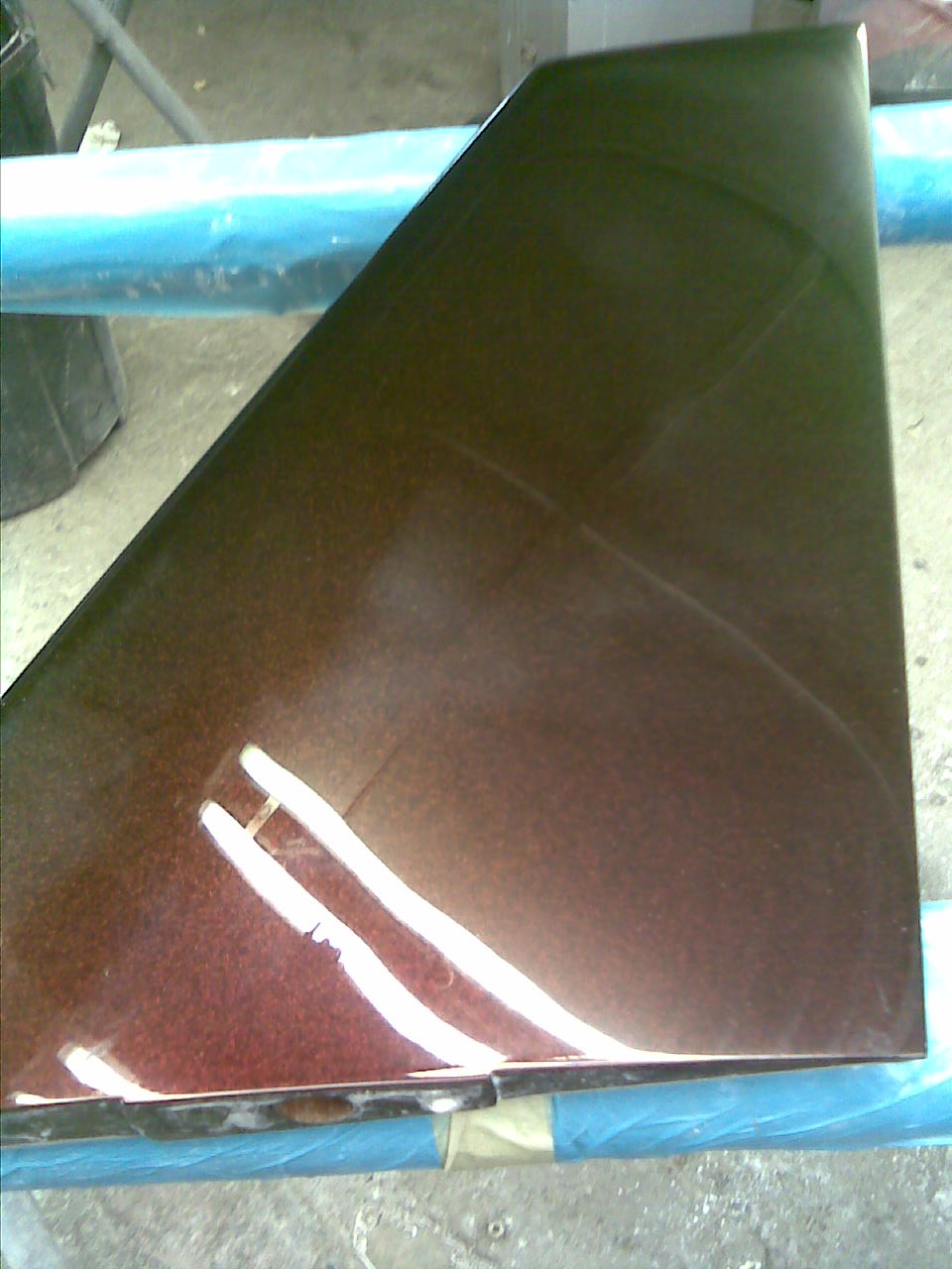

Picture 5. Change to the trizact 3000 grit pads and go over the surface until you can no longer see any 1500 grit scratches. It will start to change to more of a satin looking finish at this point.

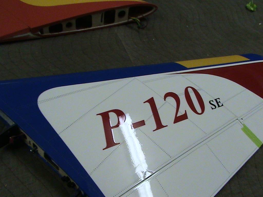

Picture 6. Now wipe it dry, and put a few drops of the extra cut compound on. Use it sparingly, to much and it won't break down while polishing and you'll end up going through your finish. Use the white waffle pad on the polisher on it's lowest RPM setting. Before starting, wash out the pad, keep it damp.
Picture 7. Before turning the polisher on, rub the polishing compound over the surface with the pad, this will spread it out evenly without flinging it all across your shop.
Picture 8. When you polish, always make sure the polisher is running OFF the edge, in other words, make sure it's running so that it cannot hook a corner or dig into the edge. This means holding the polisher at a slight angle on the edges. Overlap your passes by at least 1/2 when polishing and do NOT press down on the polisher, the weight of the polisher itself is more than enough. Pressing down will generate to much heat and you run the risk of burning your clear. Using to high of an RPM will do the same thing. At this point, it's looking pretty good, but still slightly hazy and swirl marked. repeat this step if you still see minor scratches, if you see deep scratches you'll need to go back to your sanding and sand the scratches out first.
Picture 9. Switch to the swirl remover and repeat the previous step with the grey waffle pad, again, wash it out and keep it damp. Now you should have a surface that is mirror like! If you still see swirls or scratches, repeat the process.
Picture 10. Now the light reflections don't have that hazy uneven edge as the orange peel is all gone as is the dust!
Picture 11. Here is the bottom of the stab with the pearl white.
Picture 12. Here are the stabs back on the airplane, now, just the rest of the plane to paint!!!!

Is there a difference between the two waffle pads? I was never told why one is for a certain polish and not the other by the paint shop. Also, you wipe down the wing between every buff, right? Just making sure I have good notes in my head. Thanks for the lesson. This is an excellent thread.
Hi Jimmy,
Yes, sorry I forgot to explain that. The two pads are of different hardness's. The white one being firmer and "rougher" than the grey one. The white one cuts heavier, in combination with the heavy cut compound it takes scratches out very fast. However, if you were to use the white pad with the swirl remover, you would still have swirls as the pad itself is somewhat abrasive, conversely, if you tried using the extra cut compound with the grey pad, it would not polish out as well since the polishing compound would work it's way into the pad faster than it would cut the surface. Eventually it would come out ok, but it would take far longer and you would seriously risk burning the clear. Also, you don't want to use the same pad for 2 different compounds, if you tried using swirl remover and the extra cut compound with the same pad, you would still have some of the grit from the extra cut compound in with your swirl remover and never be able to fully remove the swirls. I wipe down the wing in between the 2 different compounds yes. When buffing, you keep going until the polishing compound is almost all gone, it will break down as you polish, starting out quite aggressively and then toning down into a smoother finish. If you are having to wipe a lot of polish off of the surface, you are either using way to much polish, or not buffing long enough to let it work properly.
