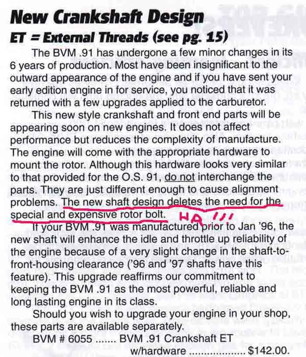

Hi Harley!
You really jogged my memory. If I am not mistaken this bolt is one of the reasons that BV switched to the special machined nut on the newer 91s and 96s!! He wanted to get away from the special machined bolt!!
Ha! No good deed goes unpunished!! No wonder I cannot get BV back on these boards, look at the crap he would have to deal with!!

I believe the .96 has the new style crank and rotor mounting parts. The .96 never had the long retaining bolt he is looking for. I don't doubt you changed the short one on your .96. That short bolt is probably a normal hardware store bolt.
I agree with the crowd that says bv had the old-stlye-long bolt specially made for a reason. It also had a special washer too.
I have a few of those special bolts... maybe I should ebay them... sounds like I could make a buck or two!
Good luck on your search to find an aftermarket one.
Dustin
