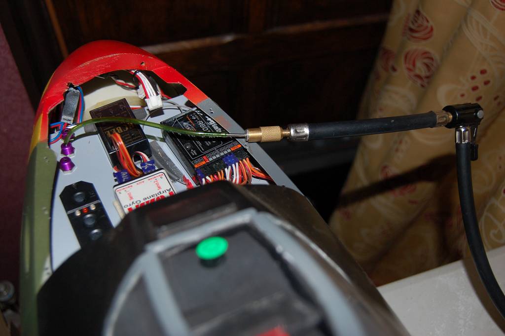

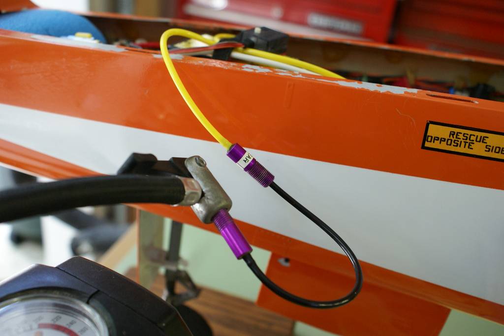

Default RE: Air Fill Question
With the BVM Air Fill Valve, you can insert a length of air line into the hole in the valve.....use an extra air fill valve in the chuck of the compressor, or a BVM Air Fill Chuck...P/N BVM2192.
Cut a slight bevel on the end of the hose, and do not insert it more than 3/16" into the fill valve..Use Caution....there is a very small "Duck Bill One Way Check Valve" inside that could be damaged if the tube is inserted too deep.
I just use the bicycle tire fiitng like in Harley's first picture directly on the bvm fill fitting. Then you dont need to use anythign that neads to be screwed/threaded on.

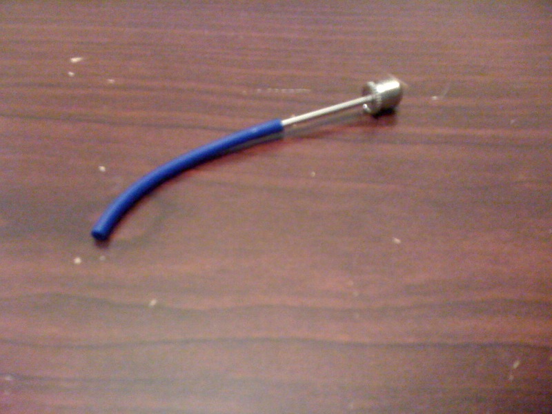

My inflator came with a needle for inflating balls. I simply pushed the 3mm tube over it and the other end is treaded and the rubber clamp of the pump fits over it. Works well at no extra cost.
John

OK perhaps this will help.
John

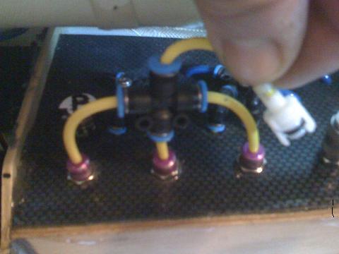

ORIGINAL: smitty1001
http://<b><font color=''#00265e'' si...our</font></b>,
so one end goes in place of your BVM check valve and stays with the plane, the other end stays on your compressor?
yes this is what i also do
i just hook up one conection and everything fills up
the photo show what stay in the plane
Smitty1001, Precisely. One end goes in place of your BVM check valve and stays with plane as your NEW check valve, other end stays with compressor, that way you just click the to connect, fill up, then unclick them. ZERO air lost during "unclicking" process and no having to thread and unthread fill valve.
Its just cleaner and easier, just like DelGatoGrande shows in his photo.

John, I just rigged up a setup like your pic - works fine, I'm gonna roll with that and see how Ilike it.
