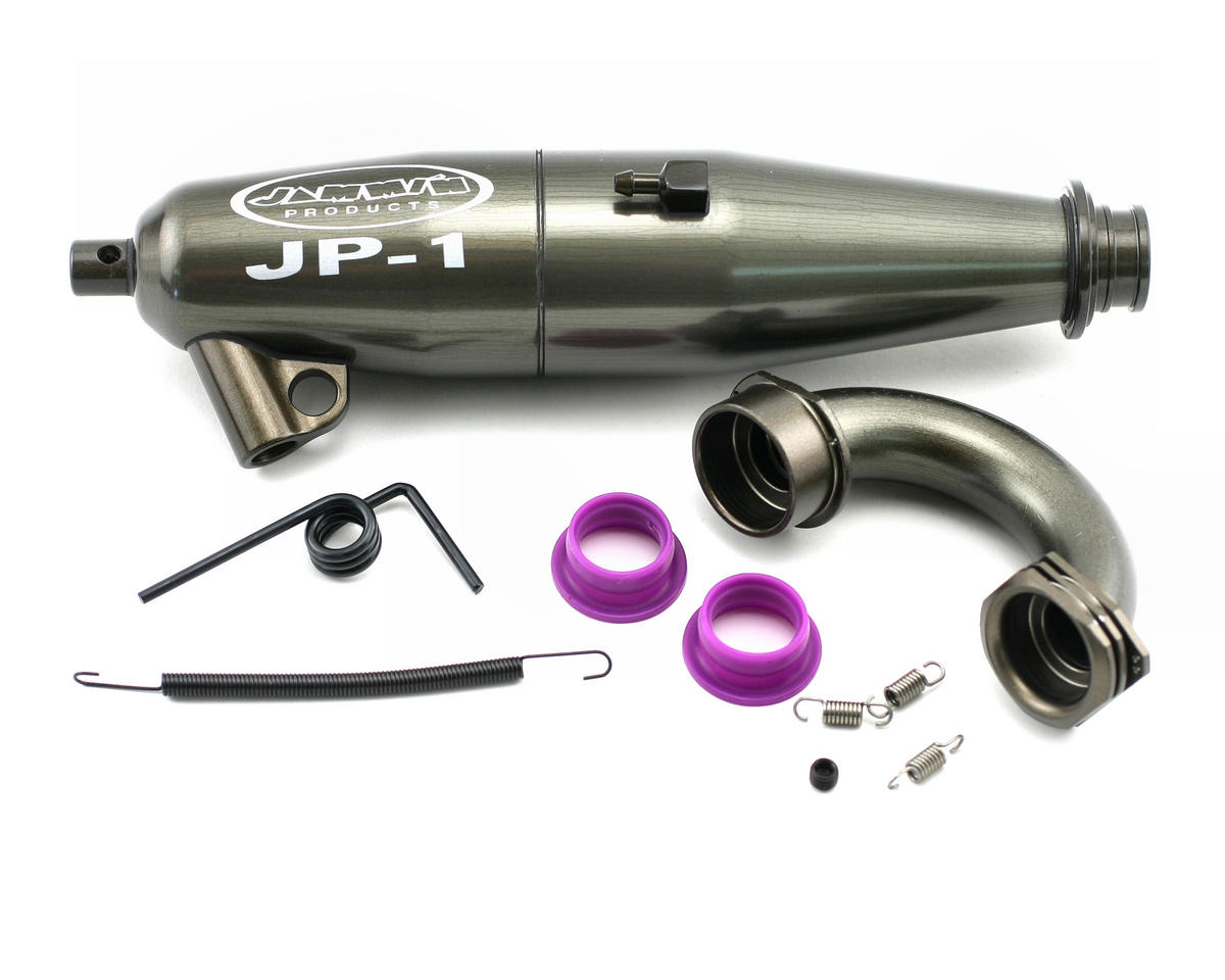

I know, pipes made specially for off road aka more torque are more rounded and pipes for on road aka high speed/revs are a little more elongated. It has something to do with the necessary time for the shock wave to return to the engine and push the fresh fuel back into the cylinder.
Exactly right! 2 strokes depend on the exhaust for almost all of their performance potential. I've run both longer and shorter pipes on different engines over the years and there is a difference between them. I think a longer, larger pipe is better for torque and a shorter, narrower one is for top speed. I could be wrong there though. I've only ever bought a few aftermarket systems, mostly from THS. But I do remember putting an MIP stinger exhaust on my old gen 1 .15 T Maxx once upon a time when it still ran and was in one piece. It seemed to have the same power down low as the Traxxas blue one I had before, but a noticeable increase in top end power and RPM was there. That pipe had a longer header, but the pipe itself was a few mm shorter and about half as wide as the one it replaced. It gets even more complicated when you introduce multiple chambers and tunable like the old CVEC pipes had and an automatic adjusting chamber like the BUKU ones had. Going with the one that came with the engine usually gives a good balance of both torque and top end. I am still considering throwing a torque tuned pipe on my Kyosho like a Jammin JP-1 to coax a little more torque out of it. The massive THS Savage pipe on my LRP .28 is insane! It's tuned much richer than most run that engine at (Tuned to average settings it was way too lean) and combined with 30% Bones fuel it just flies! But, that combo is also extremely fuel hungry and louder than hell

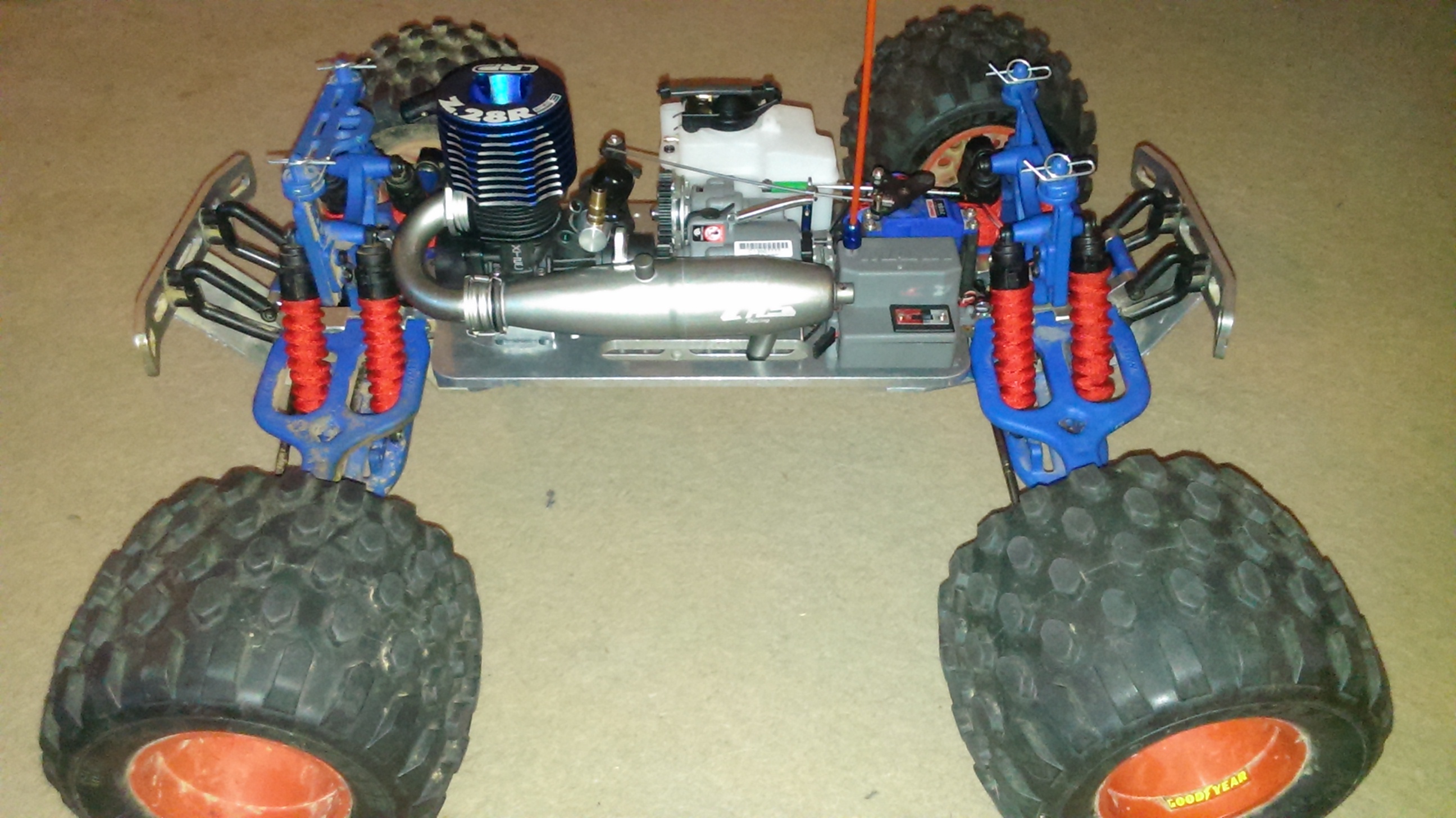

Here's a good pic of it. It is a good inch or so longer than the one on the Kyosho and quite a bit wider, too. That's on an extended chassis and I still had a hard time fitting it around the receiver box hahaha.

Ah yes I think you're right now that I look at it again. The middle one on the torque side looks almost identical to the stock one on the Mad Force. The Mad Force has a very long header though, much longer than the ones pictured. Here's one of the go to pipes many guys recommend for torque in .21 and up engines. Looks very similar to stock, but with a 1 piece design and a shorter header. I've also heard the Dynamite 086 is a killer torque pipe too and a bit cheaper than the Jammin is.

I might be so, but, if you ask me, I would choose Dynamite 053 instead of 086 for a monster truck if you want more torque at low revs. Amain lists both of them as off-road pipes, probably the difference is on what type of car you install on and what type of terrain you are running on. I know I would choose 053 for my needs, especially steep climbing over the hills
Generally, single chamber pipes will aid the low to mid part of the powerband where multi-chamber systems are for mid to high rpm power. The shorter the whole system (header, coupler, pipe) is, the higher the rpm potential. If the engine doesn't have enough exhaust timing though, too short of a "system" will have erratic running behavior. Short system - fast pressure wave return - high exhaust timing. Long system - slower wave return - lower exhaust timing. Generally. Some multi chamber pipes work a bit different though.
FWIW, most guys with monster trucks will opt for an 086 variant as the engines for monster trucks often have a decent low end to start with. An 086 won't hurt the bottom end much, but helps the top end a bit. On some engines it helps a lot. It is said that an Ofna 086 and the Dynamite 086 are very different pipes with the Dynamite being the better of the two. The barn burner pipe to have is a Novarossi 51021/9886. That is the pipe that many other 086 variants are based from. The Novarossi 9853 is said to be 98% "close enough" to the 9886.
