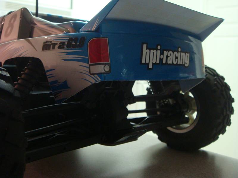

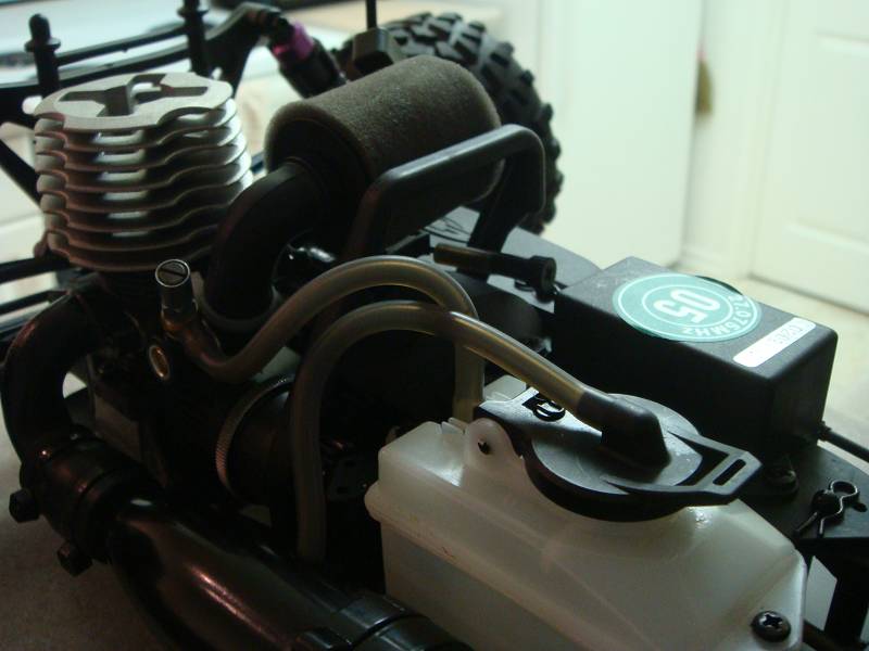

Hello, just got an MT2 G3.0 second hand. Its my first nitro and from what the seller described, it still needs to finish breaking in. Is there anything i need to look for before firing up this beast? Only reason why I asked is cause it is used, I really dont know what to expect and any advice can help. Very much a noob to nitro, need all the help I can get. I do have the instruction manual so I've got the basics covered. Any tips and will work, Mods and so forth. Great job on the thread! Hope my first experience to nitro will be a great one. Thanks to all!!!

All you need for the LRP is the engine mounts. You can use the flywheel and clutch assembly from the stock engine. Make sure you post some pictures of the build.
sixty congrats on the new truck. The first thing I would check are the diffs. Try rolling the truck back and forth and then turn one wheel in each direction to make sure they turn smoothly. After that check out the spur gear for damage. If everything looks good then reset the needles to factory settings and fire it up. Good luck, keep us posted.
