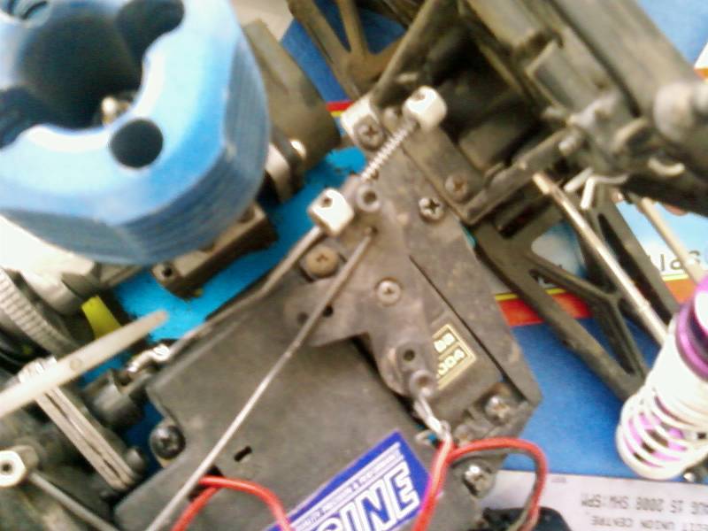

ORIGINAL: Gbaby158
Na, its a thing that happens on them carbs i've been told, the slide expands at a different rate. Look in the monster turck thread and then into HPI and picco engines.
Ok but you still have to change your linkage man unless im not seeing something in that picture. If you dont have that spring on the carb linkage to relieve pressure then when you aply brakes its trying to push the carb closed

when your not on the throttle or brake the carb should be closed to idle and the brades off ! to achive this you need a spring and 2 collars. i can't find my pics but look at the one i made it has to be copied to work you have no braking spring on the carb linkage.

You need that spring and collars plus a special slider that slides on the linkage. Just get that ofna one man its the best way to do this. Or you have to make one. I made mine on my mt2 out of a hunk of plastic a small piece of antenna tubing 2 collars and a stiff pen spring. Ill put my pics up righ away. If yo dont have the springs and collars your going to wreck your carb because its going to try to close the carb when you brake.

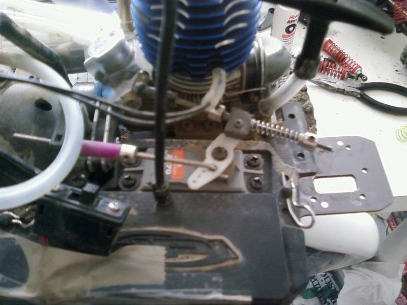

Here are what mine look like there for rotary carbs but all you have to do is change where the carb linkage is mounted on the servo horn. And one of my revo I was muddin with it friday

Hey gues iv been away for the weekend, but this is the linkage im useing http://www3.towerhobbies.com/cgi-bin...?&I=LXCXF8&P=7 same one that was posted before. The stock servo arms are 2 peaces right, all you do is replace the top half and the horn ends up looking like it dose in my posted pic (pg 720)

Take off you horn and have a look at it, you will see that there is a peace that sticks out and a peace of metal that wraps around it. On the one that its at 12/3 the peace sticking out is moved to a diffrent spot on the servo horn. Thats how it works, just like a stock one, but the top peace of the horn is turned pointng to the 12:00.
Iv tryed to make it work with a stock one but it was an epic fail.
