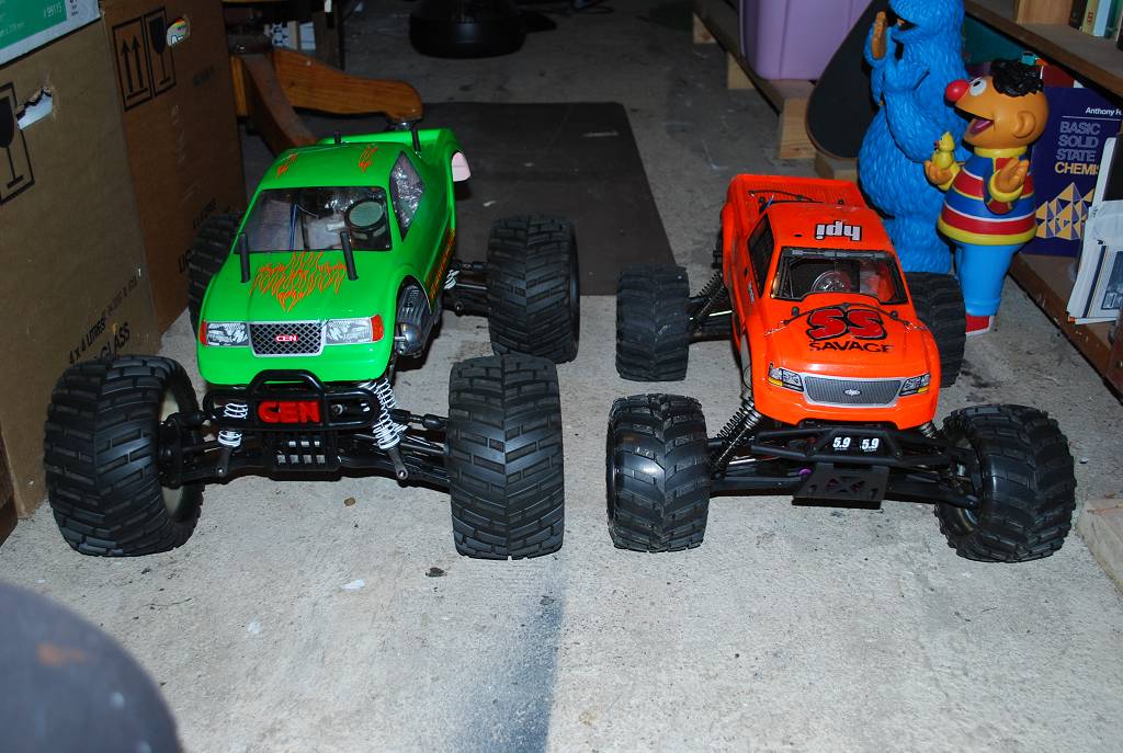

Here is the difference in size between the CEN GST 7.7 and a Savage X SS.
ID:	1318806   Click image for larger version

Wow that thing is huge!
