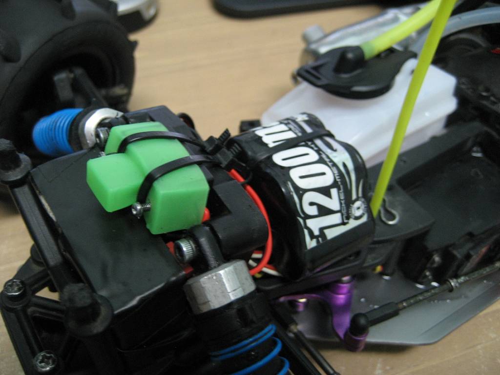

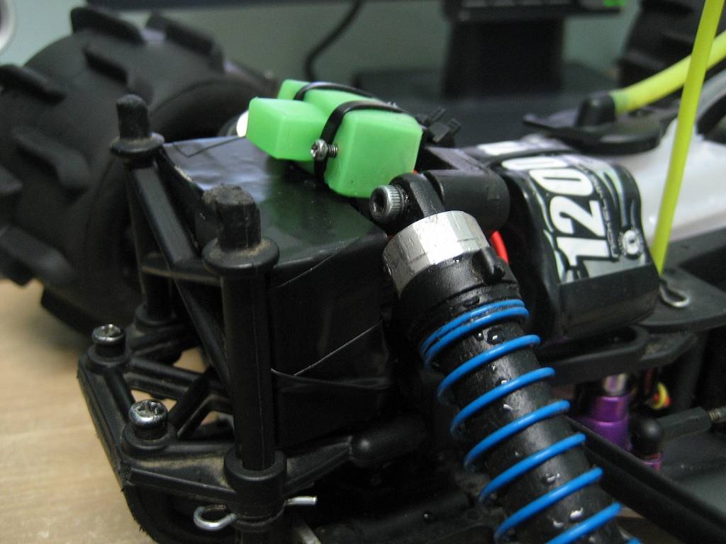

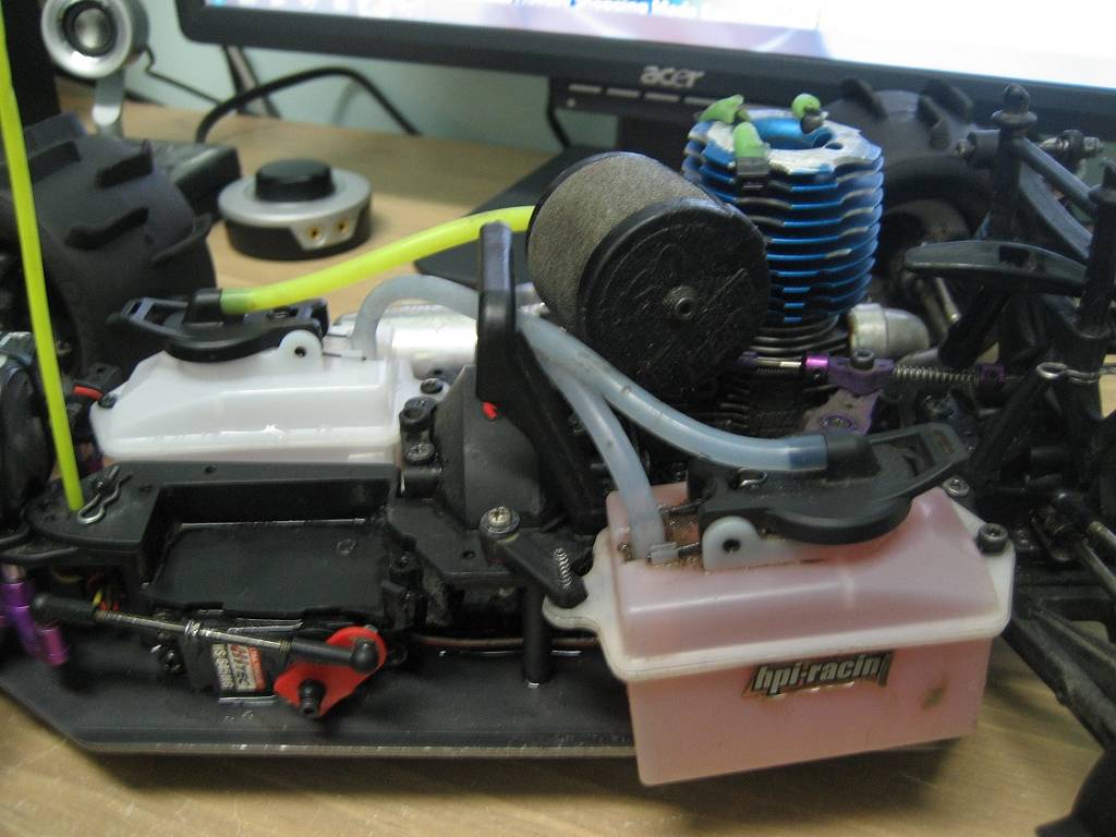

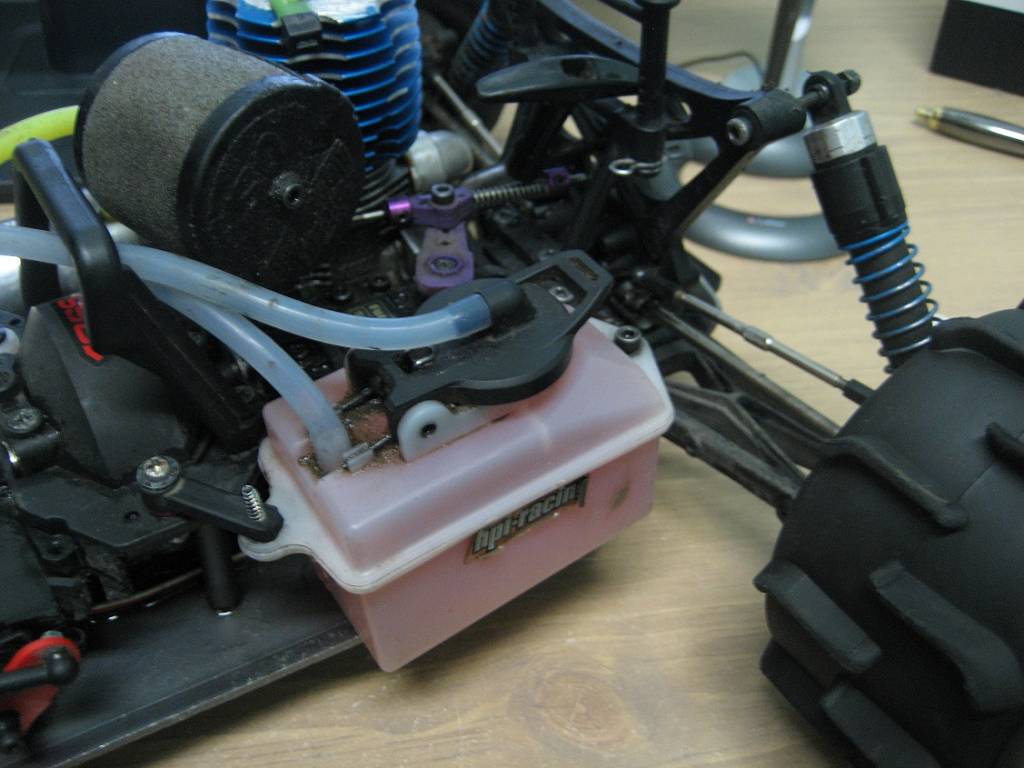

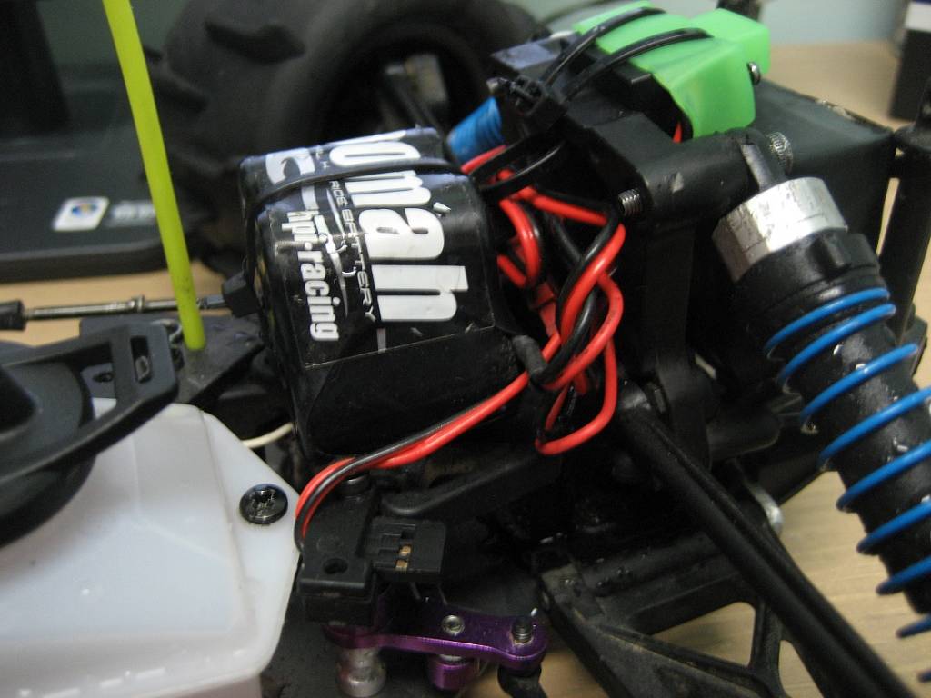

Hey guys,
I have done some work on my mt2 - the two speed and big block are out of the truck as a single speed matched with a small block make the truck much more controllable in the winter - and just completed a DUAL TANK MOD for it. I now have two tanks mounted on the truck and the second tank is in the original position of the battery pack. The tank fits like a glove in this position, although some cutting to the radio box was required. Now, since my mt2 is mainly for on-road use, I aimed to moving its center of gravity as far forward as possible as the wheelies with the big block got quite annoying. To achieve this, I happily moved the receiver between the shock tower and body mount (just fit) and zip-tied the hump pack on top of the steering assembly. I installed a three-way switch also so that charging does not involve me cutting and removing the hump pack every time. The pictures below speak the rest. If you have any questions about the mod feel free to ask. Peace

Interesting.
From the pics it looks like the exhaust is piped into the original tank and that the original tank feed nitro into the place that the exhaust is supposed to be. Am I right?
Only thing I would ask is if it suffers from a form of the half tank lean like savages.

Thats definitely different. Do you have any problems with the fuel transferring from one tank to the other? With a small block you must get ridiculously long run times.
Is there anything protecting your receiver?

Syco_Venom: Yes you are correct with the tank setup. I know the dreaded half tank lean you speak of on savages, and as far as I can tell, this is not the case with the dual tanks. All signs point to no half tank lean thus far, but I haven't ran both tanks empty just yet. I will for sure get back to you on this one as more testing is done.
KeithjV: Fuel transfer is flawless. Throughout the whole time I ran it (25+min), fuel delivery was consistent through the transfer line connecting both tanks and there were no signs of air bubbles or leanouts. As for my receiver, I am going to place it in a balloon for winter use, but this car is usually setup for on-road use with road tires and a two speed. It rarely sees and dirt, water, mud, etc. so I am not too worried about damaging the receiver. I definitely see what you are saying however; this mod may not be feasible for all you guys bashing these trucks but for me, its suited.

25+ minutes... nice!
I was more concerned with anything hitting the receiver from the front.

Yeah head-on impacts may not end pretty, but:
1. I don't jump this truck so those nose-dive landings are out of the picture
2. The only way i could damage it would be in a collision with a car on the road or whatever, but with it travelling at 50+ mph (got it clocked at 59mph with a picco .28 in it), more than just the receiver will be damaged
3. I am running an ol' cheapo stock mgt radio system in the car so if it does get damaged, $10 on ebay can quickly buy me a new one.
Overall, I am not too worried about damaging the receivers but I am stoked to drive a more balanced and better handling truck with insane run times . Too bad there's a foot of snow just outside my door...
