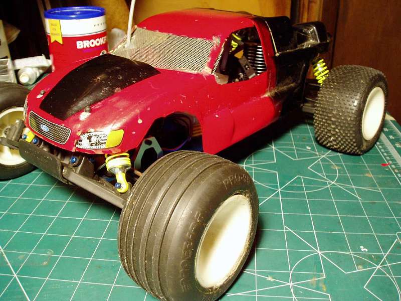

I see this post is starting to get buried, So I figure Id fire up an update on my truck. I finally installed the front shock mount amongst a few other parts. I guess I need a new body now, as you can see from the second pic. I finally started to break in the Epic .18 motor. But Im taking my time like I usually do during breakin like closely monitoring the temp. In the near future I want to start getting some metal for the suspension, But at the moment my Hobby fund is low, So Im probably getting rid of My HPI MT2 on E-bay, unless anybody is interested and is willing to make me an offer. PM me for details.

The stinger pipe has some good points and bad ones, Its easy to flood your engine with a stinger pipe, But it also blows out the exhaust and unburnt fuel out the back instead of getting it all over the side of the truck, Plus it seems to boost the performance, I had a purple stinger pipe on it originally, when I pick this truck up a few years ago, Its just that the purple did look goofy. So now its in the parts bin

You need to cut the shaft for it to fit into the RC10gt, I first had the hobby shop cut it. But it was still too long, So I had to break out the dremel and finish the job, otherwise its pretty much a drop in fit. The Engine at first has been a little difficult to start, Due to the Stinger Pipe Flooding the engine. Im still in the process of breaking it in. At first I thought this engine was a dog, But as Ive been slowly leaning it out its showing some real promise, Right now this engine starts on the first 2 pulls. I figure a couple more tank fulls and Ill see what Ive got here.

Ive have about a quart of nitro through it, Ive been anal retentive keeping it rich. Im also tweaking with other parts Ie setting the brakes just the way I like them. I have to mess with the suspension because Im getting the rear wheels hopping around turns (need softer springs?) right now Ive been keeping the motor under 200 degrees, does anybody know the most efficent operating temp? unfortunetly Im might not be able to use the car this weekend due to commitments. But I might try to at least burn a tankful if Im able.

It won't break-in properly under 180F (at least that is what Trinity says and the same is true for BBs so...) but 200F is good for cycling. On the last 4 or 5 tanks I began to lean it out to get it over 210. At 210 it was still INCREDIBLY strong but leaning it out.... wow. I have for the last 3 tanks gotten it up to 236-242 and it SCREAMS there. I have no need to ever run it more lean. At those temps some times it sounds a bit lean (screaming on the high side) but I suspect that is a product of the short-stroke, as the temps never got over what I said in the last sentence. I love this motor and I hope it lasts; it has really impressed me.
Mine is really sluggish until about 205-207F, then it begins to come on. How does yours run at 200?

I runs suprisingly well at 200, When I get a chance Ill up the temp over 200 and see what happens. I dont think Im going to have a chance until next week.

Well after a few runs with a broken in Epic .18 motor, I found out this motor is the one to go with, It might be a bear to break in, But once your there. its very easy to tune and starts in about 2-3 pulls, Plus it is insanely fast, But the truck has been controlable. Ive noticed my track has gotten really small. Now Ive got to upgrade the steering linkage because its constantly getting loose besides I want some more metal. So those parts are in the mail. Next parts will be the bulkhead and A-arms, Which are going to have to wait for the moment for I need a new motor, For a larger truck like my transportation....yikes
