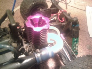

Old 02-13-2009 | 06:07 PM
Joined: Nov 2008
Posts: 14
From: conway, SC
Default RE: hpi rush problem
idk it was on the truck when i bought it used.
it is an hpi and it has a purple cooling head ill try to get a pix of it and post it

Old 02-13-2009 | 06:35 PM
Joined: Nov 2008
Posts: 14
From: conway, SC
[img][/img]
Old 02-13-2009 | 06:47 PM
Montana Mike's Avatar
Joined: Jul 2008
Posts: 912
From: Helena, MT
is there no markings on the engine anywere?
Old 02-13-2009 | 06:58 PM
Joined: Nov 2008
Posts: 14
From: conway, SC
it just says hpi on both sides
Old 02-14-2009 | 07:47 AM
241 racing's Avatar
My Feedback: (20)
Joined: Jan 2008
Posts: 687
From: Dekalb, IL
If you have no compression your wasting your time on this engine.Look on the bay for a new motor 12to18 there are tons of options out there that would make the rush go pretty good.You can get a solid motor for under 100 no problem,won't be the best powerhouse motor but will be decent and easy to tune with good overall reliability.You could rebuild the motor you have but honestly it's not worth it.Good luck and if you need help on picking a motor just pm or post what your looking at.
