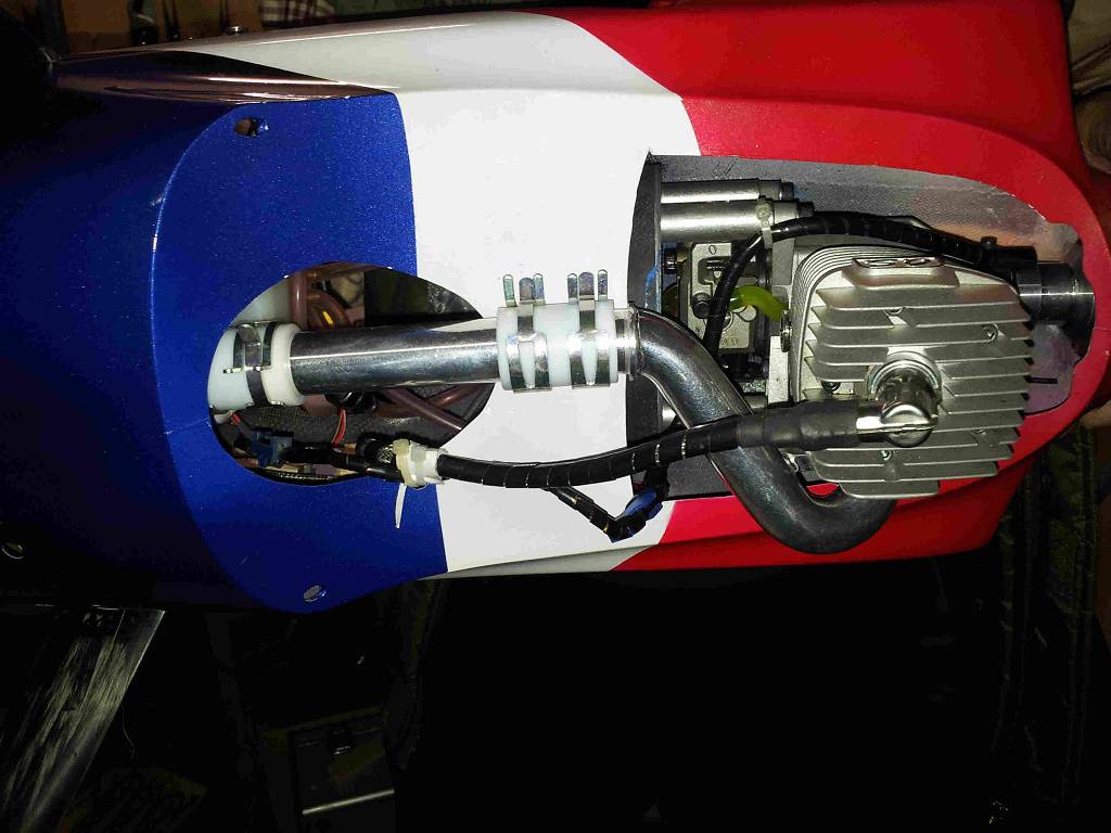

In meantime, while I wait, the Mintor 38 installation in the Extra is just about done. I had to reposition the throttle and choke arms to fit my application and also took the opportunity when disassembled to remove the extra hold levers that particular model Walbro has on it. Also needed to separate the arms from each other. Decided to drive the choke with a servo rather than manually. Now let's hope for nice weather next weekend.

#69
ORIGINAL: MTK
Curious....what does it weigh? The Hatori cannister? Is it a tuned pipe or just a muffler?
The ES pipe is what I use, either the 30G or 40G... these work well, are very quiet and light at 3 1/2 ounces
#70
Joined: Feb 2008
Posts: 54
From: Daegu, SOUTH KOREA
Dear MATT
I did not expect power boosted, it is a caniser for noisy reduction without affecting power.
In my case, it just happened probably due to rich fuel setting etc. Just after mounting the engine power plant in late evening, we could not adjust the engine needles because of no holes in the cowl, did not have enough time to make hole to access to the needles.
My friend who has another OS GT33 ordered a ES 40G tuned pipe from your thread. I got these Hatori from one of my friend who is building this Smaragd for me, a heli propessionalist for argricutural use. The performance between ES 40G and Hatori will be compared but I am not sure when. It will take one or two months.
All answer is here:
http://www.hatori-models.co.jp/HP3/k...301.2551e.html
http://www.hatori-models.co.jp/HP3/k...air/2300e.html
Regards
All answer is here:
Regards

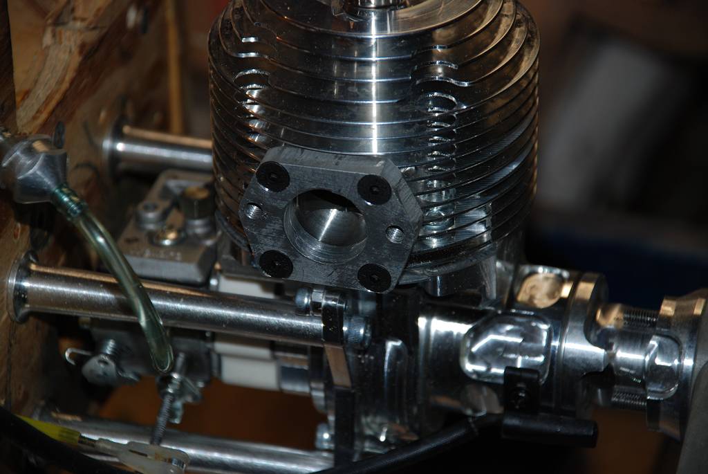

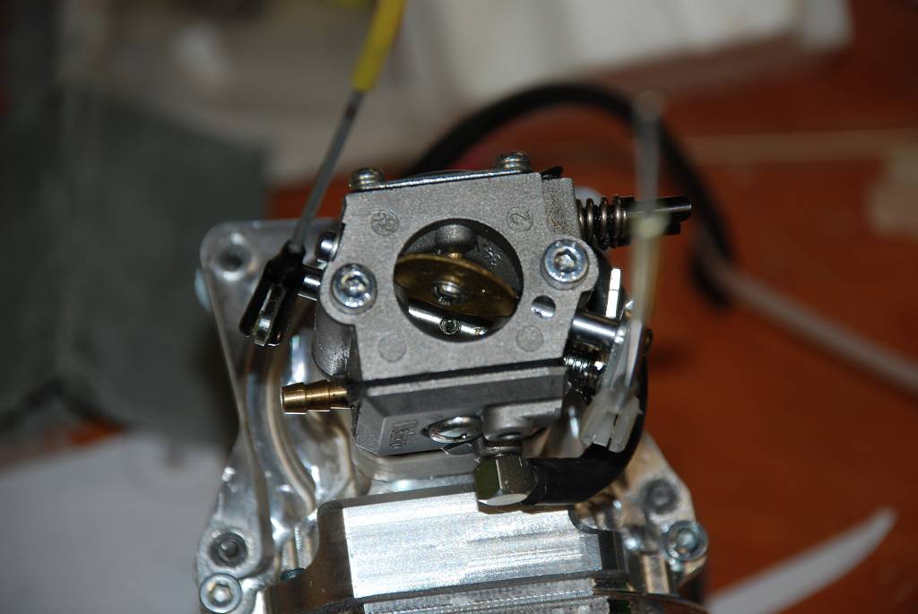

Here's the Mintor 38 installation. Note the DLE CDI unit. It runs the Mintor just fine. Also note the two servos, top is throttle and bottom is choke
The other thing of note is that part of the carb is actually inside the soft mount. The firewall has a hole in it to accommodate better breathing. That also allows me to install a foam insert behind the firewall to help reduce intake noise a little and filter the air

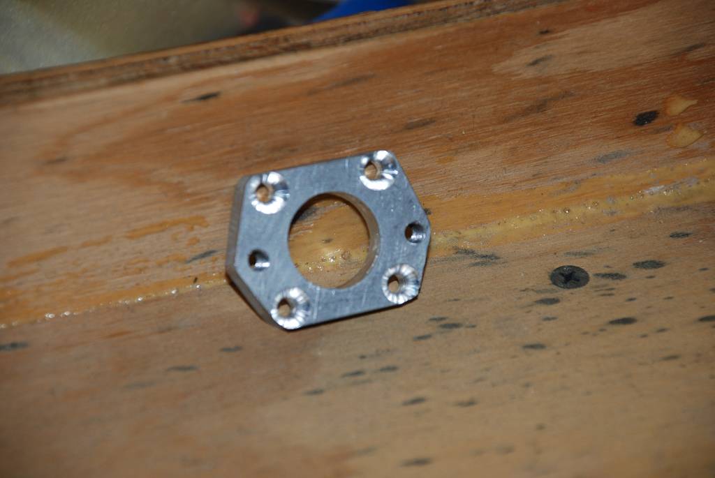

The exhaust adapter is made from 5/16" ally. It works great with a regular hatori header
