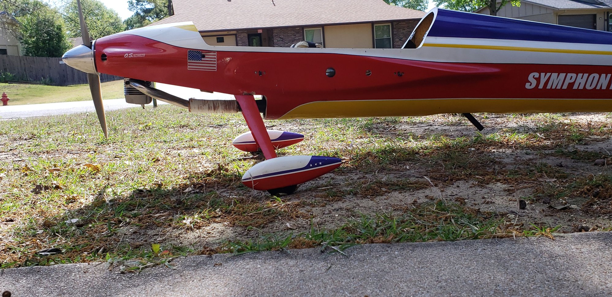

Old Aeroslave got a transplate. OS 33 replaced a YS 170 CDI. CG with the OS came out exactly where the YS was.

There was a person using this engine in the 2019 NATS.
I'm at 800 feet sea level and the OS GT 33 turns a APC 19x11 at solid 7500 rpm in the setup pictured. I'm using a ES Composites 35G pipe.
Ryan Gonsoulin flew his OS33 at the Nats. Plenty of power. My Pentathlon with a DLE 35ra with a canister is not quite as powerful, but has the power to fly Masters. You just want to enter the uplines with some energy. Maybe with a pipe it would be the same performance as Ryans.

What questions do you have?
This set up (OS 33, header and ES pipe) is about half what a YS 200 is. Easy to set up and low maintenance. Half the vibration too.
What kind of airplane are you looking at or have?

The OS 33gt is a long stroke and as such in my opinion has a slightly better torque band than the other gas engines of its size. Ryan spent some time tuning the mid range and it ran really well until a ring gave away. OS replaced the motor and he has since installed and flown but only a couple times due to work and winter/spring off season. I saw big G fly his with DLE and performance was excellent considering it was near 11lbs (I think) and setup on a canister..sound was fine too. The DLE with rear exhaust is definitely a cleaner/easier install and the header may indeed hold up better over time. Computermonkey, I would like to see more details of your soft mount.
-mark
Please see this link on what was done. I was able to directly replace the YS In the same space. Don't get me wrong I like YS engines my favorite being the 175 sport with cdi and the 115 sport cdi.
https://www.rcgroups.com/forums/show...of-a-softmount

The soft mount looks fantastic....
