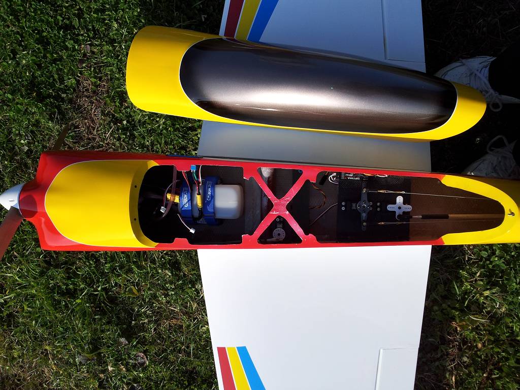

Successful maiden flight of Smaragd powered by OS GT33 gas engine on a Hyde mount with Hatori header and Canister: After rain, our runway was not good for maiden flight; but weather was OK, 10 deg C (50 deg F), 50% humidity and some wind. Honeycomb light wall isolate the canister muffler from electronics and gas tank, photo attached.
To make sure idle setup checked again; video attached: http://www.youtube.com/watch?v=ke2sO_nC30w . Starting engine by hand crank was not easy and several back-ward starting. But very reliable idling on around 1950 RPM with 18x10 prop, not much vibration on a Hyde mount, and glow-like sound with Hatori header and canister muffler. Highest RPM reached up to 7670, no vibration on Hyde mount.
After several safe flights, engine sound was slightly changed to crackling, and could not stop the engine even with fully closed throttle. One of two bolts tightening the muffler header was missing. Does it make sense even fully closed throttle? I think it might be, air can get into through exhaust outlet, it is my first experience.
On a test bed, all OS GT33 engine with stock pitts style muffler and a stock gasket was working fine. I think based on several threads, engines mounted on planes with canister mufflers with other gasket in my case, Starting engine was not easy and even backward starting. Wide opening of throttle, more than 50%, resulted in successful forward starting, but it is dangerous. The stock gasket was good to tight the stock muffler, it is melted to fit on the muffler, it is difficult for reuse. I hope to buy it from Towerhobbies, but not in the parts list. I need a good gasket again.
I will post a video on high speed running gas engine on Hyde mount later after fixing the exhaust header fitting.

I stopped using gaskets on my gassers for this very reason. They just don't hold up. I started by making the header flange flat by sanding it with the paper on a plate of glass. Usually the welding process warps the flange. The engine side is usually OK unless your muffler/header has worked loose and ate through the gasket and was banging against the engine case. Make sure the surfaces are clean, I use acetone for this including the tapped holes. Put a thin layer of Permatex orange high temp RTV on both surfaces and bolt together with red locktite. The red locktite can be stubborn to remove so usually I will hit the screws with a 35 watt soldering gun to heat them up before trying to loosen them.
As for the backward starting, Usually it's because then engine is over primed. Perhaps with a different starting sequence. It's common to flip a gasser with the choke on until if pops and then floods out and quits. Maybe try to start by choking for a few flips short of popping and then try with the choke off. More run time, tuning and familiararity may just fix that one.

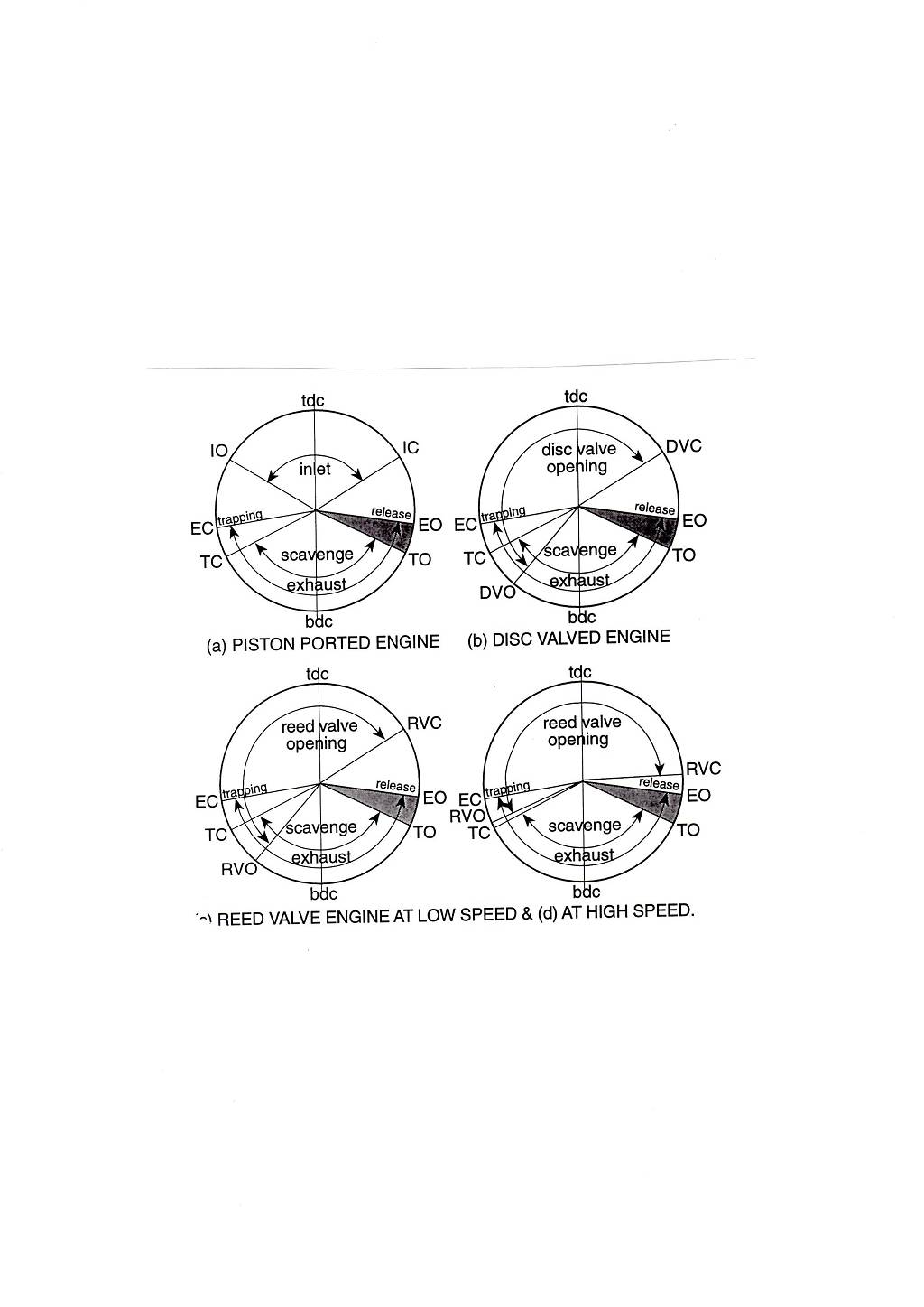

I'm wondering why OS went from front intake on the 55 to rear reed induction on the 33? Any ideas?

I guess it's nothing more complex than size... or lack of it to accomodate the carb at the front.
I suspect it has to do with reducing the crankcase volume.....one way to pack the case a bit more than the rotary valve (of front induction) would allow. This can improve power output if the porting is right.
There may be a weight advantage also. Crankshafts don't need to be as massive when there is no hole to provide strength for.
About the only down sides of a reed set-up is reed float at high rpm and lack of intake timing control. I suppose reeds are noisy so that's another down side for a Pattern application, but that's easier to control. At the rpm we operate, reeds are an excellent, simple solution. And fitting a 3 blader up front helps reduce noise a lot
Choihjin, I get my NordLocks from McMaster Carr. The M5 size comes in two outside diameters....I buy the smaller OD. If you decide to buy from them, you can get the Ultra Copper there too
Hi,
Take a good look at the figures attached. Look for the duration of induction of air in the two exsamples.The more air the more fuel can be burned resulting in more power.
This may be a good reason for rear induction.
Best regards
