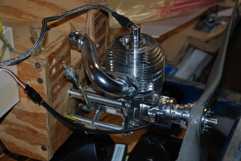

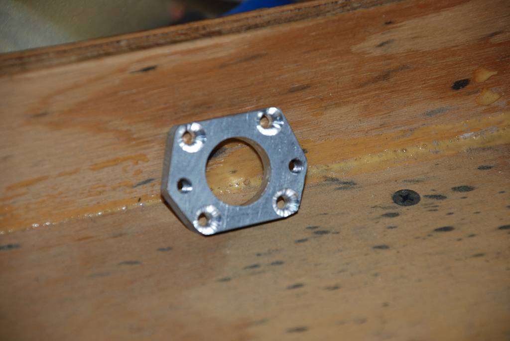

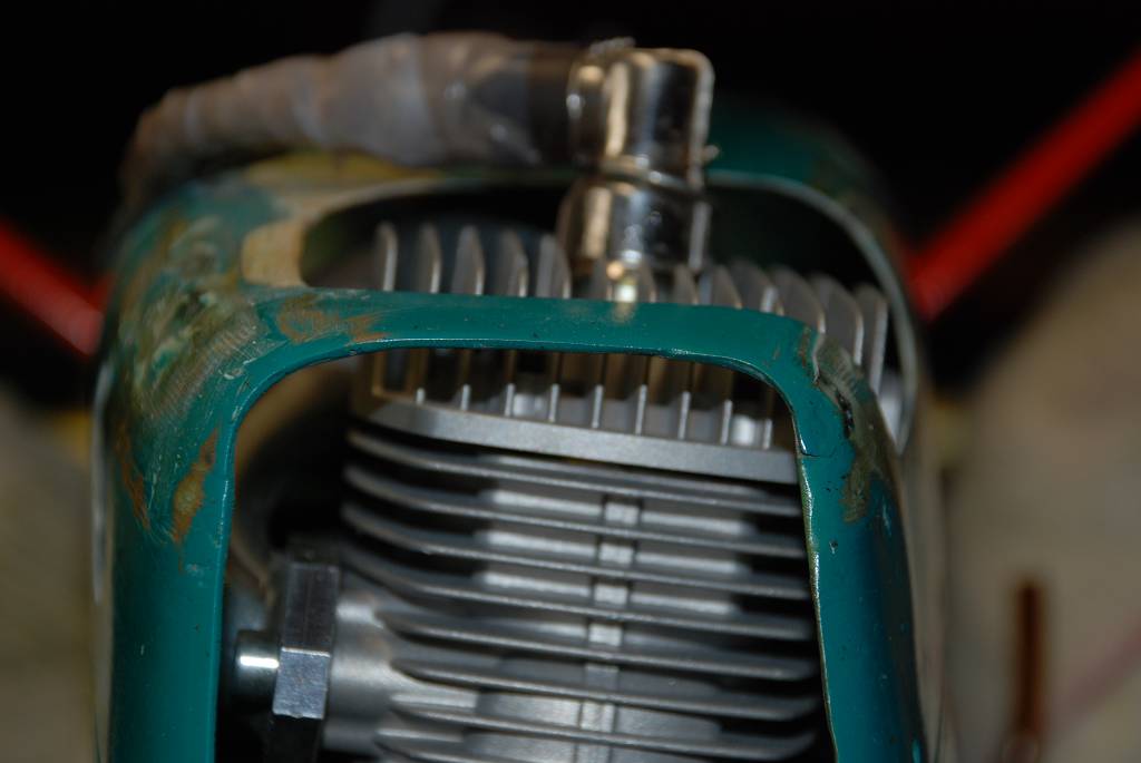

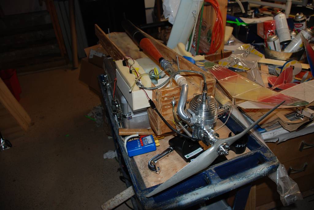

and a few more
ID:	1683997   Click image for larger version
ID:	1683998   Click image for larger version
ID:	1683999   Click image for larger version
ID:	1684000   Click image for larger version

Completed the installation this morning and tried to get the engine started. Well, easier said than done. On the bench the engine worked simply and easily but in the plane, for an unknown reason, it was quite a bear. I suspect the CDI module programming may be an issue. Also quite strangely for a gas engine, it started backwards several times so ignition timing could be off a bit.
However, once started it ran well putting out gobs of power. I decided to run the MDK 18x12 hybrid prop. My SAP 30 cc would not turn this prop without bogging down in the verticals so it was very interesting to me to see the OS33 turn this prop with great authority. I didn't measure rpm...... By ear I'd put it around 8300. Most importantly, the verticals were effortless but I have the engine slightly on the rich side. Two flights were taken today and both were really strong on power.
Got to figure out how this CDI module needs to be treated......

Uh Oh.....That's not good news. I am sorry to hear similar issues as mine. That does not speak well for the engine design. I wish I had measured the timing on it. It sounds like it way too retarded and is the likely cause of all these problems
As I recall, the 140RX had carburetion issues when first released too. Their 200 4 stroke has crankshaft issues, I have heard. I am surprised because I have always had the impression that OS did considerable alpha testing before sending their product out to the market. YS on the other hand often used us modelers as beta testers. Well, so much for impressions. The reality is something different.
BTW- I also have a Mintor 38 in test right now. I don't have it piped yet. Can't seem to find a header for the 38. The exhaust flange would need an adapter so that available headers (Hatori or Karl Mueller) could be fitted. The Mintor, in direct contrast, is so easy to start and run it makes this chore simple. Too early to tell what the performance is like since I've only played with an 18x10 apc, getting respectable power. Will try to fit the engine into my EF EXtra over the Thankgiving holiday and get a few flights on it to see for real what it can do

Just a couple runs so far (about 1 litter of gas) but I can tell the piston fit is superior than that of the OS33GT.
Exhaust adapter has been completed; engine will be run this weekend on pipe
Here are a few photos
Also note the soft mount for the pipe....simple, effective. Doesn't need to be heavy or complicated, to work
a couple more
