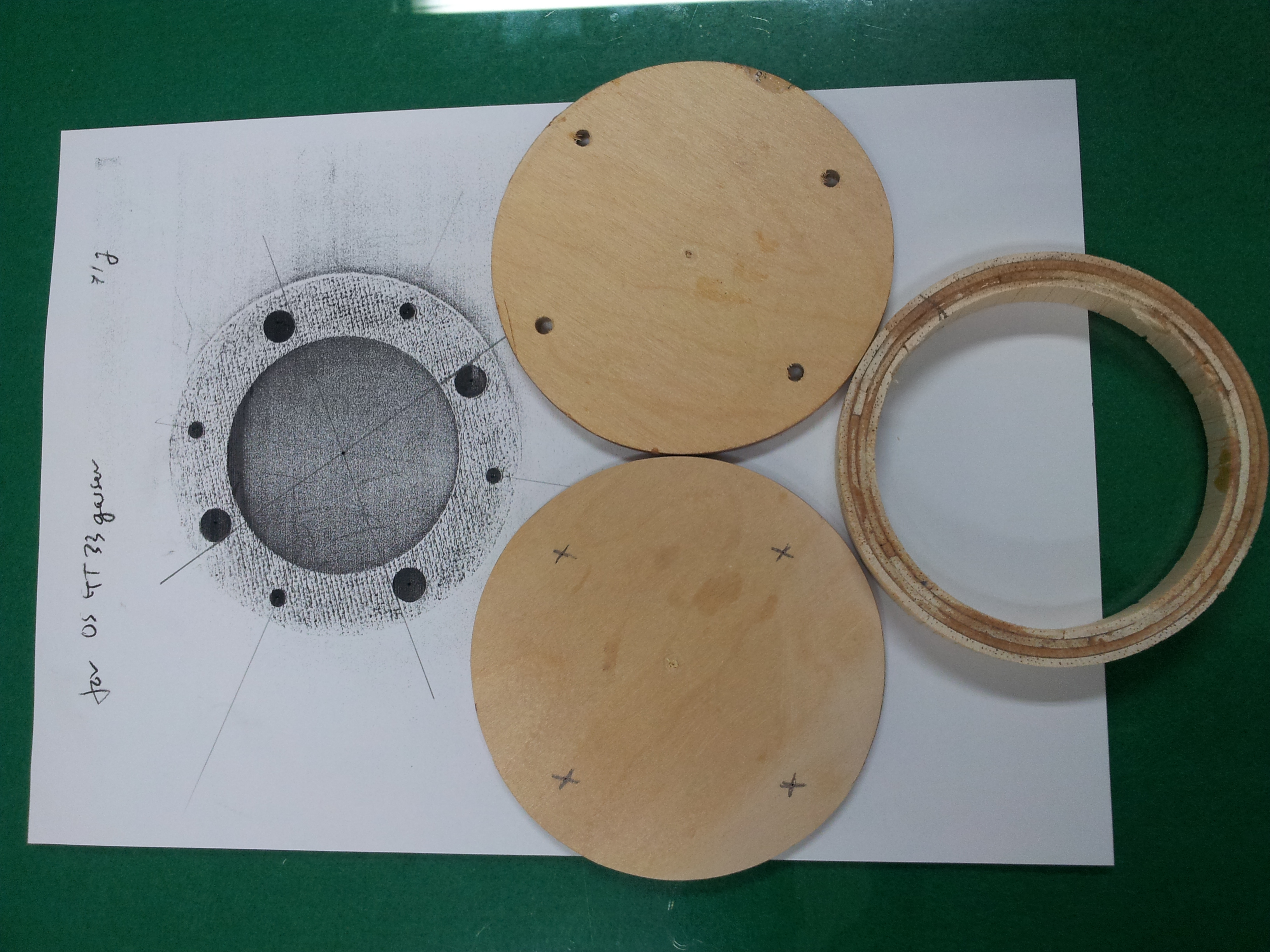

Dear Matt
I show your gasified VQ in you tube. It was great.
You might remember I had Smaragd with OS 33GT, which I lost due to radio failure.
Then I am flying Extra 330 with OS 33, but I am not satisfied.
It is difficult to find 2x2 F3A plane for OS 33. So I decide to gasify my VQ with OS 33 engine. Your thread and You tube encourage me much to mod it.
I have been out on my work, and also involved in a Forum about Chinese new Tx, Taranis in RC Group.
I will proceed soon to prepare materials for a soft mount. This time I'll make it by myself with friend's help here.
The first Hyde mount was lost with Smaragd in a river. And I'll just use the OS stock muffler which make simple to mod.
Thanks for your this thread on 'Let's gasify a VQ'.

Choihjin,
I remember the Smaragd but didn't realized you had lost it. Sorry to hear that. These things are real set backs sometimes for those of us that don't have a team working with them.
The rubber stock I use is from a motorcycle inner tube. The engine mount diameter is around 9cm so the rubber needs to have an unstretched diameter of around 8.5 cm. It works better when it is stretched a little to fit. Maybe a better way to state it is that the mount has a circumference of about 27 1/2 cm while the rubber tube should have something around 25 1/2 cm to 26 cm.
BTW- I have a different thread in RCU that shows how to build a soft rubber iso mount....Good luck. The OS 33GT is terrific power for the VQ. Half throttle everywhere for anything we need in Pattern
The glue is regular thin or medium ca. BUT you have got to make sure that the rubber is scrubbed clean and then sanded to remove any gloss. It will stick great to aircraft plywood

Matt, Thanks for quick response.
Actually I have searched all your thread about the soft mount, and organized all your writing.
I'll look at it again and will search whether a suitable tire tube is available here, Korea.
Actually I'll work withone of my club members to make soft mounts, who is very good machanic and experienced, but not able to understand English. I should direct him how to do.

Dear Matt;
I just made a ring, front plate and back plate.
Diameter of the ring are 88 mm inner diameter and 107 mm, so 9.5 mm thickness.
Thickness of Front plate is 5.5 mm (2x3/32'' +GF), and that of back plate is 4.5 mm (2/32"+1/16" +GF). Diameter are both 111 mm.
Four holes in the front plate (in the picture) are for engine mount of OS GT33.
However, I can not find proper inner tube. One that I have is from a small plow trackter with a circumference of 34 cm, which just fit on the ring without stretch.
I am considering to cut the rubber, and make a tight rubber ring by overlapping two ends pasting with gorilla super glue.
Please, suggest any comment. Thanks Matt.
